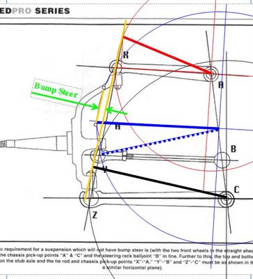

    Inspired by a question in another thread:
    Quote Originally Posted by Scargo View Post
    "Running the low ride height requires the use of a bumpsteer kit because the steering rack stays in the same chassis location." Does this mean that the steering rack can't be moved up to stay in plane
    Rather then install a 25mm bumpsteer kit to make up for the drop in height, could we not just move the steering rack up 25mm to correct the geometry?
    Director of R&D, FFR Jim Schenck's Avatar
    Wareham
    444
    You could do that but the steering geometry will be better if you leave the rack where it is and move the outer tie rod. Getting the long tie rods closer to the plane of the longer lower control arm (longer than the upper) is what you want.
    How is that???
    You are moving the rods away from the plane of the LCA if you do the BS kit.
    Moving the rack is better.

    Quote Originally Posted by D K View Post
    How is that???
    No you are not, you are keeping the tie rods in the plane of the LCA and raising the spindles with the bump steer kit.

    Adding a bumpsteer kit gives you an adjustable angle plane, you can set it to wherever you want it. Moving the rack would move it away from the height plane of the lower control arm, but if you are saying the two should always be on the same angle plane I disagree. The lower arm and tie rod should only be parallel if they were the exact same height, angle, and the same length when viewed from the front. Usually the best solution does not have the tie rod and lower arm at the same angle because as the tie rod gets closer to the upper arm it is more affected by that movement as well.
    In this case moving the tie rod down gets it closer to the height of the longer arm, and since it is a fixed length (determined by your toe setting and the width of the rack) getting it closer to the longer of the two control arms is helpful. If you really wanted to move the rack you could, but it isn't better.

    Complex geometry. How to know what's best and best for bump-steer? Personally, I don't care for the tie-rod end being levered off the steering arm by many inches.
    "Best" for me with my current line of thinking is utilizing the upper arm and mount and incorporate racing components as much as possible for a race only (uncompromised) design. Seems many spindles have steering arms at various heights and with varying Ackerman.
    For my goals, I plan on doing a different spindle, rack and LCA. I'm hoping I can get the help of a professional on design.

    As Scargo pointed out, it is very complicated geometry. You can buy a $500 program, WinGeo, and enter all the parameters and find values for bump steer, roll centers, etc. Or, you can measure it on your car, which is what I did.
    I set the toe at zero at a ride height of 4". Then I moved the upright up and down +/- 2" guessing that it would a good approximation of total travel. I clamped a lazar level to the hub, and shined the dot on the barn door 20 feet away. This way I could measure small changes.
    Some people measure toe in degrees, but I think more commonly it is measured with a 2 foot piece of angle iron laid along a tire on each side of the car. Then, for example, 1/4" of toe out means the front ends of the angles are 1/4" farther apart than the rear ends. This is equal to about .3 degrees of toe out on each wheel.
    So, for my setup, the dot on the door moves 20 times more than the front of the angle iron on the tire. Since the rear of the angle moves too, and the tire opposite moves as well, the math works out that the dot on the door moves 5 times more than the actual toe reading.
    Now for results (my measurements on my frame at R ride settings), with camber -1 degrees, and castor 4 degrees, set for zero toe at 4" ride height.
    For the Baer bumpsteer kit as it comes, using all the spacers, the total spacer length is 1.15"
    When the suspension is at 2" extension, there is 2" of toe out. At 2" compression, there is 1.25" toe in.
    For a spacer at 2.437", as suggested by Jim Schenck, at 2" extension, there is .6" toe out, and at 2" compression, .4" toe in.
    I messed around a while with different spacers, and finally found that
    For a spacer of 2.85", at 2" extension, .05" toe out, and at 2" compression, .05" toe out.
    I wouldn't be surprised if different frames have small differences in the above.

    Nuisance,
    Your measurment of toe is being thrown off by tire scrub. As the suspension moves up and down the wheels do not stay exactly the same distance apart due to the arc the control arms travel. So even if the steering angle was fixed you would be seeing an arc in your laser pointer dots. My guess is that is the difference between your spacer dimension and what we came up with, however alignment settings can have a significant affect as well because they alter both control arm length (camber) and tie rod height (caster). You can still measure bump steer with a laser pointer you just have to compare a point equal distance out the back side to seperate the turning motion from the scrub motion.
    Sponaugle,
    In your picture your lines have to pass through the outer pivot points of the lower arms, the Subaru arms are deceptive in that the center of the lower ball joint is not in the arm but is up in the spindle. So your line for the lower arm is way to low on the outside. Moving that line up would give you a much closer intersection like you are talking about.

    So, I did re-do the measurements. This time I was as careful as I could be. The alignment was -3 camber, 3.6 castor, and 0 toe at ride height of 3.5". I clamped a 2 foot level to the disc, and measured each end to a bar clamped to the frame. This way I would cancel the tire scrub, and measure toe more directly. I then doubled the difference I found so it would be the same as we usually measure from side to side using toe plates. I am still using the Baer bump steer kit rod ends.
    With my original spacer of 2.85", 2" compression gave 3/16" toe out, and 2" extension gave 1/32" toe in
    With the FFR spacer of 2.437", 2" compression gave 1/16" toe in, and 2" extension gave 1/4" toe out
    With a spacer 2.75", 2" compression gave 1/16" toe out, and 2" extension gave 0 toe
