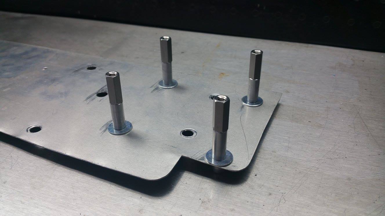

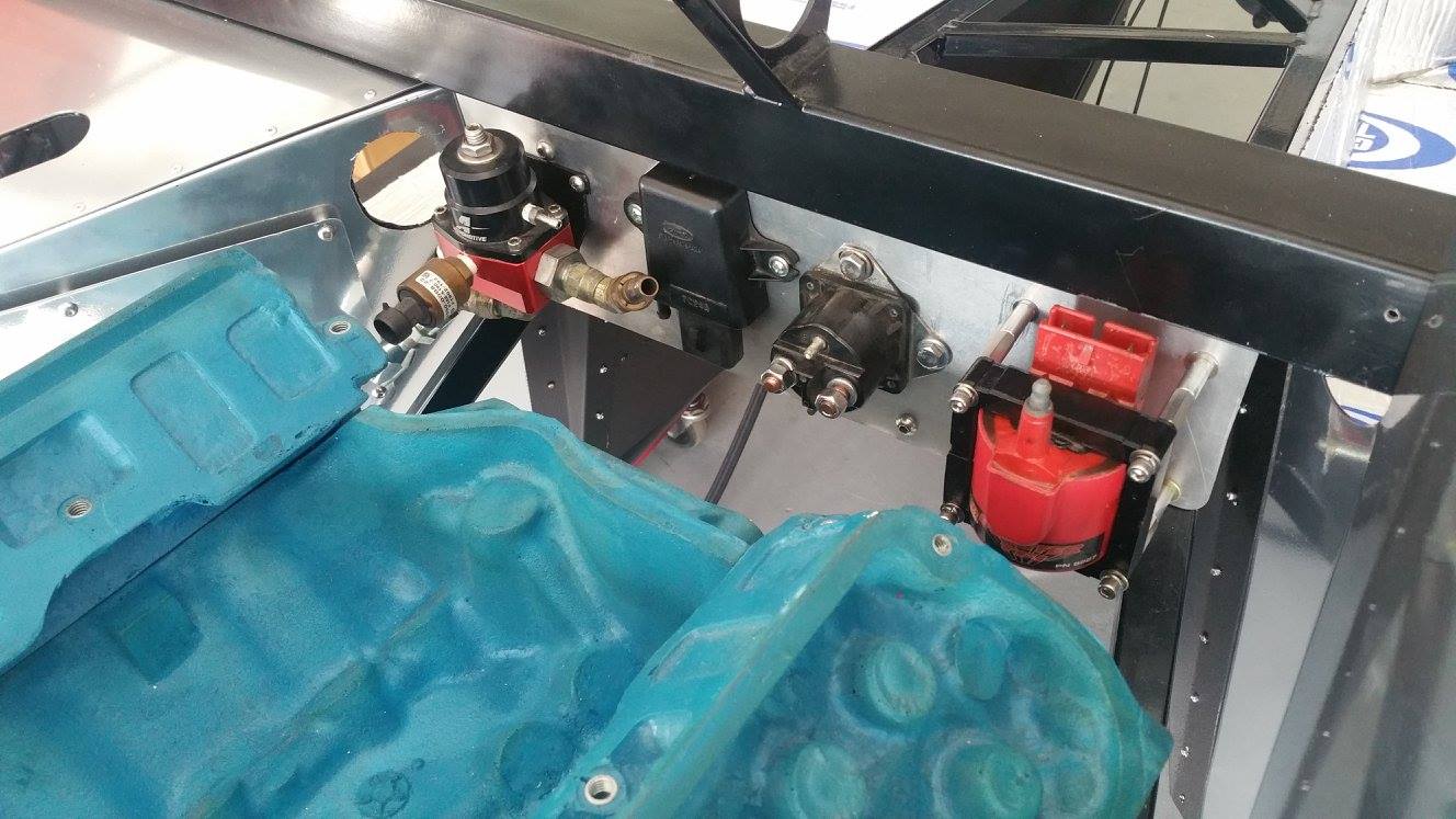

    Custom Firewall Extension Panel - Complete / Fuel Pump Controller Box - Part 1
    Here are some of the other items I've been working on for the last couple of weeks or so. These are side projects which have nothing to do with the actual build, but I consider necessary for mine:

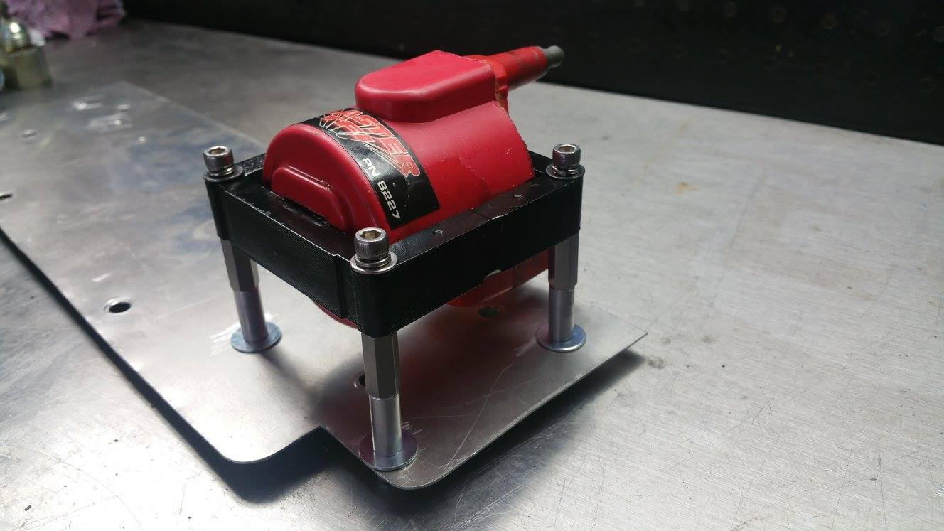

    With regards to the custom-made firewall panel addition, I finally finished it. This contraption you see here is supposed to be the "bracket" for the ignition coil. The way I did this allows me to mount the awkwardly-shaped coil, while still giving me enough room between it and the panel for the coil to fit, placing the coil forward enough to clear the 2"x2" square tubing to allow for the electrical connector to be plugged in, and allowing me to remove the coil from the front without removing the whole panel to do so.
    The coil mounted to the "bracket". This set-up still gives plenty of room between it and the engine.
    After the panel was powder-coated, I attached all the intended items (fuel regulator, MAP sensor, starter solenoid and ignition coil) onto it and temporarily installed the panel to the frame to make sure everything fit.

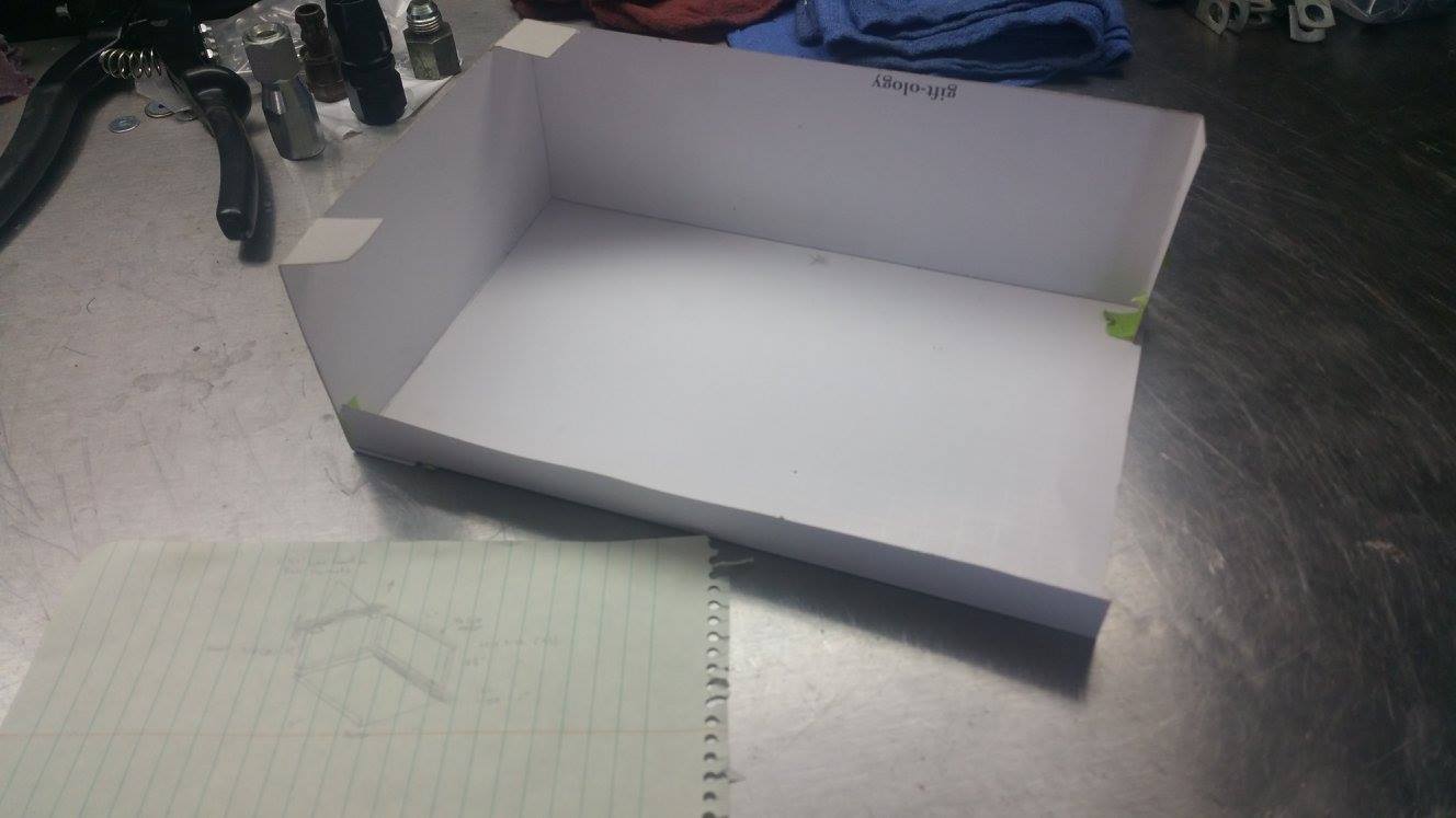

    I need a place to mount the fuel pump controller and the battery shut-off switch. I decided to place them together in a custom-fabricated box. This box would be installed under the trunk floor, but easily accessible via a bolted lid, much like the after-market battery boxes. I started with a drawing with dimensions gathered from the trunk's frame and obstructions. Then, I transferred the dimensions onto board paper pieces which I bent and taped together, then mocked onto the frame to make sure it fit.

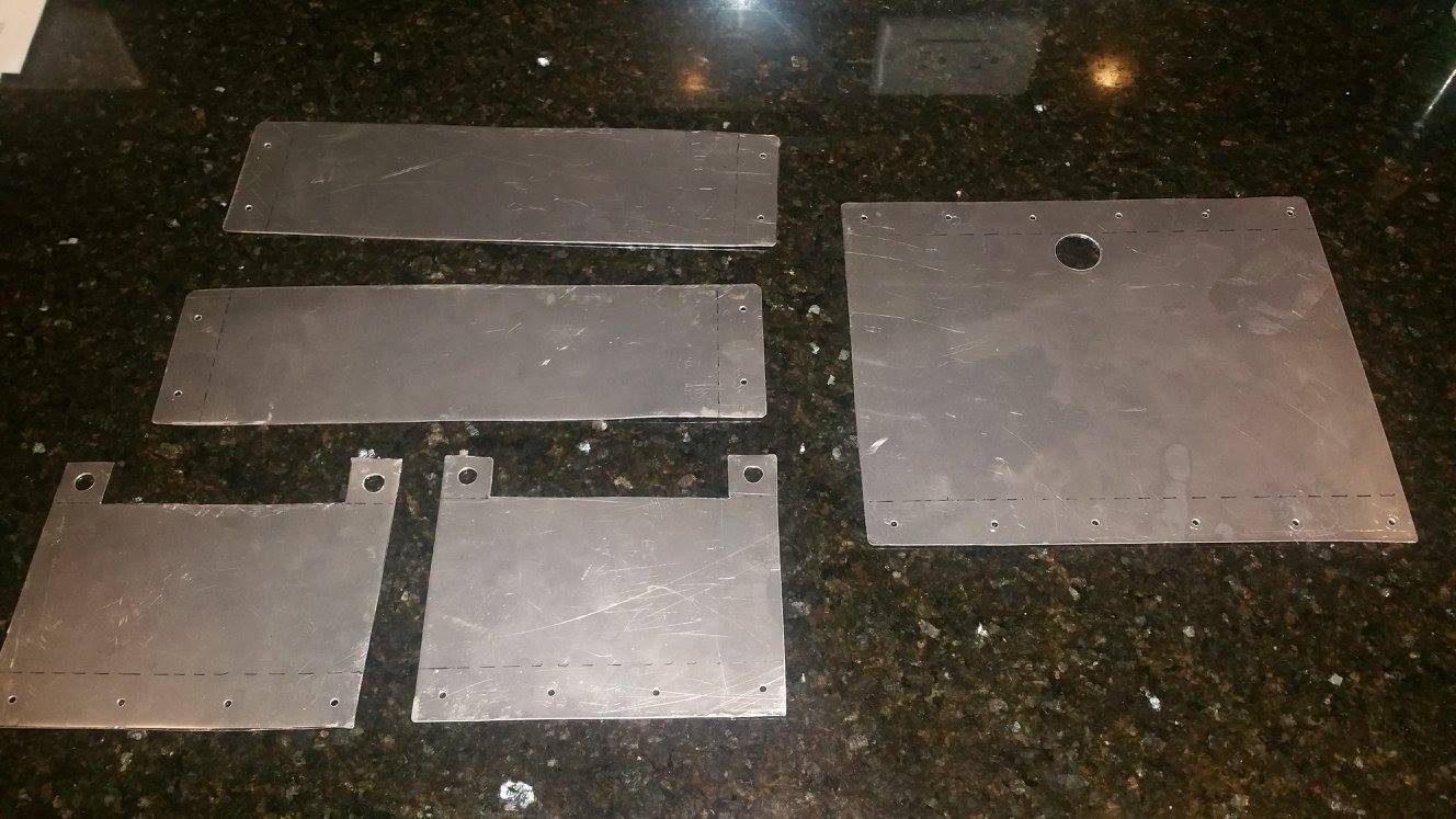

    Once I was satisfied with the fitment of the template, I used the board pieces to make aluminum counter parts. I then drilled the necessary holes and marked where each piece needed to be bent. Thanks to Henry (65 Cobra Dude) for letting me use his metal brake to do this part (I really need to purchase one, but can't decide if I want just a brake or a much more expensive 3-in-1).
    This is the pre-assembled box for the fuel pump control unit attached to the frame by cleckos for fitment purposes. I still need to drill holes for all the items and wires which will be installed within the box and fabricate the lid. I will be doing this later, during the wiring part of the build and once the battery is installed.

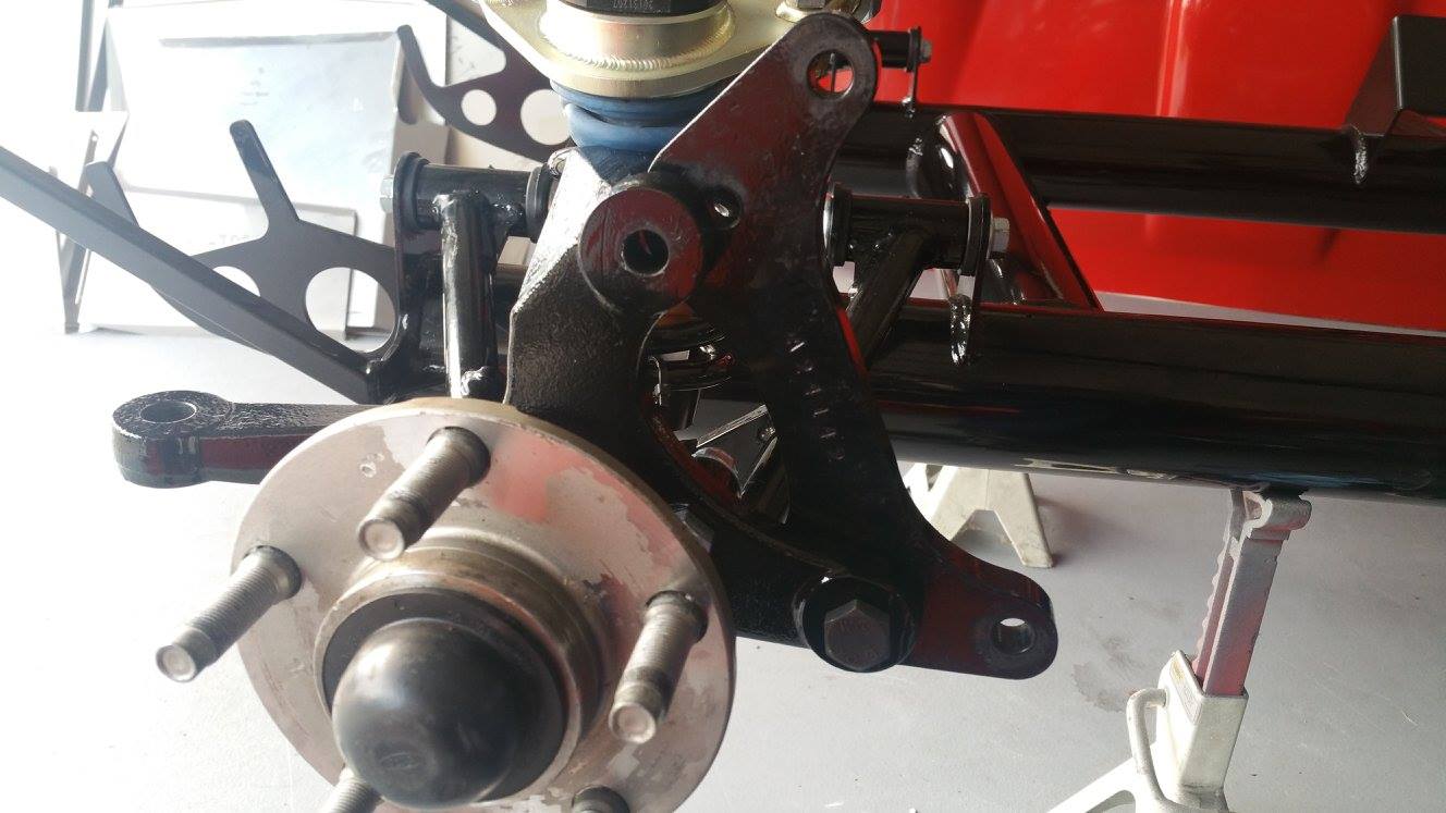

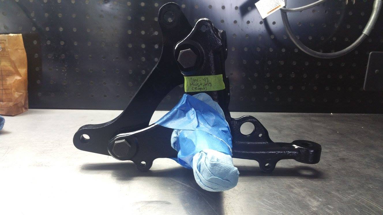

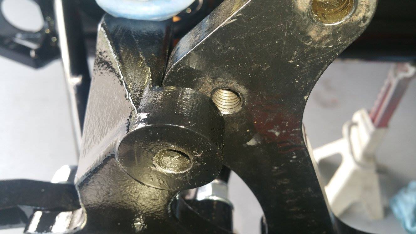

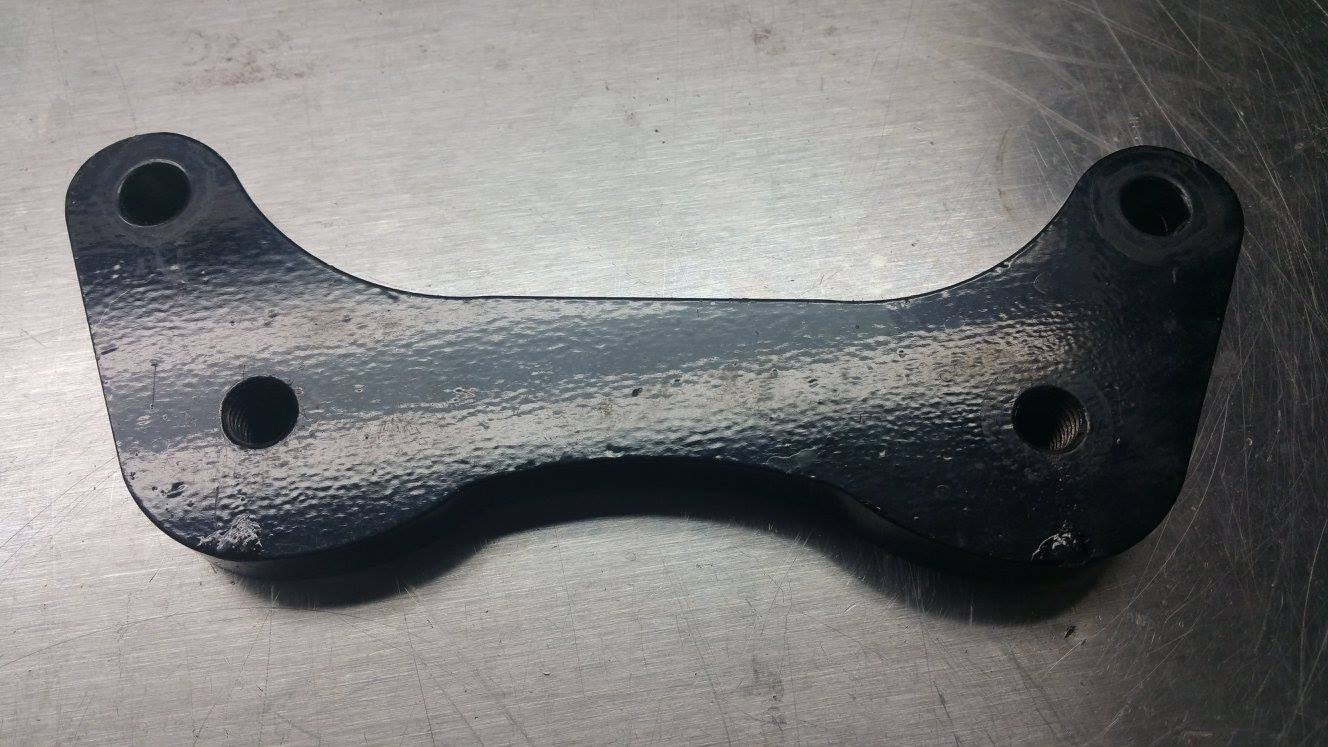

    Quote Originally Posted by Carlos C View Post
    I just keep running into issues regarding the front suspension, due to a badly welded frame tubing. After installing the FFR spindles and my donor hubs to it, I realized that I had wasted hours of work. The FFR spindles are not compatible with my donor brakes. The FFR spindles can only handle up to 11" rotors/calipers. My donor brakes are from SSBC and are 13" rotors/calipers. This brake system came with a caliper mounting bracket for the SN95 spindle (which is what I have), but due to the design of the FFR spindles, this bracket is not compatible with their spindles. See photos below.
    SSBC caliper mounting bracket, specifically made for the Mustang to work with their 13" calipers.
    SSBC caliper mounting bracket mounted on the SN95 spindle.
    SSBC bracket not fitting onto the FFR spindles.
    Close-up of the FFR spindle's interference with the SSBC bracket.
    After a few email exchanges with photos, I was given two viable options:
    1. Bend the front frame tubing which originally created the interference between the UCA and the frame, and go back to using my donor's spindles and attach the UCAs on the upper mounting locations. This option makes me uneasy as although I asked for detailed information on how to properly bend this tubing without damaging it, I was not giving any. And any bends on this tubing could result in misalignments later on with the aluminum chassis panels for the radiator, or worse yet, the brackets which attach to the nose, although I was promised they would be no such issues. Well, I should've never had any issues installing a simple UCA to its bracket, but yet here I am.
    2. Spend an additional $921 to purchase FFR's brake system designed to work with their spindles. I have two problems with this option:
    a. Their brake system is not up to par compared to mine. Theirs are 11" rotors, non-drilled and non-slotted, with 2-piston calipers. My brakes are 13" zinc-plated, slotted rotors, with 4-piston aluminum calipers. Let's note that my engine makes over 600 RWHP. I need to make sure I have a set of brakes that can stop the car at any given moment and resist fade when hot, especially when racing.
    b. Why should I spend almost $1K for a brake system, in addition to what I've already spent in options, in order to rectify a situation which is not my fault?
    I do have a third option: I may carefully cut this frame tubing at the welds on the X-member, install the UCA, place a few spot welds on the tubing after repositioning to clear the UCA, remove the UCA, finish welding the tubing, and powder-coat the section where the coating was removed. After that, I'll re-assemble the suspension and FINALLY install the brakes.
    Either way, I've already WASTED too much time changing parts, assembling, disassembling and re-assembling; emailing FFR back and forth, just to end up going nowhere with this. It's very frustrating when you spend so many hours working on this vehicle, and then step back to look at it, just to see absolutely no progress.
    Well, we'll see what option I decide to go with...
    Carlos
    If you have not decided yet, I suggest a fourth option.
    Just grind the SSBC bracket to fit the FFR spindle. There is way too much meat in this bracket anyway. To a lesser extent, I had to grind my Wilwood bracket as well.

    As suggested above, there is plenty of meat on the caliper bracket. Grind down carefully so that the bracket matches
    the contour of the spindle. make it as close as possible so the threads appear as the bracket contacts the spindle.

    I decided to go a different route as the amount of distance between the bolt holes on the bracket and spindle is too great, and removing material off either or both would compromise their integrity. Thanks for your suggestion, and sorry for the very late reply, as I've been off the site for a long time.

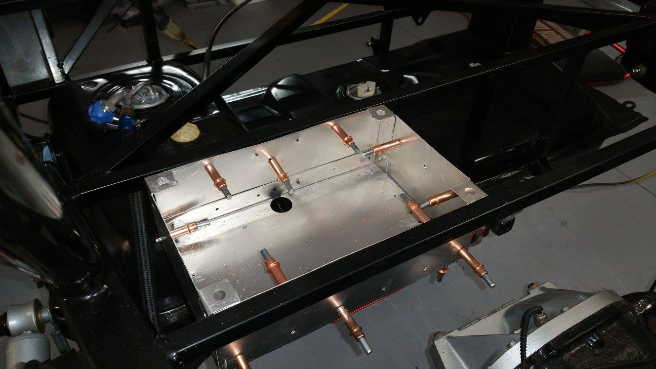

    I turned my attention to the trunk area this past weekend. I finally received and installed my battery box, along with my fabricated FMU (fuel management unit) / battery cut-off switch box.
    Here are the two boxes temporarily mounted within the frame rails under the trunk.
    Close-up view of how these boxes will be permanently mounted. After this photo was taken, I removed the bottom of the FMU box and drilled out all the necessary holes for all the items which will be attached to it.
    I placed the trunk floor down, marked the holes to be cut out, performed the "surgery" and placed the trunk floor back down to check for correct clearances. Besides the holes for both boxes, I cut out holes for the fuel pump pick-up tube, fuel level sending unit and fuel pump emergency cut-out switch.
    Before I permanently mount these boxes, I will be coating them to protect them from the environment, including road debris. I also just ordered a sound system for the car, and plan to build a sub-woofer box. I'll hopefully start that mini-project this weekend.

    It's Been A While - Part 2
    The trunk is finished, all the electrical, including custom electrical work - besides the gauges/dashboard - has been completed. Speaking of the dashboard, due to the A/C system and custom center console, I had to cut so much of the Spyder GT dashboard, that there wasn't much left of it. So, I decided to use the original aluminum dashboard instead, but I'm adding a few custom touches to it. I've also added some custom pieces throughout (shock towers, E-brake, Shifter, etc) to help seal the cabin from the elements.
    I also had to make modifications to the frame for the custom center console.
    Although there has been more progress than what the photos show, and I will be posting more updates in the future, I'm in the middle of a new, but short side-project. I just purchased a 2020 Mustang PP2, which I plan to modify immediately - I already have most parts ready to go. The supercharger is on its way. I will be documenting the project on this forum. Stay tuned.

    It's Been A While - Part 3
    Here are some more photos on my Coupe progress.
    The beginning of the sub-woofer box.
    The somewhat finished trunk floor.
    The amp will be located behind the driver's seat.
    Once I complete the Mustang upgrades and get back on this never-ending build, I'll post more photos. Now, these are older photos; this car is actually further along than this. I just haven't taken any recent pictures.
