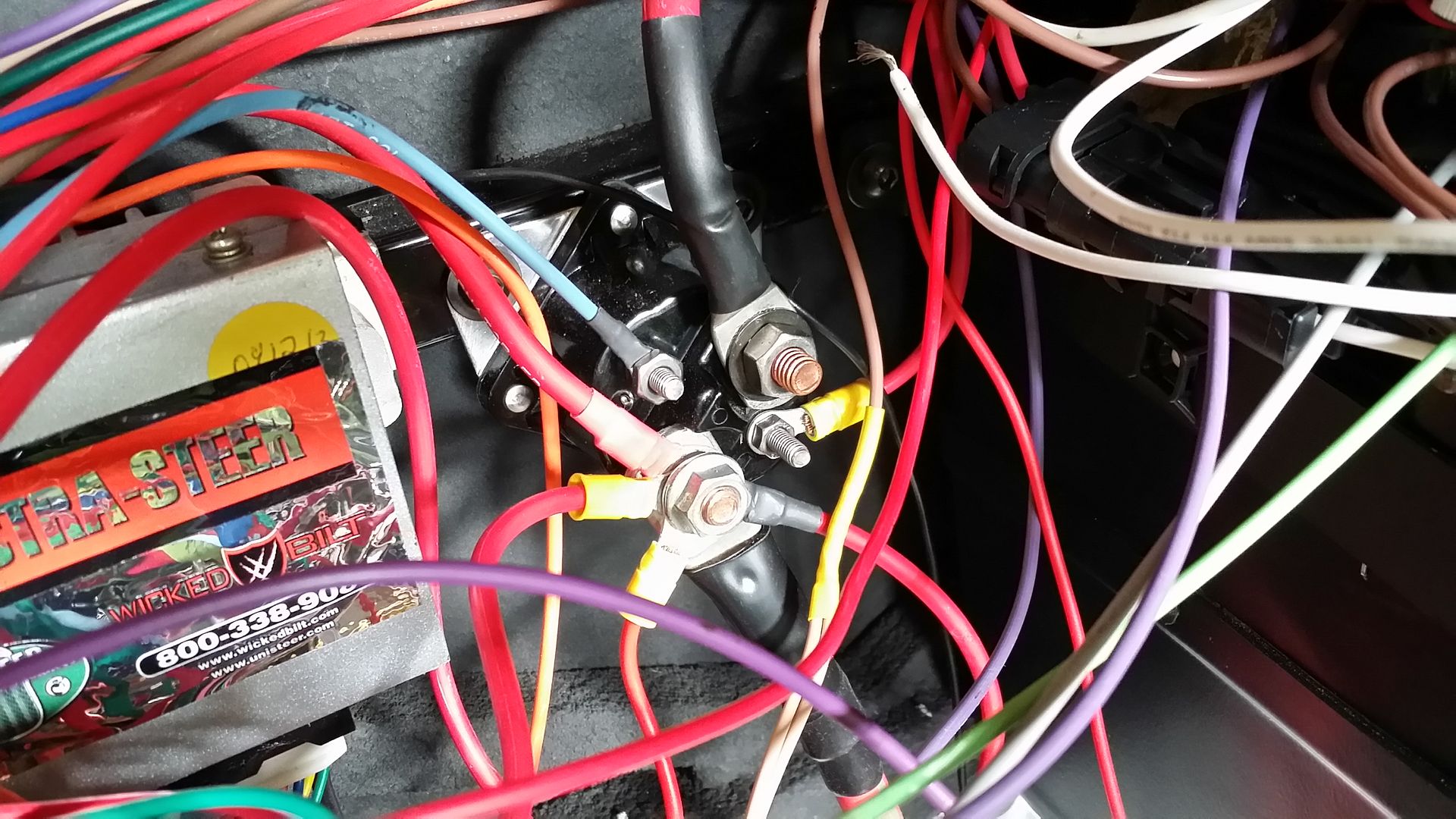

    I ran a 2 gauge cable from my trunk mounted optima to the solenoid then used the 4 gauge cable that came with the kit from the solenoid to the starter. There is a second wire that goes from the solenoid to the starter. The manual is not very clear on this setup. This is how mine is wired.
    Solenoid - Red wire on the right side terminal is connected to the starter.
    Starter
