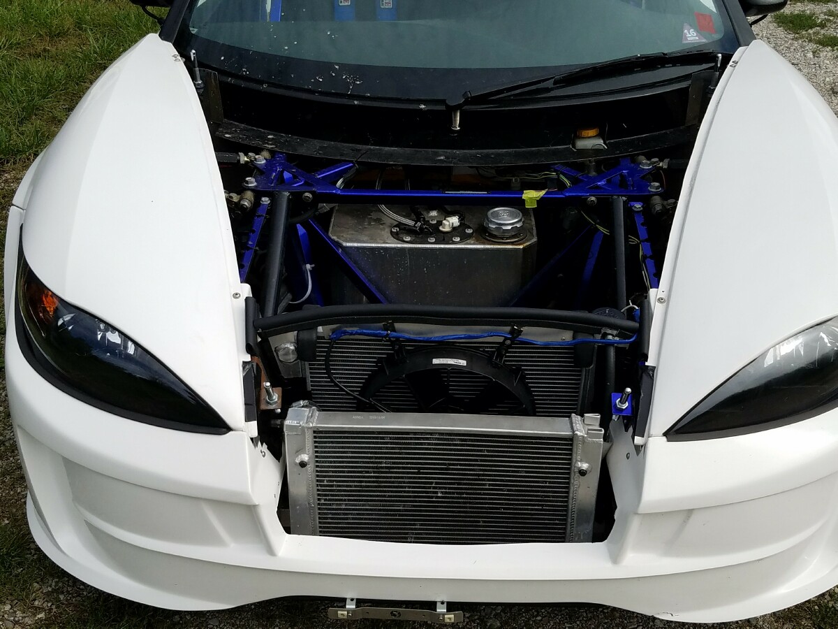

    I also went with a different radiator. http://thefactoryfiveforum.com/attac...2&d=1474354730
    https://www.summitracing.com/parts/GRI-1-25201-X
    Keep up the good work.
