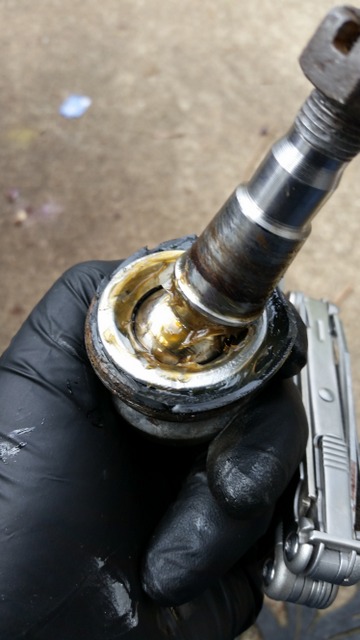

    I have about 1000 miles on my 818 with the donor ball joints that came with the donor front lower control arms (LCAs). I replaced them with some Moog ball joints yesterday, and cut off the boots to inspect the old joints for wear. I'm happy to report that there is no visible sign of wear. Here's a picture with the boot and most of the grease removed.
    I swiveled the ball around and could not find any wear marks or any sign of looseness in the joint. I will cut one open to make certain the cup is in good shape too, but based on how smooth and tight it is, I don't expect any surprises.
    Considering the critical role theses joints play in holding up the car, I plan to replace them annually. I will post the status of the joints again when I swap in a new set in a year.

    Nice initiative to let us know.
    You replaced your excellent condition OEM balls (I mean joints lol) with Moog's cuz you want to replace them annually? You didn't replace them cuz the OEM failed so I believe your reason is preventive only?
    This is the ball that you sit the spindle onto, right? And then bolt a pinch bolt at 37lbs.

    Yep, those are the ones.
    It was preventative, primarily because I have no idea how old the donor joints are, and all ball joints wear out eventually. In the stock WRX application, they become noisy and steering gets bad. In the 818, the joints are constantly under tension (unlike the stock application) so I don't know what the symptoms of a failing LCA ball joint would be other than catastrophic separation.
    Moogs, I'm told, are better than OEM. So I figure I'll start with a good set, and find out how they hold up with a known amount and type of use.

    No, they didn't fail. The ball joints carry the full weight of the front end, so failure would mean the chassis will hit the ground. At anything besides a standstill, I assume that would effectively destroy the car. In other words, you can't wait for failure to replace these. You have to find a way to inspect them, or regularly and proactively replace them. The Moogs are $50 each, so if I'm going to take one out to inspect it, I figure I might as well replace it with a new one.
