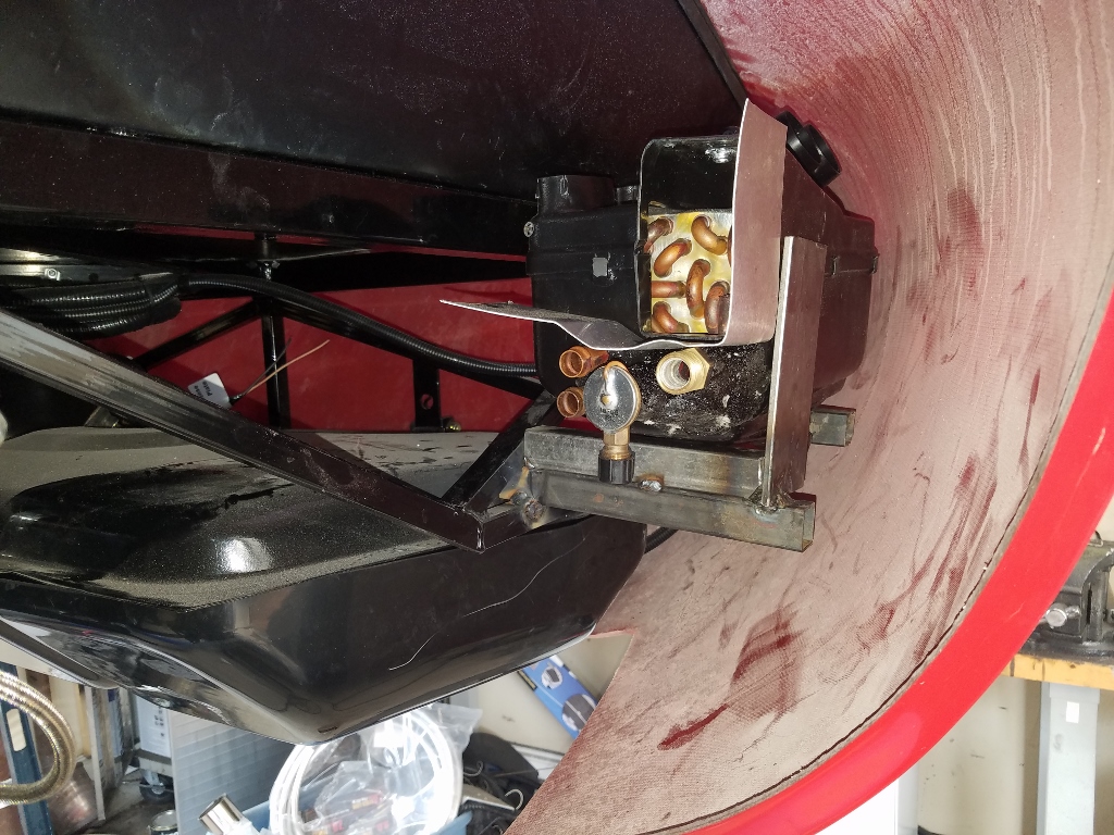

So, with my intercoolers taking up the spot where I am sure the AC/Heat unit is supposed to go.... more out side the "box" thinking was required.
While Wayne was up here last we kicked around a lot of ideas...this one made the most sense....
I will run the ducting back up into the back of the cabin. The defrost ducts will merge together and go through the tunnel up into the dash and split in two....
I have to make a custom fan box to rotate the blower so it draws air from the trunk... but I will do that with the body off.
