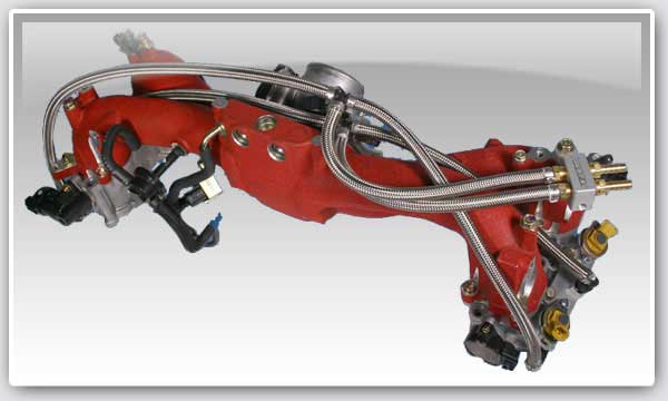

    If you're doing any sort of conversion switch to top feed injectors if the '04 wasn't already.
    Harley818's Avatar
    Vancouver BC
    788
    or you can simplify the fuel line for delivery per the Simplifying the EJ thread under Engine and transmission post #1.
    This makes it look better, and eliminates the uneven delivery lines that some say is a problem for high output engines.
    http://thefactoryfiveforum.com/attac...3&d=1362067091
