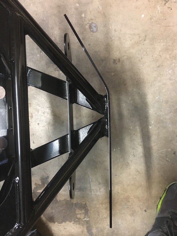

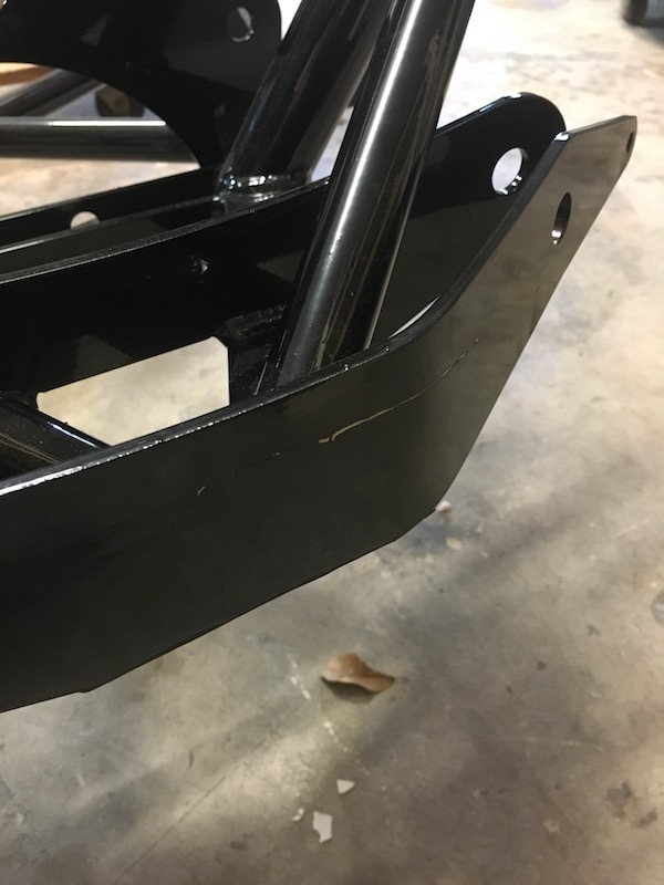

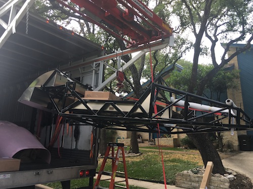

    Jerry at Stewart Transport delivered my '33 stage 1 today!

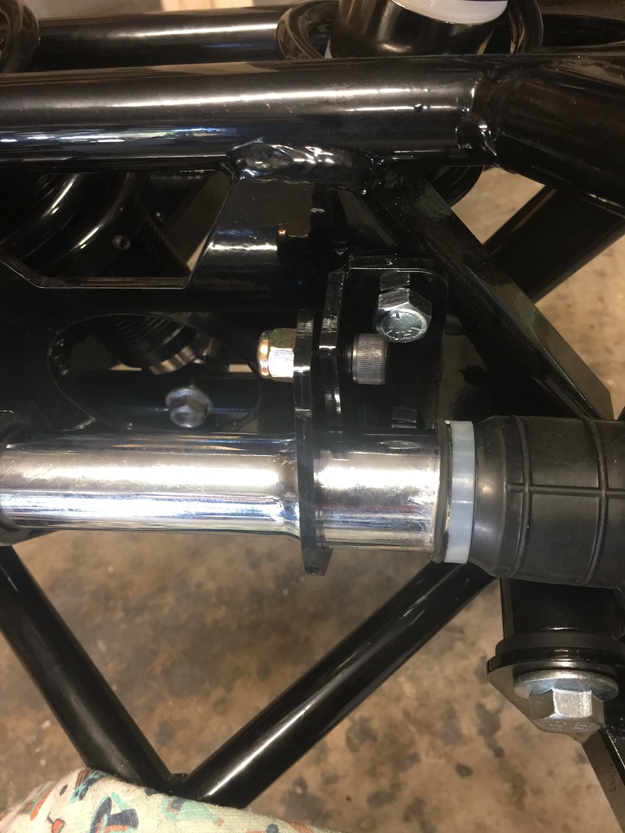

    Looks great, apart from one small problem, can you spot it? Something isn't as it should be
    Look at the very front of the chassis.. a little modification and flaking of powder coat. I'll let FFR & Stewart know about this on Monday. My wife and I did the inventory today, there's very little missing. A few bolts and a very short backorder list. In fact I have some extra parts in the cooling box that I haven't identified yet!

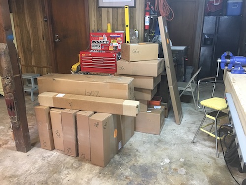

    Of course I have a lot fewer boxes and parts having just stage 1. No body, interior etc.

    Now it's up on stands my first job is to fix the bent LCA bracket. Still pondering how best to do it.. any ideas?

    RR, the renderings look great! Those tires look massive. I was pondering boxing the bottom of that frame horn on my car at one point. Now I may go back and do it. I recommend using a rigid square tube clamped or tack welded to bend it back without creating another bend and getting a wavy result.

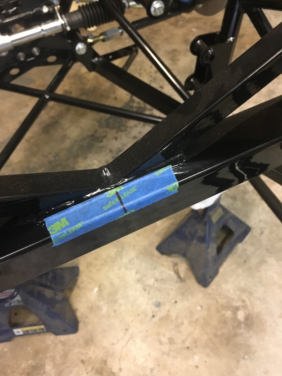

    Thanks erlihemi. I did exactly that but still got a wave. It doesn't want to bend that close to the weld. I've trial-installed the front suspension this morning to see how it all works.. went together very well so far.

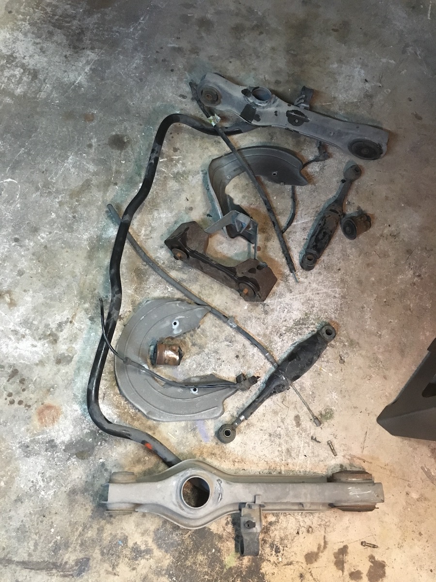

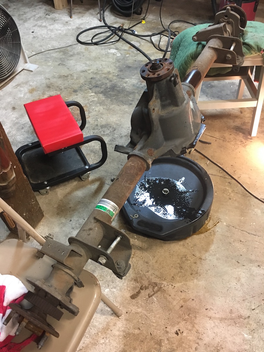

    Emptied some more boxes and assembled more parts while Stewart decides what to do with bent chassis. May have to ship back to FFR, but we'll see. Went to local junk yard and got '02 Mustang GT rear (3.27, 8.8, limited slip, 5 lug, solid rotor, 62.52" wide) and stripped it of all the unnecessary crap. Will wire brush and paint along with all the rest of the bare metal parts, but I think I'll trial install the rear and see how the 3-link all goes together first.
    Once it's in (and I've confirmed the 3-link still suffers from this problem) I'll consider the fix documented over at http://www.ffcars.com/forums/17-fact...sing-link.html (hat tip to myjones for pointing me at this). Or perhaps I'll try and find a competent welder to weld the banana bracket on..
    Before and after stripping the 'extras':
    All the leftover parts

    RR, that particular bend in the front bracket is pretty simple to straighten if you have some basic equipment. If you have access to an oxy/acetylene torch and a rose bud tip; PM me and I'll provide you with enough details that you can straighten it yourself even if you've never done this type of work before. It really is that easy. Of course you'll have to touch-up the powder coating and I can recommend a product for that as well.

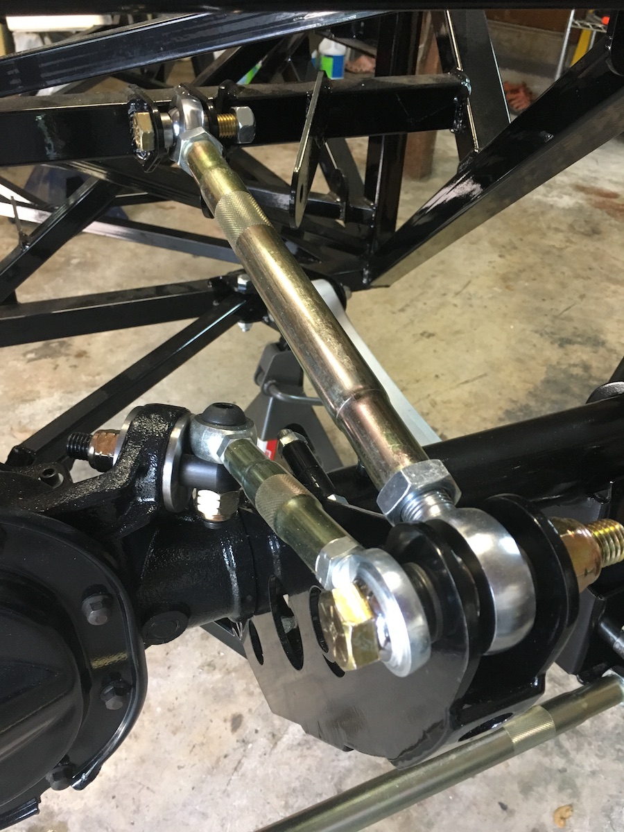

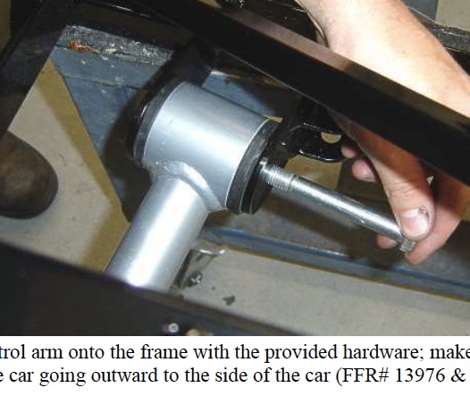

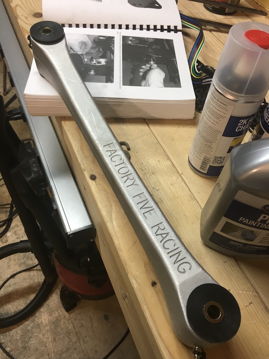

    BTW, love the new rear LCA.. compare the version shown in the latest manual with what I got!
    Thanks NAZ, will do, once we all decide what course of action to take.

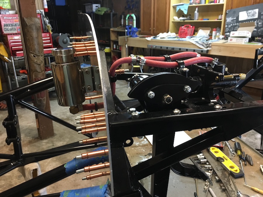

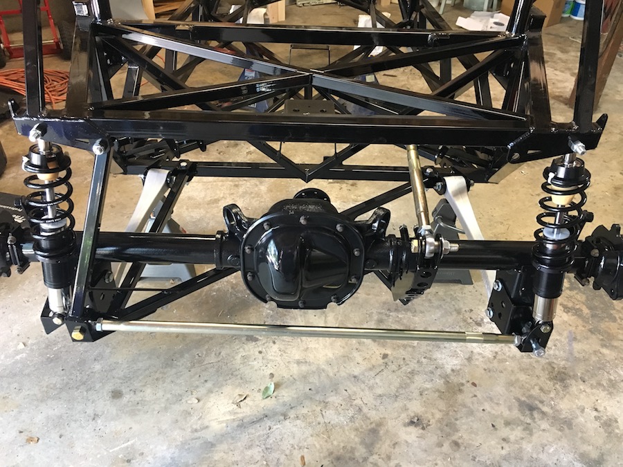

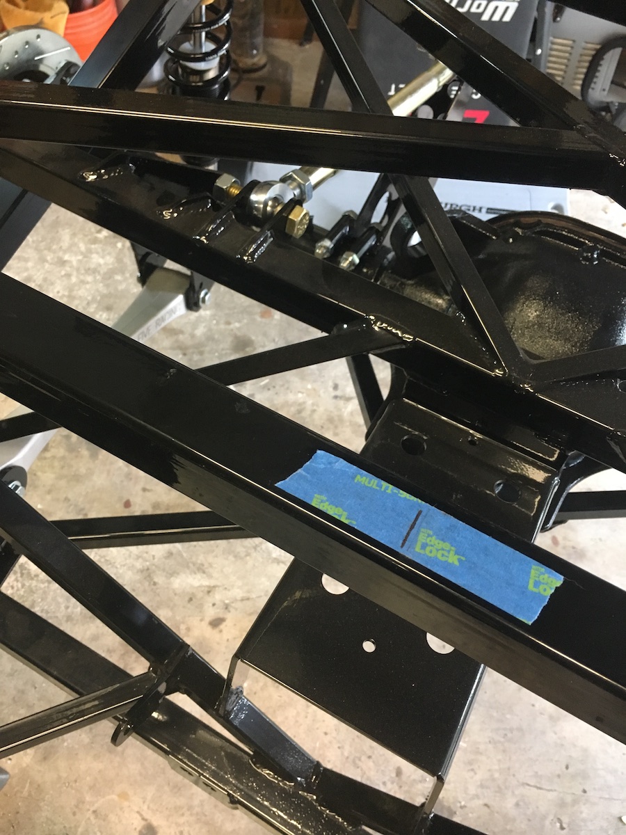

    Today was wire-brush-on-a-drill day. Many years of dirt and gunk to remove from the rear. Scrubbed, Soaked in Purple Power, scrubbed some more, then Eastwood Pre, 2K Primer and 2K Gloss Black. Turned out nicely though, used one can of primer and one can gloss on the rear and the two front UCA.

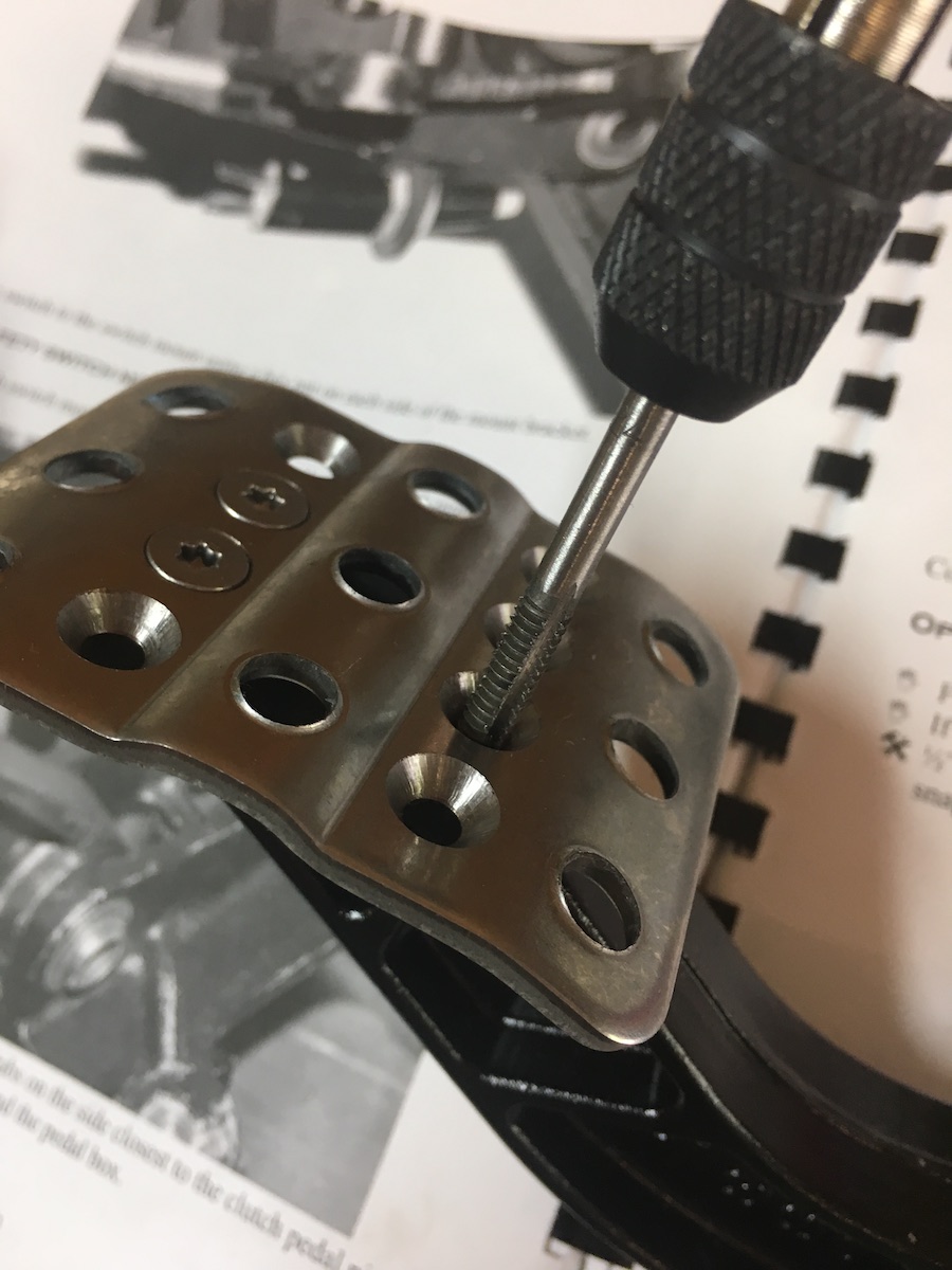

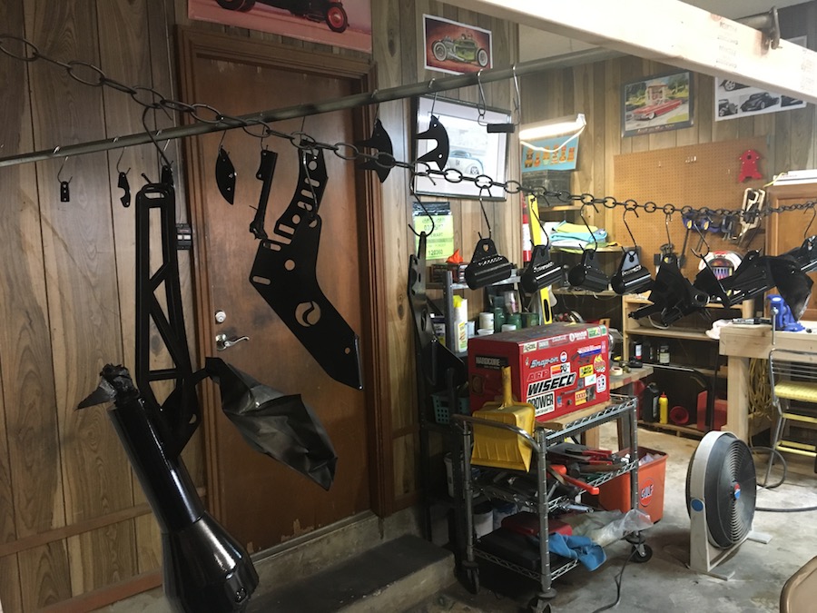

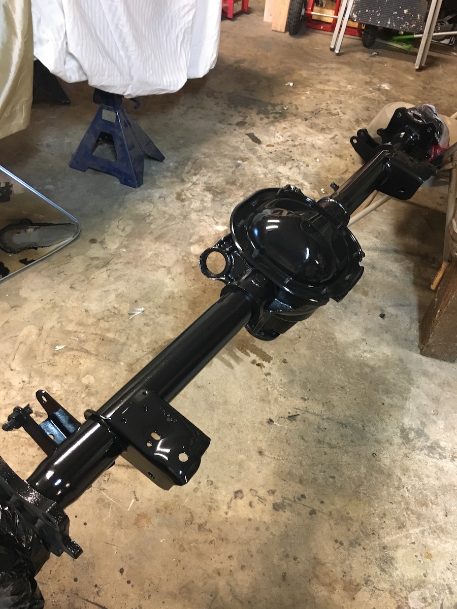

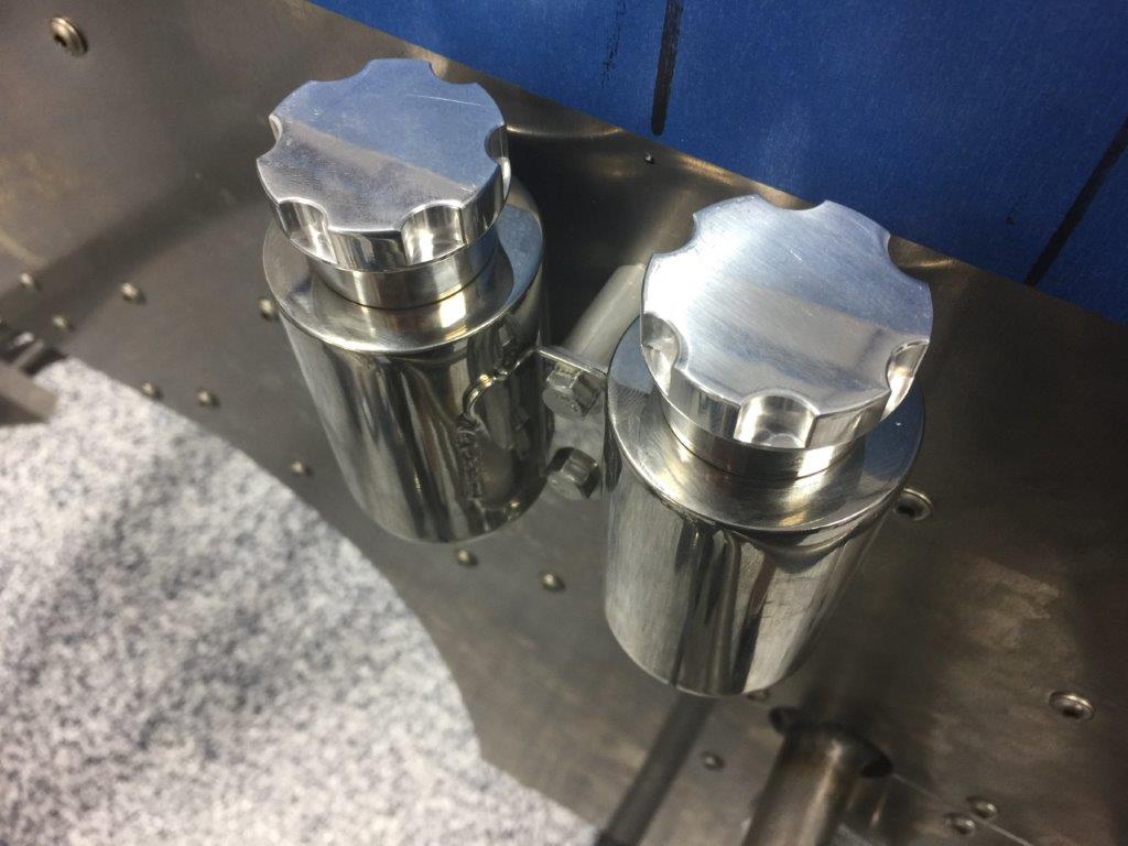

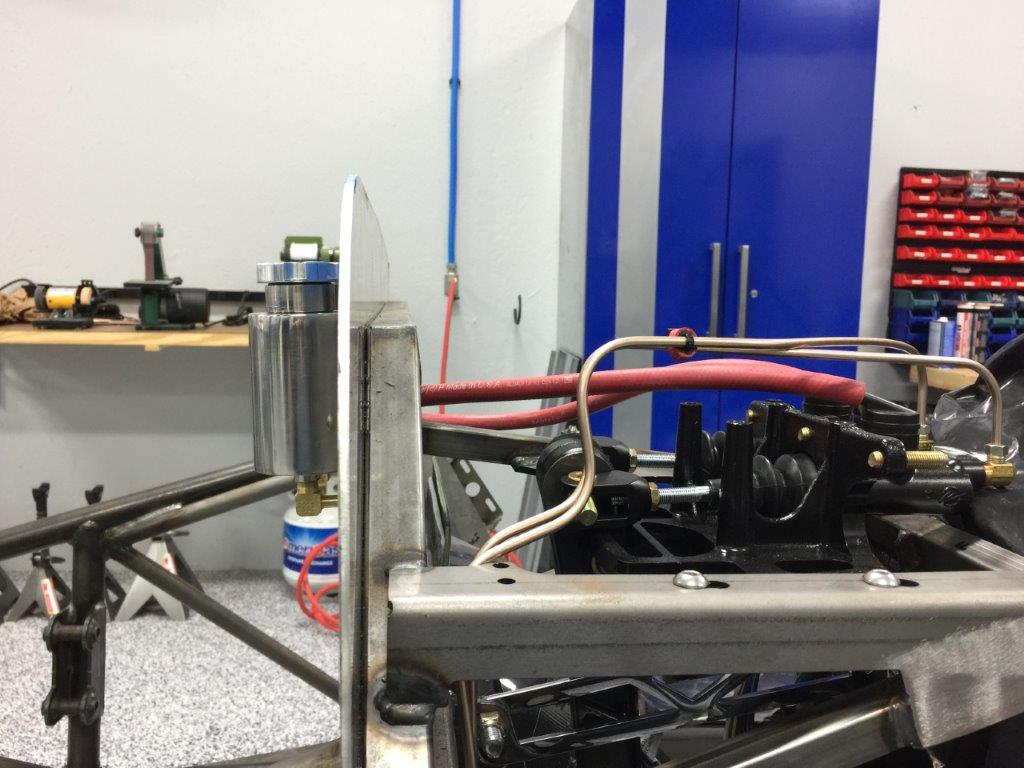

    Sanded, prepped, primered and glossed most of the rest of the parts I've got. The Eastwood 2K ran out with only the engine and gearbox mounts remaining - which is fine since I don't have an engine or gearbox
    I wish FFR would offer an option to powder coat all these pieces too! There's a lot of bare metal delivered.
    At least assembly can start now..

    I like your chain hanger and wish I would have thought of it.

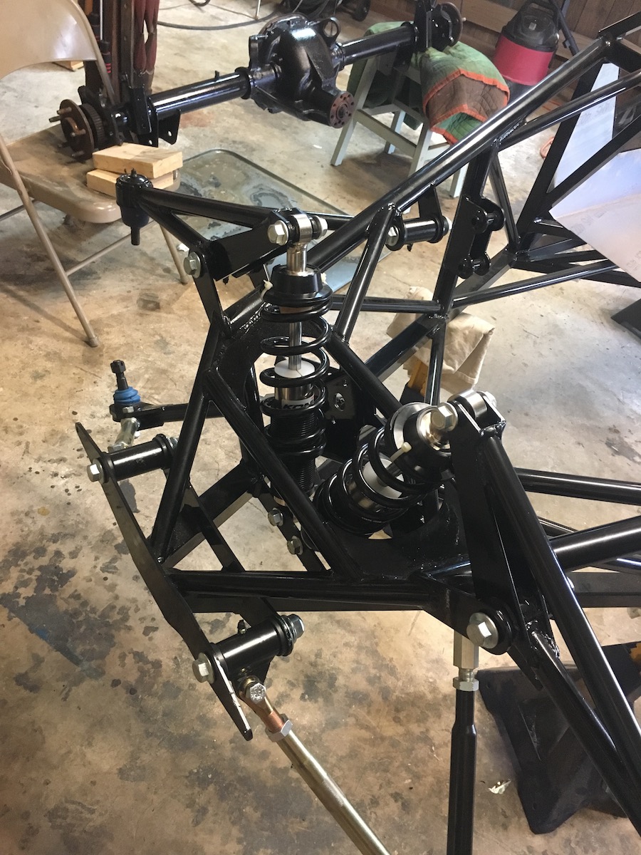

    A day of 'suggesting' that all the front suspension parts please kindly fit into their assigned locations. I hesitate to say i've done 'final' fitment of all this, but I surely hope so. It will be a day of cusswords if I have to remove those shocks, knowing what it takes to get those .32" spacers in.
    Although, the whole thing only took a couple hours. Finding and fitting all the grease nipples and caps and greasing it all up seemed to take just as long! I probably could have stayed an extra few minutes and added spindles and brakes (already assembled) but I'll start the day tomorrow with something easy..

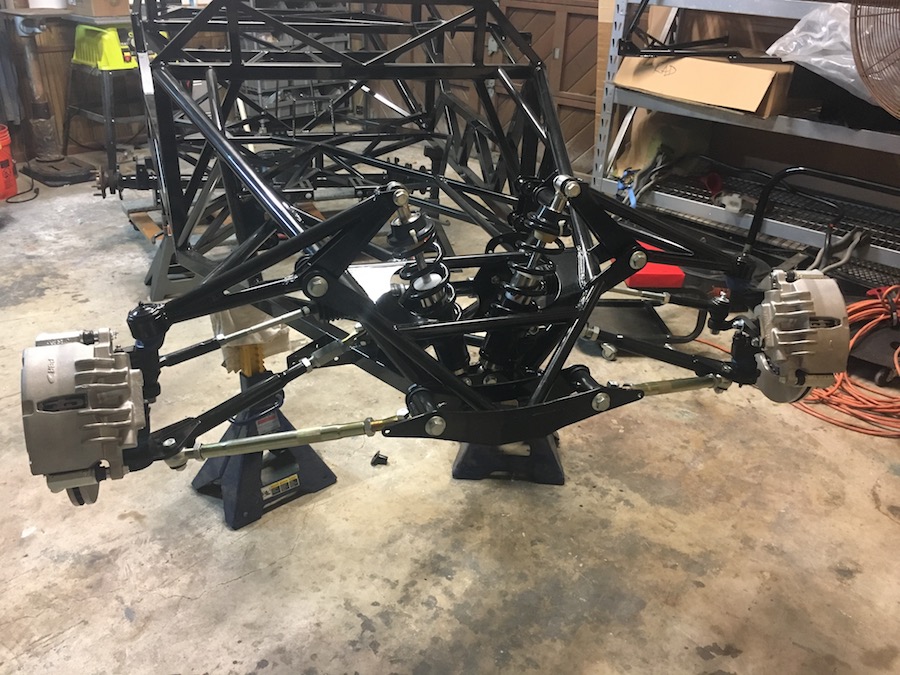

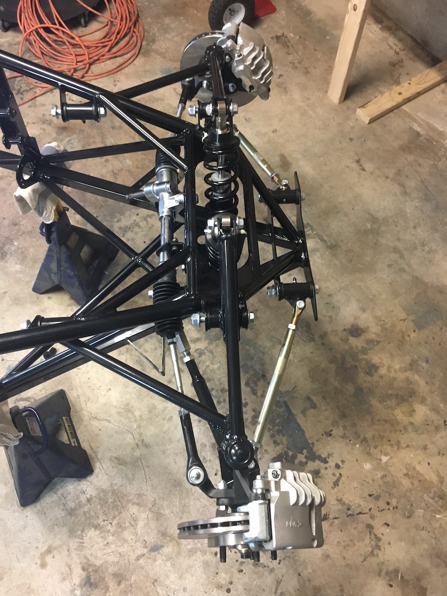

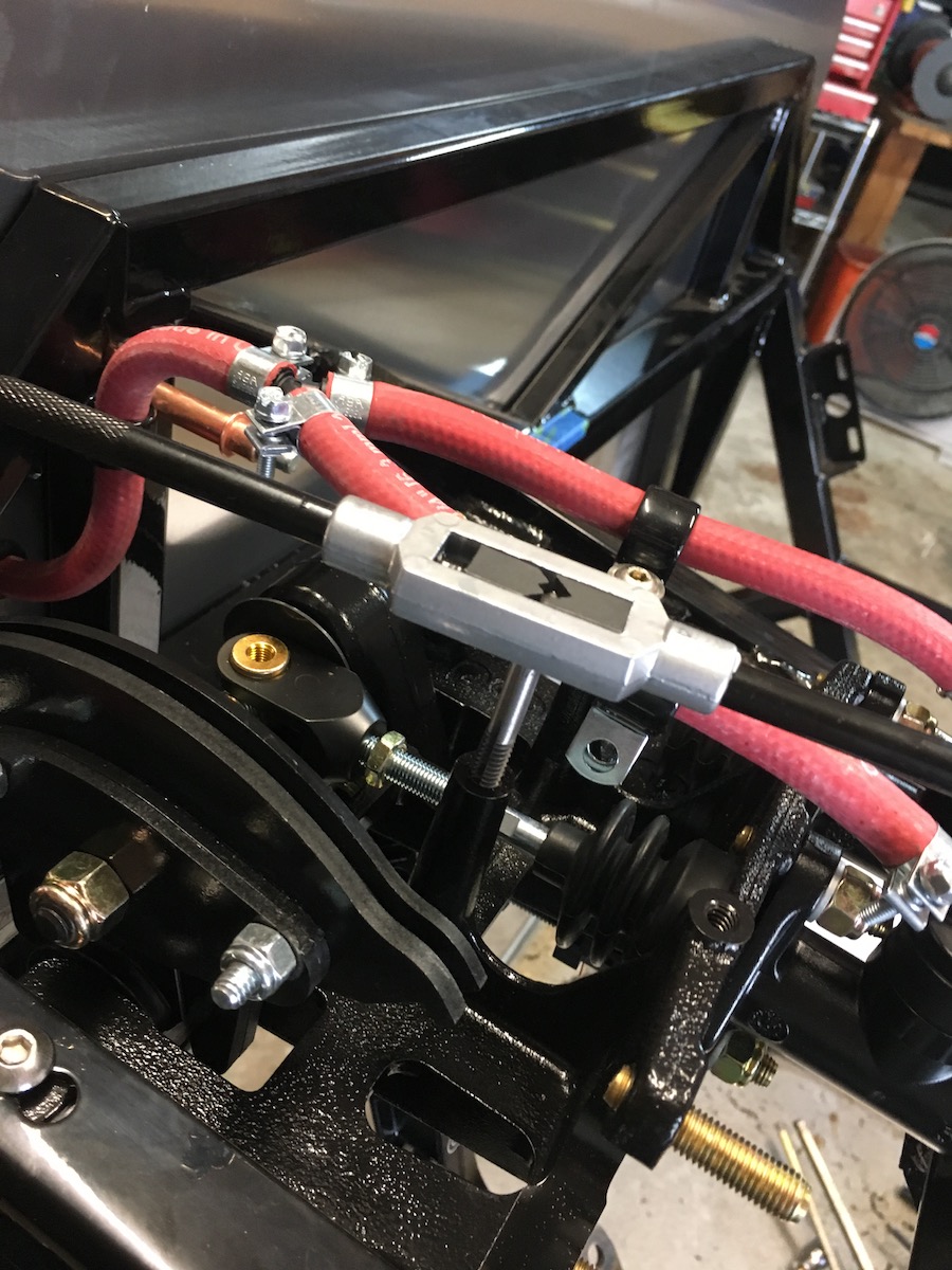

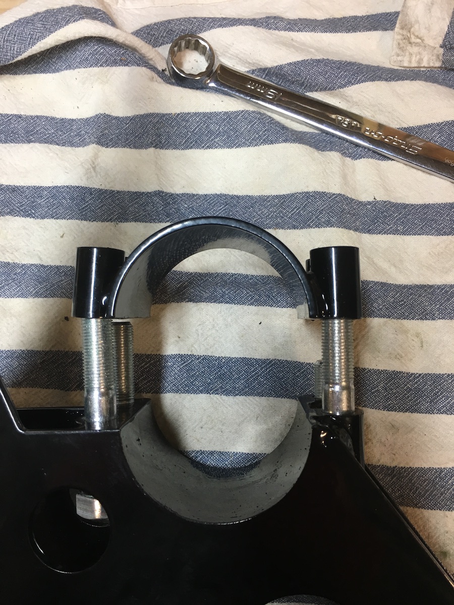

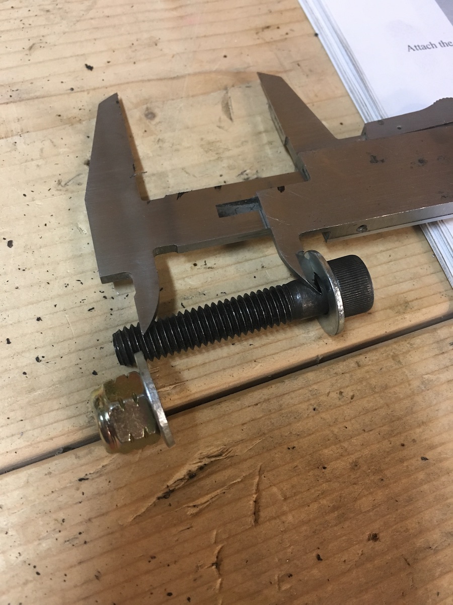

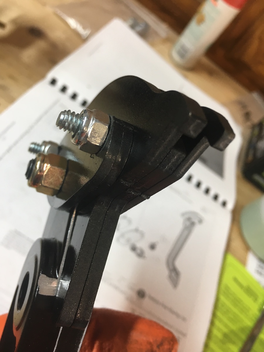

    Added spindles, hubs, rotors, calipers and steering rack today. Finally removed the chassis panels that came installed. Moved the rear into position with wife's help, waiting on the brackets which were POL and are already on the way from FFR.
    Everything went smoothly today, but the hub torque was interesting! My old snapon 3/8 drive torque wrench - 25 years old - only goes up to 100ft/lb. Never had to torque anything higher! But 235ft/lb is a lot higher, so I went and borrowed bigger torque wrench from autozone and had to buy a 1 3/8 wrench to do it up. I weigh 215, but damn it took some effort to get that click-click! I was doing chin ups on the wrench

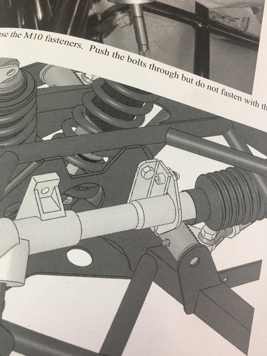

    Note sure about my placement of the metal steering rack bracket - the manual shows it the other way around, but that interferes with the cable tie, and since that didn't easily move I wondered if there was a groove there on the rack. So for now I just switched the bracket which will works. We'll see. It's at the end of the wide part, but it still tight.
    UPDATE: Later I went back and flipped this steering rack bracket back to as per manual, and moved the boot over a smidge.

    I didnt see a mention in the thread of how FFR addressed the bent chassis piece.
  20. #19
    Moderator
    RoadRacer's Avatar
    Join Date
    Oct 2011
    Location
    Manor, TX
    Posts
    2,245
    Post Thanks / Like
    Quote Originally Posted by Mick Scarborough View Post
    Ah, sorry. FFR were amazing and offered a replacement chassis if I wanted one, even though it happened during shipping.
    In the end Stewart and I agreed on some cash compensation. I'm happy with that.

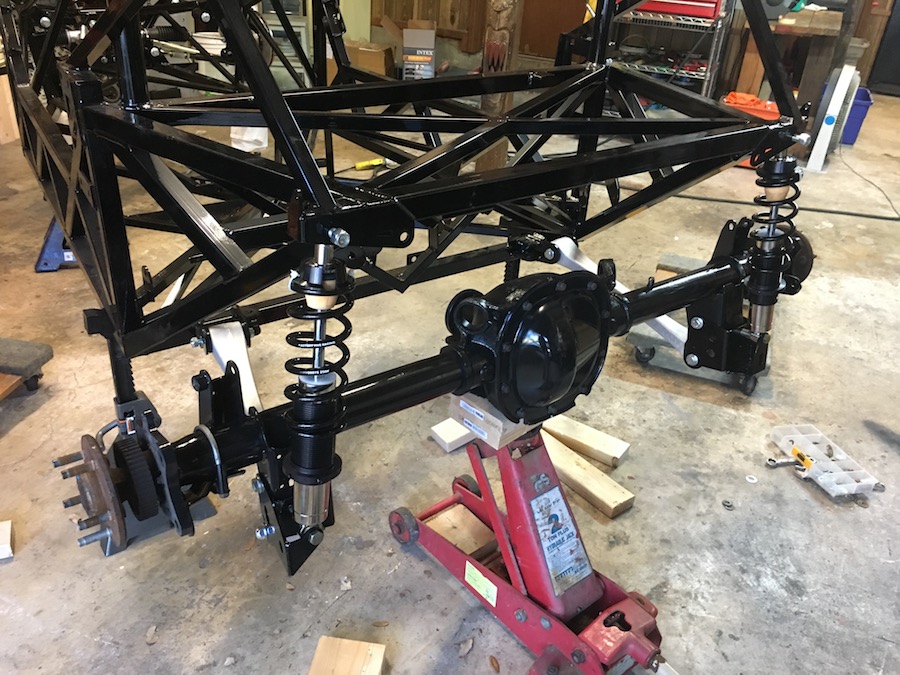

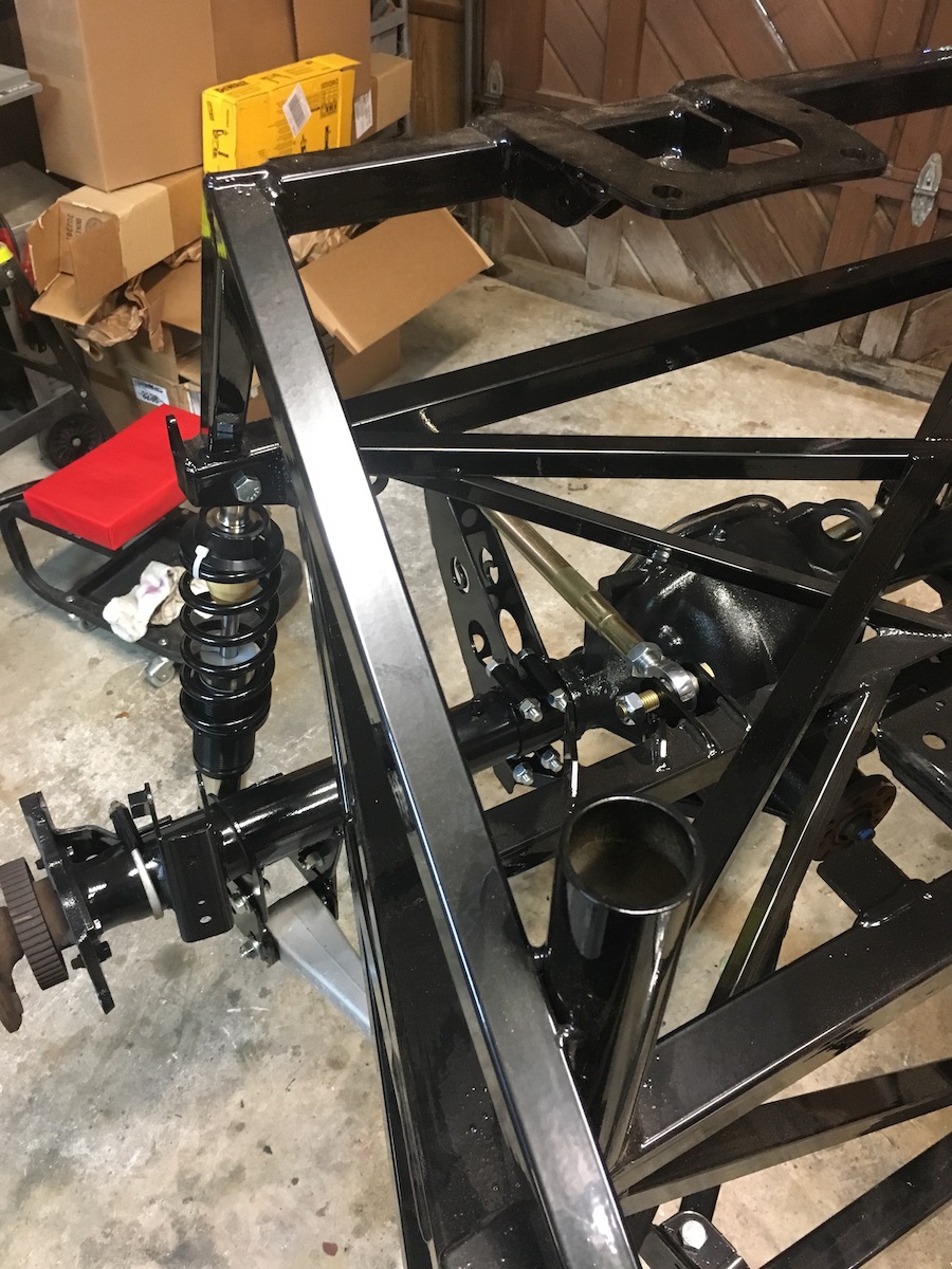

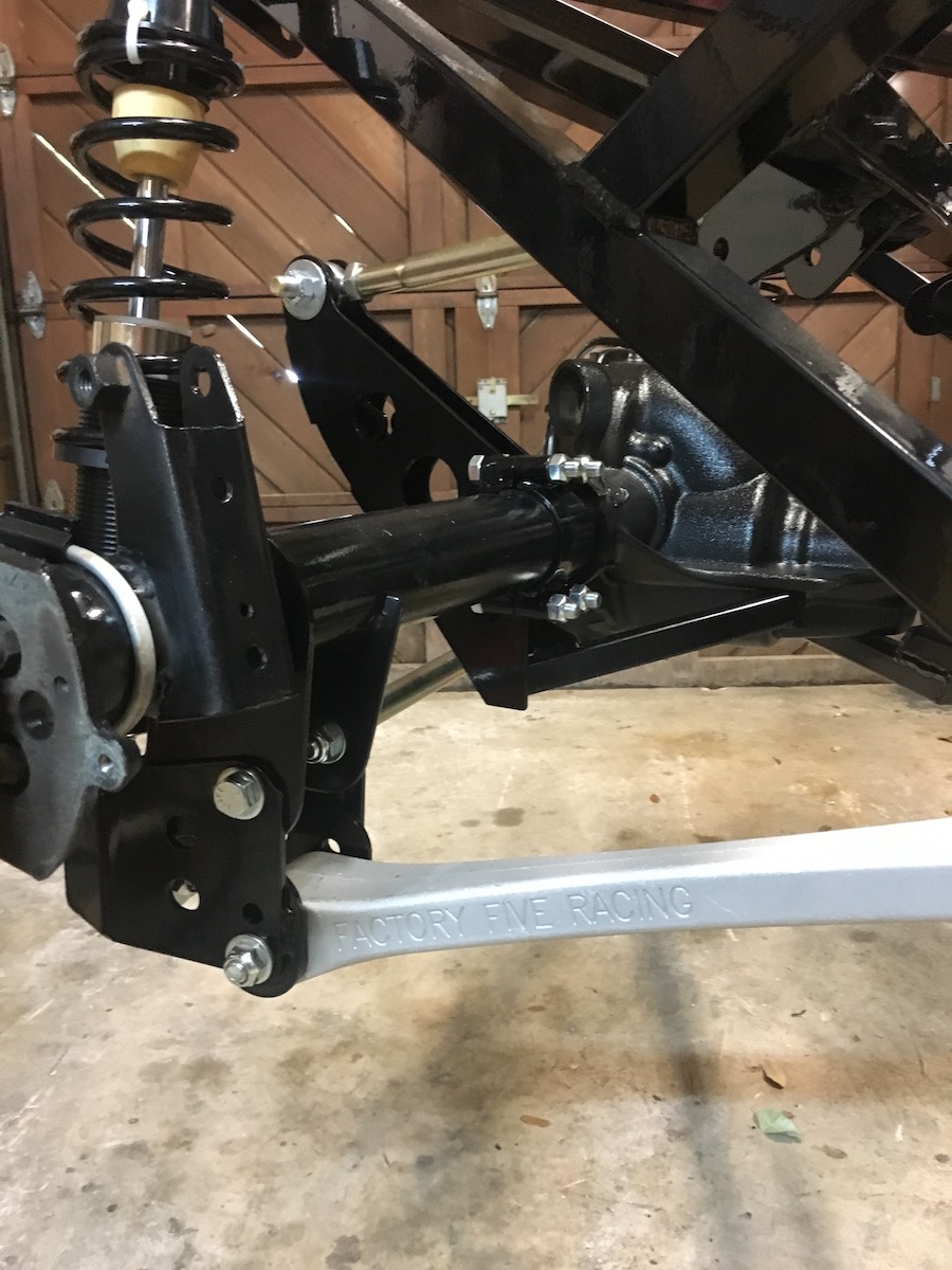

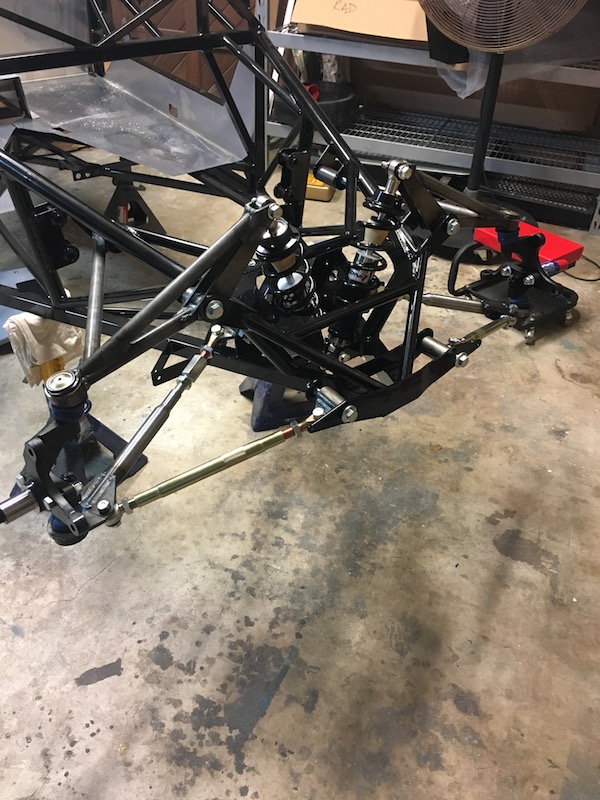

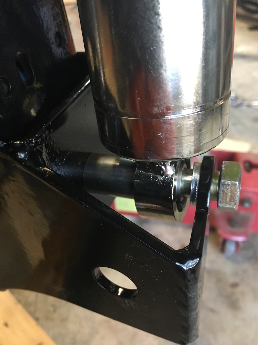

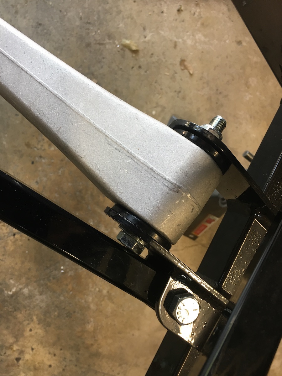

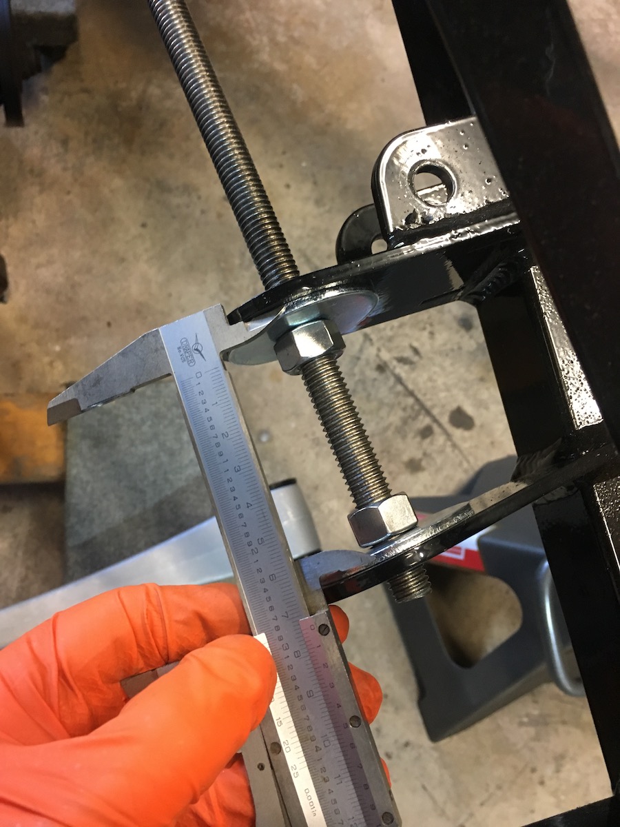

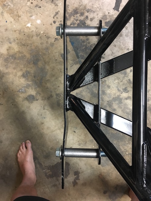

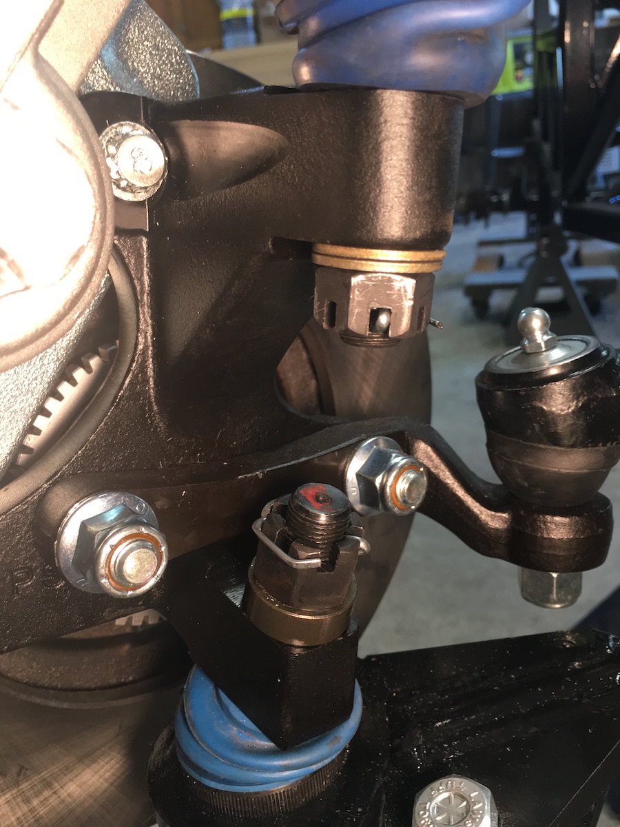

    Finished torquing up the front suspension, here showing the extra spacers I had to add to top balljoint on both sides
    I had a similar problem at the rear, on drivers side, lower shock mount. Only on that side, there was way too much gap remaining after the spacers were in, so I added two washers there too. The other side is different design and worked with just spacers
    At this point I have to say that a homemade spreader "tool" is super useful - I've used it many times already on front/rear suspension. I have a 3ft 1/2" threaded bar, nuts and thick 2" washers that I've used to open up most of the attachment points. Some are WAY too small, the worst so far being the chassis mounting of rear LCA - over an 1/8" too small. I open it up maybe a 1/8" bigger than needed and it springs back 1/16", then I snug up with bolts.
    Fitting the rear on my own was interesting - when it falls off the jack (and it will) I made sure to have a backup underneath it. It's a big heavy mofo, but it's in there now, and tomorrow it'll be on to the 3 link.
    Last edited by RoadRacer; 05-07-2017 at 07:38 AM. Reason: oops.. lower shock mount, not LCA
    Love the idea for the "homemade spreader bar". I had the same issue with most of the attachment points. Must really pull in during the welding process.

    It will be a roller soon! Nice spreader bar.
    haha, yes! I have no wheels yet, so I'm going to make some MDF circles the right circumference as the planned tires and bolt them on.

    Installed the 3 link & panhard today. Lots of farting around with the bolt-on 3-link bracket - the front and back bolt holes were nowhere close to aligning, so I used the drill press to redrill in a straight line. You can see the original misalignment at top left in pic below. I split the difference and drilled all four holes out straighter.
    That, and the customary 'spreading' and I got it all together. The panhard support was awfully close to the bolt head at front of the LCA though. I had to persuade it to get in.
    Good time to call it quits for the day..

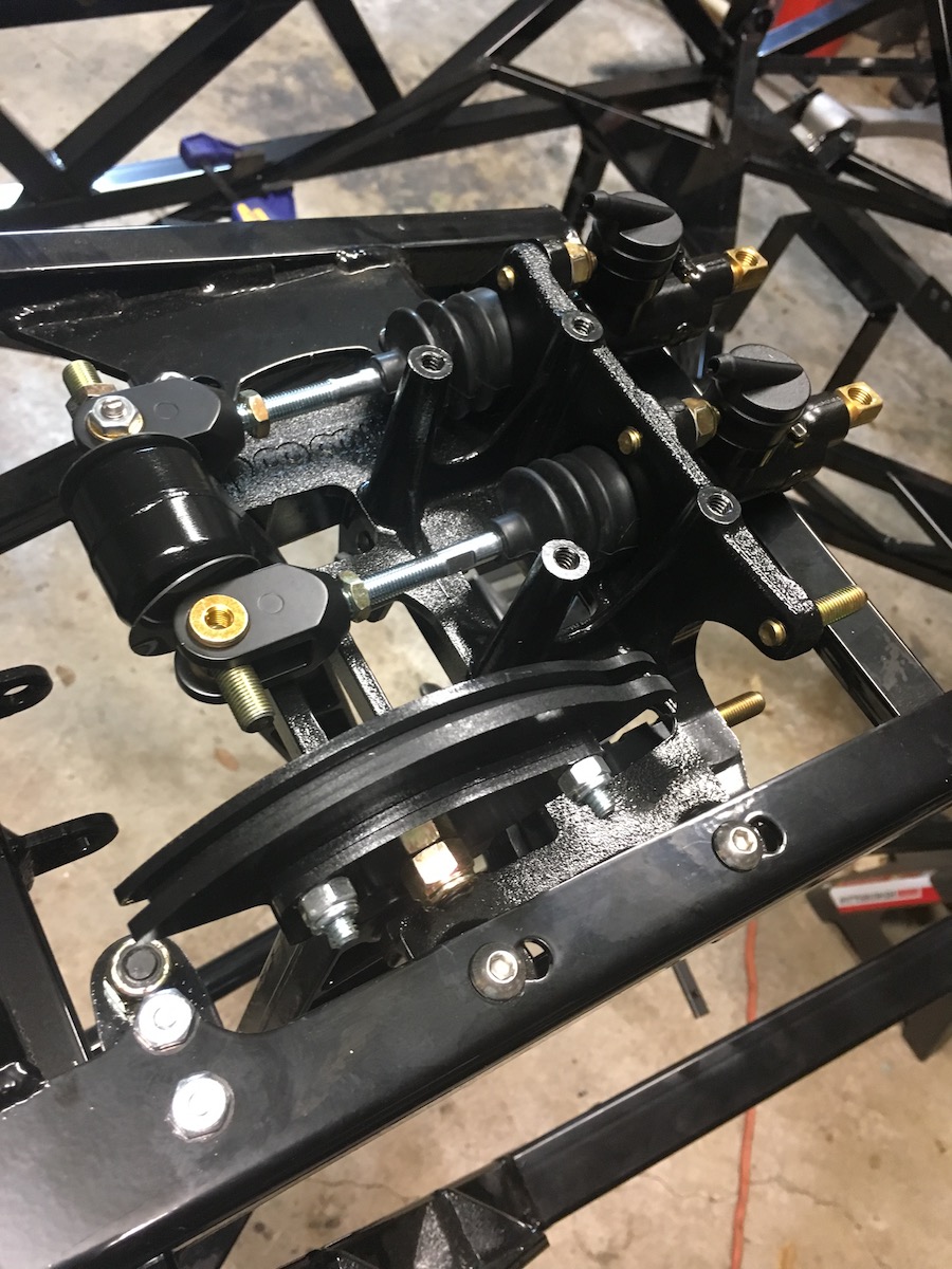

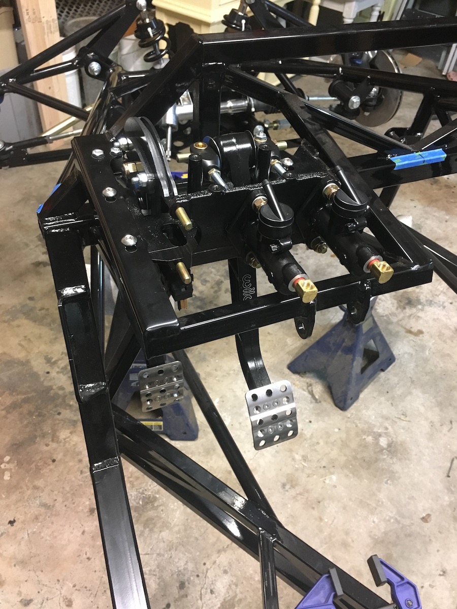

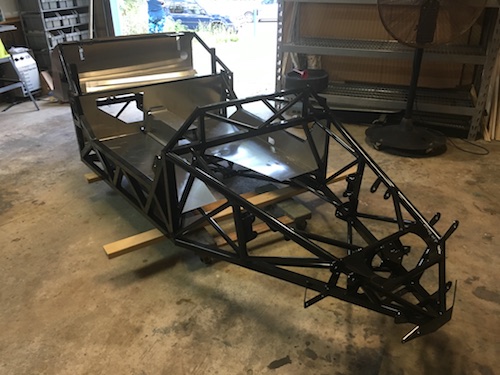

    First, drilled the banana bracket brace hole, and bolted it up.. kinda. Turns out the supplied bolt is a little short so I'll have to get a longer one. I have ordered VPM's banana top brace too so I'll install that when it comes next week.
    Then I dropped two center marks at front and rear of cockpit square.. I'll use my laser to move that onto front/rear subframes later. I already used the center mark when measuring the firewall.
    Next was pedal box.. got that all assembled (using the clutch cable setup) and installed to chassis. Yes I had to definitely grind the cast line off the pedal to get the clutch cable thingy to fit!
    Lastly I trial fitted the firewall and lower panels a few times to get them all lined up and centered. Marked the holes and waiting on #11 bits to arrive. I'd only ordered #30 and 1/8 clecos.. forgot the #11 and 3/16..
    Oh and somewhere in there made a fun embarrassing post about the steering flange Duh
    http://thefactoryfiveforum.com/showt...980#post281980

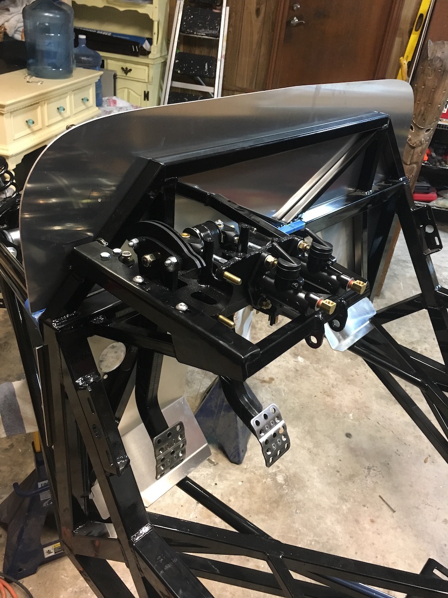

    When installing the pedals I had to retap two out of the eight holes. Felt like it was cross-threaded going in so I didn't want to take the chance. A quick tap and they went in smoothly and tightened nicely. Used red locktite.

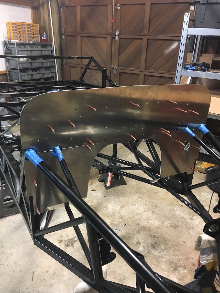

    Drilled and cleco'd the firewall - done with 1/8 until the 3/16 come in the mail.

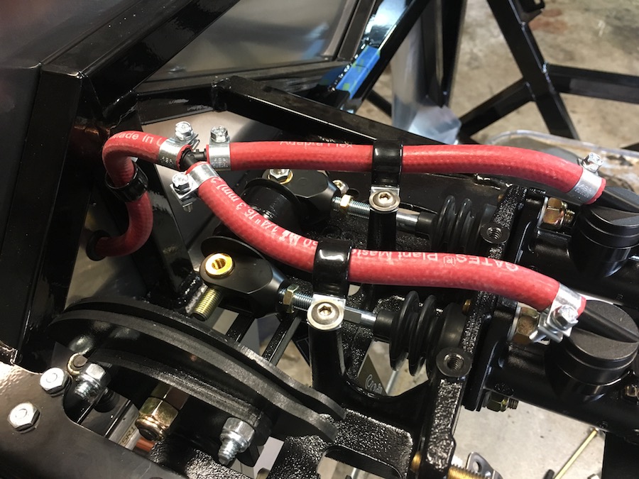

    Had a few hours yesterday to fit the brake reservoir and plumb it in. Since there are no instructions about *where* to put it (exactly) I browsed the threads and hopefully put it in a place that won't cause issues. Far enough away from clutch cable, low enough(?) to not hit body - but without a body to look at that's hard to be sure of!
    I didn't want/need it inside the car so had to run off to Harbor Freight for a grommet kit.. was a little surprised a grommet for the firewall wasn't included though. Or perhaps it is, but I must have missed it on the inventory.
    Got the lovely http://vpmcobras.com/ banana brace kit installed. So happy with this, it fit like a dream and now finally I don't have to worry about this banana bracket.
    Lastly, attached the steering flange, and now the next task is the brake lines that I've been naively looking forward to. I'm going to start by trying to use what was supplied but all this talk of eastwood flare tools and NiCopp brake line makes it appear that almost no-one uses the supplied parts.
    I'm taking that as a challenge!

    P.S. seems the rule is to tap everything! This seems obvious given the powder or paint coating, but I'm glad I'd bought a tap/die set to run through everything. The bolts in the pedal box acted like they were bottoming out in the hole.. quick tap and they went in beautifully.

    Quote Originally Posted by RoadRacer View Post
    Your brake fluid reservoir will not function properly. The bottom of the reservoir should be as high as the hose to the MCs. Also, is the hose intended for use with brake fluid? Others have found out that fuel hose or air hose will disintegrate when exposed to brake fluid.
  38. #37
    Moderator
    RoadRacer's Avatar
    Join Date
    Oct 2011
    Location
    Manor, TX
    Posts
    2,245
    Post Thanks / Like
    The hose came with the brake master cylinders and is positioned like most people's reservoir that I found.. and the manual. any higher it hits the body (apparently).. but ok I'll ask FFR for more info.
    James

    My thoughts were that the TOP of the reservoir and fluid must be highest point. Which they are. Wrong?
    James
    FFR33 #997 (Gen1 chassis, Gen2 body), license plate DRIVE IT says it all! build thread

    It all depends on the top of the fluid level, the reservoir is secondary to that. As long as your fluid level is higher than your hoses and masters it will gravity feed as it tries to equalize levels. (source: am engineer, but its been a while so feel free to disagree) Yours should be fine RoadRacer, but you will have to be careful since a little bit of fluid drop will put it your fluid level below the hoses and create a potential high point that wont gravity feed your masters.
    As I type this I am thinking I need to go double check my hoses to make sure I am not getting any high spots and that I have taken my own advice! I mounted it in a similar location, just a bit higher. I would post a picture, but it keeps giving me an "upload failed" error.
    I went Tony at FFR with the same question and he said that mine should be fine...IMG_3420.jpgIMG_3621.jpg
