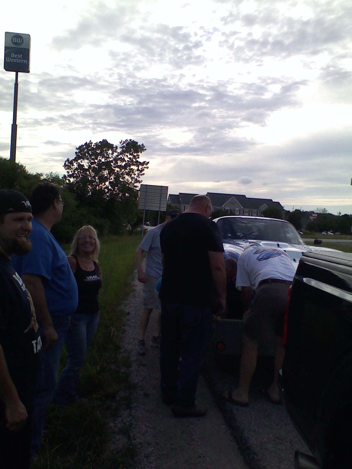

    We got 4 blocks from the hotel in Columbus OH and the coupe died on the exit ramp. It would turn over, but not start. I tried several things, but nothing worked. Then I had Lynn get out to push me off to the side of the road ... Fortunately, some lady in a business suit stopped and the two got me onto the shoulder. Next, I texted Mark D, for his suggestions. Nothing worked there. He texted back after awhile, "don't go anywhere, we're sending the calvary". Phone rings and it's Henry Renaud. Then a truck and trailer with four people(Henry, Frank W, Karen S. and Dean ) show up and push me onto a trailer (Lynn got an education on not pushing on Millers perfectly molded tail fin!). Mark and Brendan showed up on the ramp and we had a party. To Henry, Frank, Karen, and Dean: "Thank you, Thank you, Thank you......" (This folks, was very humbling...)

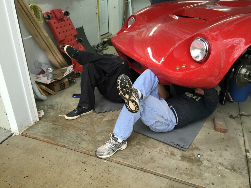

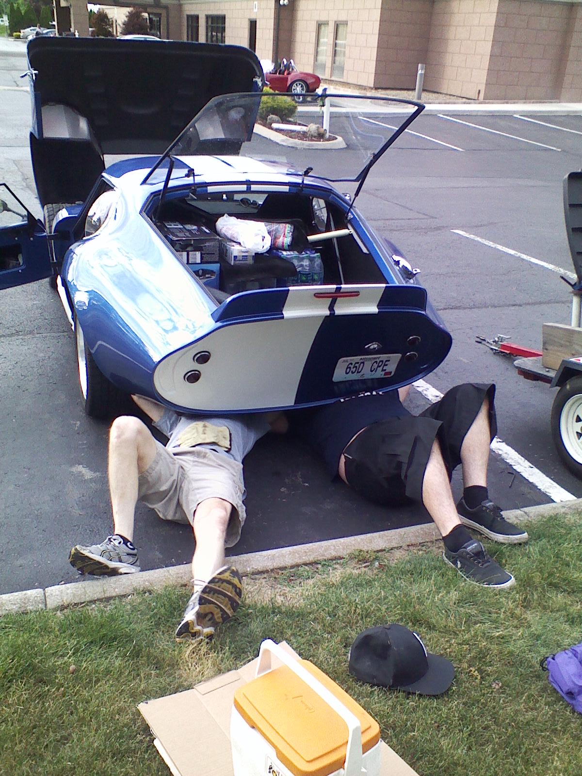

    The concensus was that fuel was not flowing, so Brendan and I started chasing down the problem. I'm the good looking one on the left!
    Lynn thought this picture was hysterical because Brendan and I had met earlier on the build phase!

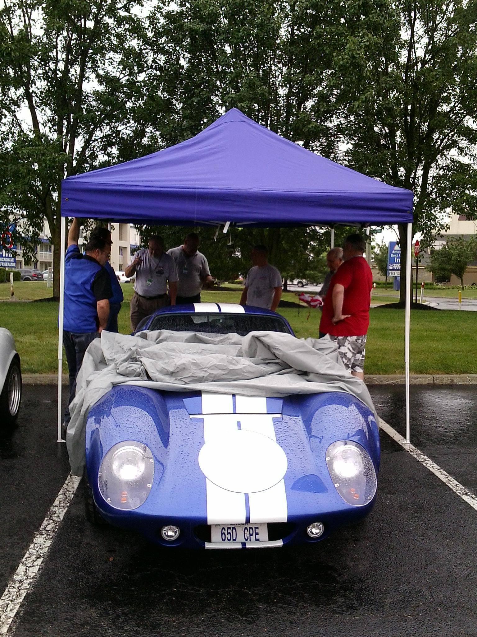

    Then, the 30 hour tropical storm came and it started raining. So Henry and Dean brought over the NAPA tent. While Brendan and I continued with the car, the Thursday happy hour moved over to the tent. Miller joined in and gave us his sage advice.

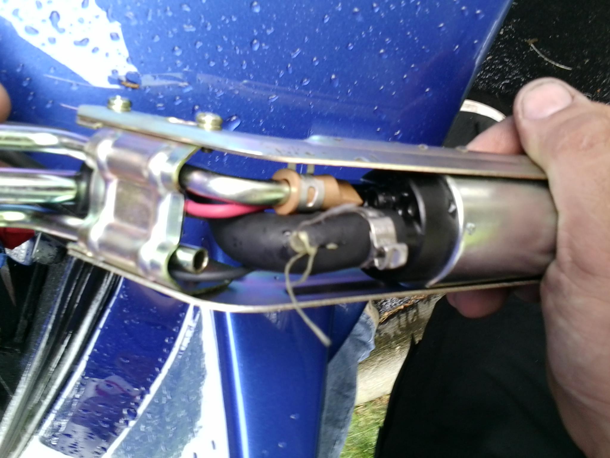

    The culprit was the fuel pump not working. More specifically, the rubber feed line of the in the tank pump was split. Furthermore, it was not a gas impermeable hose. (China origin). This kind of thing, kind of really hacks me (enough said). Here is the hose.

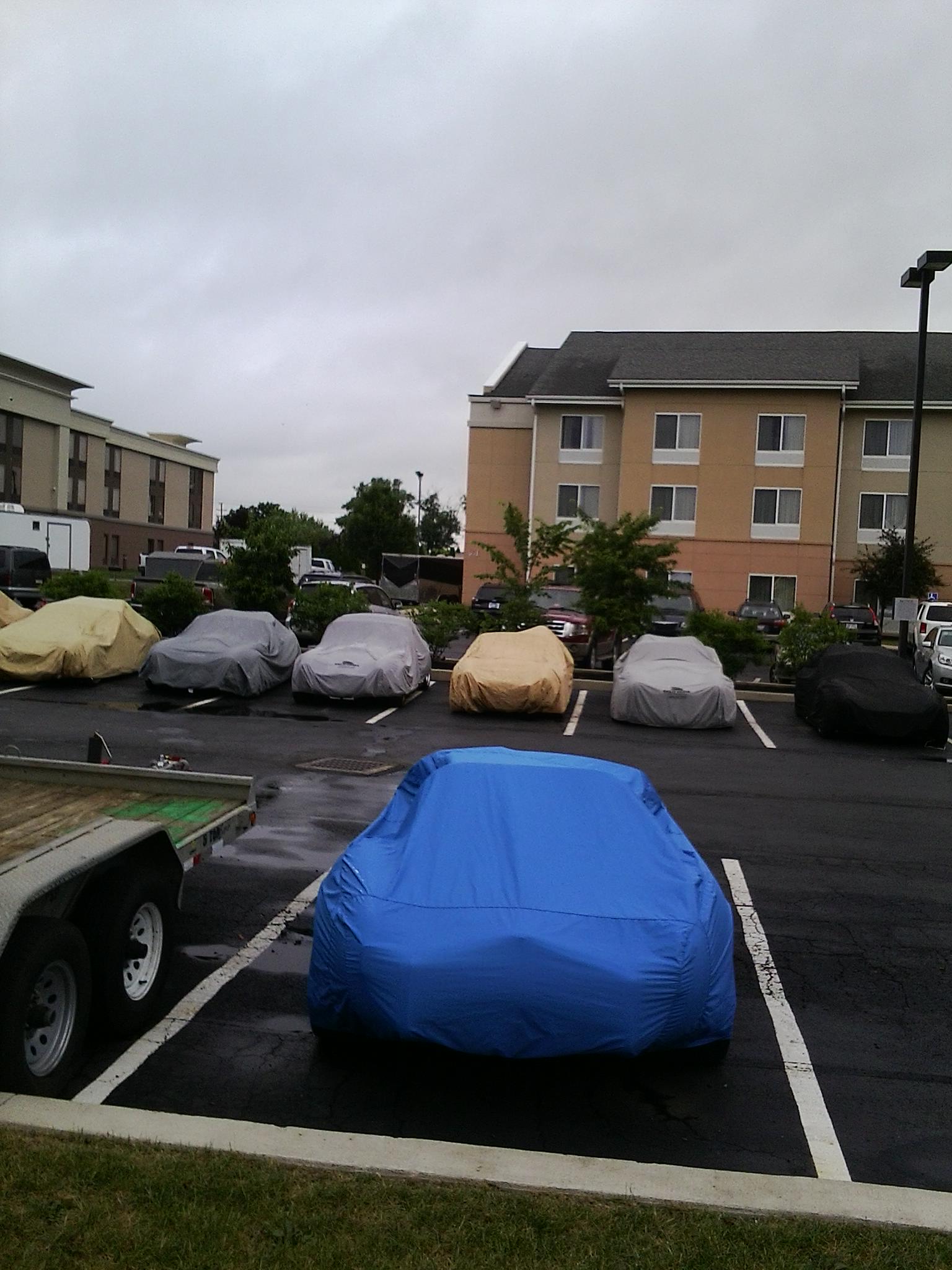

    Everything got tucked in for the rainy night. For those that have never gone, there are three hotels together, with all their parking lots like this.
    The Ohio Cobra Club does an outstanding job in organizing this. There is even continuous security at the hotels.

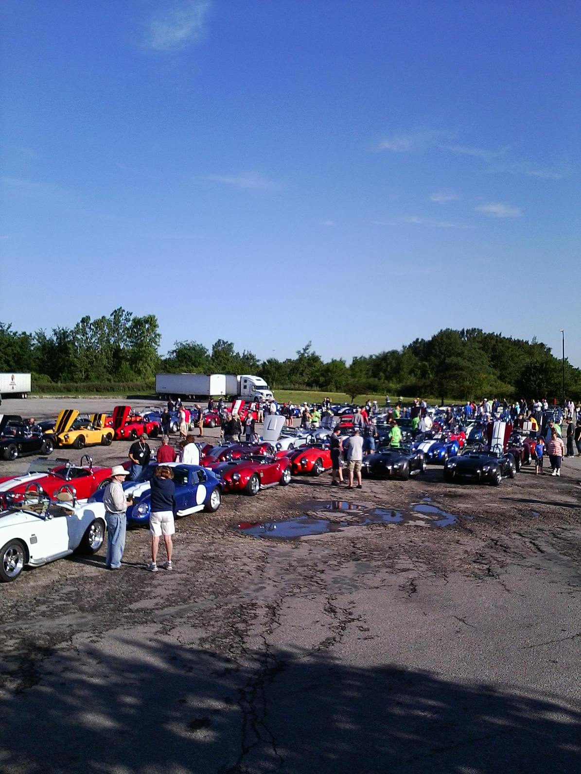

    Saturday morning most of the cars lined up at the Speedway Truck Stop prior to the parade into London. This was a real highlight for me. You have a hundred cobras, it is real laid back, coffee while you wait, you can see any car and talk to anyone.... A great time! Here is what that looks like (Fortunately, Lynn in khaki shorts in the foreground didn't see me balancing on a railing to get this picture.
    When the Highway Patrol says "Okay, get ready to go...", a hundred cobras fire up. Now that is pretty cool!

    Nice write-up about the London show and your pump repair. I watched the Dougherty boys do their magic while under that cover in the pouring rain. (In the picture, but I'm not admitting it...). That's the second failure I've seen of that piece of tubing, in my limited experience. Something to check for sure. Nice to meet you and loved the Coupe.

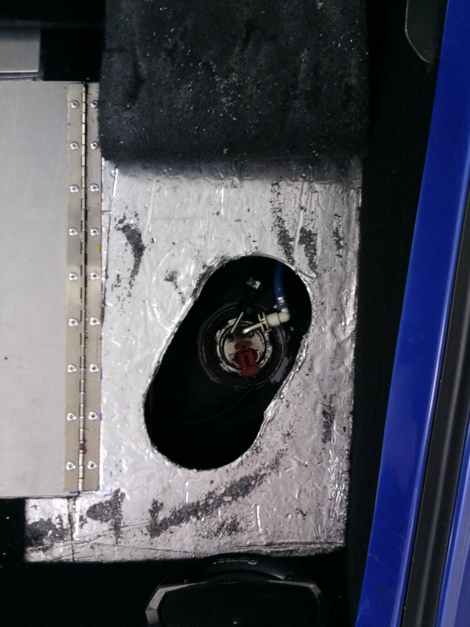

    Interestingly enough I had the same fuel hose issue when I first put my coupe on the road. Did you drop the tank? I ended up cutting an access hatch in the rear floor.
    11,145
    Quote Originally Posted by Timb View Post
    The patient underwent some surgery and received an access hatch. Not a particularly good spot to be dropping the tank, especially heavy with fuel in it.
    Yes, we "did some surgery" in the parking lot. We raided the Salvaggio mobile workshop (thank you) and came up with a cordless drill and five inch hole saw bit (another lesson in being prepared). Funny thing, I could have sworn I marked and cut an access panel during the build, but I sure couldn't find it (definitely, this is something mandatory that should be done on the build). Anyway, here is what we did.
