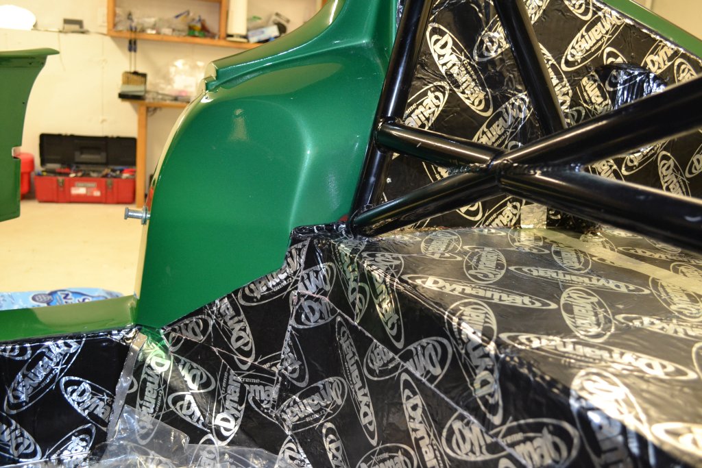

I bought the pre-cut carpet from FFR when I ordered my kit. After reading some posts and learning that the kit didn't have a piece to cover the sides of the trunk, I ordered an additional 2 yards of carpet from FFR. I needed up needing it all. Between the sides of the trunk, the inside of the doors, and various mistakes (ie. tracing wrong side of carpet, not sticking in the right spot and having to rip up, cutting too much) I used it all.

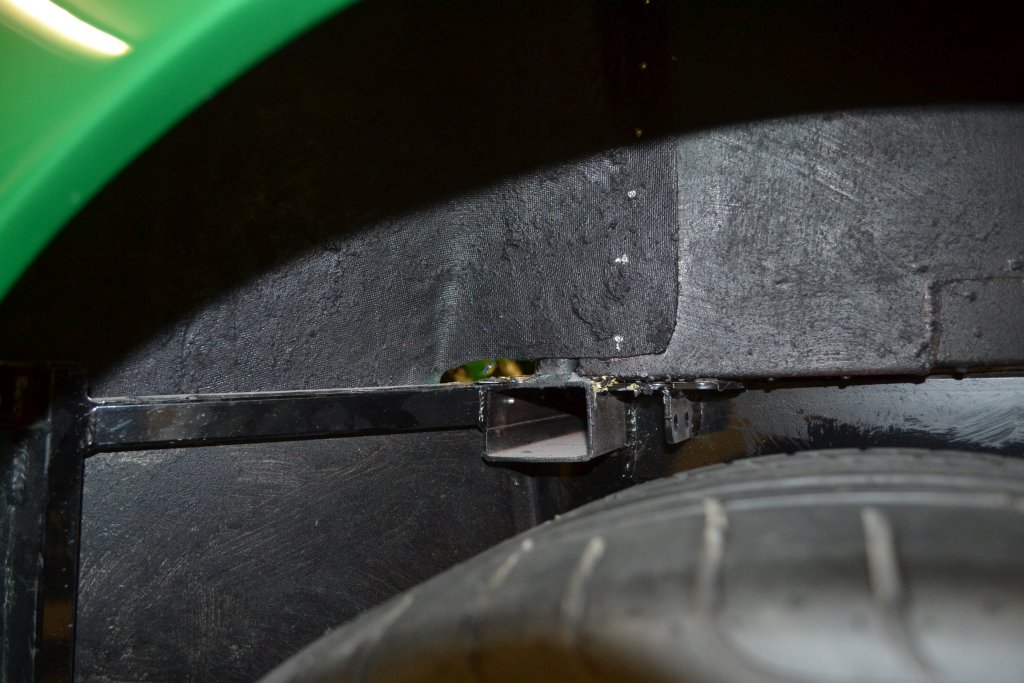

Before starting the carpet, I needed to rivet the trunk aluminum sides to the body. This closes the gap between the outside and the inside. You can see the rivets to the left of the round tube. Also needed to patch up the holes between the body and the frame behind the seats.

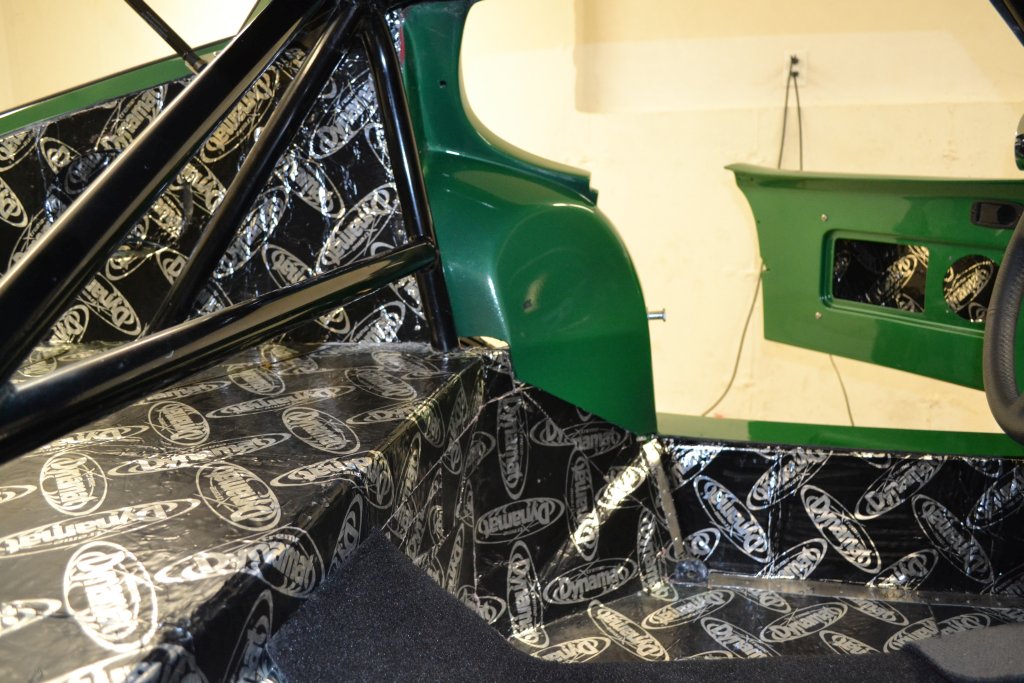

I bent up some aluminum and riveted it in.

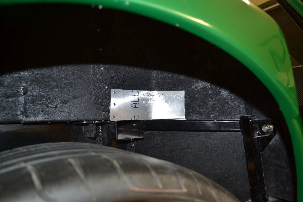

Then built up the inside with dynamat to make it flush with the rest of the dynamat

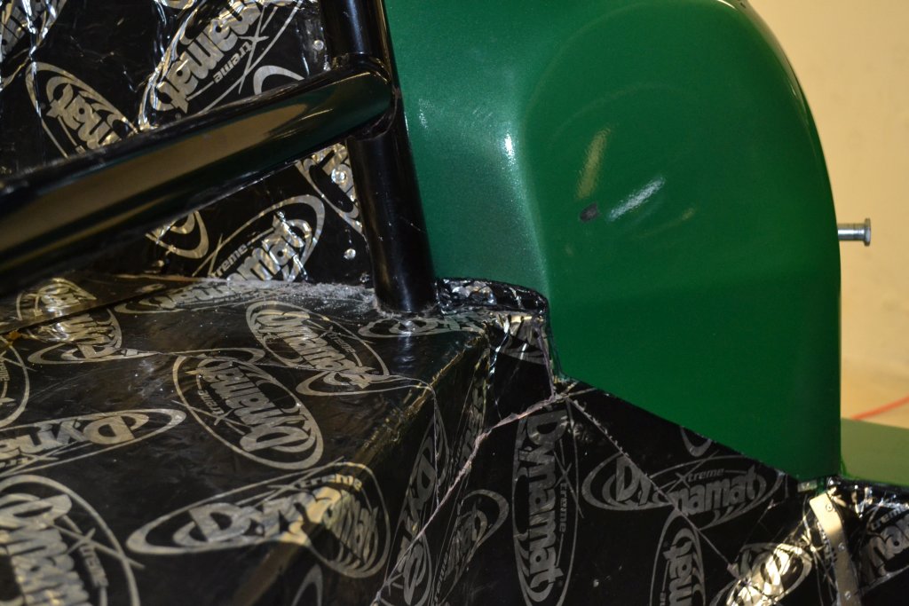

I did this on both sides.
