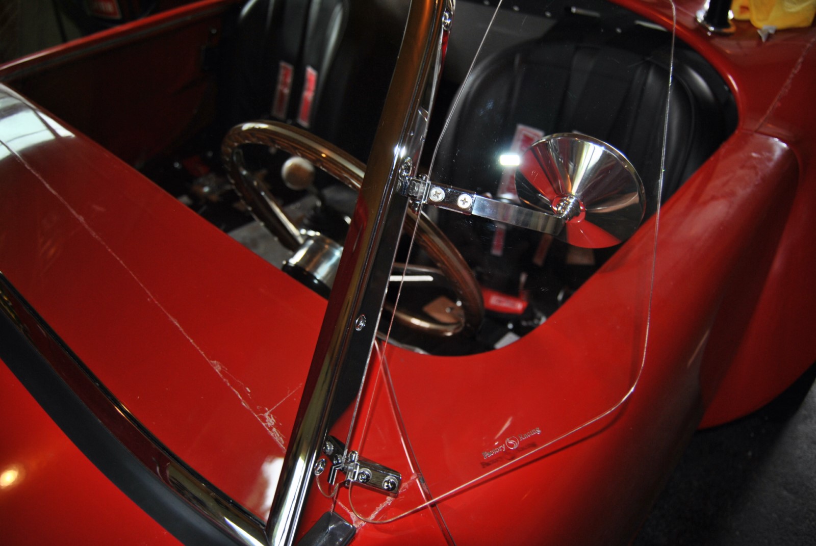

    I made a small plate that screws to the windshield post. And then found a motorcycle mirror.
    https://farm5.staticflickr.com/4434/...c733b571_m.jpg
    Nearly all motorcycle mirrors have a stud attachment so there is a huge world of styles available. Positioning it high helps a LOT. Mounting a mirror on the front fender gives a great view of the huge rear fender and not much else. Trying again to get a larger image.
    http://farm5.staticflickr.com/4434/3...c733b571_b.jpg

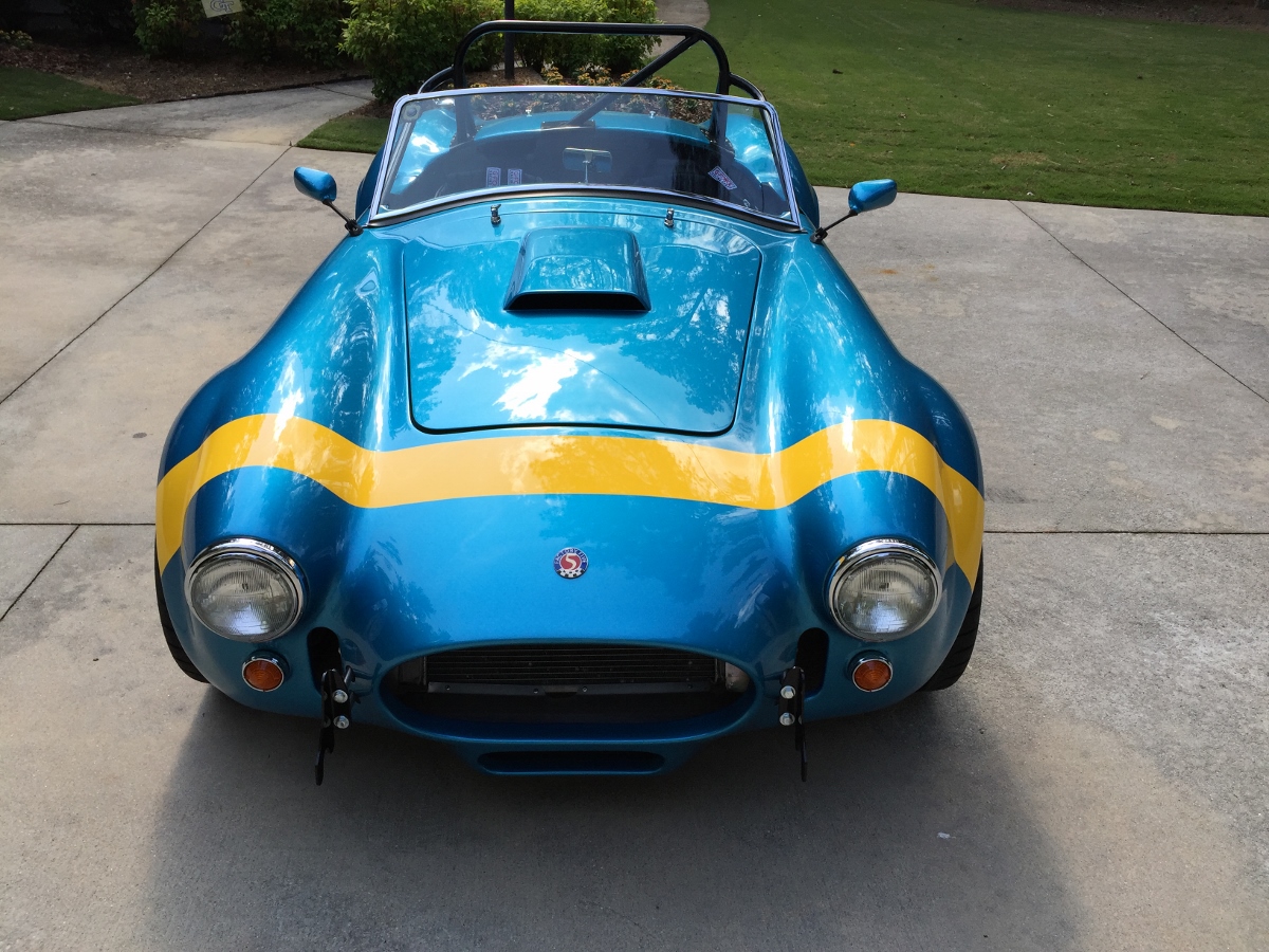

    The mirrors on my challenge car are rather non traditional but work very well and are inexpensive, as well. The mirrors are slightly convex so they have a great field of view. They are Kawasaki motorcycle mirrors. They attach from the top and you can reach in through the side louvers to attach locknuts.
    Albuquerque, NM
    Quote Originally Posted by Garry Bopp View Post
    Garry,
    interesting, do you have a closeup picture of the mount and arm? I'm not building a period correct car by ANY stretch of the imagination, but I'm at least trying to keep a certain "look" and I'm wondering how those blend in with the car.
    -TJ
    TJ,
    Here's a link to the mirrors:
    https://www.walmart.com/ip/Krator-20...&wl13=&veh=sem
    For that price, you can just order them and if you don't like them, you've only lost $14.00!
