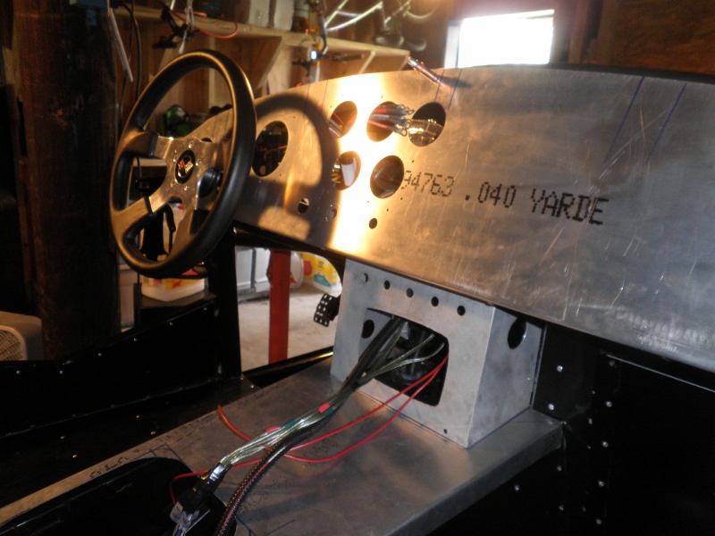

    Anyone, Is there a source for pre-bent sheet metal to go around the dash support offered by FFR? I'd like to use the sheet metal fro a couple of switches and possibly a radio...

    • Aluminum door sill kick plate will work.
    • I used it for my under dash support, which holds my speakers, fuse block assembly and my radio too.
    • You just need a sheet metal brake to make your parts which can be purchased at Harbor Freight.
    • Hope this helps.
    Under dash pics from passenger side of car:
    http://thefactoryfiveforum.com/album...chmentid=51762
    http://thefactoryfiveforum.com/attac...4&d=1458505006
    This is the brake that I have and it works well for small stuff:
    https://www.harborfreight.com/18-inc...ake-39103.html

    I think what you are looking for is a "console" As far as I know, no one is making one for the Cobra. Very simple to make though. I made patterns out of cardboard to get the shape I wanted. Then transferred it to aluminum.

    An under-dash panel is a good spot for a couple switches. I used a piano hinge to attach it to the frame, (so the dash can still be dropped down), and attached it to the dash lip. It helps make the dash much more solid too. No bending required.

    If this is what you are looking for Whitby has pre-made panels that rivet together or you can bend your own. Box is just 3 sides & easy to make.
