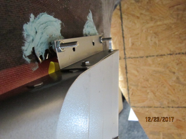

    I captured the studs on the mounting brackets with nuts on each side, determined where they would attach on the inside of the body centered in the pre-cut opening, roughed up the body with 60 grit paper, and bonded them in place. I used rubber bands looped around the louvers in two places and held in place by paint sticks while the HSRF cured. The clothes pins helped hold the rubber bands while I fed the paint sticks through. I only had used paint sticks on hand. Nice. One of the colors in our family room and not sure about the other one...
    Once cured, removed the louvers and the studs are bonded in place for good. Used a Dremel to clean things up a little and added a little more HSRF in any voids. Then trimmed the bolts to have a more reasonable length.
    Re-installed the louvers.

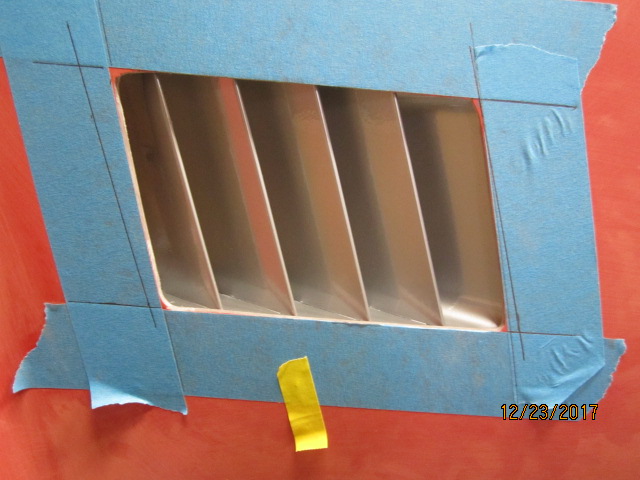

    Now for a very important part. The precut openings were reasonably close, but not finished products at all. Drew parallel lines top and bottom. Then drew lines on each side parallel with the angle of the louvers. This is a critical step and IMO makes the difference between a pro looking job and one that isn’t as much. Also, ideally the width between the last louver and the body on each side should the same as the width of the inner louvers. The louvers weren’t quite long enough, but got them close.
    While doing the final fitting, I noted that the louvers didn’t fit flush against the inside of the body. Further review showed the rear part of the louver is too high. I trimmed them on my disk sander until they were flat. Roughly in the area noted here. The sanding removed the powder coat on the edge, but it’s inside against the body and doesn’t show.

    As shown in EdwardB's pics above, the key is to get the positioning and the shape of the openings right in comparison to your louvers. Done properly and the look is seamless - especially if painted body color.

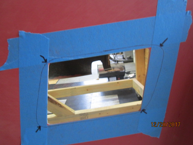

    Think I got it now. Since there is 1.5" spacing on the fins, the forward and rear area needs to have the fiberglass trimmed up to make the opening better to look at. The faint pen marks forward and rearward show the area I'll plan on trimming up. Following Edwardb's logic I agree the opening needs that trimming. Sheet metal screws used to hold the aluminum bracing on, will replace with SS button screws

    Small drum sanders on a dremel work great for cutting the corner radius.
    Looks like you're on the right track - can't wait to see the finished product.

    I think this is much better. Possibly may finesse the opening just a bit (think the lower R line needs a little more off) but I think it looks better. Seems like its one of those things the more you look at it the more its off? Powder coated the grill with what's called a chrome, really it's more like ceramic coating with a clear coat, but I won't have to worry about oxidation.
