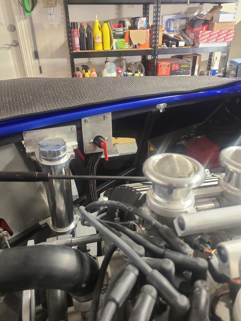

    Finishing up the wiring. I am going with the Breeze box up front for the battery. I have a cut off switch mounted under the dash. My car is very basic, with very little "extras". I have a clock in the dash and an outlet under the dash for USB/charging. Nothing else added electrically (yet). I will be wiring in some reverse/backup lights, and hopefully a third brake light, and the FFR wiper kit, but other than that pretty plain build. Carbureted 289, in-tank fuel pump, so EFI is not an issue.
    That said, I am stuck on how to wire the switch. I would like it to kill as much as possible, but obviously the clock needs constant power.
    I've ordered a 5a auto reset breaker to wire across the kill switch.
    In my seriously taxed brain, the clock should probably have a home run from the battery? Or from the positive pole of the kill switch (closer)? I wired the dash awhile ago, and don't remember where I pulled power for it in the provided wiring harness, but the dash is coming off for final fitting, so I can rewire the clock.
    I'm confused....
    I appreciate any help on this.

    I put a battery disconnect in the engine compartment, the theory being I can lock the hood for a little added security. Now if I can only find the keys to the hood latches....
