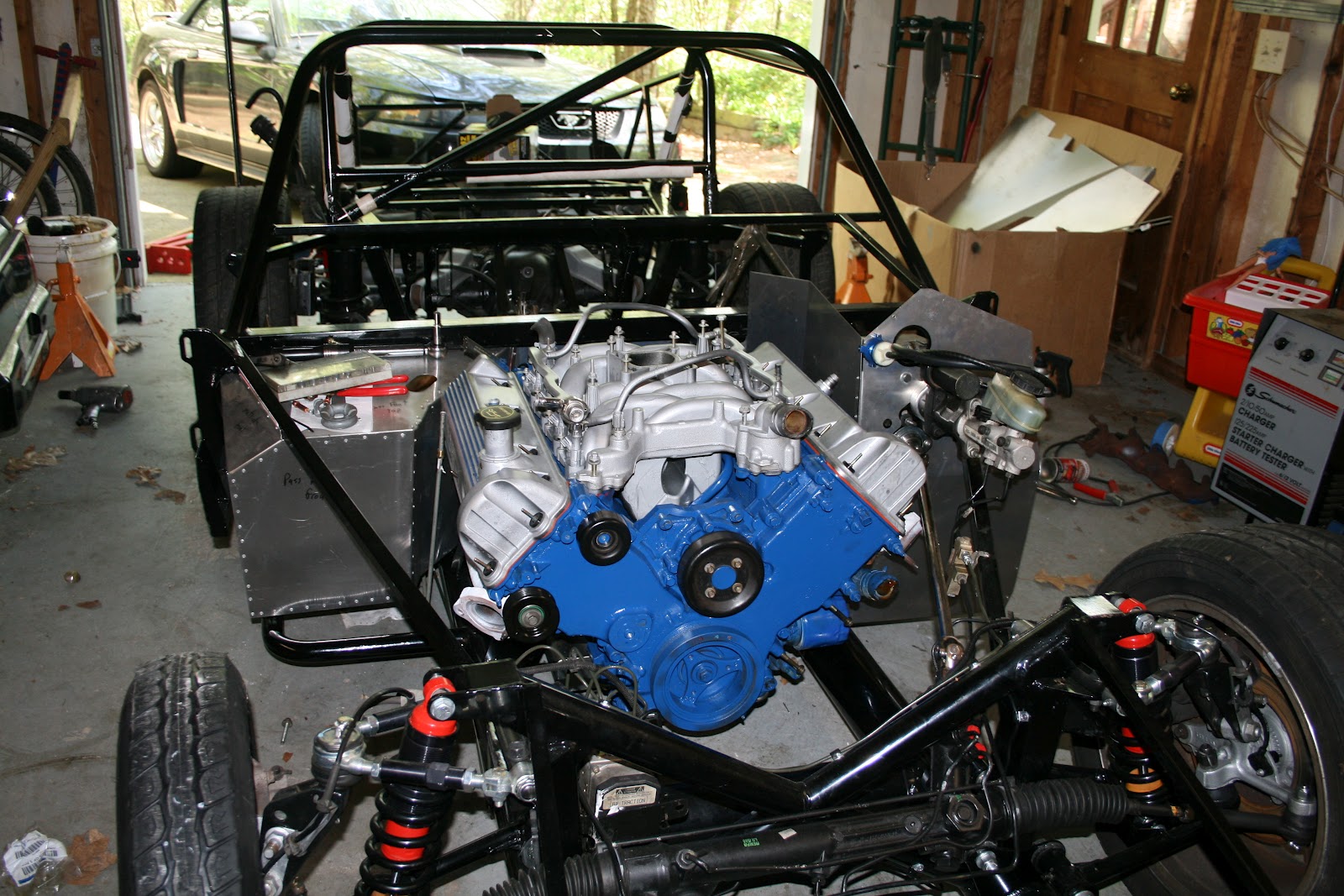

    Wlecome to the forum. To put a finer point on what was correctly stated above, the old Windsor 302 engine, with the 8.2" deck height, fits perfectly, with this very minor caveat: some EFI manifolds will interfere with the hood due to how it slopes between the front fenders. I imagine you'd also have trouble with certain tall intake/carb/air cleaner combos.
    The 351 Windsor also fits the frame, but due to the increased deck height of the 351 block, there are additional intake/carb/air cleaner combos which will not clear the hood.
    To the best of my knowledge, the various Ford modular engines (SOHC, DOHC, 3-valve, Coyote, etc.) will all fit in the frame just fine. However, you have to widen the aluminum footboxes on each side to clear the massive cylinder heads on these engines. Also, one of the most knowledgeable participants here (Karen S.) has noted that the new Boss 302 intake will probably not clear the hood on a Coupe. So, the long story short is that outside of the 302 Windsor, there are minor, and not-so-minor, fitment issues with other engines.

    The SOHC really wasn't that much work. I just used the modular roadster drivers foot box aluminum and slightly modified the passenger foot box. Powersteering, AC and hydroboost all bolt right in place no interference
    More photos an video found here http://homeschoolcoupe.blogspot.com/
