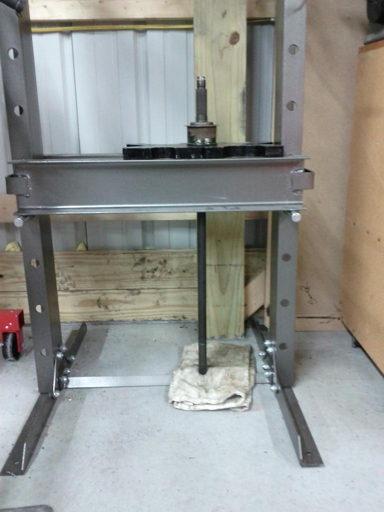

    It occurred to me - hammering on the housing to knock it off the shaft includes trying to accelerate the mass of the housing before anything else happens. Why not get things in motion first and let the shaft's inertia end the matter. Over all this has potential for less excitement. In fact after doing some, it gets to be kinda-fun! As always, care and prudence must be observed.
    I did hammer the first couple joints out. Worked, but a lot of effort, increasing violence and dinging up edges, etc. Also good to have a range of medium to ridiculous sized hammers (I got) as things escalate.
    By the way, after the big glops are removed with a rag, etc., grease is easier removed with solvent and small brush than wiping and pleading.
    The easy ways:
    1) Rig press plates or equivalent vertical "stoppers", put a catcher below for the drive shaft. "Drop" (you may have to help a bit) the assembly down so the housing stops and shaft can keep going. Start gentle, it won't take much probably. You could simulate this setup with some pipe and bits if you don't have a press.
    2) Why spend time setting up anything. If your workbench has the mass (3/8 x 2' x 5' steel plate here), just hold with towels, be ready to slow the shaft, and "bring it home" to the end of the workbench. Unless you have recalcitrant shaft clips, you are done in about 5 seconds per. Use the towels, glove transfers a lot of shock, trust me.
    as in:
    and
    If you really want to be nice, slip something under the axle so the table edge doesn't catch the boot grooves.
