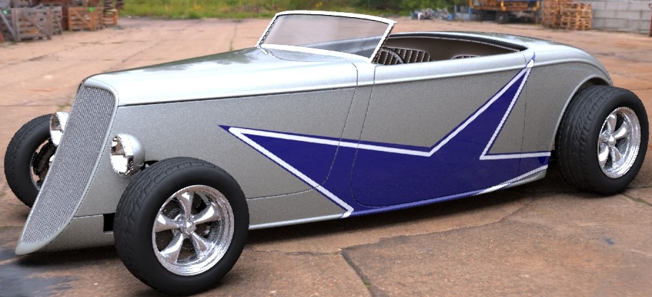

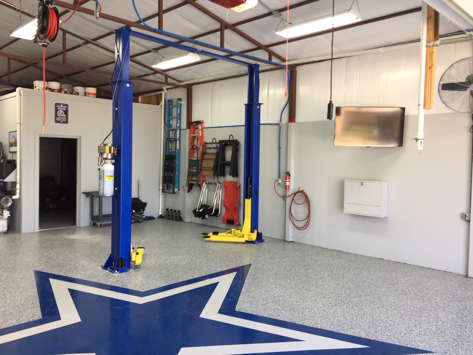

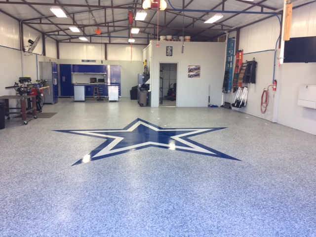

    Love the garage! Cars nice too!! Assuming the big screen is there someplace?

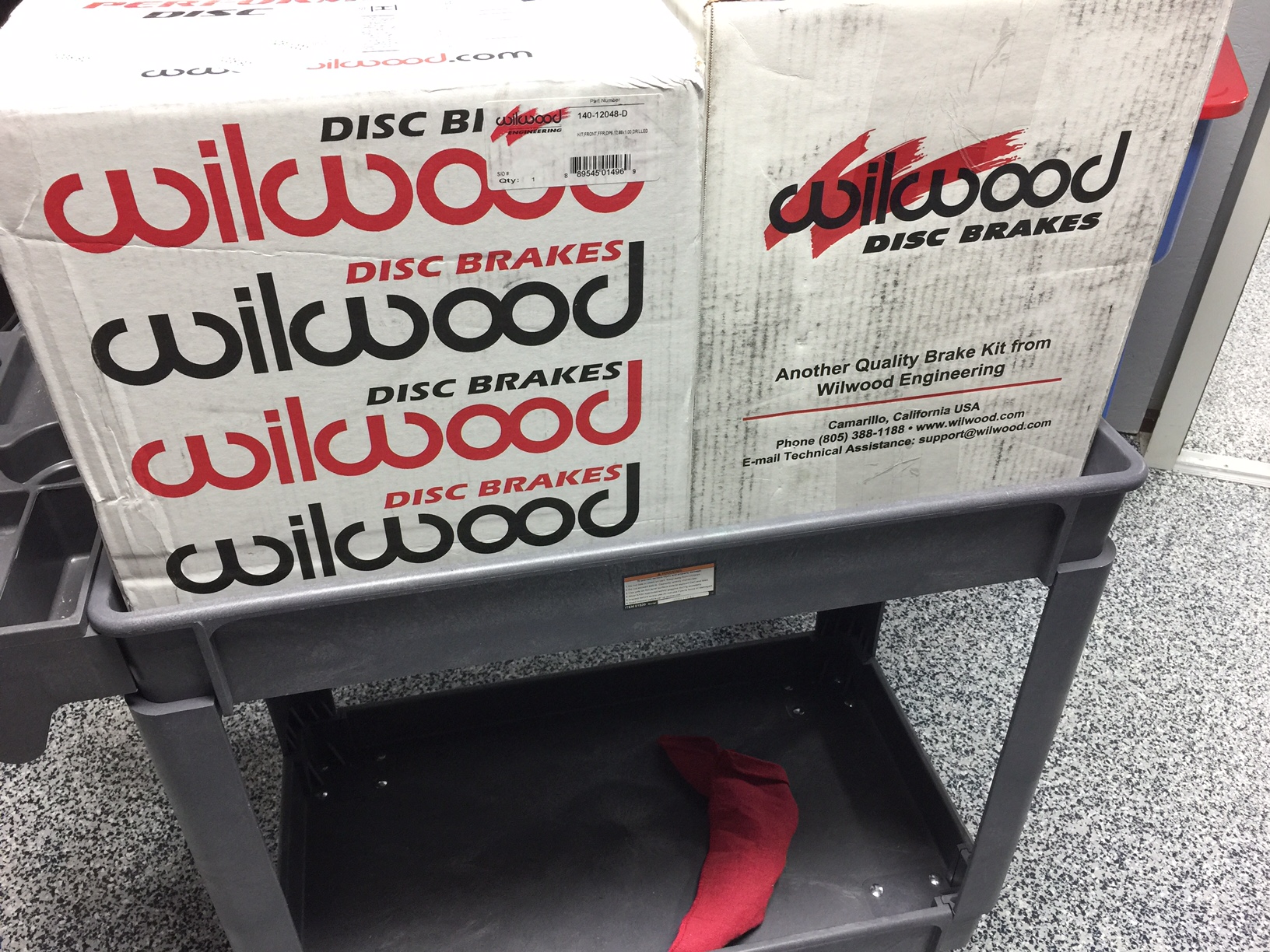

    Brakes arrived today! So is this the official "start" or "stop" of the build?

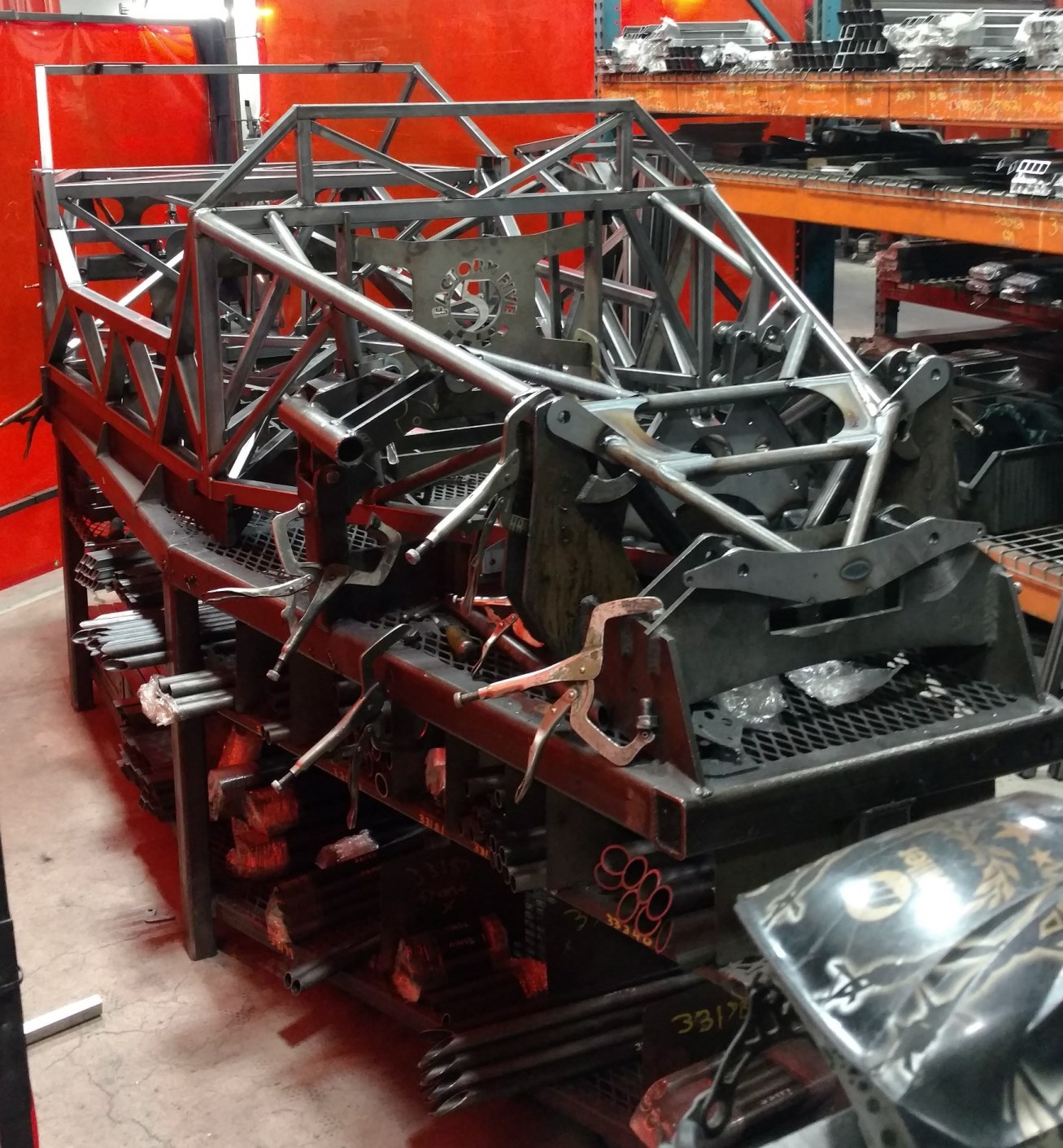

    Had Dan from FFR send me pics of my chassis in the weld jig as well...Chassis.jpg

  17. #15
    836
    Even though that jig is robust there is still a certain amount of heat draw that happens after it comes out of the jig. A lot of bars are tacked there
    then fully welded after it comes out and goes on the rotisserie. The other quirk is that the rear clip< piece behind the pass compartment is 1/4" off center. <That
    is not heat draw. The upper half of my firewall tubing was laying back 1/4" on 1 corner and 1/8" on the other. The point is you should check things with a straight
    edge and establish a centerline while it's a bare chassis and easy to do or fix anything that's far enough off to put up a fight later.
    Fun to see it become real though isn't it.

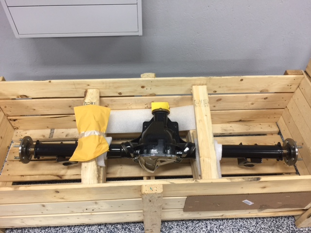

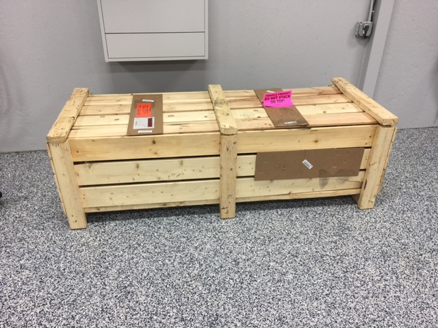

    Rearend made it's way into the shop today...My wife will be able to use this crate as my casket if I don't ever finish this build!

    Doing a little last minute prep to the shop before 33' shows up next week. After discussing with several builders and the experience at build school, I have decided to start the build on jack stands and then move to the lift after I get it rolling. Any opinions on a "good" working height for the jack stands?

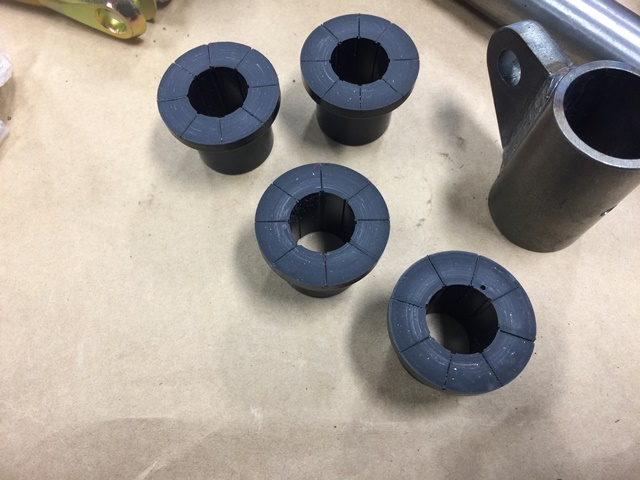

    Received my parts in from Kootenai Valley Customs this week...great parts Tim! I'm sure I will appreciate them more when I have a vehicle to put them on! This waiting is no fun.

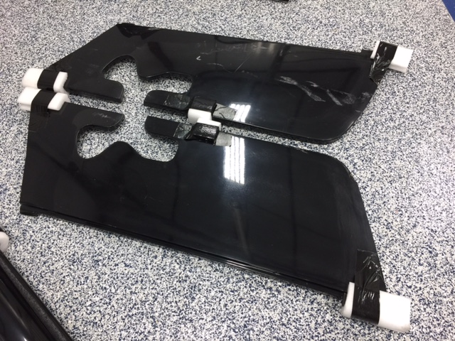

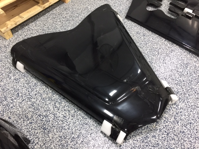

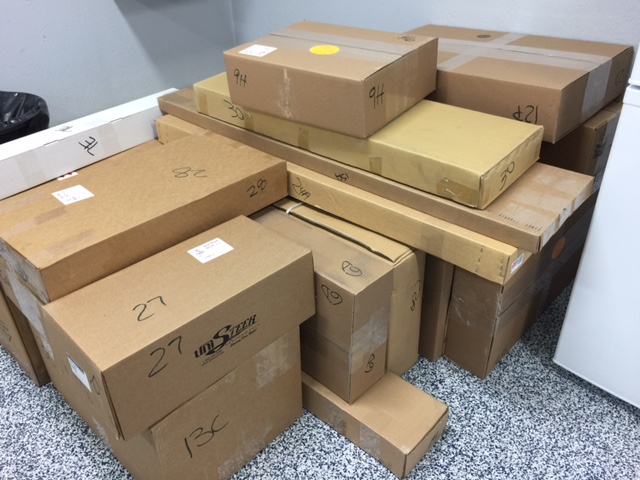

    Just starting inventory. After all I had heard about the job that FFR does in trying to simplify the inventory process for you, I was a little shocked to see parts that were in bags with no part numbers (at least none that match the inventory sheets), or you just had to try to figure out by the description alone...better than the alternative of no help I guess and still fun!
    I just marked those with a sharpie as I translated the inventory to manual decoder. Yes it would be nice if the inventory and the bags matched the manual a little better, but once you get going the paint by numbers isn't too bad.

    So 12 hours and 31 boxes later...inventory is complete. All parts accounted for with the exception of just a handful of non-critical items and a couple back-ordered items. I say non-critical...of all things to short me, it seems FFR left the rivet spacing tool out, seriously! The only damaged part was that beautifully, turbulent, corrugated radiator hose...crushed! Will hit FFR up on Monday for updates on back-orders and make them aware of missing/damaged items. All in all, the process was relatively painless and it really is a good exercise to physically put your hands on most of the items to help become familiar with them...at least IMO. I like the fact that FFR sends about 50 promotional brochures for you to hand out at car shows! Hey, ABC, Always Be Closing, right! I removed all the body panels with the exception of the main body. Tonight I am going to re-introduce myself to the manual, at least the one that was sent with the kit. I had purchased the pdf back in October and received an actual manual at build school last month, but my hopes are the one sent with the kit will be the most up to date. I think my plan is going to be to move forward with marking the panels, remove and then begin the front suspension. I have waffled back and forth on whether I should build the entire car, tear down then powder and paint, but I am going to mock-up through suspension & brakes, then send the chassis and components out for powder. I should be able to tell relatively quickly if that ends up being a good plan...

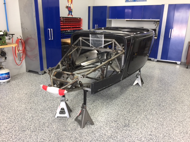

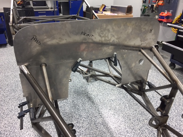

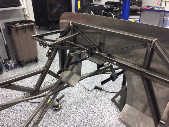

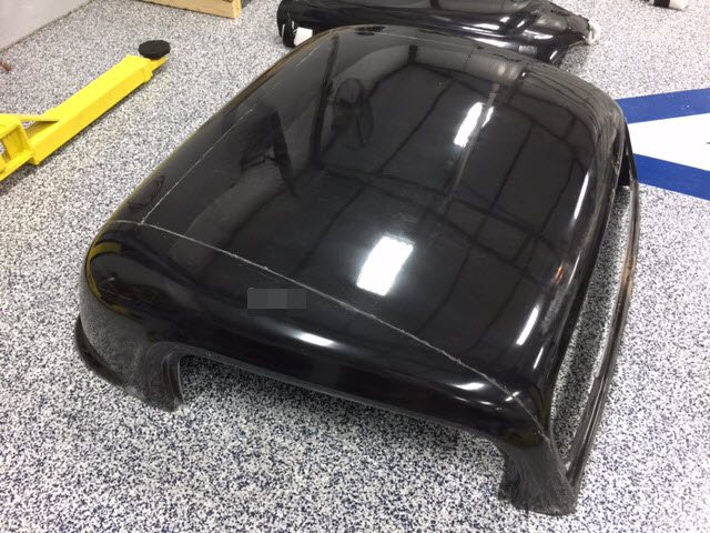

    Spent a little more time today than I thought I would have to cleaning up welds around the firewall panels so they would fit. I was able to mark and remove all aluminum panels though. Hopefully onto front suspension and brakes this week.
    33' Hot Rod Coupe/Roadster (GEN 1), Fendered, Ford 302, 350hp, EFI, AOD, 4-Link, Double Adjustable Koni Coilovers, Split Rear Exhaust, Electric Power Steering, AC/Heat/Defrost, Moser 8.8"-3.55, Willwood Front/Rear Brakes, 18" x 8" Fronts/20" x 10" Rears, Ordered: 1.26.17, Arrived: 3.29.17, First Start: 7.2.18, Go Cart: 11.4.18 Paint/Body: 2.23.19, Back Home: 11.24.19, Completed: NEVER!; View More Pics @ https://starmobileone.com/

    Kinda scary hearing you had to clean welds to make panels fit nicely.. I ordered my chassis powder coated
    I had originally done the same, but after hearing others talk about having to clean up some areas , I decided against it. I think the welds on the large outside tobes got a little wild on them.

    You can always just throw a little gloss black rustoleum on the grind spots. Or trim the aluminum. Enjoy
    I was able to trim the aluminum some, but I found that there were welds behind the top firewall panel that were not allowing it to it to sit flush against the chassis. I will mock up the suspension and then send the chassis out for PC, so there shouldn't be any issues.

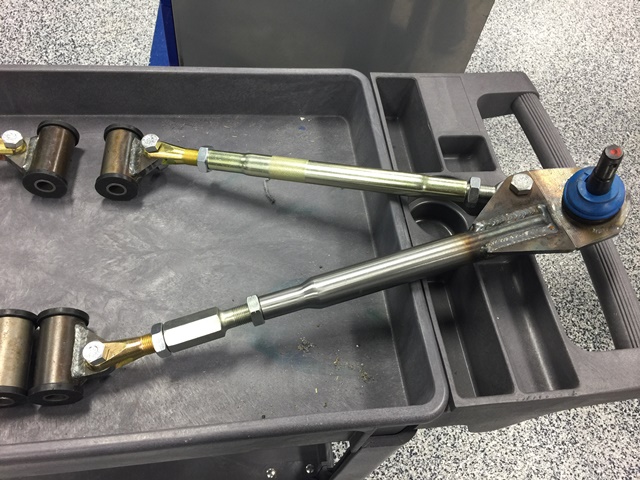

    Started the front suspension this evening beginning with the lower control arms. Will try to get uppers together tomorrow. Don't hold back guys if you see something out of place. Haven't put zerks in as this is mainly for mock up at this point before I powder coat.

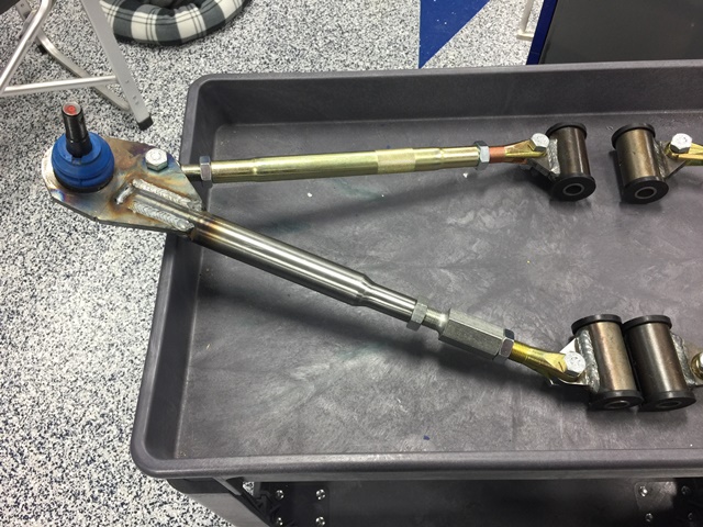

    Quote Originally Posted by JOP33 View Post
    Next step;
    Look at the welds on the chassis where the rear mounting tabs are for the (upper) control arms. On the inside of the shorter tab in
    each pair where the barrel mounts you will likely see that the weld interferes with the lip on the Urethane insert.
    You will probably have to carve off some of the thickness of that flange for about a 1/4 turn so the arm can swing freely through
    it's full range of travel. Some builders have ground off part of that weld but that approach scares me.
    DB
