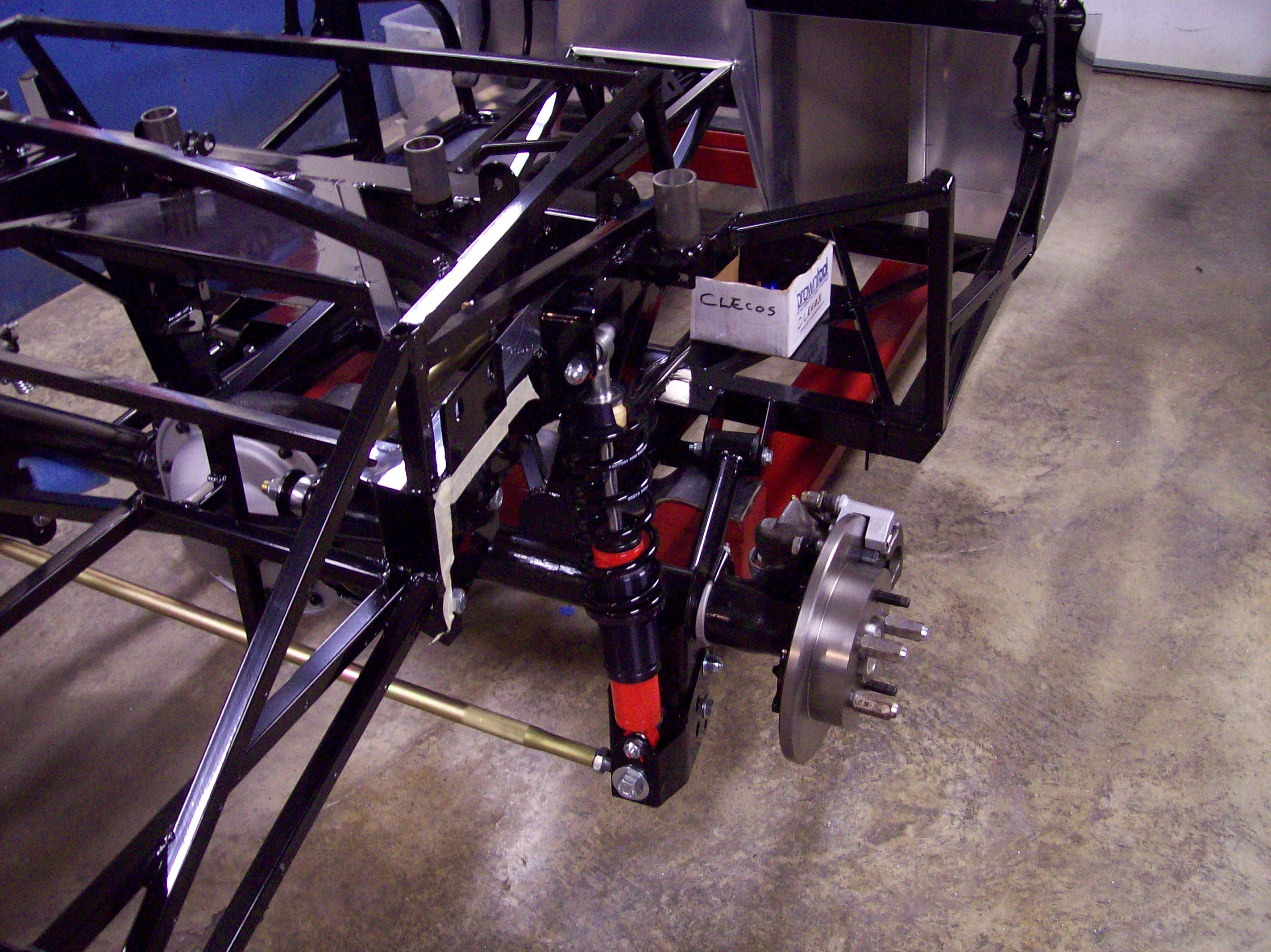

    Lots of progress today! I got the body off the chassis and onto the buck and into the eventual parking space for the finished car.
    After marking and documenting the aluminum panels, I removed everything down to the bare chassis.
    Finally, I drilled the F-Panels and cleco'd them into position. Now I need to decide how I want to finish them before permanently riveting them and starting on the front suspension.

    More progress today as I began assembling the front suspension. I decided on black bedliner spray for the exposed aluminum panels and scuffed and cleaned the F-panels then sprayed them. They came out really nice and after several hours of drying time, I mounted them.
    While they were drying, I addressed some areas on the chassis that were missed when they powder coated it. I used a rust converter and will touch up the uncoated areas with POR15 after the converter is completely set.
    Finally, I got the lower control arms, upper control arms, and front coil overs installed. Please check my work on the uppers as I had to flip the mounting bar to get the proper (I hope) configuration on the pre-assembled arms.
    I had to use a large flat screwdriver to wedge the rear upper control arm bolt in order to get it torqued. It was too close to the chassis to get a wrench or socket on it.
    Back to work (that pays the bills) tomorrow, so the build will wait for another day off to get back into it.

    Completed the front suspension and brakes today!
    Used the two 35mm bolts supplied by FFR to mount the caliper brackets to the spindles. The Wilwood supplied bolts are 40mm.
    Next I'll begin working on the rear suspension.

    I'm not saying this is relevant but we had this conversation on the 33 forum, discussing red vs silver shocks.
    Jim @FFR cleared it up:
    "Monotube shocks like the red ones that come with roadsters and came with older 33 kits can be mounted either direction. Twin tube shocks, like the current 33 nickel plated ones or the optional aluminum body double adjustables, must be mounted body down. "
    http://thefactoryfiveforum.com/showt...nt-konis-on-33
    As I said, this was a slightly different context, so take that into account. I only mention it because noticing you have red shocks.
    I suppose if it doesn't matter, then I could flip the shocks over. My reference to the manual was about the red vs. silver shocks, and there are different pictures in the manual that show them in either orientation.
    My Build Thread: http://thefactoryfiveforum.com/showt...ter-Build-9754

    Papa,
    I called Dan at Factory Five since my shocks are oriented in the same position as in the 2013 assembly video.
    Dan stated that the Red Shocks can go either way and that you've got them in the correct position as outlined in the later manuals.
    I've got them inverted like in his video, but you've done it by the book so yet again I've gone against the norm.
    Hope I didn't cause you too much grief.
    Steve

    Quote Originally Posted by GoDadGo View Post
    Papa,
    Steve
    Not at all, Steve. I just wanted to know if anyone has had clearance issues. If flipping the shocks over is a good solution, I'll be happy to do what works best in spite of what is written in the manual. That's why this forum is so awesome!
    Dave

    One of the cool things about monotubes (like the reds) is that they can be mounted either way and work fine. If you need the clearance on one end or the other, mount them that way. Otherwise, mount the heavier end at the top to minimize unsprung weight in the suspension. Looks like things are going well!

    Papa,
    Flip 'em.
    Cheers,
    Jeff
