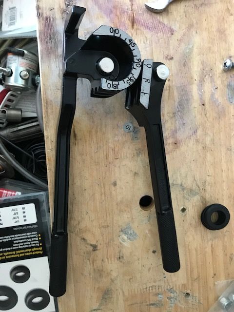

    As I was looking over my front brake routing, I wasn't happy with the main line going from the MC, so I gave it another try. This time I put the looped area inside the box and I think it looks much nicer. Was able to use a full stick of 60" NiCopp for the job. Much easier to bend than the FFR provided steel ones. The lines now have plenty of slack in them so there is no stress on the fittings...very easy to screw and unscrew by hand. I don't have have the padded clips or the gravel guard installed yet. Speaking of which, these brake lines are 3/16 in diameter. I can't get the 3/16" gravel guard over the pre-flared ends, so I ordered the next size up which is 1/4". We'll see how they fit. I will say that I'm liking tube bending more than before as I've got some practice.
    One thing to note was the minor scratches or scathing I was getting on the tube from my tube bending pliers. Hard to avoid on the tight J bends, so I took a piece of shrink wrap and placed over the tube where I was hooking on with the pliers. Worked great and you can see one in my picture before I took it off.

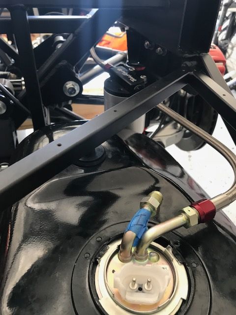

    Moving on to the fuel tank. I had two sets of o rings in my kit for the fuel sender and pickup. One set was thicker and round, the other were thin and square. I picked the thicker round ones. When installing these, the FFR video says to use a fuel/oil resistance sealer, and they were using 'Seal All'. This sealer hardens up and I just couldn't see using that on a rubber o ring, so I used some Permatex gasket sealer and dressing. This helps seal the o-ring, but also stays pliable.
    Installation was simple and uneventful. I will say that I used the Ford part F4ZZ9072DA for the filler neck seal. I had read Edwardb's post stating that Ford part was much more robust than the FFR supplied part, and as usual, he was right. I thought I had taken a comparison pic, but can't find it. The rubber is much more robust and the inner seal has secondary ridge that helps seal against the fill tube. $35 later, but I think its worth it to ensure a leak free system. As you can see, I also bought the larger check valve from Breeze. It's made of plastic instead of metal.
    I also ensured to install the 4 barrel nuts for the fuel tank mod. I used the 7/16 sized nuts (about 2" in length) and 1" SS flanged bolts. I was able to source both of these from Lowes.
    I'm using the Breeze 3/8" pickup, as those are the size lines I'm running for my 427. Nicely made piece with a screen on the end. I am going to use regular rubber hoses at the tank and to the mechanical fuel pump as the pressure is low with this setup and should be all I need.
    Speaking of fuel lines, I was able to run that as well. I had to choose the passenger side or the driver's side. I think most run it up the driver's side, but since I'm running 3/8" Nicopp line, it just seemed too congested with the brake lines, so I ran up the passenger side. I ran one piece of 72" tube from the rear and then one union to another 60" piece up and around the front 4" tube. Again, the NiCopp line, even though it was 3/8", still easy to bend with a typical tube bender. I have not bent the final 3" up to meet the fuel pump rubber, as I'll do that after the engine is installed so I can line it up a little easier. Thought it turned out pretty nice. Just have to add the clips.
    Anyone know where I can get 3/8" female barbed fuel line connectors? I see a bunch of them for NPT fittings but not for flared fuel lines. Nothing local either. The FFR kit comes with them but they are of course for 5/16" lines. You'd think it would a staple at the local auto parts.

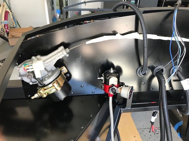

    Haven't posted in a while, but LOTS going on.
    First off, I did get to my electrical wiring harness and began sorting through it. First piece was to get the fuse box situated. The entire assembly went without a hitch, although it was a little trying getting it all to line up while drilling my holes as positioning yourself is a little awkward and the assembly frame concaves a little bit when riveting everything down. As with everything else, the plate was painted SG black.
    I fed all of the main harness wiring through the middle opening so it would pass right over the steering column. I have 3 holes cut in the firewall. I had 2 and one was behind one of the dash supports, so I evened out the space and cut a 3rd one. All of the wire harnesses passed through with grommets without any issues. One of my grommets was backwards as pulled out of the box, but it was already installed so had to control the OCD thing.
    I also installed the inertia switch just to the right of the steering column.
    As I connected the front harness to the main, I was having an issue finding a suitable location for the larger connector. The inboard side of the DS footbox has the Forte mechanical linkage arm coming up and I didn't want to place anything on top of my MCs feeder lines or brake lines, so I decided to run it up the outboard side of the box and out that hole. It's better from both a functional and aesthetic perspective. Papa did the same thing and said that the front light harness on the passenger side 'might' need to be extended due to the additional couple of inches that might be used to route it that way, but I'm good with the trade off.
    The F-Panel notching, as recommended by Edwardb, came in to play as the front harness was run, as it gives makes room for the harness and kind of gives it a place to sit as it winds through the front. I have the Breeze lower radiator mount that will go in later, and the harness will route across that, so I have it just sitting for now.

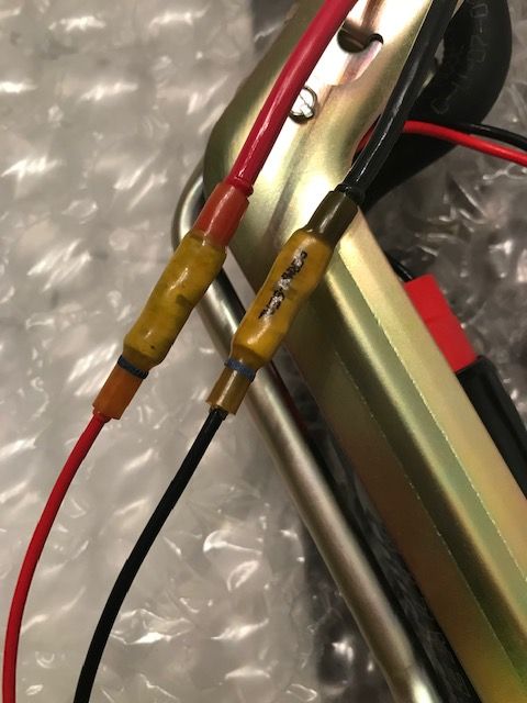

    No real issues hooking up the rear harness, although I did discover that my fuel sender weather pack had two male plugs. Papa was kind enough to send me a female that he had left over and I ordered the Weatherpack tool on Amazon for $7. Took 10 mins to change it all out. I'll be using more Weatherpacks on my lights.
    I ran the rear harness up the drivers side of the tunnel as instructed, but I may run it up the passenger side as it 'might' interfere with my mechanical linkage...but we'll have to wait and see.

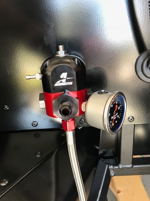

    Unfortunately, or fortunately, depending on how you look at it, I had to revamp my fuel system, as using a mechanical pump is not going to be an option with the 427 and PS pump/pulley system. So, decided to go with an in-tank pump, regulator and return line. The Pro M Racing hangar just arrived, with the Aeromotive Stealth 340 pump. Go big or go home right?
    Wasn't aware that some cutting needed to be done to the tank to fit the Pro M Racing hangar, but consulted with Boydster who gave me a few ideas on technique and product selection (Gotta love the members on this forum!). Was a pretty easy endeavor and duct taping the shop vac around the hole worked like a champ to ensure nothing got inside the tank while I was grinding away with my Dremel and grind stone. Below is a during the operation and afterward shots. I also used duct tape (sticky side up) both inside and outside the hole to pick up any stray micro shavings.
    The Pro M Racing instructions are very good, and state to cut two sides of the tank opening. You really only need to cut the larger side. If you lightly press on the return line of the hanger when inserting, it goes in and out easily.
    As you can see in the pics, the Pro M hangar has two different sized plugs. Have no idea why they did that, as the little plug is not that common. I will most likely cut the connectors off of the hanger side and just reconnect with butt connectors with the Aeromotive pigtail and then use some fuel resistant shrink tubing. Anyone know where I can score a couple of pieces? Seems that the outlets all want you to buy in some kind of bulk, except for McMasters, but I'm not 100% that their version is gasoline resistant. If anyone knows, just let me know.
    I'll be running the Aeromotive A1000 regulator for carbs. That should be coming this week with a Trickflow canister filter by Tuesday, then I'll have all my parts and can start effectively planning out my new fuel lines.

    Ok, so was able to get my Pro M Racing fuel assembly completed. Cut the connectors off of the Pro M housing and butt connected it with the pigtail from the Aeromotive a1000 pump.
    Two things. First, I used the Perma Seal butt connectors per Paul's recommendation and I'll tell you what, those are the real deal!! They shrink up nice and I had a sample test in fuel for over a week and no issues at all. They have some kind of jelly inside that liquifies when heated up then hardens up when cold. Bought myself a 'real' butt connector ratcheting crimper. It was $50, but hey, gotta have the right tools and the old standby cheapy was not cutting it for an 8GA crimp.
    Now, being the anal person that I am, I thought that I would put come DC-25 heat shrink over it for some "double protection". Either I didn't have the real deal DC-25 or it simply swells up after a few days in fuel. Needless to say that I didn't use it and stuck with the Perma Seal connectors.
    If you are using the Pro M Racing fuel pump housing, you'll want to ensure that the sock that goes on the end is in the right position before inserting it into the tank. I didn't do that and it got all jacked up and folded, so had to pull the housing to fix. And I don't have to tell anyone that has installed this housing, that's not a fun deal, as the sides of the tank are like razors, and want to cut up your wiring as you try and wiggle it through in the right position. None the less, got it in and ready to rumble.

    I ran both of my 3/8" line from front to back. Actually, wasn't that bad once I got the hang of it, as its quite a bit thicker than the 3/16" brake line, but the Nicopp made it easy to bend. If you are using one of these type of tubing benders, you'll want to ensure that you have equal pressure on both handles when bending. If not, you may end up with a small indention in your tube where the bracket holds it in place. Nothing that will affect operation, but if you are into good looking tubing, may cramp your style.
    As soon as I get all of my tubing brackets in place, I'll post a play by play around how I routed it in case anyone is doing the same with the 3/8 lines.
    I did get my Aeromotive Fuel Regulator in place. I pushed it as far as I could towards the passenger footbox with clearance in mind. The Input is right on the nose of the regulator, so didn't want it to get close to anything hot. Man, Aeromotive makes some high quality stuff. Hopefully it works as good as it looks.
    Also, bought an Auto Meter fuel pressure gauge and installed it. Was surprised that it didn't install face up on the Automotive regulator, but I guess its more situated to a driver's side readout when at the carb. Either way, should be good to go and high quality piece as well.
    And per a few people's suggestion, I moved my wiper motor up a bit, which I think looks much better. Just used a couple of plastic plugs from ACE to plug the open holes. Can't even tell really.
