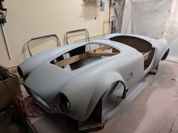

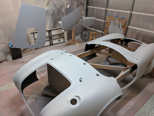

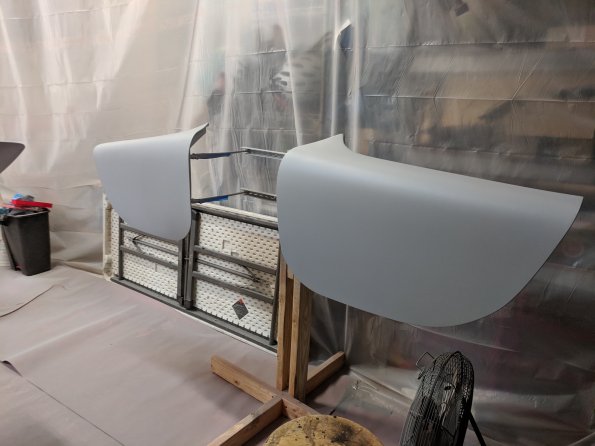

    looks like time spent on the filler was well worth it.
    I got a whole bunch of FeatheFill on today. 4 good coats. Boy, that stuff is a PITA due to how fast it kicks. I only managed a quart between gun cleanings. OH well.
    In the end, I'm really pleased how it went down and how it turned out. Using my shop lights, I can't find any obvious waves or bad spots in the body. I'm pretty happy with what I've pulled off.. for a 1st timer.
    Even the orange-peal was non existent. All those 80 scratches I thought might be a problem... meh! Nada.. they are gone. I do have a few pin-holes to fill, but noting too crazy.
    Question... was my gun pressure too high? I was a bit surprised at the amount of over-spray. I thought I had the gun dialed in pretty fair (for a newb) but, there was sure a lot of the overspray on the paper.

    653
    Overspray is normal. That stuff is heavy and the less airflow you have in the booth, the more on the floor. The fact that it went on smooth without (dry spray) across the panels means you had your gun adjusted well. What are you using for exhaust fans? ..da Bat

    Thanks Bat... I couldn't find any obvious dry spray (not that I'm an expert in what to look for), and only 1 spot with a bit of orange peel.
    I was wearing a proper face mask with proper filter for paints. For my ventilation, I have a modified HVAC blower fan in a DIY box. That sucker moves a crap ton of air. But, for this stage, I only had it just pulling air out of the garage. So, it wasn't the most efficient use of it. I really didn't notice the haze much until the very end of the small gun pot. When it comes time to spray color and clear, I plan to build a sealed tent (10x20) with this blower and a good HVAC filter moving the air through the tent. I'm pretty confident it'll work well. (fingers crossed)
    I'm planning to hit the FF with 220 grit next, then 320 dry. Lots of guide coat.
    Looking at the finish so far, I'm quit pleased with the lines. I'm optimistic that there will not be a lot of lows and highs.. but.. only blocking will reveal that.
    With about 4 coats of FF, I think I have plenty of material to work with.
    Question.. how will I know what my next stage should be?
    Do I "need" a 2k urethane layer? How will I know if I do? Or, can I go right to 400 & 500 wet on the feather fill if it's straight enough?
    Then, put down the sealer, and wet-sand it to 600.
    Or.. will I be better served with a good 2k primer/sealer tinted darker for my base coat color? Work this 2k with 400,500,600 and have that be my layer before base coat?
    This sounds easier and more forgiving.. but.. newb!

    Once again thanks guys.
    Guess I have some marching orders.
    As for heat, I can manage that. My garage has both AC and heat. Once all the base and color is on, how long at what temp would be ideal to leave it bake at? The max I can set my garage at is 30C (85F).
  23. #19
    Senior Member skidd's Avatar
    Jan 2016
    SA-TX
    333
    Lol... poor naive newb!! Thinking I'd easily be able to cut down the FF with 220 grit. haha... (facepalm)
    Quickly switched to 150 and 180. Much better at making dust. Keyripes!! I thought the red-dust was bad!
    And.. DAMN YOU LONG BOARD AND GUIDE COAT!! for Showing me lows and highs that sure weren't their before!!

    Thanks Bat.
    Also.. just wanted to add.. I've been keeping a timelapse video record of every moment spent working on my cobra. From the day Stewart dropped it off, all the way to the present body work.
    It's a bit of a "fudge" but if I calculate the timelaps spent during the "bodywork" phase, I have just over 130 hours spent so far to get to the stage of 1/2 sanded after feather fill.
    Mind you, this includes things like modifying the body buck, building a make-shift-dust-tent, drinking beer, neighbors coming to see what all the dust is from... etc.. but.. dang!
    To think you pros can get so much farther along, in such a shorter time.. mind-blowing!

    Here is a suggestion for when you shoot color. Your panels should be in the orientation that they will be when on the car. Especially with metallic. The metallic particles will lay differently and you could have a hood / body mismatch with the hood and trunk hanging.
    Doing your own body and paint is a seriously rewarding endeavor. It gave me some serious appreciation for guys that do this professionally.

    Thanks.. Yeah.. I intend to orient the hood and trunk flat like they were on the car. I'm going to copy .. (I think it was Kleiner) hood and trunk flip-flop tables.
    2016 MK4 | '99 Explorer 5.0 | E303&600cfm carb | T5z + 3.55 | 3-link | SN95 | PB/PS | FR500 17" 315&275 |
  29. #25
    653
    Forget the "Flip-Flop" tables. Finish sand and shoot the bottom of the hood and deck a few days before you are ready to do the whole thing. Turn them over when dry and finish sand the tops. Mask off the bottoms and shoot the tops with the rest of the car. Two things. A. It will give you a chance to shoot a little paint. 2. You don't need to be fiddling with wet paint in the middle of a paint job . Save the circus stunt fly-bys for Capt. O......He's been busted and thrown in the brigg for that move....something to do with "Penny Benjamin"....da Bat
  30. #26
    Jan 2016
    SA-TX
    333
    and D. I don't really know how to do that.
    Honestly... painting it all at once is something I can wrap my brain around. Though, I need to find enough room for this trapeze act in my make-shift paint booth.
    Stripes on tops -> base color all surfaces -> clear all surfaces. makes sense.
    I don't really quite understand how to paint and clear one side, let it dry, and paint the other side and get it to "blend" correctly.
    I don't know how much paint it'll take to do just the bottom of the hood and trunk. (I'm guessing all I have to do is ask)
    I don't get where and how to mask the painted bottom side when time to spray the top.
    How do you not end up with some sort of "line" where the tape mask is? Or is that solved with the 1500 grit wet-sand stage?
    what do you do about the edges? Painted with the bottom? or the Top?
    Though, I like the idea of getting a bit of practice shooting color and clear on an "underside" before going for the big shoot.

    Taking into account, the airflow ,which end of my makeshift spray booth do I start at? The end with the exhaust fan? Or the end with the intake filters? Or doesn't even really matter? And which ever end I start at, should I begin with panels? Or the main body?.. or.. in the words of Mr.Miller... stop over thinking it!!
  38. #33
    Not a waxer
    Jeff Kleiner's Avatar
    4,104
    If you're moving plenty of air I don't think it really matters which end...maybe Professor da' bat will have better input. I generally spray in the same order (with no significant logic to it) and I'm pretty sure that Jeff M. does also. My order goes scoop, doors, hood trunk lid, main body---rinse and repeat.
  39. #34
    653
    As for the booth....Start spraying closest to the intake and work your way toward the exhaust. Any overspray landing on the car on it's way out gets melted in. As for spraying, I start with the body on the intake end and finish with the loose parts on the exhaust end (that's just how I like it). Play with your set-up to see what kind of room you have to move around and paint accordingly...da Bat

    Right now I'm 220 sanding the feather fill. Keyripes! What a difference! Sanding to achieve smoothness is so much easier than sanding to make shape! It's almost turned sanding fun!
  41. #36
    653
    If you have already sanded the FF with 150-180gr you go right to 2K urethane then sand the 2K with 320 then 500-600 , seal, paint.....220? Who does that !...da Bat
  42. #37
    Jan 2016
    SA-TX
    333
    who does that? Newbs like me over worried about leaving grit scratches in the surface and NOT covering them with the next "layer" of stuff.
    I thought the 2k required a 220 surface? Or to be specific, I think it said 180-240. Which my neurons translated to "don't leave any of those 150s on the body".
    Too late now though, I'm half way done with the 220.. no point in stopping.
