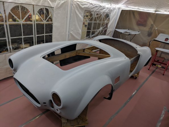

    The Spray Booth is about 1/2 done. It's up, the seams are all sealed with duct tape, and a bunch of led strips for added lighting. The leds, along with the main shop lights.. and ... the ambient light from the open garage doors (I'll be spraying during the day) provide plenty of light to see what I'm doing. There's more light than it looks in the photos due to the auto white balance of my phone camera. Still need to seal in my blower fan and the hvac filters. That'll be tomorrows project. Tonight.. Beer-o-clock.

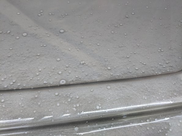

    Ok... I need some EMERGENCY help.
    I just put coat #1 on the bottom of the hood trunk and scoop.
    FISHEYE!!
    I need to know what to do at this point.
    I sprayed the hood first, got a few, the trunk 2nd got a FREAKIN' CRAP LOAD, scooop; 3rd and got just a couple.
    I have a desicant water trap in my air line, before the filter and regulator. And a very large black-pipe based water trap right after the tank,
    And, one of those cheap disposable filters at the gun.
    I pre-paint wiped down all surfaces, then tack-clothed them all.
    Is this crap I left behind on the panel? Or .. something in my air line?
    Here is the worst spot on the trunk
    What do I do? I'm going to need to stop, let it dry, and sand it, right?
    Of all the things that could go wrong.. this is the worst case scenario.

    I called a buddy of mine who has far more experience than I have.
    Showed him the pic, asked for guidance.
    He said. "stop... let it cure, sand it and start over again".
    I was not happy with this advice. but.. I made my bed.. time to sleep in it.
    I asked him.. nothing else I can do huh?
    he said.. "well.. uh.. yeah. .no. I mean.. uh.. well.. No".
    ?? I heard that.. what are you not telling me.
    He said.. I have tried something with marginal success . If you try it, it's all on you.
    he said, try a few light "dusting" coats over the fish eye. See if it starts to cover it.
    If it does, go ahead and try a normal coat after that.
    It will NOT fill the craters, but it "might" emphases on "MIGHT" cover the fisheyes.
    So.. I figured.. .if I'm going to have to sand it worst case.. I'll try this first.
    It pretty much worked. Actually better than he lead me to believe it might.
    The fisheys did leave small craters, but at least it's the under-panel surfaces.
    I actually have to look close to see them, but they are there.
    Good news: at least I don't think I can blame my air supply.
    Bad news: clearly I didn't do a good enough job cleaning the surface.
    Good news: It's the under panels that this happened on, and I can live with that.
    Bad news: daBat and Kleiner are going to see this soon.. and I'm gonna git'it!!

    Quote Originally Posted by skidd View Post
    I'd have taken it off rather than trying to bury it... I'm going to leave this one to Dr. Miller because he's the chemist (in spite of the fact that I like blowing smoke up his skirt he's one smart guy and you can take his advise on problems like this to the bank). Lots of things could have caused it so the big concern is what. Compressor blowing oil? Contamination in your hose (my paint hoses only get plugged into air that's been through the dryer/separator, never the regular shop air)? I don't think it's residue left from a final wash cleaner---in my experience that will craze rather than fisheye. It will be interesting to see what daBat has to say.
    Sorry man

    Got ahold of daBat on the phone.. and he talked me down from the ledge!!
    Good news is, he's fine with the "cover it up" I did.
    Especially given they are under panel locations.
    We went through how to avoid it happening next weekend when I do the rest of the car.
    In short... I need to "wash" the whole car again.
    We both more-or-less agree it was something on the panel, because I'm getting no more fisheye after that initial one.
    So, it's almost certainly not in my lines. (fingers crossed).
    Plus... I didn't put down sealer on these underside panels, while I intend to put down sealer on the main surfaces next weekend. Technically, that gives me a layer of "oops" to recover from.

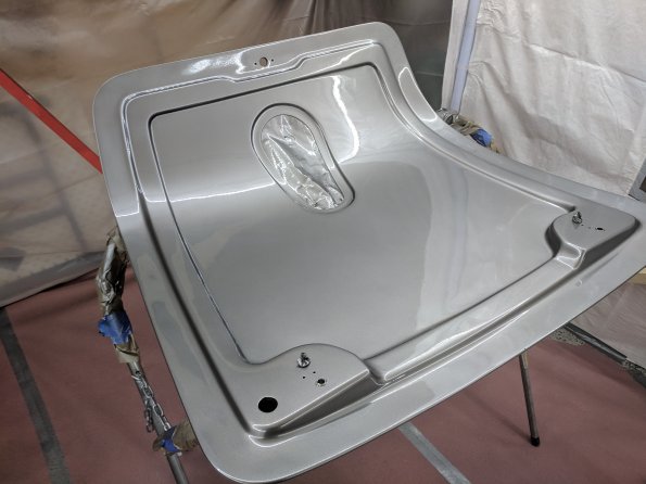

    Here is the result of my "dusting" repair, and 2 coats of clear (2 more to go). I'm really quite content with it .. again.. given it's under the trunk afterall.

    4 coats of clear on the bottoms?.....SAVE SOME CLEAR FOR THE REST OF THE JOB !... WHAT CLEAR ARE WE USING AGAIN ? I WORRY WITH DOING 4 COATS YOU COULD HAVE SOME SOLVENT "MICRO POP" PROBLEMS. 3 max.... sorry for yelling....my radio was turned up and didn't know if you could hear me...da Bat
    The clear I went with was the PPG Vibrance Line. per yer recommendations. See.. I do sometimes listen!!.. sometimes.
    I mixed up 16oz of the stuff, and figured I might as well use it since I can't save it. Hope I don't get these micro-pops ya speak of.
    coat 1 was pretty light. I might have been a bit paranoid from the base color fish-eye, so I went a bit light to start. coats 2,3 and 4 were pretty wet.
    It's all been baking in my garage with the heater set on max (30c/85F) for about the last hour.
    Looks pretty good so far. A ittle bit of orange peel in a couple of places, a couple of dust specs.. but most of it seems to have leveled out pretty nicely.
    Actually.. the problem spots on the trunk surface.. where all that fisheye was.. looks almost the best! Whodathunkit. I looked as close as I could, and couldn't find the fisheye craters.

    OK, so with the Vibrance gives you alotta film build. To put 4 coats on you need skill and patience (I do not recommend you try). 3 coats with 12-15 mins between at 75* to where the clear is sticky but no longer stringy (checked on the body in the gas cap recess, under tail light gasket covered area and same in front under marker lamp. checked on doors under door latch area. checked on decklid under plate light) Loading wet on wet will get you into trouble with the micro pop (that is solvents trapped in the first coat trying to escape through a drying top coat)

    Would I see these micro-pops by now? Because as of this morning, the under panels look really good! A few dust particles which have introduce tiny "bumps" in the finish, and a couple of minor orangepeel spots. and what looks perhaps like a spot of tiger-stripe right beside the scoop opening (see pic). But, no bubbles under the surface anywhere. Did I escape this round relatively unscathed all things considered? Truth be told, except for the handfull of dust bits, these panels turned out fantastic. Despite the trunk looking like the face of the moon after coat #1. I looked as close as i could, and I can not find any of the fisheye craters or anything.
    Hey.. when It eventually comes time to color sand the whole car... do these underside panel surfaces get wet sanded and polished too? Or .. to they generally get left alone?
    P.S. I'm absolutely in LOVE with this color!! There is no doubt in my mind I made the right choice.
    2016 MK4 | '99 Explorer 5.0 | E303&600cfm carb | T5z + 3.55 | 3-link | SN95 | PB/PS | FR500 17" 315&275 |
  27. #105
    706
    OH SHUT UP !! Yes you would see them by now. Best I can describe is kinda looks like sugar on the surface. God bless beginners luck.....but now that you have used it all up on the bottoms (WHO DOES THAT ) be mindful of all we have talked about. I do nib and polish the bottom of the hood but not the deck lid (cause it's not my car and I don't care). It's really up to you......god knows ya got enough material ta work with under there ! Stay in touch brother. I will try to be available to you on paint day ….answer questions, hold your hand, talk you down from the ledge,,,,,,OH LOOK ! HE'S LAYING IN THE DRIVEWAY MAKING "GRAVEL ANGELS".....FACE DOWN ! ….I wonder what went wrong. Yeah, it's like that !

    I'm ahead of schedule today, and the weather is good. 55F outside, but a nice 70F in my garage with the heater running.
    So.. Planning now to get the sealer sprayed on in the next hour or so. Let it dry enough... then the 1st stripe color.
    Then, tomorrow morning 1st thing, I'll spend the time necessary to lay out the stripe masking.
    Which, if things go smooth, should have all layers done by the end of the day. Left to bake in my garage all night at 85F
    Since a cold-snap is in the forecast for Sunday, this should work out well.
    So.. it BEGINS!!

    So far... So good!
    Sealer went on nice. No orange peel, can't see any overspray (not that I have an expert eye) , and most importantly... NO FISHEYE!!!
    Now, beer break while I let the sealer dry enough for the pin stripe color.

    Stripe masking went pretty well. Took a bit over 3 hours to lay them out.
    Both primary and pin-stripe colors went on pretty well.
    Now, I'm waiting until the stripe color is dry for final masking.
    Then.. main color!!
