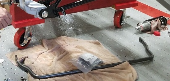

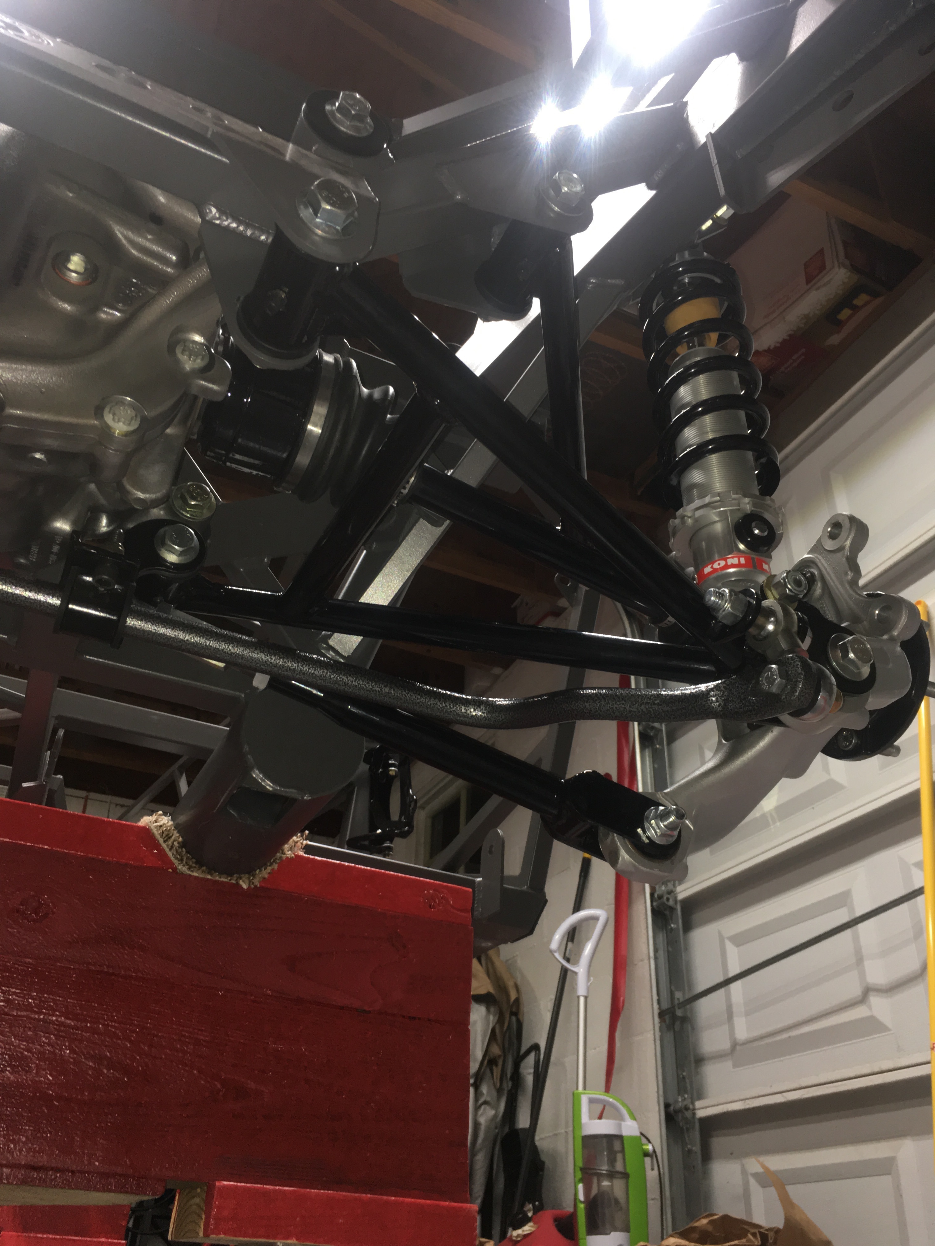

I had the opportunity to take some vacation, so had a blast making some progress...slow but sure.
Up first was assembly of IFS components. I have most of the components in place as shown below, but not yet torqued. And, I just received my LCAs, so finishing the IFS will be up soon. The plastic bag over the upper ball joint is to keep from getting grease everywhere until I attach the remaining components. I also have my power steering rack in place--will update with picture once IFS is complete.
IFS: A couple things I encountered when assembling the components (not breaking any new ground here): (1) the first upper ball joint (Mevotech) went in a little tight, but I managed without any extra persuasion--the vise-tightening method worked well. The second upper ball joint threaded in more easily, so I switched to my pipe wrench, which was a bit more efficient for me than the vise-tightening method. (2) I replaced the MevoTech dust cover boots with Energy Suspension 5.13102G per numerous experiences/recommendations from this forum. (3) I won't be using the reluctor ring (AKA tone ring?), so I removed it from the hub with a hacksaw. Cut most of the way through, then tapped lightly with hammer and punch to finish breaking it apart.
IRS: Since I have all of the components I spent the majority of my time here. First, I prepped the parts that could see some corrosion/rust over time (front of center section, CV axles, rear hubs, front and rear sway bar brackets, and the front hubs) with POR-15. This is my first use of this product, and I think it turned out awesome! It's takes a good amount of prep. and time, but I think it will be worth it. It feels very durable. I used Duplicolor clear gloss engine enamel on the rear cover of the center section. I hit it with my drill and a wire wheel before applying.
Center section installed! Wow, is that ever a tight fit! I installed it solo--okay, my wife ran the floor jack at a particular dicey moment--using mostly straps and my floor jack. Knowing I would be solo I drilled out the front mount holes to 11/16" beforehand (slightly larger than the 5/8") to provide a bit of wiggle room to insert the front bolts. I got that idea from Edwardb's 20th anniv. build. Thanks, Paul! I think it helped.
The CV axles went in without any drama with a little persuasion from my rubber mallet. Here's the 1/8" gap the instructions say we should look for once the axles are fully seated.

IRS sway bar installation: The IRS sway bar turned out to be a lot more difficult than I expected. First, the welded mounts were too narrow for the rod ends plus spacers. (In fact, EVERY set of mounts for my IRS (UCAs, LCAs, toe adjuster) were too narrow). I spread the mounting tabs quite a bit, but still couldn't get the rods in with the spacers. I did not feel comfortable spreading the mounts any further. So, I ground off a bit of material from the longer spacers using my bench grinder. This allowed them to slide further into the welded mount tabs, so I could pass the bolt through. That worked. I discovered after torqueing the nuts the mounting tabs came back to parallel, which made me feel better.
The next issue was for the life of me I couldn't get the rod ends to fit on the outside of the sway bar as shown in the instructions. Maybe if I applied enough torque I could have forced both the DS and PS rods to the outside. However, the instructions say not to preload the sway bar. So, I ended up with the PS rods on the outside of the sway bar, and the DS rods on the inboard side--see picture below. I don't think this will affect the function of the sway bar, or be any less structurally sound. However, as a noob I very much welcome your input if you disagree, or have advice.
The good news is my rod ends came at the correct length, so I didn't have to cut them down to 0.5" of thread. I'm not too upset about NOT having to cut those given the numerous comments about their hardness, and my cutting tool is my trusty hacksaw.

Looking great... as for your IRS anti-sway bar, that one looks different than mine. As you can see from this photo, mine has a bend on the short legs that brings it to a different position. Where as yours looks to have straight short legs on each side. I don't think that it really matters, but thought I would share this.
Originally Posted by
BadAsp427
Thanks for chiming in on my IRS sway bar, Carl. Yours indeed has a different shape, an extra curve. I'm very hesitant to try to bend it with some hefty ratcheting straps, or other means.
Also, thanks for the PM on your cubby idea.
I would not try to bend it. But I would contact Factory 5 and make sure that they sent you the right one.
You wont be able to bend it and get it to stay without either A LOT of force, or heat. Sway bars are made from heat treated spring steel so they are designed to bend and go right back to their original shape. FWIW I used the same sway bar BadAsp has, with my homebrew mount system on the IRS, and I have both rod ends inboard as that is the way the links were most vertical. I am not sure yours would work out that way with the different bar though.
I like your idea, Carl. Think I will send a photo to F5 and have them confirm I indeed have the rear sway bar.
Hoooper, I appreciate you weighing in and comments as well.

I emailed F5 and they confirmed the IRS sway bar sent to me looks correct. Dan confirmed the heim joint should be mounted to the outside of the say bar. It's good to have that confirmed.

P.S. Yes, I'm putting off the rear sway bar correction on the DS--move heim joint to outside of sway bar. I will get to it, but I need a little instant gratification on the front suspension. In my case, "instant" means many hours.
