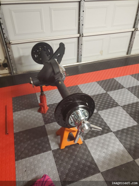

    To Weld or Not to Weld.....Ford 8.8 Welded Tubes?
    Ok so there looks to be several posts on this in the past but looking for some fresh (recent) input.
    I am getting ready to pull my rear end for a rebuild/repaint and trying to decide if I should take the time to weld the axle tubes. Ill be putting new gears in and stepping up to 31 spline for piece of mind.
    If I were to weld the axle tubes, there's no "cost" as I would do this myself with plenty of experience in the welding and fab area. Have tigs and migs, etc. Am aware of the nuances, distortion control, stress cracking, correct filler metals to use, etc., of welding cast steel.
    Looks like if I were to weld the tubes, the banana bracket would have to be ground out to create clearance for the weld between the tube and the pumpkin. So that would kill the powder coating on the bracket which is a bummer.
    Question is with a planned build of 5-550hp in the future is it worth it or would it be overkill/waste of time?
    I never plan to run slicks or run down a 1/4 mile. Has never interested me.
    I may run auto-x one day but that's just a mild interest at this point and may never do it.
    I am just not a fan of doing things twice but if unnecessary I am not a fan of wasting time
    As always, appreciate the feedback guys!

    Weld the banana bracket to the tube because that will fail first. Nothing to lose by welding the tubes to the center while you’re at it but not really absolutely necessary IMO.
    Jeff

    For those of you that welded the banana bracket in, any words of advice?
    About the only picture I didn’t get is the position of the bracket with the car sitting in the tires. It’s now in the air with the axle at full drop.
    I’ve placed several witness marks around it.
    Did you guys that welded it, cut off the bolts, narrow up the bracket pad at all?
    Once I weld the axle tubes it doesn’t look like there’s much wiggle room to hog out the inner radius of the banana bracket to clear the weld between the pumpkin and the axle tube.
    And with the vent right there, seems the bracket pad has to be narrowed up a bit.
    Also, when welding the banana bracket on, can a guy remove the lower sqr tube running diagonally up to the front of the pumpkin or do you guys leave it?
    Seems it serves very little structural advantage once the banana bracket is welded.

    I wish I had a better view but this is my rear end.
    I bought it from Forte, he had a new narrow 8.8 in stock so I took it. I got the banana bracket from Factory Five ahead of my shipment and sent it to him to weld on. I noticed he completely removed the split bolt clamps and just welded the fabricated piece directly to the tube. To me either way would work if welding which I would strongly suggest.
    My build thread https://thefactoryfiveforum.com/show...Roadster-Build
