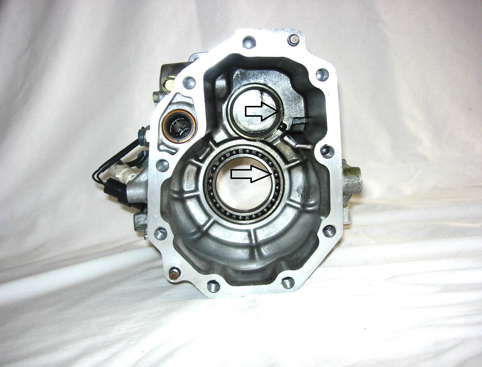

    Hey Adam,
    Not sure if you noticed but Bob & Cincy pointed out to me that I didn't take out the bearing race from the upper shaft of the back of the trans.
    Your photo in post 123, 3rd photo.... looks a little blurry, but it appears that the bearing race may still be in place.
    See attached link for Photo.
    I left mine in..... I see you now have yours buttoned up already..... but you might want to check. Mine was a "loose" fit and would have fallen out at some point.

    Quote Originally Posted by Harley818 View Post
    Hey Adam,
    http://thefactoryfiveforum.com/attac...5&d=1415232132
    Thanks Harley, I probably did leave it in.

    It took quite awhile to get here. Very little time has been spent on the car. I recently purchased the welding truck I was renting, and most of my time off between jobs was getting it in tip top shape. Put on 6 new tires, replaced a few sensors, shocks, brakes, axle seals, steering links, made a intake, installed much needed Hid's, changed all fluids/filters, and added a boost gauge. Also did some tweaking and modifying of the welding skid. She's an old girl, 358k Kms (222k Miles), but the 7.3's are tough.
    Back to the 818...
    I had the adapter plate outer edge machined smooth, looks much better now. I gave up trying to find a clutch to match the holes in the flywheel, all I could find was a 90's FWD clutch that was pull type which wouldn't work. So I had the dowel pins removed, new holes drilled and tapped and new dowel pins installed so my OEM clutch could be installed. I don't intend to run this clutch for long, but I want to make sure everything works before wrecking a $500 HD clutch.
    It felt so good sliding on the transmission. The dowel pin and input shaft aligned perfectly and it just fell in place, effortlessly. Very rewarding. In this pic you can also see my Racing Beat stainless steel exhaust flange. Not sure when I'll get to building a manifold, but I knew I'd need it eventually so I added it to an order.
    Small issue with the starter, it doesn't fit. You can see the small hole for the gear to fit, and the massive housing that surrounds my 06 starter. A little searching on rock auto has revealed that a early 90's EJ22 manual starter should work. I'll pick one up tomorrow.
