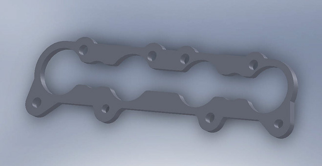

    I finally got some time in the shop today and was able to test my idea for adapting the FFR 4.6 2V headers to the Coyote.
    It started with this design I created
    Glenn (ASTGlenn) was kind enough to cut one out to test fit it. Thanks Glenn!!!

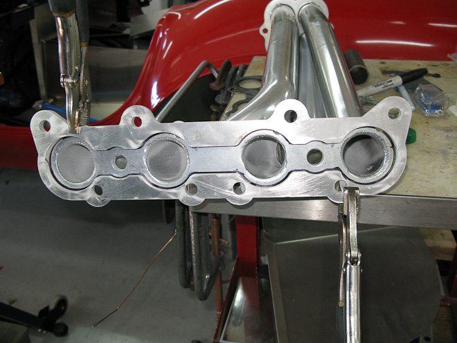

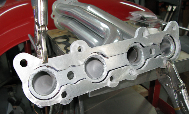

    Here's the flange from Glenn laid over the 2V headers. I took a sharpie and marked the inside perimeter of the adapter on the headers to find out where I needed to cut.

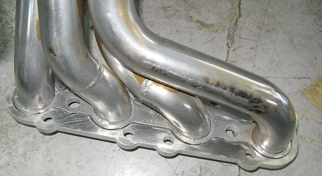

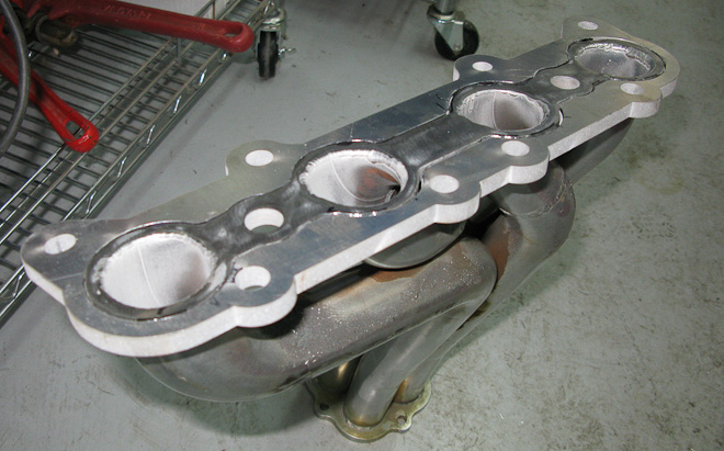

    I used a plasma cutter to knock off most of what I needed to remove, then used an 40 grit flapper wheel and carbide bur to get the cut to the line I marked.
    This is what I ended up with.
    I have a small concern about getting the sealing surface flat but am guesing if Im really careful TIG welding it it should be OK. Im going to have Glenn make the final ones a bit different to assist in fitting.
    Let me know what you guys think and if it appears to be a good solution.
