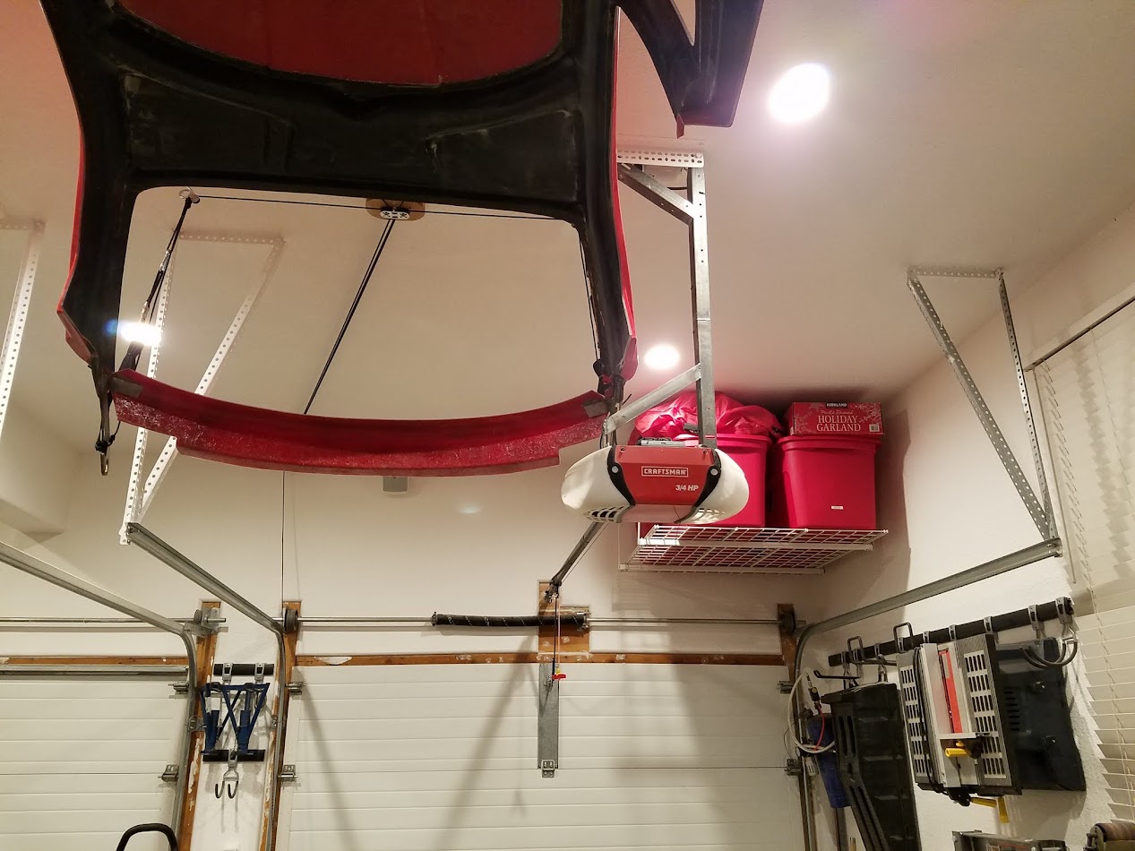

    Hardtop Storage
    Since the registration process takes so long for a kit, I decided to store my hardtop until next fall. Plus I wan't to get it painted before I install windows on it and I need a windshield for the inspection. I purchased a jeep roof pulley system. It was expensive, but saved me the time of finding all the individual pieces. https://www.amazon.com/gp/product/B0...?ie=UTF8&psc=1 I should be able to back my car in and lower on top.
    I also had to modify my garage door support to allow the hardtop to sit perfectly between my lights. Eventually I hope to get a screw type garage door opener and a high lift track system.

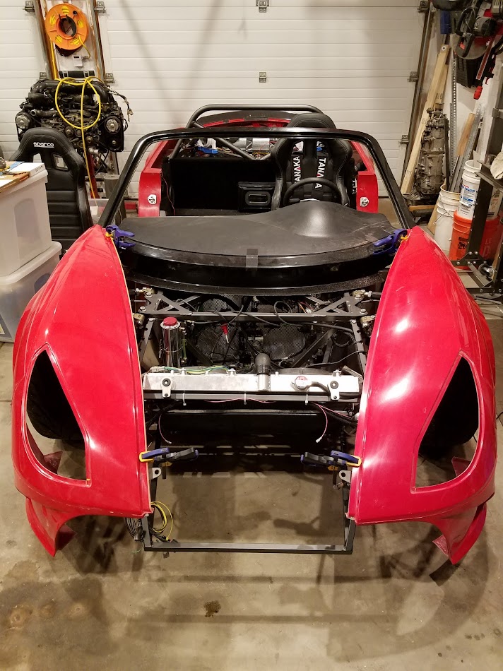

  12. #132
    Denver, CO
    1,363
    I also used windshield super fast dry urethane to fill the gaps between the rear projector mount and the housing. It can fill large voids, you just build it up pass by pass.

    I now have a little time to get the body ready for paint. My color scheme will be Subaru World Rally Blue body, Gloss black (including carbon fiber bits) accents, Matte Gunmetal metal components, and a touch of bare aluminum here and there.
