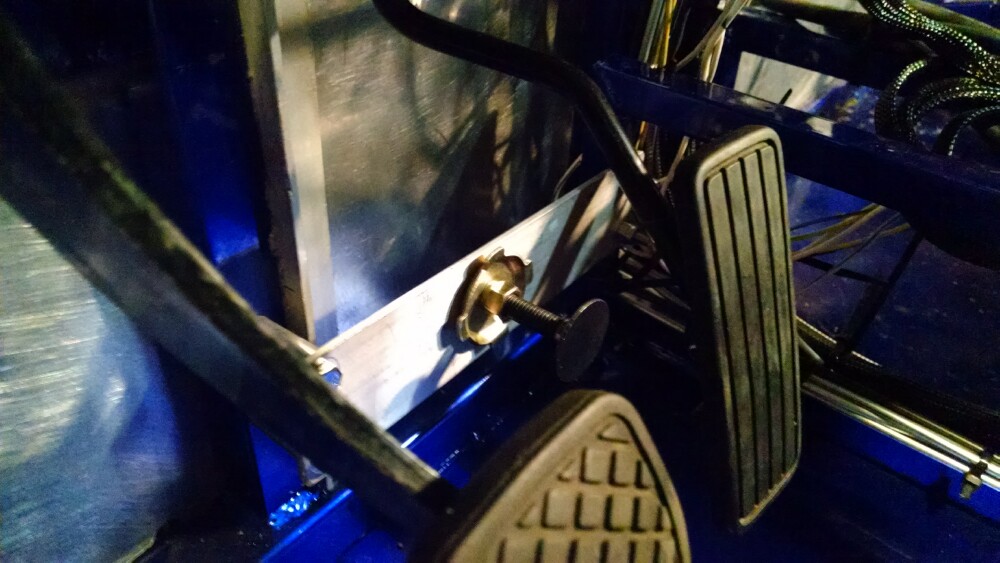

    Not so good i had 3 problums 1 bad o2 sen , i have drive bye wire and it is going past 100% throtle and im losing fuel pres some were so i left the car there they are going to look at it to day
    Senior Member Bob_n_Cincy's Avatar
    Sep 2012
    Cincinnati OH
    3,916
    Quote Originally Posted by brian b 36 View Post
    I had to add a stop behind my pedal
    http://thefactoryfiveforum.com/attac...1&d=1413755230
