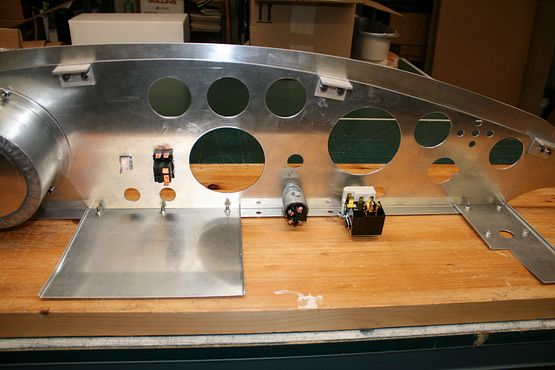

    Question: In post #118, the first photo showing the back of the dash the dash supports appear to have the sides bent up in an "L", which I assume is for strength. My support pieces are flat, except for the turn down where they mount to the 2 inch frame tube. How were you able to make those bends? I have a metal brake, but can't figure out how to form the edges without ruining the frame attachment section. Thanks as always for your input.
  2. #722
    11,147
    Quote Originally Posted by zilverx View Post
    I have the very inexpensive and basic Harbor Freight 30-inch brake. Used it to make those pieces. Yes, the "L" on the edges is for strength plus just looks more finished. The way I do that is first have an oversize piece, at least an inch or more past the intended "L" bend. That provides enough material to make the bends on the HF brake. Then I trim the excess material off to leave just the "L showing in the pictures. Hopefully that makes sense. Then use a block of wood or scrap piece of metal, whatever, that fits between the bent up "L" profile and put the other slight bends in using the brake. Someday maybe I'll get a real box brake. Have looked at Woodward Fab among others. But right now make do with the simple one.

    Edwarb, how did you mount the aluminum support angles to the back of your dash panel? I can’t see any screws coming through the face of the aluminum which makes sense since you want a flush surface for the foam and leather… but how did you do it?
    I am doing a similar dash to yours with the 1/8” foam and leather. Was there a certain produce you used for stretching the leather to get the folded marks in it from shipping out? Thank you
  49. #756
    11,147
    Quote Originally Posted by Morrisett View Post
    The angled support brackets on the back of the dash are held in place with flat head bolts and nuts through the dash. I don't recall how much I detailed this in the build thread, but for a couple builds I added a .040 doubler to the back of the FF dash to make it a bit stiffer and solid. The three brackets in the center only go through the doubler, so aren't visible in any pictures from the front. The end pieces do go through to the face of the dash since the doubler wasn't in that area. Those I countersunk just below the dash level and use JBWeld as a filler. Sanded flush and covered.
    For the leather, you really don't want to stretch it to remove wrinkles. The hide I purchased came folded and also had wrinkles. I contacted the seller and he said to drape it over a clothes pole or whatever and let it hang. The wrinkles did go mostly away after a week or two as I recall and fully disappeared without doing anything special when I covered the dash.
