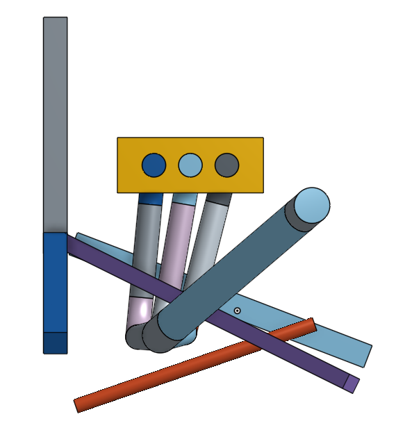

    This a long post, I know, but let me know your thoughts on my design.
    By choosing not to go with the Subaru H4 engine you take on a bunch of fabricating you would not otherwise need to do. The exhaust is one of the biggest in my view. There are no headers or kits available that will bolt on and work. You need to fabricate the entire exhaust from scratch. As I have never done an exhaust system before there was a fair amount of research involved. I ended up drawing up my exhaust using a 3D cad program so I could experiment with positioning and layout before I even started cutting metal.
    I had a few criteria in mind before starting:
    • Get the exhaust out as quickly as possible to reduce heat build up in the engine compartment
    • Design it so it can be easily built
    • Use off the shelf tubing and bends so it does not cost a fortune
    • Make equal length primary tubes
    • Try not to screw up the cars aero
    Below are my ideas and a short pro/con list for each.
    1. Run a side exit exhaust that would dump out just in front of the rear tires.
      Pros: Short exhaust run; fairly straight exit path (easy to build)
      Cons: Not much room given my cooling and oiling system (see previous posts)
    2. The traditional "out the back" idea.
      Pros: Nice looking; exits in a known low pressure area
      Cons: Longest path (most heat transfer to engine bay); most costly; most difficult to build given the space constraints
    3. Straight Out the bottom of the car.
      Pros: Shortest possible path (least heat transfer to engine bay); easiest and cheapest to build
      Cons: Screws up the under car aero; its so short the wide band O2 sensors would not read accurately
    4. Out the top through the humps?
      Pros: Short exhaust path; easily fabricated; different and unique
      Cons: ?
    After much debate and mock fit ups I decided to route the exhaust vertically out the top of the car through the engine double humps. I know what your thinking, that will look like a Peterbuilt truck! I thought the same thing at first, but think of the Porsche 918. Pretty slick I think.
    Now hide those pipes behind a set of Mechie Hump vents and you have a very cool exhaust (pun intended). Hidden design, short length, good impact on aero, easy to fabricate. I have my winner! To ensure the exhaust exits and does not swirl about in the engine bay, I will build boxes under the hump vents that will seal against each exhaust pipe.

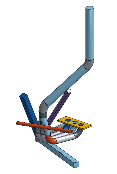

    Here are some 3D CAD drawings of my exhaust design with the key frame rails inserted to ensure fitment.
    The yellow rectangle represents the header flange, the redish orange cylinder is the rear top trailing arm (the one with heim joints supplied with the kit)
    Isometric view from the back corner, just in front of the passenger rear tire:
    View looking straight down from the passenger hump:
    MK3.1 Roadster completed 2011
    818R built with EZ36R H6 completed 2018
    818R rebuild with a JDM Honda K24A
    Denver, CO
    1,363
    I am really sorry, but I recommend you evaluate the airflow first. I have cut out the humps for the vents on my car. The fumes from the engine come right out into the cockpit. I can only guess that air circulates and swirls into the back of your head.
    It is sometimes overwhelming, I can't image what it will be like getting direct exhaust fumes into the cockpit area. It may asphyxiate you.
    Denver, CO
    1,363
    I also saw some of the first 918s, as they were driving through Denver for high altitude testing years ago. The ones that were still uncovered at the Marriott all the drivers were staying at had black soot on their deck lids. Maybe it is something they fixed, but I am guessing it will be a problem for sure on the 818.
    Denver, CO
    1,363
    I am not saying it can't be done, but I strongly advise you to be careful. The last thing you would want is to pass out while driving.

    Quote Originally Posted by bbjones121 View Post
    Remember I am building an 818R so no windscreen and decent airflow over the rear deck, at least compared to the 818s.
    I figured that might be an issue. I will most likely paint the humps black to minimize any sooty appearance between washes. I imagine that is why Porsche has those blacked out tray inserts around the exhaust exits as well.
    I have thought about this extensively and will definitely keep an keep eye on this during testing. I plan on using wool tufts attached to the body to double check for proper air flow direction. Thank you for pointing this out though, for those building an 818S this would be a bad idea!
    Quote Originally Posted by flynntuna View Post
    Remember he's has a R. So no windshield . I'm wondering if your using a muffler of some sort. Not much room except for a glass pack if that I would think . I'm liking the idea, I'll be doing my exhaust soon enough. I love this thread, so many great ideas.
    You are right, no mufflers or cats . There would be room for a muffler in the vertical section at the end, its about 15" long, if I needed one.
    And there is a backup plan. Should the vertical exhaust exit prove to exhibit back flow or be too messy, I can turn the pipes rearward just before they angle into the humps and exit them out the rear of the car. This keeps the manifold and collector section intact and (the hardest part to fabricate). I would only have to discard the two small sections of pipe after the flat merge collector and fabricate the relatively straight new sections needed to exit the rear of the car.

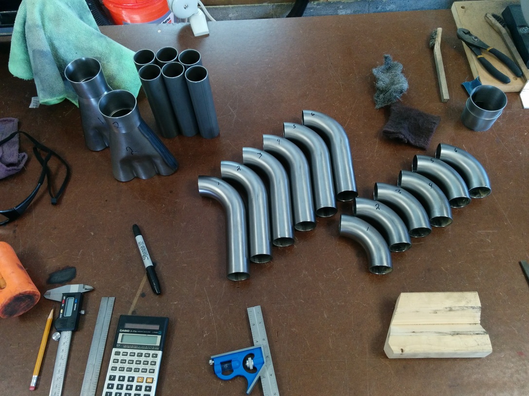

    Header Fabrication Begins!
    I have begun work to fabricate my custom headers. I have all the primary tubes, bends, and flat merge collectors as well as the header flange plates ready. Just waiting to build up the courage to light up the TIG welder and assemble the manifold sections .

    Such a cool build! I can't wait to see it on the track. Any idea how much WHP you'll be making?
    As for the exhaust, If you are NOT running a windshield (which I'm assuming you aren't since you have an R), then I don't think you are going to get fumes in the cabin. It's the low-pressure created by the windshield that causes the exhaust to be pulled forward into the cabin. It is, however, going to be very loud! But I'm sure that H6 will make beautiful music.
  10. #90
    Denver, CO
    1,363
    Sorry, you should be good with the R. I look forward to seeing it when it is done.
    It was late last night and I got worried for you...

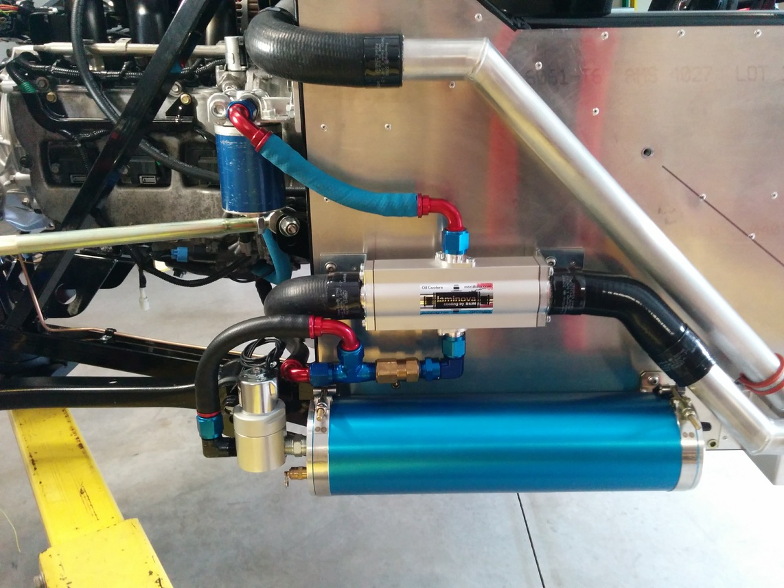

    Oil System Completed
    I completed the oiling system today. I removed the small factory oil to water cooler and added a take off plate so I could route the oil to my external filter. From the filter the oil goes through a much larger oil to water cooler and then it passes through a one way check valve on its way to both the Accusump oil accumulator and finally the engine. It turned out nice and compact

    Looks great,
    Are you going to have a way to measure/adjust the air side of the accusump without tacking off the side sail?

    Looks great,
    No, if I need to change it I will have to remove the side panel. But, all the panels are attached with rivnuts so it would be possible. I have never had to change the pre-charge on the Accusump in previous installs, so I do not think I will need to this time either.
    Hmm... now that you brought it up, maybe I'll drill a hole in the side panel to access the valve on the back of the Accusump. This way I would only have to remove the door to adjust it.

    Quote Originally Posted by Hobby Racer View Post
    I would run a piece of brake line to a remote schrader valve with a viewable gauge. We checked ours whenever we checked the oil between each run.

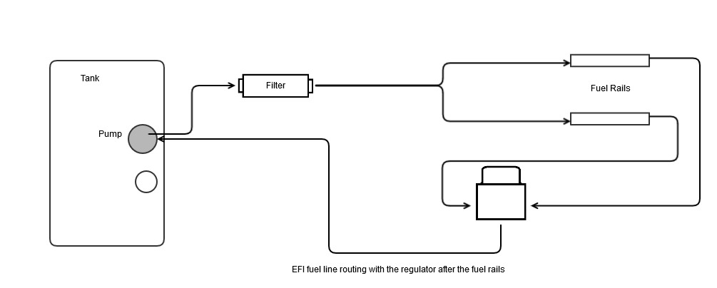

    Fuel Rail Modifications
    I am not going with the OEM return-less fuel setup that Subaru uses, but instead I am using a return system with an external fuel pressure regulator. This of course means the stock rails will need to be modified as they dead end and have no way of returning fuel to the regulator.

    Are you going with a return system to insure fuel pressure under race conditions? Do you see any reason not to keep it return less, I mean Subaru had a reason to use that system right? My car will primarily be a street car, and I don't think I'll be adding any major power adders like a supercharger or turbo. Is your choice of ECU a factor in the decision? I'm a little confused.
  29. #109
    Senior Member Hobby Racer's Avatar
    Syracuse, NY
    1,331
    I am using a MegaSquirt 3 Pro aftermarket ecu. It is much simpler to use a return type system than to try and get the factory setup to work with the aftermarket ecu.
    And yes, using an Aeromotive fuel pressure regulator.

    thanks. When did megasquirt make an ECU available for the ez36? I heard a year or two ago they were looking into it. I was considering using the Haltec because a buddy is a dealer, but more tuners around here are proficient with megasquirt .
    Also, your two into one coolant line looks to have a bend were the bung is, did you heat the pipe to bend it?
    MS3-Pro ecu is a universal standalone and can be configured to run almost any engine. In particular, they have a cam/crank trigger for the Subaru 36-2-2-2 crank wheel which is used by the ez36r. It can also control the 4 VVT cams so its a nice fit. You do need to splice it into the factory harness though, it is not plug and play.

    Which one are you using? The Aeromotive 13109 has a return fitting built into the regulator.

    Which one are you using? The Aeromotive 13109 has a return fitting built into the radiator.
    I am using Aeromotive 13129, very similiar, just a slightly different pressure range.

    That one has a return line as well. Just curious, but why modify the rails when you could use the return line off the FPR?
    It is possible to run the regulator in that way but they are most efficient when run on the return side of the fuel system. This way fuel flows through the rail constantly and the pressure is more precisely regulated. That is why they have two inlet ports and one outlet port. Each rail feeds into a separate inlet port and the excess fuel is returned to the tank via the single outlet port.
