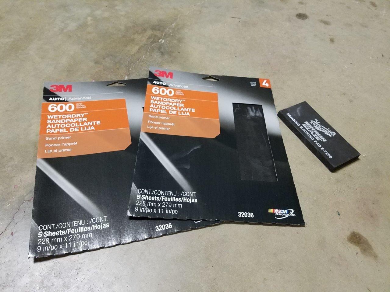

    Well, hopefully I am finished with dry sanding. While blocking does have a certain initial satisfying appeal, the dust is never ending, annoying, gets in every crack (garage, car, even you), and eventually becomes the bane of your existence. I went over the body one more time with a hand held light and cleaned up all the small areas of orange peel I missed during my blocking effort over the past few days. I also found two small pin holes and two small uneven spots on the door jambs. I filled those with glazing putty and got them sanded down. I will check everything one more time before wet sanding with 600 grit. Here she is.
    I also needed to knock out a few items before paint. I got the side louver mounts installed. As I mentioned earlier, I am using the method Edwardb shared in his build thread. Attached perforated base studs and 3M HSRF. Probably a little over kill but I like the idea that I can remove the louvers. It makes getting the side pipes off and on easier (at least on my car it does). Here is the rough finish. I will sand them down to make them smooth and more presentable. No one will ever see them but I want it to look nice if they do. If you are going to do it..... do it right.

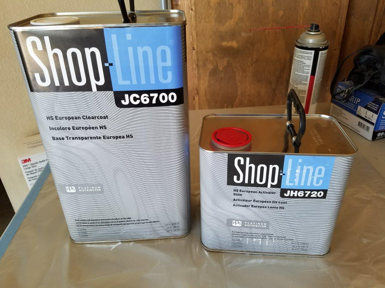

    I also picked up some sealer while I was at the supply shop picking up my oops paint. It was the last gallon of 335 they had so instead of risking a delay, I thought I would go ahead and pick it up. I certainly hope I don't need a whole gallon but it is a 4:1:1 mix ratio sealer that says I only need one coat. I figure it will take about 1/3 - 1/2 a gallon to cover all the panels and the body. If I mess up, I will have some extra.
    I will start wet sanding this week (hopefully tomorrow after work) and will try to finish this weekend. Each round of blocking has taken a consistent 8-10 hours. I suspect wet sanding will be no different even though I will be using a small pad instead of blocks. Is this the right tool to use?
    The sand paper says NASCAR Performance so it must be good.
    I am going to try a guide coat as well as without on the under side of the trunk first. I have never wet sanded with this fine a grit so I would like to see if the guide coat helps or just makes a bigger mess. I will try and take some pictures for comparison.

    Oh ! My! god ! you are such a rookie ! First off...NEVER BUY NASCAR SANDPAPER !!! DUDE ! You can only sand to the LEFT ! So, Yes you need to use your guide coat. It will let you known when you have all the 320 scratches out. The dry guide works fine wet (I do it all the time on small parts ). Ok, I'm trying to figure out how to splaine this. You fold the paper in half and tear or cut it. Now you fold the half into 3rds (should come out about the same size as the block) DON'T USE THAT BACKING PAD !! I don't freeking care what anyone says ! Get the one with holes n it that looks like thick wet suit material. DO NOT ! fold your paper around the sanding pad ( I will pull your ears of). You place the paper on the pad and using the tip of your pinky finger wrap it under to secure the paper. With your three center finger running the length of the pad keeping even pressure. Moderate pressure, pushing hard is bad news. ( This is GOLD,,, I don't share this with just anyone) (you're lucky I'm drinking tonight) (hell, I'm lucky I'm drinking tonight ) You sand at 45* angle with 50% overlap and then reverse the angle so that you are cross cutting. When the guide coat is gone do a front to back (linier) clean up pass to smooth things over. Short strokes (8-10 in) If you do long strokes and pick up a little sompin sompin you'll put long scratches in the primer (bad news). Short strokes and pay attention to the feel and sound to avoid crap getting under your pad....lots of water to flush away primer silt ! You gotta keep it flushed or your paper is just floating on the silt (and you thought the dust was bad....just wait till you deal with the goo you are gonna make) SO ! One piece of paper (I am talking about the half piece you have folded into 3rds) will do the top of the hood. The deck lid...2 sides one left over...the nose "between the fenders" 2 sides" the cowel" (between the fenders) 2 sides. The back...around the roll bars between the fenders 3 sides....Trying to give you an idea of how often you need to turn your paper. It's only 600 for the first ten licks...then it turns to 700 then 800. You need to keep a good cut and leave an even scratch (painters call it "tooth") for the paint to grab onto.....lots of paper, lots of water "little squeeze of soap" Watch the edges of that paper as you make those left hand turns so as ya don't be gougen the primer....so much more but I put in a 17 hr day and I need to get drunk in the shower (saves time, don't need a chaser) and hit the rack. Cheers...da Bat.... damn it son,,, you get this dialed in and you can go broke working for me !

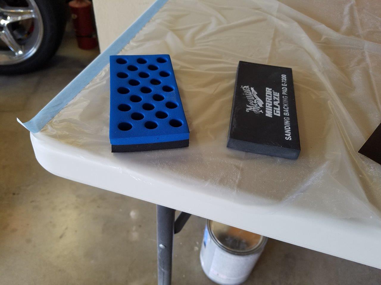

    I ordered one of the pads you mentioned. My local shop didn't have one. Here is a link.
    Motor Guard HT-1 Holey Terror Sanding Block https://www.amazon.com/dp/B003WUYG1O..._kdHBzbH3WMP32
    I was wondering if I could just use my current pad for a small test? I am impatient and Amazon next day delivery just doesn't satisfy my need for instant gratification. What about a scotch brite pad as a backing?
    If not I guess I will just wait one whole day.

    Yes, I'll let you practice with the one you have. Now you will have two and be able to see which one suits you.....Left handed sand paper.....who ever heard of such a thing. Sheesh

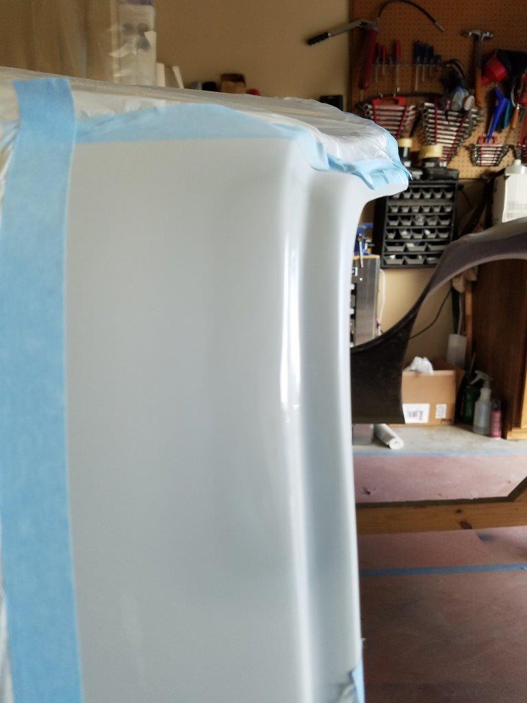

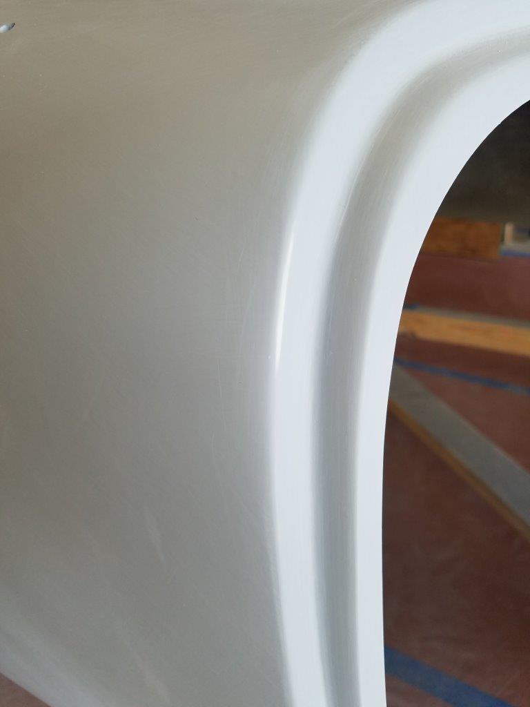

    Another update
    Sorry for the seemingly daily posts. I am sure not everyone wants to read through this thread but it is a way for me to capture my learnings while they are fresh in my mind. So I tackled two items tonight. First, was a burn through I needed to fix and the second was a test with wet sanding. First the burn through.

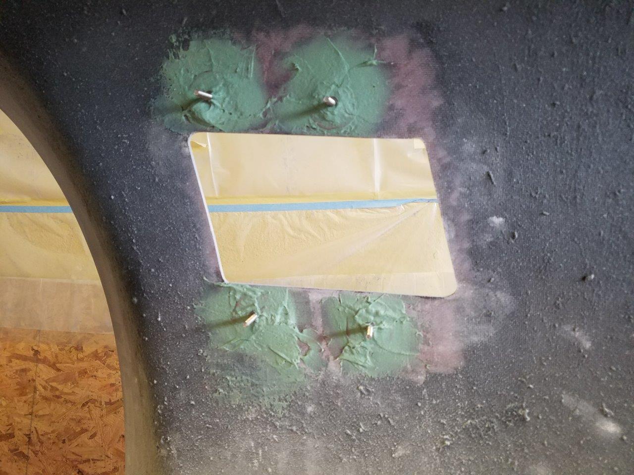

    My Jedi Master (aka Jeff Miller or da Bat) told me that the only reason to worry about burn through on the 2K primer was if I sanded to filler. Well, I was cleaning up a glazing putty spot and found this:
    It wasn't large but it looked a little yellow to me. Slick Sand is gray and this seemed to be some Rage Gold. I wanted to do this right so I broke out the gun and 2K and mixed up a small batch. Plus, this was another way for me to test my newly acquired gun set up skills and work a little on my spraying technique. I had spotted some 2K before on the hood and trunk and had terrible over spray. That was the sand paper feel I had described in earlier post. Since I have a better understanding of my gun, I did two things. One turned the fan down to about 25-30% open. From 4-5" away I got a 3" fan width. That seemed right for the small touch up. Secondly, I set the fluid flow to about 1/2 to 3/4 a turn open. I did some tests on my trusty poster board and I liked it. I got a little closer (4-5") and applied a medium wet coat. Here is a picture of the first coat.
    Virtually no over spray or orange peel. I had suffered from both earlier and it seems my new set up is much better. I contribute this to my Jedi training. I am still a Padawan but at least I can turn on my light saber. After three coats, I had a really smooth application. Two hours later I blocked it out (I know, more dry sanding) and it it all fixed. I wish I had this knowledge and set up prior to spraying the 2K. It would have minimized my sanding efforts. Well, I got some exercise and hard work never killed anyone.
    Now for the wet sanding test. Miller gave me the thumbs up to try my rubber sanding block. It worked but I will test my new one tomorrow. I used a guide coat on most of the trunk but left a little spot clean to see how it worked. The guide coat is much easier. It is easy to see the 320 grit scratches and when they disappear. This picture is not great but you might be able to see the remaining guide coat on the left.
    I started sanding and before I knew it the underside of the trunk was done. This wet sanding went a lot faster and much easier than dry sanding during my earlier blocking sessions. It takes 2-3 sanding passes and the front to back stroke and I could move on. I worked in small areas and it was easy. It went so easy, I went ahead and knocked out the top of the trunk lid as well. The whole process took maybe 30 minutes. If the rest of the wet sanding goes this smooth then it won't take me 8-10 hours like the other sanding sessions. After sanding I washed the trunk off with a hose and snapped this picture. I thought it looked neat. It is so smooth. This is the first time it has looked this way. I hope the paint turns out this smooth.
    As usual thanks for following along, let me know if you see any issues, and thanks for the continued support.

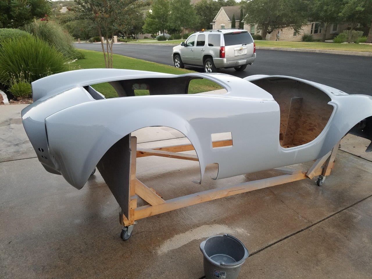

    Wet Sanding is done
    You guys come on. I will supply the rum, lazy boys, and you won't even have to share a bedroom.
    I finished wet sanding everything with 600 grit tonight. Took me a total of 4 1/2 hours to complete this round of sanding. That is about half of what it took to block out everything dry. Much faster and much easier. Here are the two backing pads I tried. The one of the left was the type I think Jeff Miller recommended. It is a little firmer and I like it better for the large flat areas. The only problem is was just a little too thick and I found it hard to get the paper to wrap around both edges so I could grasp them with my fingers (that is with 1/2 a sheet folded into thirds). The smaller one on the right was easier to keep the paper on the pad and had a little more give which worked nice on the curves. I struggled at first with the paper staying on the pad but found that if I could just get one side held down with a finger on the edge (pinky worked best) then the water would allow a slight suction to hold the paper to the backing pad. It is hard to explain but if you try it I think you will see what I mean.
    I found that Jeff Miller's account of paper use was about right. It took me one and a half full sheets to do the driver side front of the car. The back driver side took one full sheet. All together I went through about about 5 sheets on just the body. The panels took another 3 sheets. I bought two packs of 10 sheets and have one full pack (unopened) and two sheets left over. That might help someone in the future as they start to buy material. I will hang onto the unopened pack in case something goes awry but hopefully won't need it and can take it back.
    Here is shot of the finished product after wet sanding. I found one small pin hole I missed on my previous inspections. That guide coat really helps identify these issues. I will fill it with glazing putty and wet sand that area.
    I just love the way it looks wet. I hope it looks that good when I finish the paint.

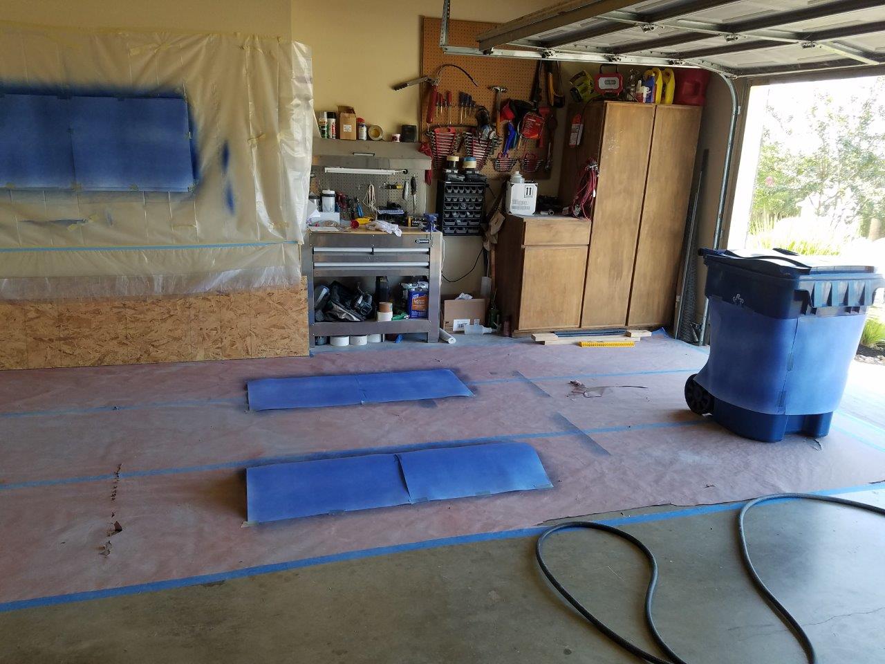

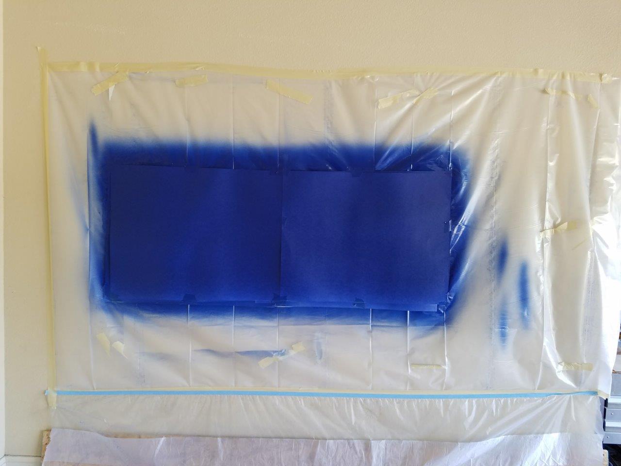

    My next move will be to wash the body, panels, buck, and panel stands. I was planning on using a washing cloth or sponge. Something soft that won't scratch. Is that ok or should I use something like a gray scotch brite pad? I will wash it with water and just a little dishwashing soap. I will wash it twice and rinse it real good and then air dry. I will use a stiff bristle scrub brush to clean the underside of the car, the buck and the stands. I should finish that tomorrow evening of Saturday morning. I will then have he remainder of the weekend to clean the garage real good (walls, floors, garage door, etc). I will mop the floors and wipe everything down with a wet rag.
    I will then practice spraying some paint. I plan on wrapping the poster board around my trash can. That will simulate the ends of the car. I will also lay a roll of plastic on the ground and lay the poster board on top of that with the edges taped down. That should simulate the humps on the car. I will practice both of these until I have good smooth coverage after three or four passes with no striping or uneven coverage. I will have the weekend and the first part of next week to get that part dialed in. Should I practice with some clear coat? Or does it spray about like the basecoat?
    If all goes well, I would like to paint next weekend. I am going to work on my painting plan. I will share that in the next couple of days for input and advice. More to come. I am getting close.

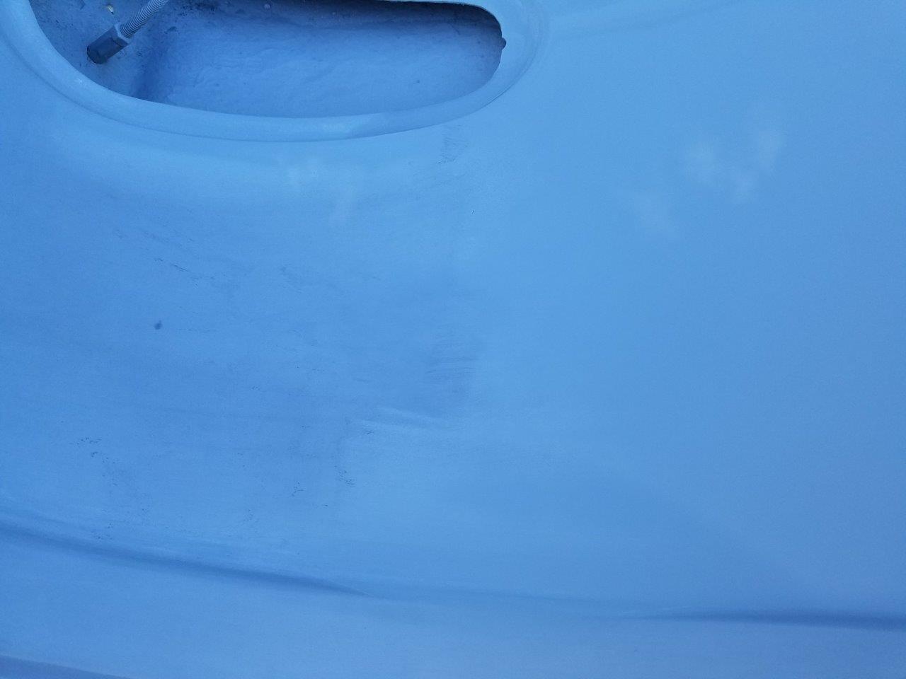

    In all my excitement to finish the wet sanding, I forgot to mention I did find another spot of burn through. On the front cockpit roll. Just a small spot but definitely some Rage Gold showing through. I touched that up this evening. The JP202 laid down really smooth with no overspray. Thanks again to Miller for the guidance on gun set up. It is smooth enough I think I can just wet sand and be done. I will do that in the morning then wash the body, buck and stands. The rest of my time tomorrow will be dedicated to practicing with paint and clear. I picked up a gallon of JC6700. Supposedly this is their good stuff in the Shopline category. I got the slow activator JH6720.
    I think I have plenty and will use a little to test. I will post some pictures of the tests for critique and comments.

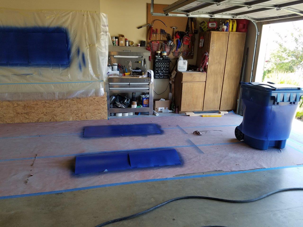

    Forgot to ask my question. I am planning my painting set up/sequence and could use some guidance. As I see it I have two options.
    Option 1:Put all the panels/body in my two car garage and paint everything at once. Convenient but things are tight and I am concerned about overspray, good air movement, and bumping something.
    Option 2: I can paint the panels (doors, hood, trunk) and the body separately. That gives me more room and lowers the risk of overspray
    I am leaning towards the two separate sessions but things get tricky and I risk dust and contact. If I do things separately Here is what I am thinking:
    1. Move the body outside and set up the panels. Apply 2K sealer. One coat per the product sheet and let it flash. Does anyone apply more than one coat?
    2. Spray the stripe color on the hood and trunk. I was not going to tape off the bottom. Enough coats for coverage (3-4 I hope). Let it flash good.
    3. Move the panels out of the garage and roll the body in.
    4. Apply 2K sealer on the body and let it flash
    5. Spray the stripe color
    6. Take my hood and trunk off the Kleiner flip flop apparatus and Bring them back in
    7. Tape the stripes after a good flash per the product sheet.
    8. Body back out side and all the panels come in. Hood and trunk back on the flip flops.
    9. Spray the color on the panels followed by the required flash
    10. Spray clear on the panels then move them to the front of the garage
    11. Bring the body inside and spray color then clear.
    Seems like an awful lot of finagling but I am concerned mostly about overspray. I know I said that seems to be solved but I only get one shot a the base color. If I mess that up I am sanding and respraying. What do you guys think here? I might try to post a layout of my garage. That might help some of you provide feedback. Let me know if I am missing something.
    Thanks in advance.

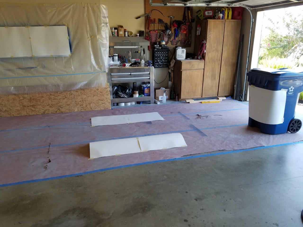

    Garage layout

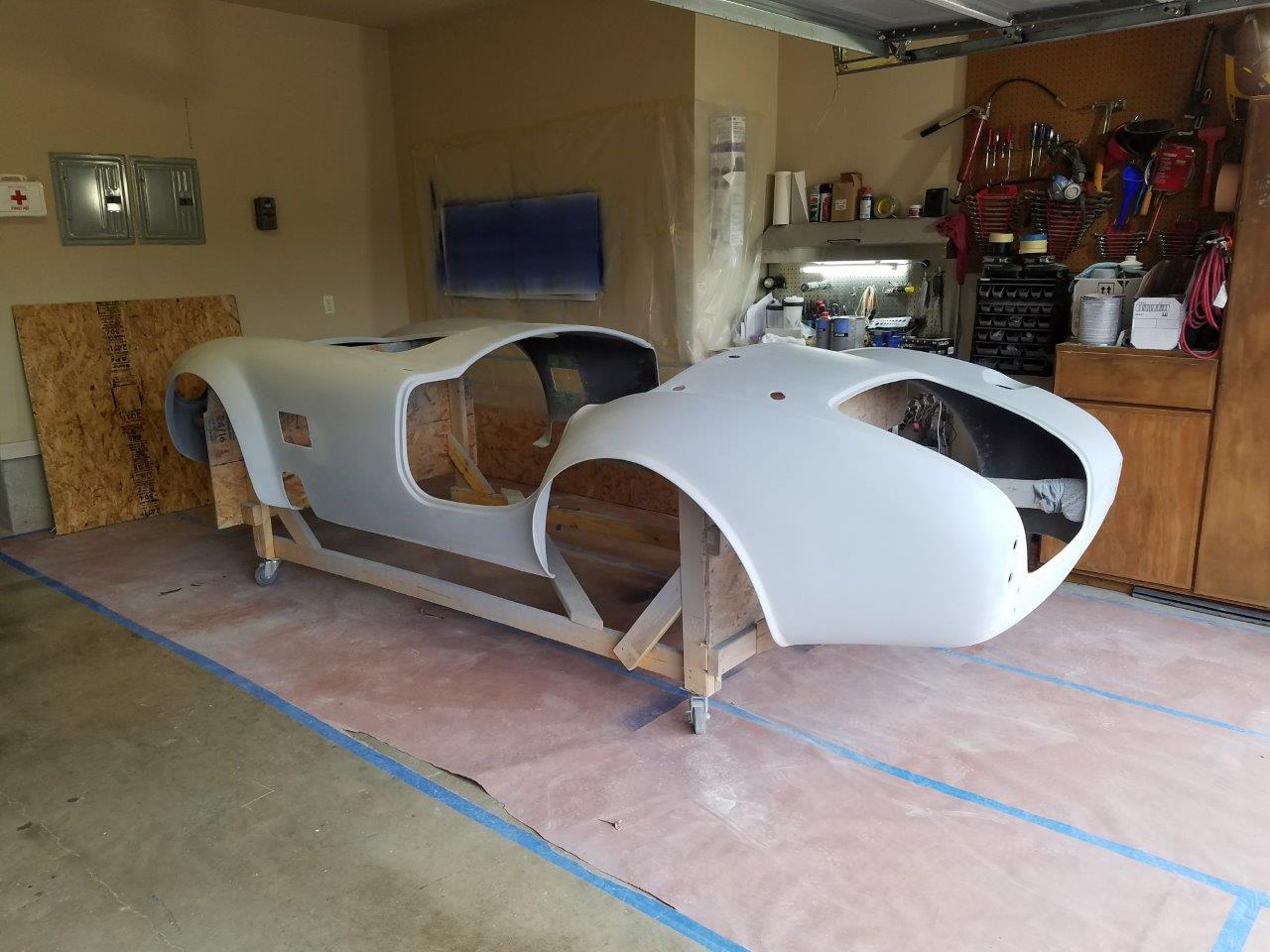

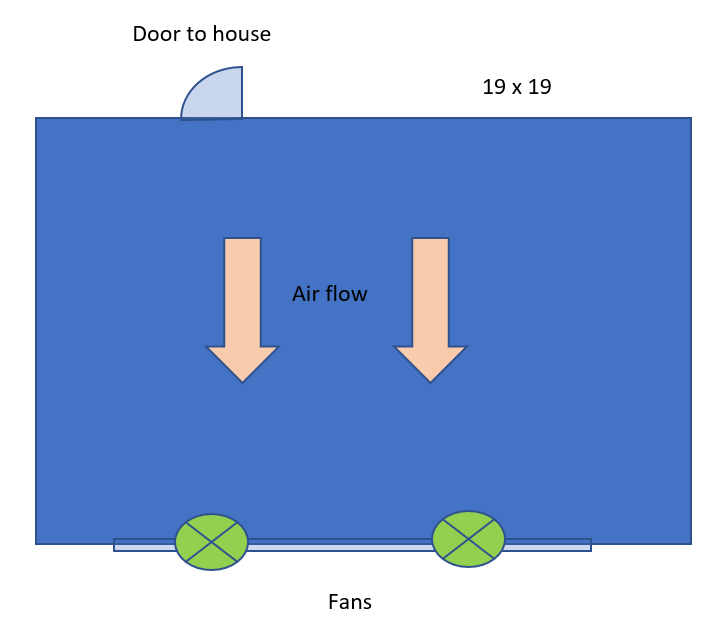

    Here is my garage layout. The airflow is per Jeff Miller's recommendation. The fans will be on the floor with the garage door shut down to their height. I will put plywood panels on each sides of the fans and on the door to the house. The house door will be open and that panel will have a hole with a filter.
    Everything will fit inside (this is how I applied the 2K primer) but it is tight. Thoughts and suggestions are appreciated.

    Paint practice
    I got the body and panels washed. I used just a few drops of soap in a 2 gallon bucket. Washed everything twice and let it air dry. Also got the buck and stands cleaned up. No exciting photos of the cleaning. But I did some practice painting.
    I set up a painting "obstacle course".
    I had two flat surfaces (vertical and horizontal) as well as two curved surface.
    Set up my gun like I did the other day, 1.5mm nozzle,50-60% fan, and just slightly over 1 turn out on the fluid flow (1 1/4). Put down a first coat.
    After three coats I almost had complete coverage. It looks thinner than it is. Some of those light spots is just glare.
    This give me an idea of how many coats and how much paint I will need. I put all three coats and a fourth on the poster board on the wall. This took about 1/2 a pint (premixed). A gallon of paint should be plenty.
    Here is the fourth coat on the wall.
    I really didn't have any issues to this point. My technique is getting better and I feel more confident. I then decided to test some clear. I mixed up just a little to spray on the poster board with 4 coats. Here is a shot after two coats and a 15 minute flash. It is pretty smooth considering the poster board is not perfect.
    The clear is thicker. I was using the same nozzle/needle but I had to open up the fluid flow. I like what Jeff Miller said about not changing my technique. I will have a hard enough time keeping one technique in check, I don't need another to confuse things. The little extra flow allowed me to keep the same distances away and about the same pace of spraying. I noticed something a little different about the clear. When I first sparyed it, looked like it had a little "roughness" to it. But within a 3-4 seconds, it would "flow" out and become pretty smooth with a wet look. This is the first time I noticed what I think painters are calling flowability. It was pretty cool.
    I have another pint of oops paint the I will practice with some more over the next few days. I will also play with my garage arrangement in preparation for paint. I will try to do as Miller says and see if I can find an arrangement that will allow me to paint everything at once.

  30. #190
    1,113
    I like the fan pattern on the paper. Looks good. If you want to save room, shoot the bottoms of your hood, deck, scoop....let them dry a couple days. Get rid of the flip-flop tables and this should give you a little more space.....good practice brother
  31. #191
    Senior Member srobinsonx2's Avatar
    San Antonio, TX
    325
    I like the idea of painting the bottoms. More practice. Do you tape the top off during that part? Would you recommend just sealing the bottom or seal it all at once and scuff up the top prior to base?
    The flip flop tables take up a lot of room. just having them on stands would make my life much easier.
    FFR MK4 Complete Kit #8952
    Bodywork Thread
    3 Link Rear Suspension, Gordon Levy 347 SBF with T5
    First start Feb 20, 2017, First Go Kart March 5, 2017, Registered & Title April 25, 2017
  32. #192
    1,113
    Sooo, for me, I don't finish sand the tops till after I paint the bottom....with yours already being sanded I would say Yes, mask them. I know you have washed your parts but they will have been sitting for a few days...no big deal...when you are ready to paint you want to go over the parts with a gray scotch brite, blow them off, tack them then spray.....just to get "fall out" pollen, little teeny tiny bug turds, hand prints...etc off before you paint.....if ya need me ta hold your hand I'm just a phone call away.anytime...(damn near as excited about your paint job as when I paint mine)...da Bat
  33. #193
    1,113
    Oh ! Just seal the side you are painting.....we're just trying to get this bird in the air and back on the ground in one piece.....save the acrobatics for the pros. (jeez I crack myself up) xoxo
  34. #194
    San Antonio, TX
    325
    Thanks Jeff. I am getting exited and a little nervous. I took the flip flop parts off the panels last night and played with my garage set up. Much more room and doable. I am going to paint it all at once like you recommend. Well, all except the underside of the trunk an hood. I am going to paint those this week. Either Tuesday or Wednesday. If all goes as planned I am going to paint this weekend. I am developing my plan and will post some details later. I know, I know. Some of you are saying.....your over thinking this....Get er done! But I'm an engineer so planning is part of the fun. Plus my wife says I have a little OCD. I am going to need a plan to address that.
    I am going to pick up the paint today at lunch. Getting close.

    I am committed now. I purchased the paint yesterday and the rest of my supplies. I picked up a gallon of the main color (PRH) and a quart of the stripe color (1D6). I also bought the appropriate amount of reducer in JR507. This is their slow reducer for 75-85F. I also picked up some tape. They had a few kinds so I picked what I thought was the best. I got some vinyl tape that I plan to use as the outline of the stripes. I will then use the green tape (more like traditional masking) along with some paper to fill in the stripe. All of the tape for this part was 1/2". I also got some wider green tape incase I don't like the paper. I also picked up some 1/4" vinyl tape. I will use this for the 1/4" "pin stripe" just outside the main le mans stripes. I struggled with how I was going to get this stripe laid out perfectly. Since I am going to have the 1/4" stripe, exactly 1/4" away from the main stripe I am going to use the tape itself as a spacer. So, I will lay down a 1/4" tape line right next to the main stripe. I will then run a second 1/4 tape line right next to the first. I can then pull the first tape line (the one in the middle) and should have a perfectly spaced 1/4" stripe. If there is a better way just let me know. Here is pic of what I bought
    So I have contemplated how I am going to actually do the painting (time of day, sequence ,etc). Here is my plan. Feel free to critique me:
    - Wedensday eveneing: Paint the underside of the hood scoop, hood, and deck lid. Sealer first, followed by the main color and clear. Tops will be taped
    - Thursday evening: arrange the garage for the main painting session. Remove the tape from the top of the painted panels and re-tape the bottom
    - Friday morning: 4 AM sealer is applied
    - 5:30 Apply the stripe color to the center of the body, hood, and trunk. 3 coats or until full coverage (10 minute flash between coats)
    - 8:00 AM (after a 1 hour flash) - tape off the stripes. I assume this will take me 2-3 hours to get it perfect. It will then be 11 AM and getting hot. Wait for evening
    - 10:00 PM - spray the main color on all panels and body. 3-4 coats for full coverage with a 10 minute flash time.
    - 1:00 AM - pull tape and spray clear. 2 -3 coats with 10 minute flash time.
    If I make a mistake (runs, accidental contact, big bug) on the sealer or paint, I plan to stop at the point of the mistake. Let it flash completely (essentially cure) then wet sand with 600 grit and re-coat. If a mistake happens on clear then I was going to just going to deal with it once the clear is done. I will of course remove any trash if it happens to fall into my clear but runs I will just fix later.
    As a note, I was going to tack the car off between coats after it has flashed and just before apply the next coat. I thought this might help reduce any risk of having some overspray that had dried. Is that a good idea or not?
    I am getting excited. I took off Friday and Monday so I will have adequate time. Wish me luck and let me know if I have missed something.
