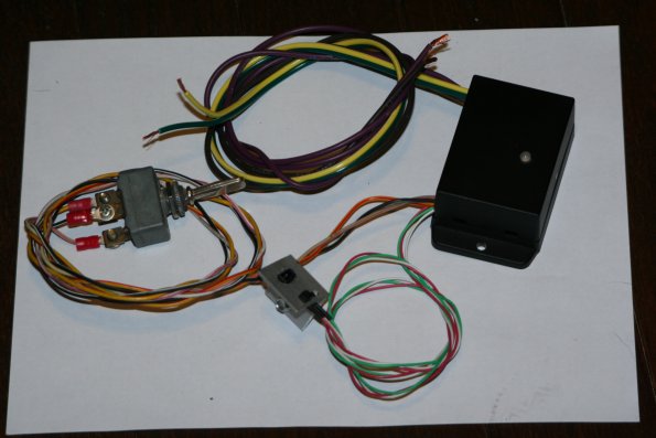

    This weekend, I tackled the wiring... including an OpenSource solid state self canceling Turn Signal module that I've been designing and building. This is still in Early Alpha.. .and actually un-street-tested.. but.. I just had to share it none-the-less.

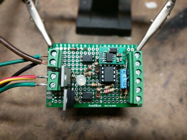

    So.. I'm no Electrical Engineer.. I'm a self-taught DIYer. I've built a few etched circuit boards and built a few different circuits. But. .I am a Software Engineer by profession, so the programming of a ATTiny85 Arudino was trivial. Add in a few other simple JellyBean components, and I was pretty sure I could come up with a pretty simple self-canceling turn signal system.
    It's powered by a simple ATTin85 arduino chip, with a couple of P-Channel MOSFETs to drive the hight-current loads of the signal lights. The "magic" is an Infrared sensor that can detect the turning of the steering wheel without the need for any mechanical connection. Just a bit of black paint on the steering shaft is all it took.
    Anyway.. I had been bench testing my prototype board for weeks.. this weekend I finally got to "install" it and see if it actually does what I expect it to do.. and it does!!
    The software for this module will be made full opensource, the circuit board design (it's pretty trivial anyway) will also be made full open source, as well as the PCB layout once I've done re-designing it. I'll also put together a full DIY writeup on my main build site for all to use. I tried to make it such that retro-fitting one of these into an already built car would not be too hard, and require minimal changes to an existing setup. They are still on their way to my house, but I ordered a small PVC mounting box to house the module. It won't be left perched on the frame like that.

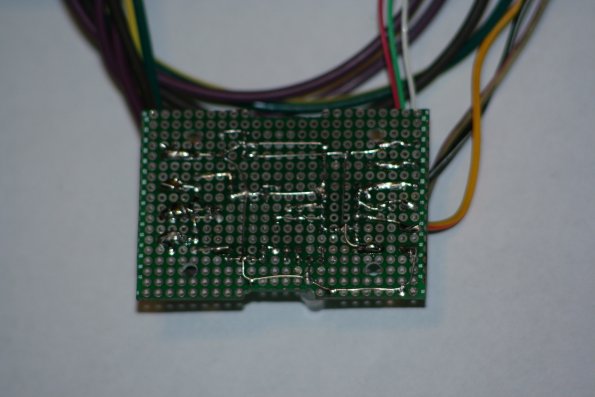

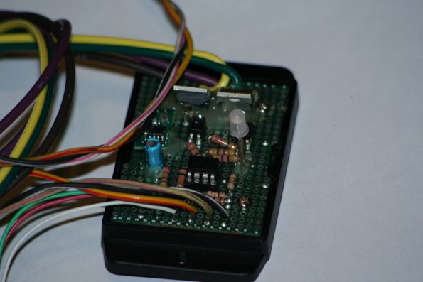

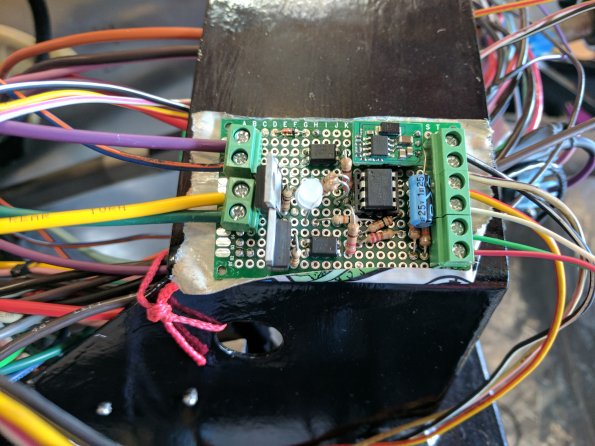

    Here's a pic of the prototype board after I was done soldering it all together

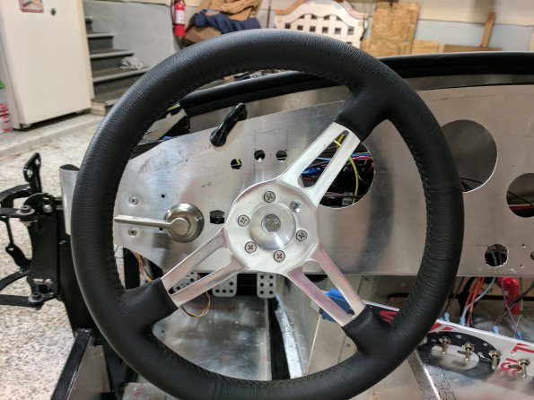

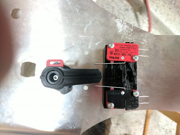

    Temporary Mounted to frame with some tape for Testing.

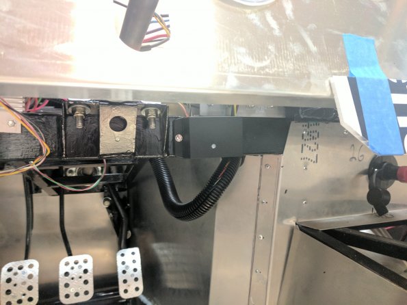

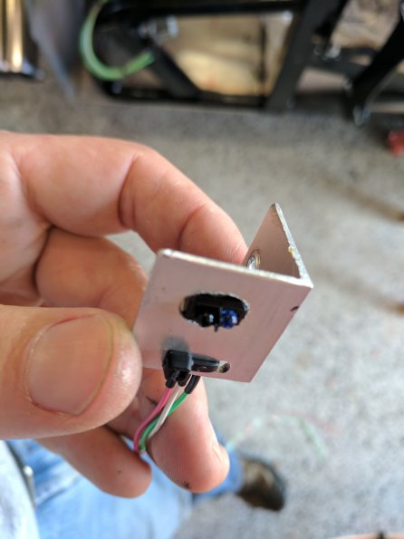

    The IR Sensor mounted in a piece of angle aluminum

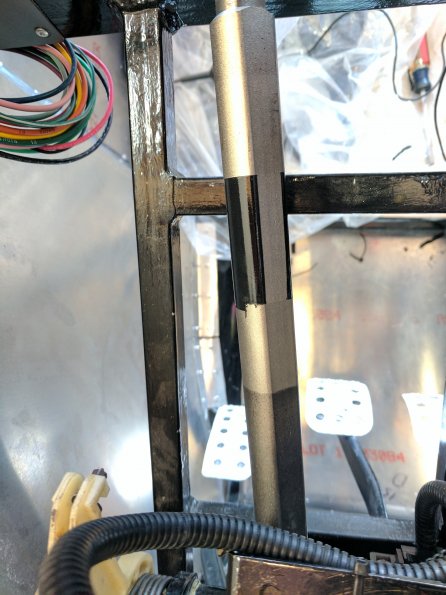

    The steering shaft with the black paint applied for the IR Sensor to detect.
    The IR sensor mounted below the steering shaft.

    The is the sensor in question is one of these (TCRT5000L).
    It has an LED IR at one side that emits an IR light wave.
    and an IR sensor beside it, that detects the IR light reflecting/bouncing back off of "something" and back to the sensor.
    Hence.. the black and not-black painted parts on the steering shaft. the black paint absorbs and scatters the IR light, so the sensor reads nothing. But, the silver reflects the IR back to the sensor, and thus can be detected by the ATTiny85
    Magic!!

    Update. Functional Prototype Built!
    I found that the layout I came up with for the PCB was pretty easy to translate onto a perf-board. So.. I did just that.
    Came out to have less, more direct traces than the original proof-of-concept.
    Top View. I soldered the wires directly to the board for added strength.
    Bottom Trace View
    Installed in the mounting box, with some "HotSnot" to keep the vibration from fatiguing the taller components.
    The complete prototype

    SWEET . . . if these go into production, how is the "black-silver" line part taken care of - some sort of tape or decal for the steering column?
    Keep up the great work.
    Doc

    The black stripe can be pretty much anything. Black Tape, Sharpie, brushed on Paint. Anything that's black. the IR sensor is pretty sensitive, and has little trouble distinguishing between black, and not-black.
    The idea of using a good quality decal is a good one. That way, the "cancel" point in the rotation of the wheel can be fine tuned. People with a 3.5 ratio rack, might want a different width black strip compared to a quick ratio 2.0 rack.
    Stabbed it in today. Next is the turn lever design. I opted specifically to put it there for easy access to the Arduino chip inside for any required software updates.
    P.S. Yes, the engine-bay harness that hangs down low in that photo will be tied up and secured out of the way.

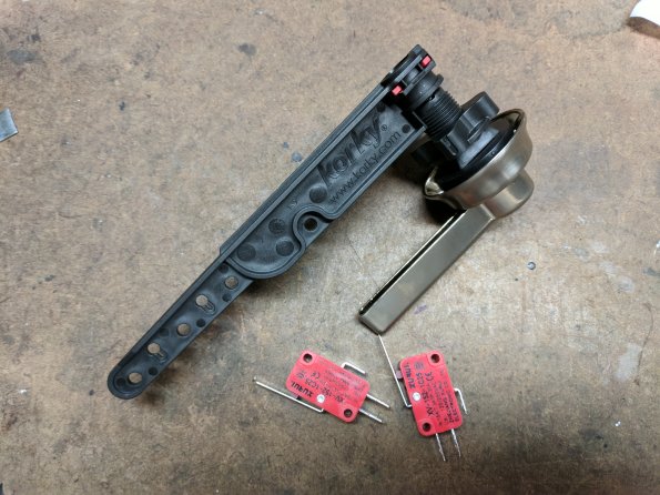

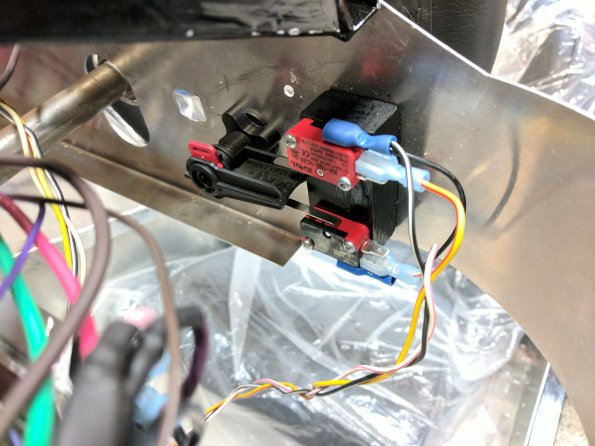

    Installed my "turn" lever today.. and it works perfectly! In fact, it might be better than I expected. It's very smooth, easy to reach, and dead simple to operate. The best part, over-the counter parts and it's a very simple install.
    The 3 extra holes you see are a failed first attempt. I'm just going to cover the back with some aluminum, and fill the minor depression with some filler.
    A view from behind with the 3 control wires connected.
    The lever has a built in centering spring to keep it positioned between the switches. Switches are mounted to a piece of 3/4" oak I had. These switches are only $8 for 5 on Amazon.
    The main parts for the lever mechanism.
    A Gold star for who ever can figure out where the handle came from? My kids think it's the funnies thing.

    Korky! I like it, can the arduino play a flushing sound when the lever is actuated?
  39. #38
    Papa's Avatar
    Mexico, MO
    5,774
    Quote Originally Posted by skidd View Post
    Is the handle for a toilet?
  40. #39
    Senior Member chmhasy's Avatar
    North CT
    443
    toilet
  41. #40
    Senior Member skidd's Avatar
    Jan 2016
    SA-TX
    644
    lol.. won't need the arduino to do that... the Carburetor already makes that sound when I press the skinny-pedal!
