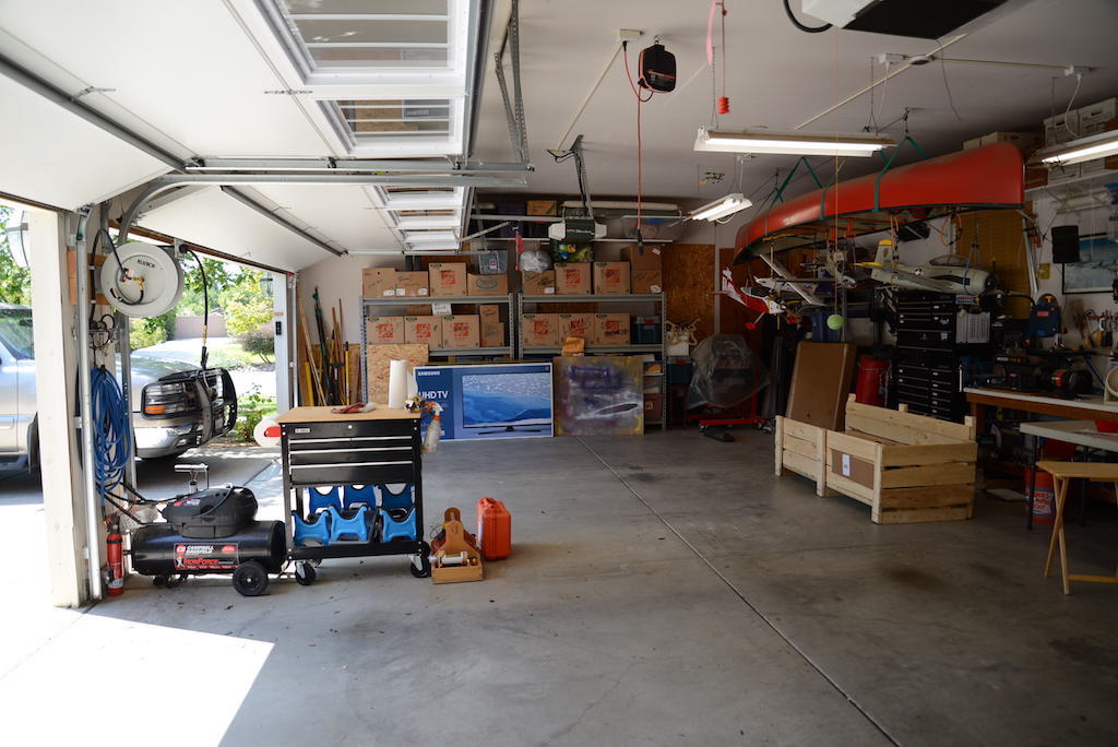

    This is my workspace
    (DSLR photo resized 1024x768)

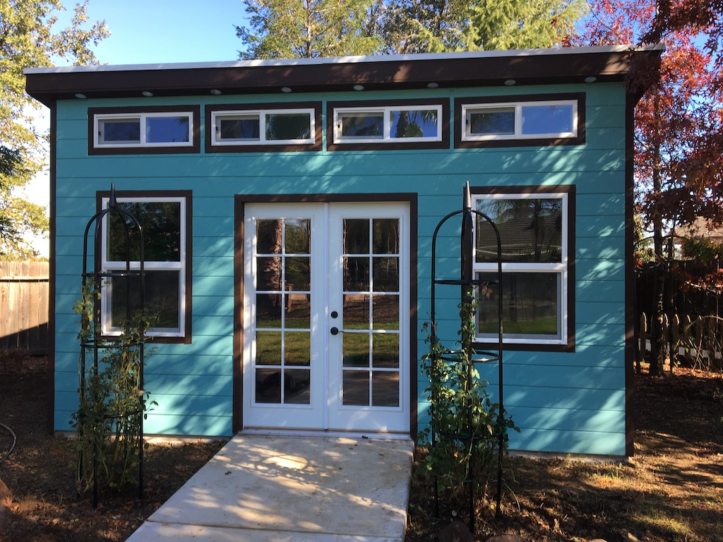

    And all those boxes on the back wall will go to my storage shed which I just built this year in preparation for a "possible" Cobra build.
    (old photo taken from iPhone resized to 1024x768)

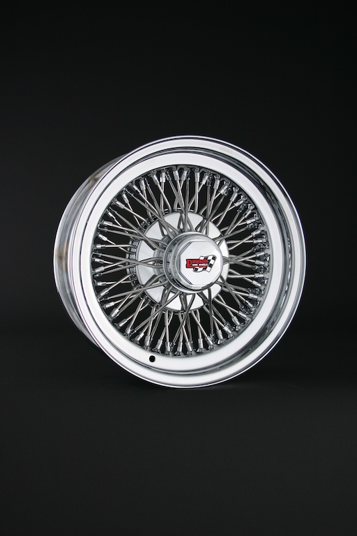

    Yes, that ERA photo is exactly what I wanna accomplish. I considered the pin drive wheels but I already made the decision and bought the regular width axles to accommodate the wire wheels. If those wire wheels don't hold up I'll go with the FFR bolt on wheels or something similar.
    The Tilton HRB is internal and I'm debating on getting the Fortes external one for ease of adjustability. For the clutch and flywheel, I still have to figure that out combo out.
    Thanks for the input guys.
    Are the wire wheels bolt on? Which model?

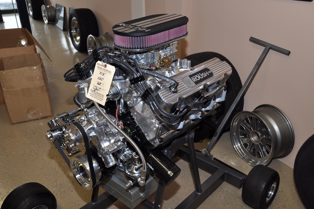

    Uploading Photos - Test2
    This engine has been sitting in my garage for the last several years
    (old photo from computer resized)
    I'm thinking I might change out the Holly carb and installing a bolt on FiTech EFI.

    Quote Originally Posted by CobraboyDR View Post
    (GReat minds, and all that. I can't get the look of that ERA out of my head...)
    They are 72 spoke cross lace knock offs

    Quote Originally Posted by Vspeeds View Post
    What sizes?
    I LOVE your build...
    Do you have a color in mind?

    CobraboyDR
    The standard wheel sizes Im looking at are 15x7 and 15x8. The wheels are pretty pricey so Ill most likely stick with standard sizes rather than custom sizes with custom backspace/offsets.

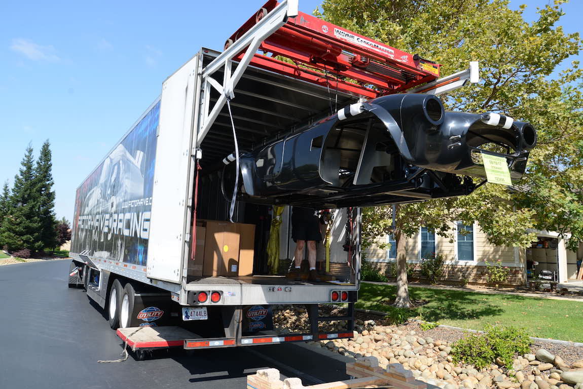

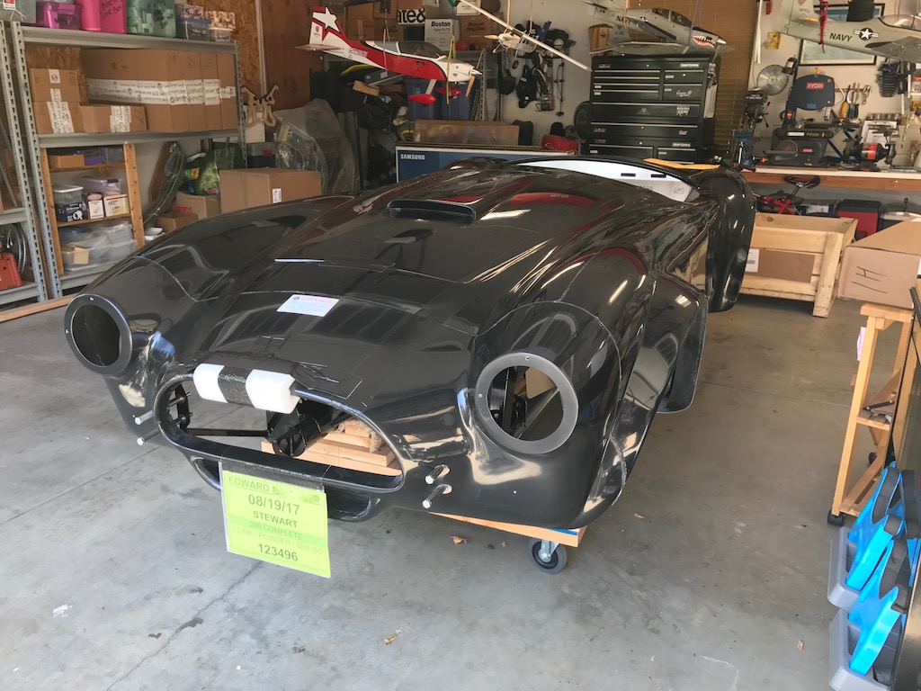

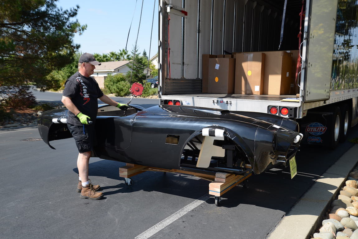

    My kit Arrived today!
    My kit arrived today! It was a smooth process. Don, the driver from Stewart Transport was awesome. He kept me informed and was right on schedule.
    After delivery I was real busy at home. Didn't even get a chance to really go over it, however I did start the inventory this evening.

    Congratulations! Seeing the fresh body with the order sticker on it brings fond memories of the trip to FF to pick mine up. As Joel says, the fun now begins! I'm ready for first prime, and have shared many pics with Joel for the dips waves and fitment issues. send your email in a pm and I'll be glad to forward. One of these days I'll have to retrain this old dog the new trick of uploading pictures directly.
    Hey Eddie,
    Now that is a beautiful engine!

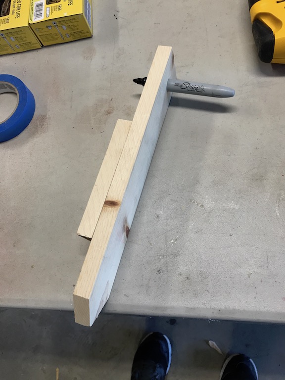

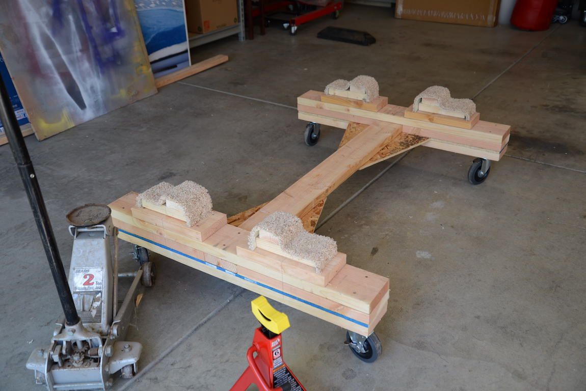

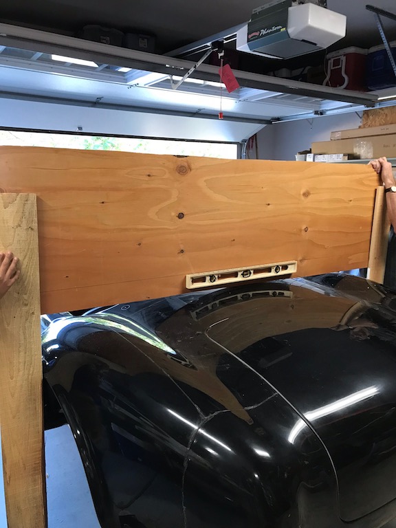

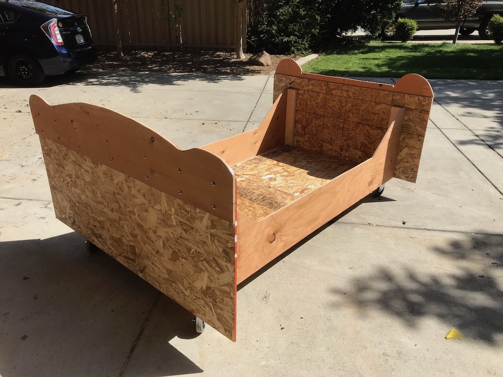

    I finally found some time today to start working on the kit. I began by running a sharpie pen along the inside body and marked the aluminum panels for trimming to get a more uniform gap between the body and aluminum panels ( it's late and I hope that made sense.)
    I also made the body buck. I placed a plywood board on top of the body and made sure it was level. Then I made this little contraption to trace out the rough shape of the body onto the board. I cut the plywood a little smaller to compensate for the difference between the upper and interior body. I then mounted the cut and shaped plywood onto an OSB board and finished the rest of the body buck. I then removed both doors, the hood, and the trunk. I removed the body, placed it on the buck, and called it a day.

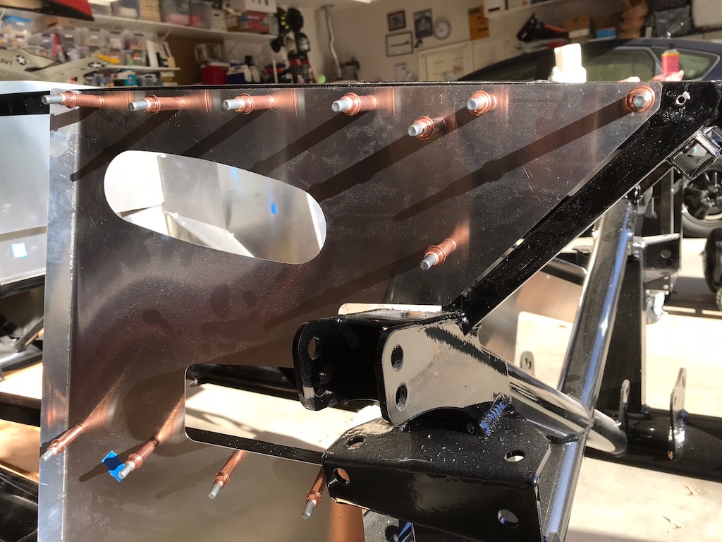

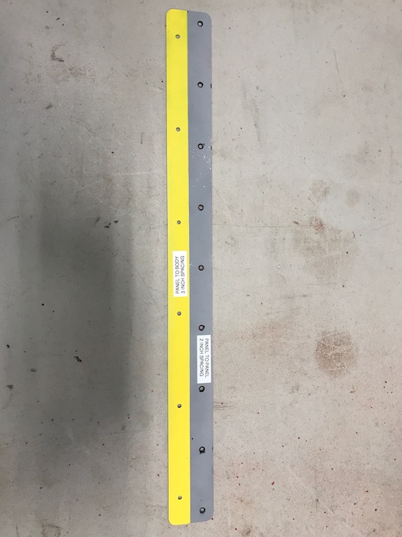

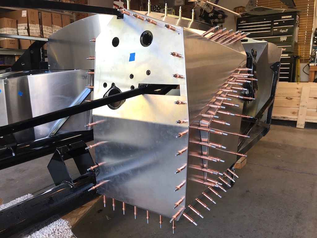

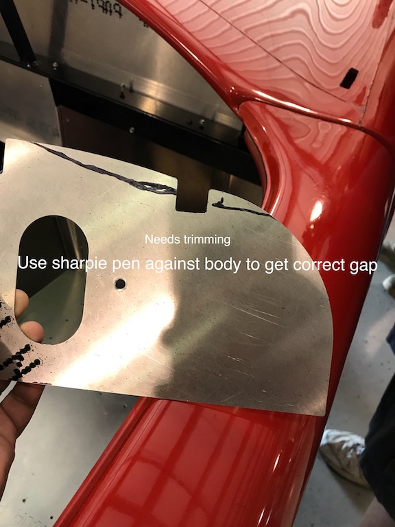

    Today I started on removing the aluminum panels. In an attempt to not lose the rivet spacing tool, I painted it so it would stick out amongst the other aluminum pieces. I painted it halfway across so it also helps me easily determine the proper side to use.
    My plan is to mark, remove, drill, and fit the panels before removing them for the build. Then once removed, I'll send them off to be powder coated.
    Here is the F-panel. With the advise of a fellow FFR owner, I moved the panel aft about an inch. On the roadster it helps with wheel clearance and better geometry to fiddle with the elephant ears when its time to install it. On the 289 with the body still on, I played around with the elephant ears and by moving it back I think it made them fit better...we'll see when the time comes to install them.
    Here is the driver side footbox. There sure are a lot of rivets. I hope they all align together when I re-assemble them.
    That's all I accomplished today...2 F-panels and the driver footbox.

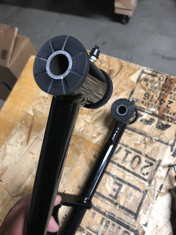

    My build is starting off a lot slower than I anticipated. I've been really busy lately with work and family and extended family. I have a few friends who lost their homes in the Napa Valley/Santa Rosa fires. I also have a few more friends still hoping and praying the fire would miss them. This past week I've devoted my time with them.
    This week I've been receiving boxes of my backordered parts: LCA's, radiator, some hose fittings, lower body mount, and some other small items. Still waiting for the windshield and door lock mechanisms.
    I'm still in the process of removing the aluminum panels. I'm too tired to do the panels tonight, but I did work on my car for about 20 minutes. I used my dremel tool to cut grooves into the bushings of the lower control arms. This was a tip I learned at the build school.

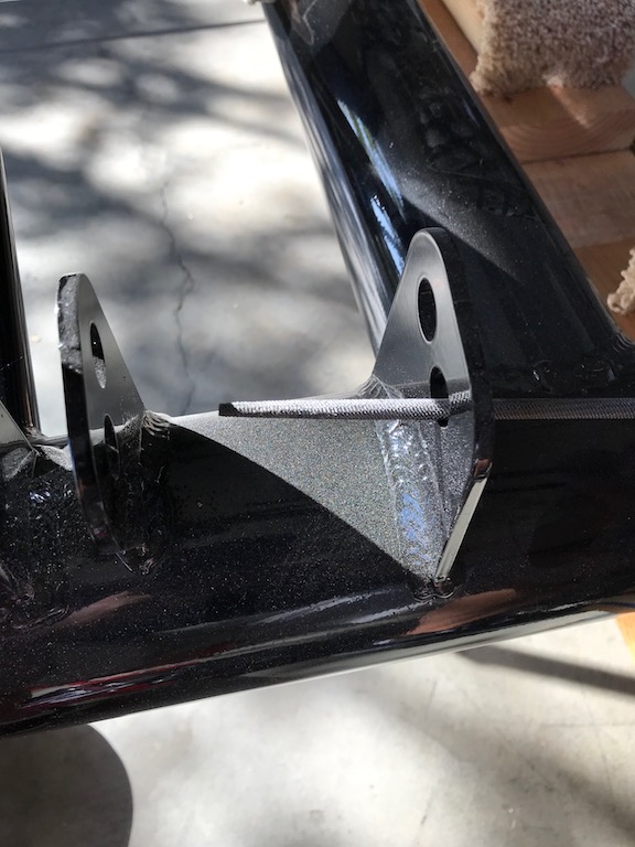

    Why the grooves?
  40. #38
    Elk Grove, NorCal
    550
    CobraboyDR
    The grooves are to prevent the bushings from annoyingly squeeking against the steel. It allows for the grease to enter the grooves to help lubricate. The upper arms already have them from the factory.

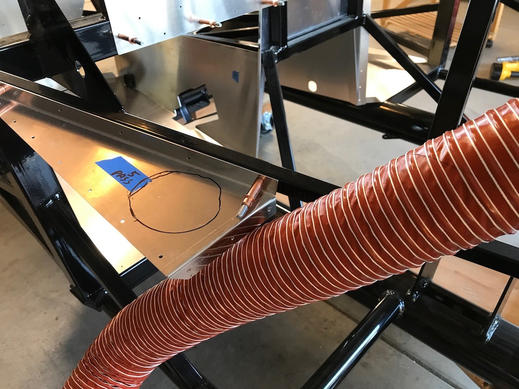

    Finishing up the aluminum panels. I still have to cut the trunk for the FFMetal battery box which is coming in the mail tomorrow. I also want to get the Russ Thompson drop trunk but I haven't sourced that yet. That should almost complete the aluminum panels, then off to powder coat. I'm also going to get a fan shroud but I don't think I'll powder coat that.
    I'm going to put a footbox vent in but haven't decided if I'll have a gated shutoff.

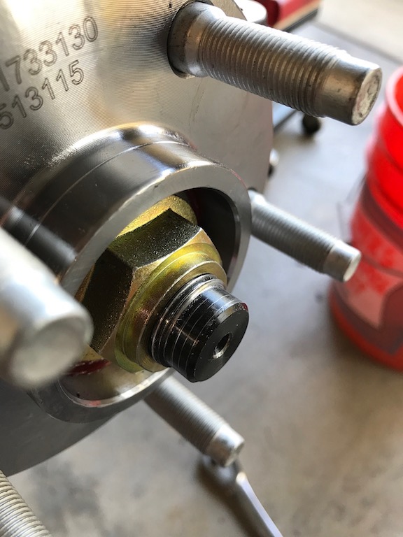

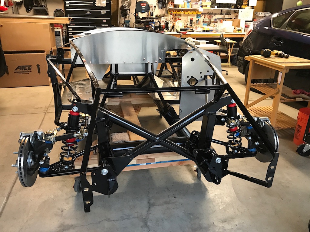

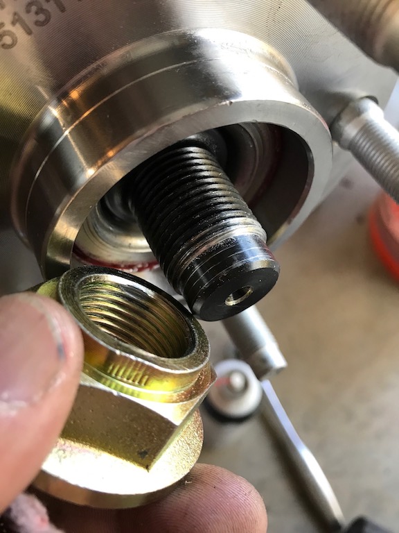

    I started on the front suspension. I made sure the F panels could be attached at a later time. I started with the LCA's. It was a little tight for the bolts because of the powder coating. Instead of just hammering the bolts in, I used a little file to clear the powder coat from the opening.
    One upper ball joint went into the assembly easily while the other I had to use the vise just like in the instructions.
    After I torqued both hubs onto the spindles I thought I stripped the spindle threads. Then I realized they both look the same. Hopefully this is normally how they look and hopefully I didn't screw up.
    If I didn't screw up, I have to borrow a torque wrench and torque the bolt down and place the cap on. Then on went the shocks. I temporarily installed the front brakes and called it a day.
