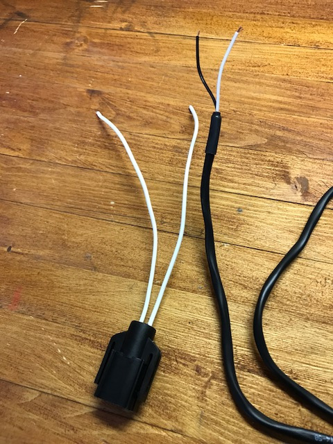

    OK, maybe I'm hijacking the thread (for which I apologize), but it is related... check out the photo. The connector for the speedometer at the transmission has two white wires. The wires from the gauge connector (classic) is one white, one black. Or in the RF bundle, one white, one gray. I have to believe that it does matter which way you connect it. But which way? Thank you for not getting annoyed at this slight diversion.

    My roadster wasn't wired with the RF harness, but I was led to understand it makes no difference, as long as one of the leads from the VSS is grounded. My Classic speedo works fine.
