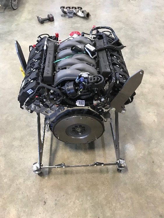

    New engine is mounted on the stand. This is the stand that comes from Factory Five. The engine lift points are also from Factory Five.

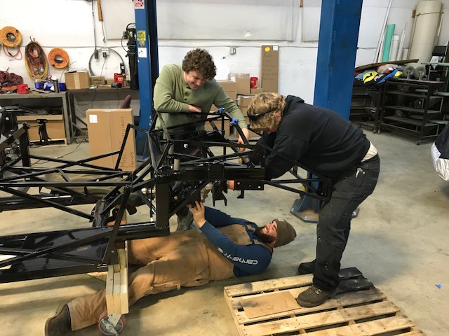

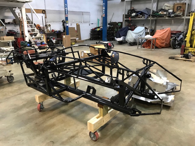

    This is the frame stripped of panels and ready to start in.
    These were my helpers last night. My oldest son and 2 of his friends from college.

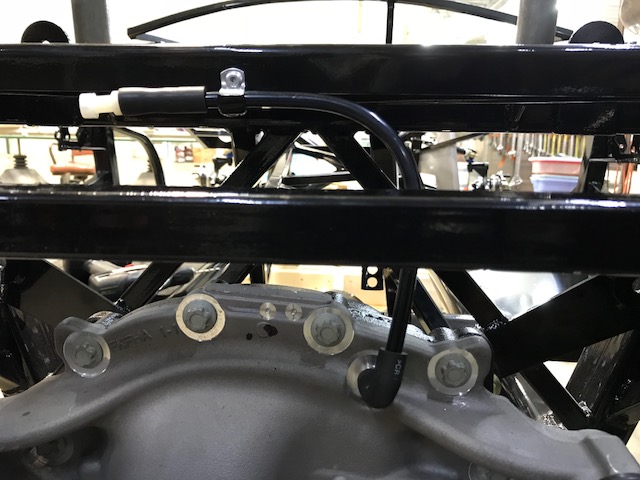

    I used the Ford part for the vent. I cut down the tubing and riveted it to the upper trunk panel.

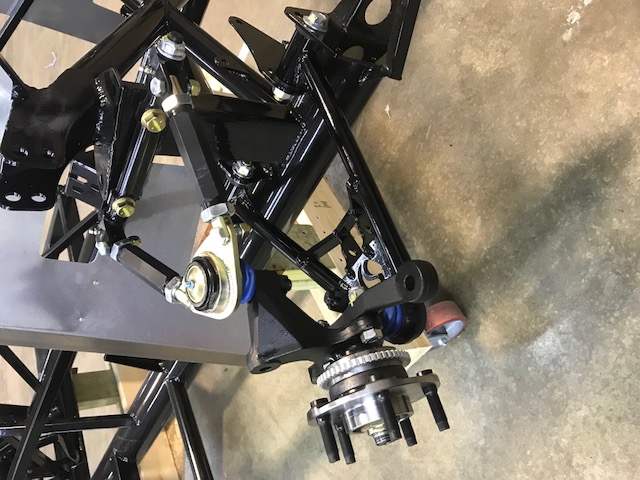

    Does anyone see anything wrong with my front suspension so far? The UCA was assembled upside down from FFR. I don’t have any of the steering assembly yet from FFR or all the parts to put the coils on the shock so this is as far as it goes for now.

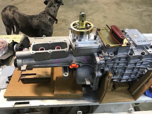

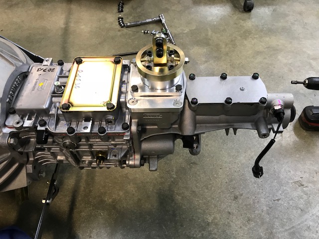

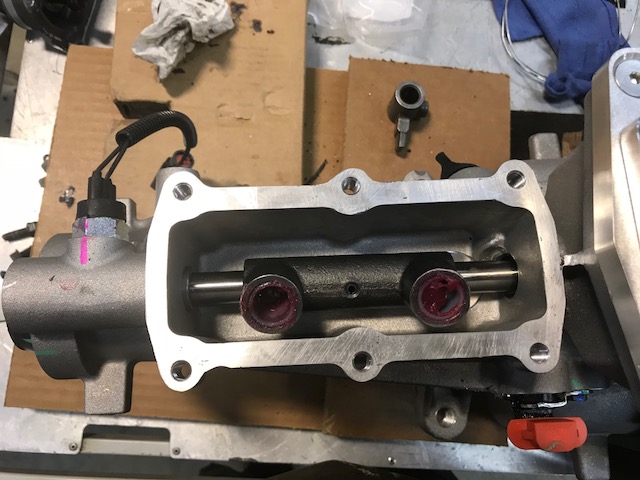

    I installed a Forte midshift kit in the TKO and got the back mount trimmed off.
    I am left with this linkage loose in the rear of the case because I didn't split the trans to take it out. It doesn't interfer with anything but I am worried about it rattling back and forth. There is a detent that keeps it from going for and aft. I am considering wrapping it with something to hold it in place. Has anyone else delt with this?

    BTW, best I can tell your front suspension looks correct.

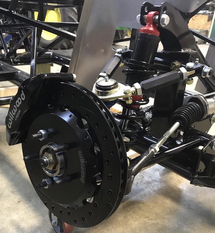

    Big day yesterday for me. FedEx dropped off the Wilwood brakes, steering rack, trans A frame, the missing shock pieces, and many other items that I will need soon. I got the front brakes assembled and safety wired and got the rack installed with the Breeze mounts.
    I dial gauged the bell housing. I wish I hadn't. It is out of center by .0065 which is out of tolerance. As edwardb correctly stated, there is no apparent way to correct this because I cannot find offset bushings for a Coyote block.
    I went ahead and mounted the clutch, bell housing, and transmission. I locked the rear shifter shaft in place by driving a piece of wood dowel into it and then running a screw into it through the top plate with gasket compound.
    It's hard to tell from this photo, but is there a centering ring on the hub for your brake rotor? Just checking.

    Yes, the centering ring is installed. The disk is tipped back in the photo which is hard to tell because the upper a arm is run all the way in at this point. I didn't realize until I went to install the rotor that I had yet to order any lug nuts. I found 4 laying around the shop just to hold the rotor on to square and align the caliper.
    Very good. One other thing that I missed on mine, is that the 6 piston Wilwood caliper is directional. There is one set of pistons that are slightly bigger diameter, and if I remember right, they will be on the trailing end of the caliper. (as the rotor turns, it's the last set of pistons.) I had to swap the calipers side to side after they were already bled. What a pain.

    Brake lines
    I finished out the brake install yesterday. This is how I mounted the flex line to the body in the rear.
    This is the front. I went to the front 2x2 upright with the mount. I liked how the flex line laid better this way.
    This is what I ended up with going across the front. Its hard to tell in the picture but the power steeriing lines should have plenty of room to come up through the bend in the brake line going to the passenger side.
    This is the line that shipped with my kit. It is awesome. It bends easily, doesn't kink, and the coating doesn't peel off when bent.

    I just got my engine stand from FFR today to mount the coyote on (versus the crate it came on) so I can get the oil pan and transmission on while it waits to go into the car sometime later. Quick question, it appears that it mounts to upper set of exhaust bolts, is that where yours is mounted?
    BTW I think our kits rode together on the truck, mine was delivered 3 days after yours!
