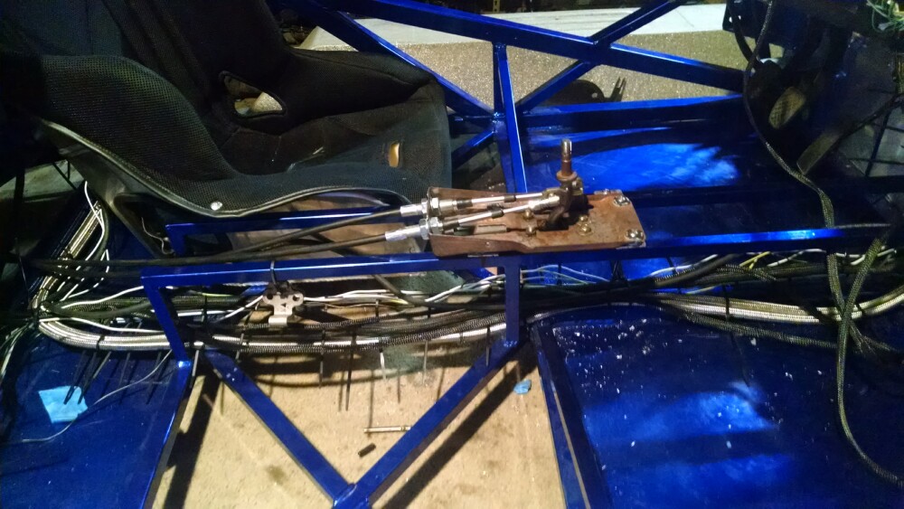

    I have got the MR2 shifter pictured above.
    The cables come out the back, so you need much shorter cables.
    The connection to the transmission is the same as FFR standard.

    Found a picture of my installed shifter.

    See, almost anyone that knows how to run a CNC can put parts in and get nice stuff out. Now, making stuff with a bandsaw and sanders and fooling people into looking like it was made with a CNC? That's skill.
    Zero Decibel Motorsports
    Check out my new website!
    www.zerodecibelmotorsports.com
    www.facebook.com/zero.decibel.motorsports
    Moonlight Performance
    Hindsight's Avatar
    Atlanta
    3,402
    Quote Originally Posted by Mechie3 View Post
    Uh, yeah. I would have bet money those were laser/water/CNC machined. Hats off to you DMC for some serious craftsmanship!
    Bowling Green, KY
    1,382
    Very Nice DMC, you planning to make some extra pieces to sell?
