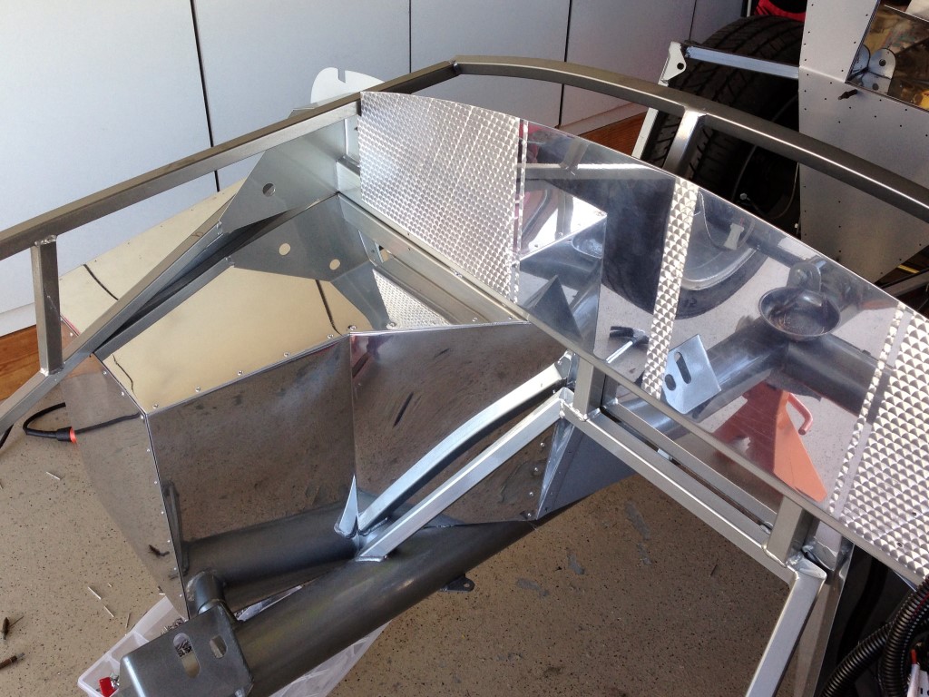

    BTW I'll just put it out there that with a SBF you can make an absolutely huge passenger footbox to go with it. Notice this one is pushed out beyond the floor tube:
    All of this is not to sway you to go with a 302. The Coyote is a GREAT motor! I'm sure there is a way for us big guys to make it work to our satisfaction, I just haven't had the opportunity yet...

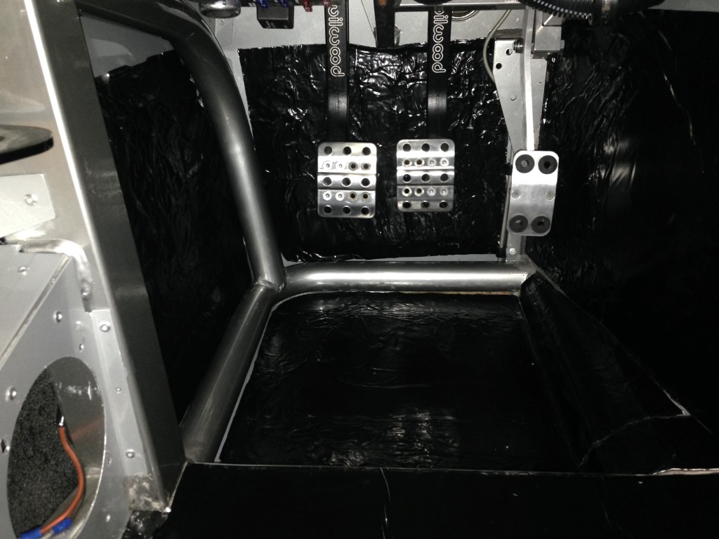

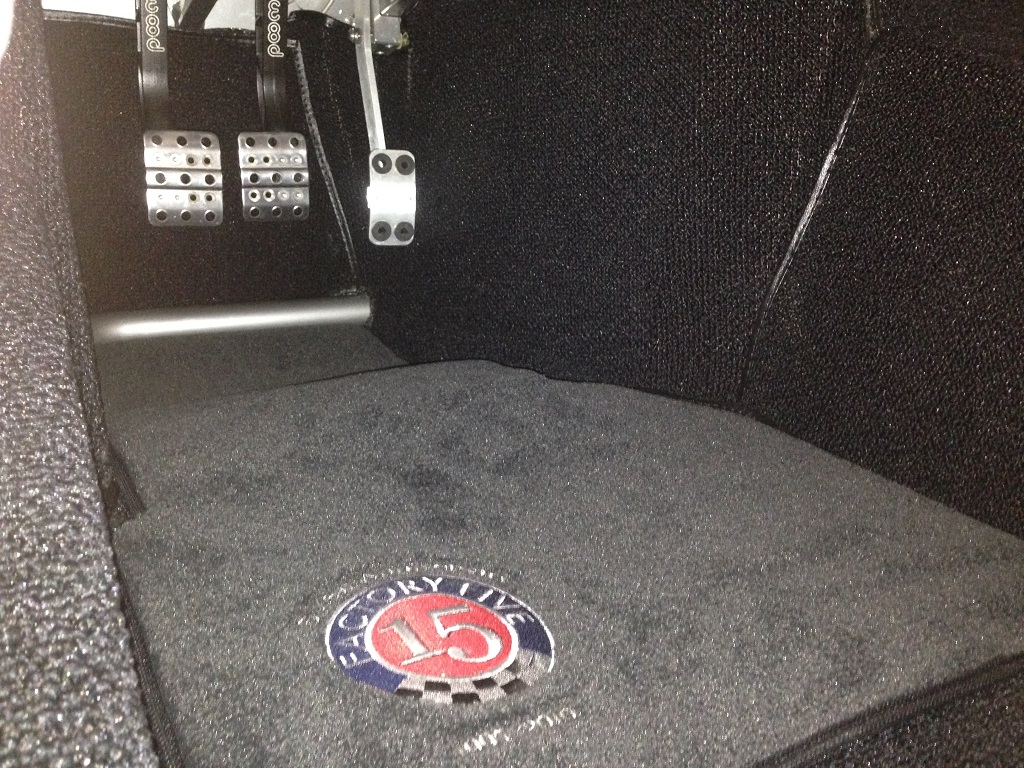

    I have size 12's and fabbed my custom footbox mod to fit the Coyote. Space is not an issue. I installed Koolmat, followed by Dynamat and then carpet on top (likely lost close to 3/8 to 1/2 inch of space on each surface with these 3 layers but still plenty of space. I have posted a number of pic's for reference. I use standard running shoes that are quite wide - refer to pics. Size 13 will not be a problem as you can space the pedals to fit and modify the drivers side wall of the footbox to maximize space. I understand that FFR now includes an expanded clutch pedal side "kick out" for even more space for your feet (not needed in my case - but more space is always welcome). You will note my left foot easily passes between the clutch pedal and the side of the foot box (with FFR's new "kick out" there will be more than enough space for size 13"s "+". Typically I rest my clutch foot on the down tube in the foot box (perfect length for me and a natural resting spot). In this position there is another 3-4 inches of space in front of my left foot before reaching the front wall of the footbox (for drivers with longer legs - I am 5'11" with 34 inch inseam). Space is not an issue.
    size 12 vs coyote footbox - 1.jpgsize 12 vs coyote footbox - 2.jpgsize 12 vs coyote footbox - 3.jpgsize 12 vs coyote footbox - 4.jpgsize 12 vs coyote footbox - 5.jpg
