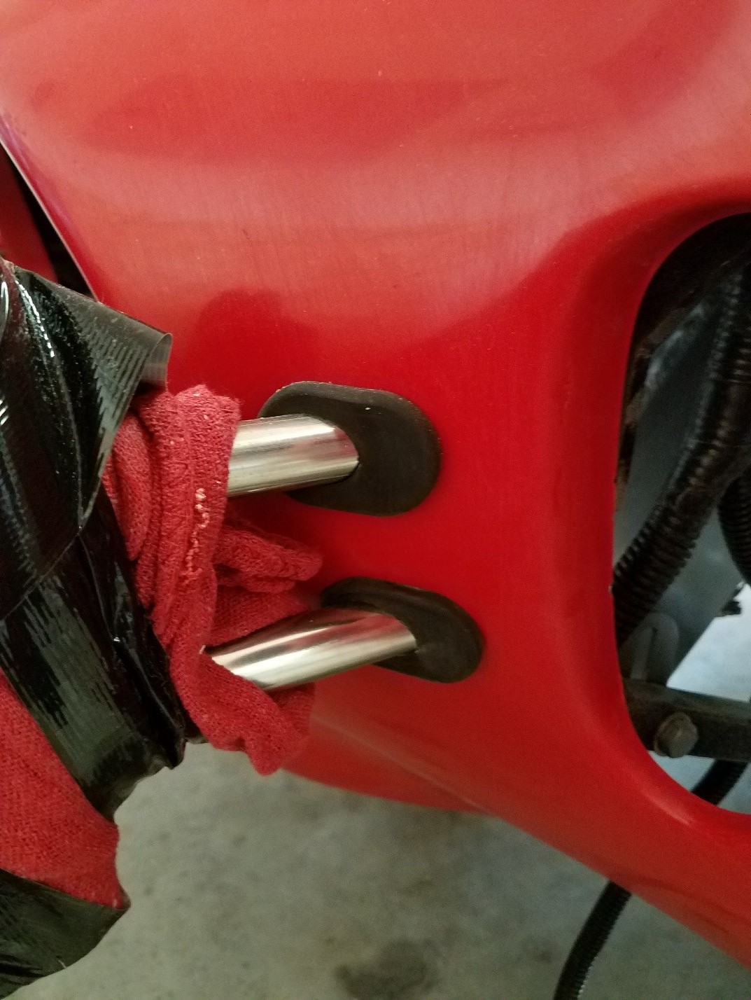

    Side pipes: I also installed the Gas N Pipes. The driver side was angled in and right up against the frame. I wanted to test drive the car with these pipes so I wouldn't upset all the neighbors. In order to solve this I called Mark Reynolds at Breeze. He sent me a wedge that moved the rear out 1 1/2". It worked perfectly and they both line up almost perfectly.

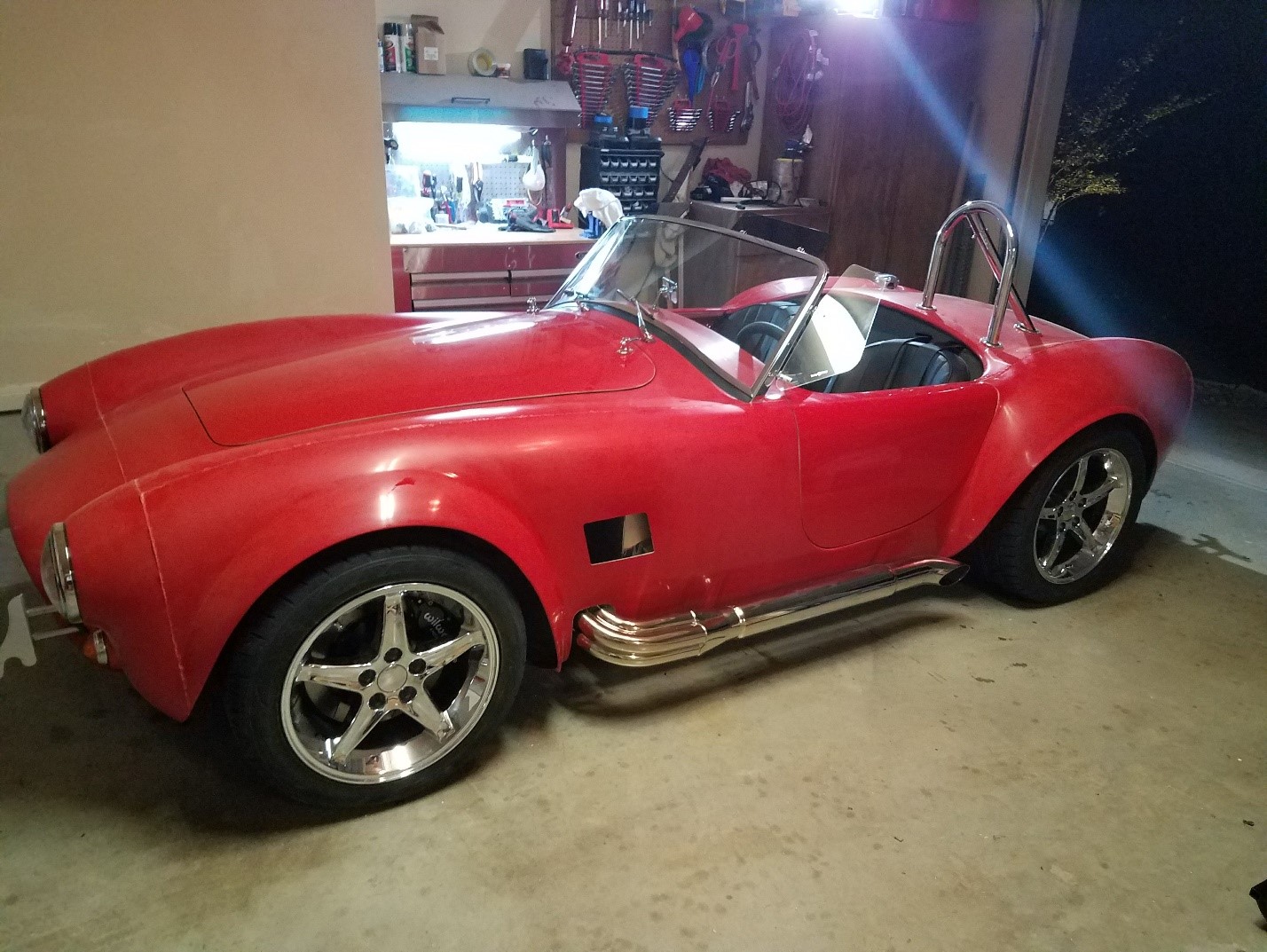

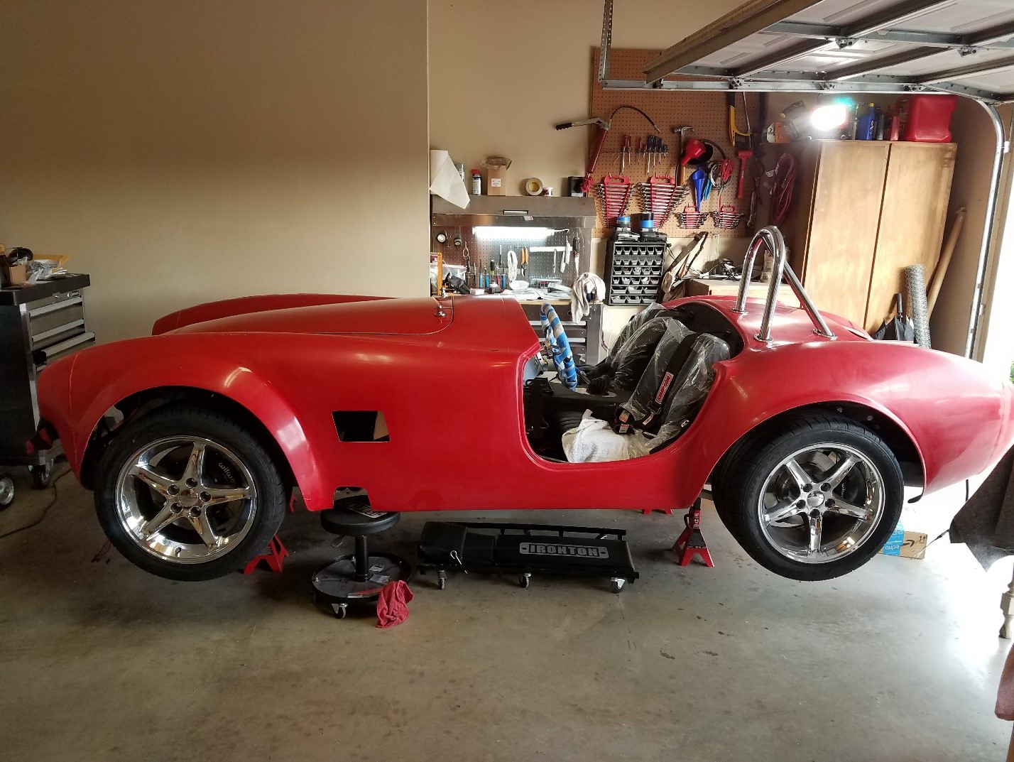

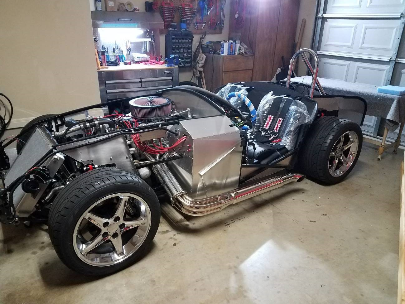

    Here is a picture of the go Kart.
    So here a few questions:
    1. My fuel gauge doesn't seem to read right. I and using the autometer gauges and the level sending units that came with the complete kit. I have put 8 gallons in total. When I first filled it up it read a little over a quarter of a tank which seemed a little low but thought I would worry about it later. I have since cranked it a few times and driven about 7 miles. It now reads less than a quarter of a tank. I can't fathom 7 miles and a few idles would consume 4-5 gallons. If so I will need to plan trips with gas stations every 15-20 miles. I verified the gauge reads the standard ford range (16-158) since at 1/4 tank it had a resistance of about 50 ohms. The level gauge has moved and I can tell it changes as fuel is moving around in the tank (inclines and declines). So what are your thoughts. Should I take the sending unit out of the tank and check it. I could also "stick" the gas level in the tank and estimate about how much fuel I actually have. Other ideas?
    2. Carb issue. So the engine starts beautifully from a cold start. I press the throttle all the way down once and release. Then turn the key and it starts almost instantly. When the engine is hot (choke is still open) it starts great and idles well. The issue is when the engine is warm. So the engine itself is warm and the choke has started to close but has not gone all the way shut. The engine struggles to start. It usually takes about 4-5 seconds to fire and then idles really rough. I usually have to feather the throttle to keep it running and get it hot. Once hot and the chokes opens completely it runs great. I am using the same starting sequence each time. Pump the throttle once, release, and start. What do you guys think about the "warm" start issue? The fast idle speed is about 1100-1200. Might be a little low. Would increasing the fast idle speed help at all? Thoughts.
    Thanks for the help in advance. I might also post these questions on the other forum as well to see if I get other ideas.

    You probably just need to back off the choke setting a little. After all you do live in Texas!

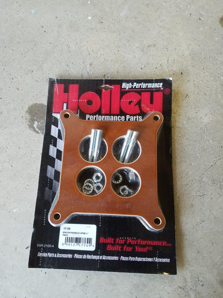

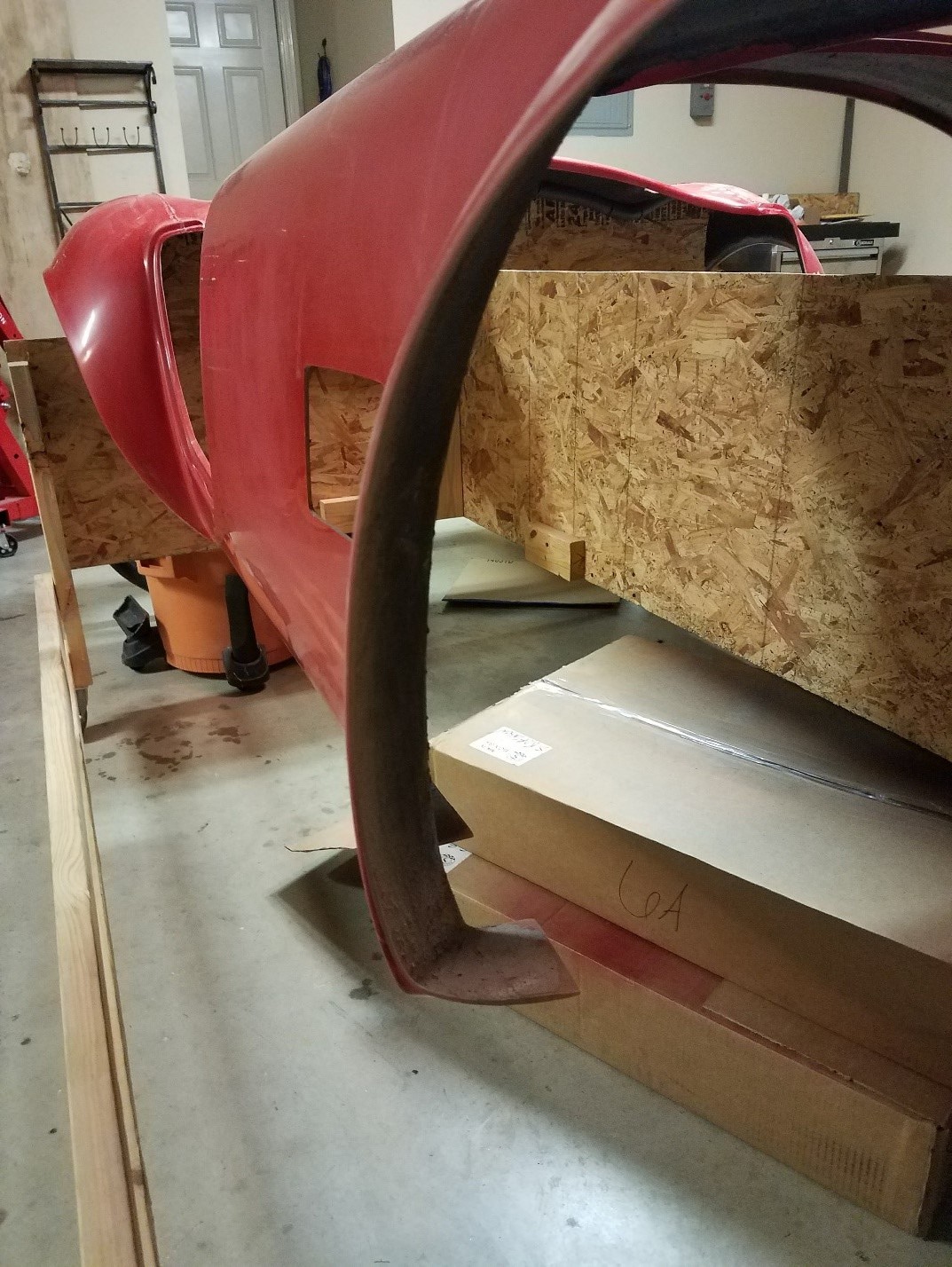

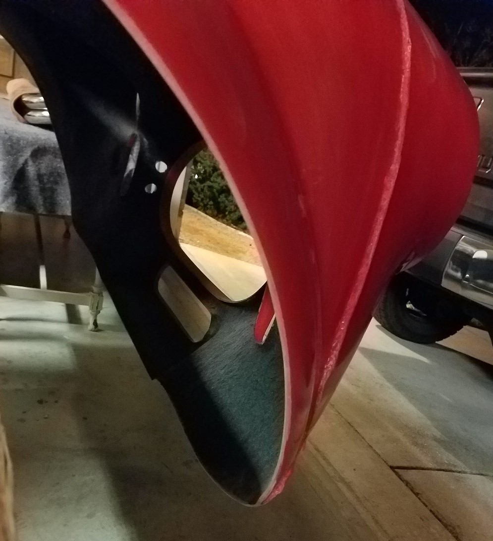

    That should be all the mechanical issues for now. So I moved on to mounting the body. This past week I cut the wheel well lips back and did a little trimming of the cockpit. I had put the body on the chasis a few month ago and marked where I need some trimming. So with reckless abandon (actually I was nervous and quite timid at first), I broke out the sanding drum, orbital DA, and sanding block. The cockpit edge was easy. The wheel well lips took some time. I drew a line around the lip where I wanted to stop sanding. That kept me from getting carried away. I used the sanding drum (1 1/2 in) on my drill. That took off the bulk of the material. I then used my DA to get right to the line. I then used a sanding block to finish them off and round the edges. I used 80 grit to do this portion. In hind sight I could have used something a little more aggressive. Took me a couple evenings after work but finally got it knocked out. They still need some work, especially around the bottom where they transition into the bottom lip. Not sure how to finish those so I decided to wait and think on that. It shouldn't affect the gel coat test mode. Here are some pics. Let me know if I need to change something here.
    Front wheel lip
    Rear of the front wheel lip

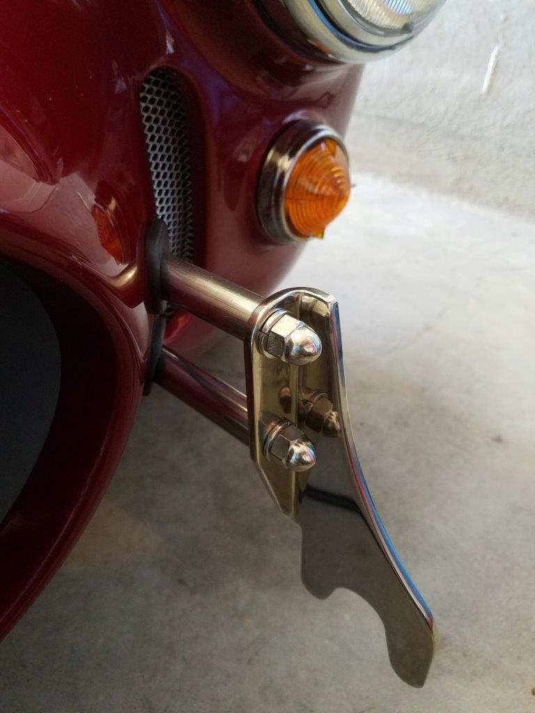

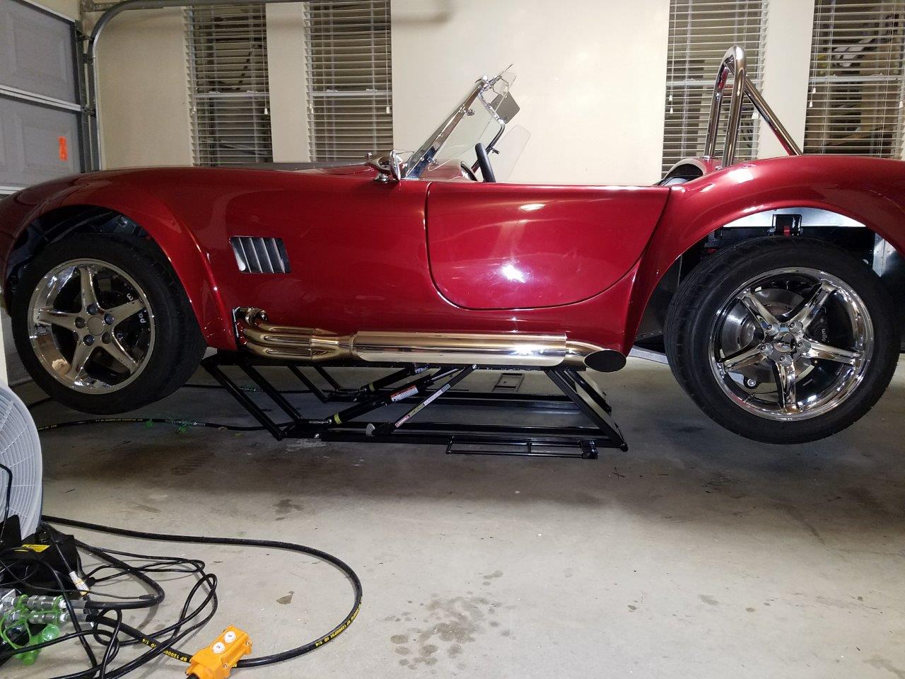

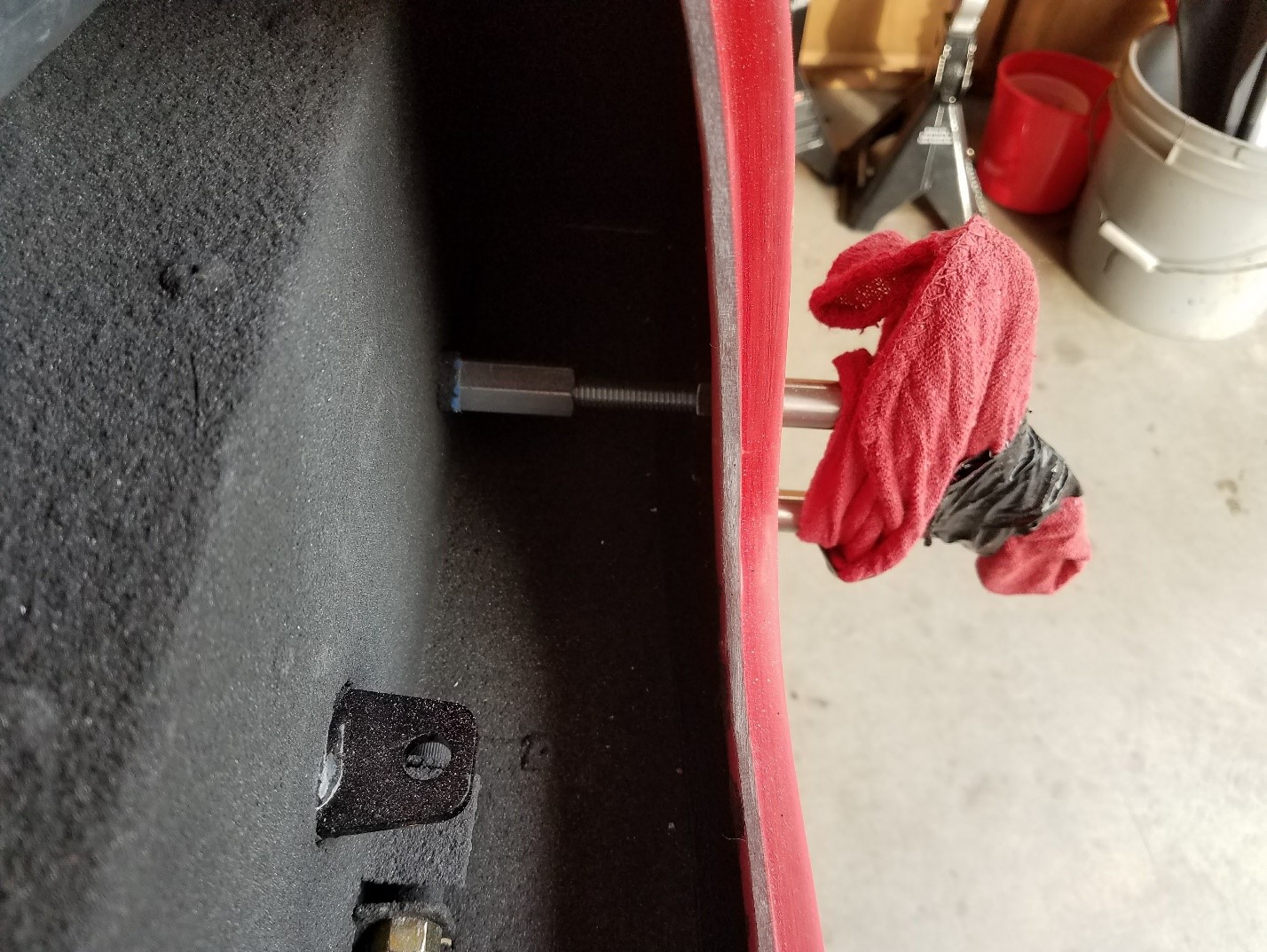

    Quick jacks were next. I used the Finish line grommets and tubes up front. I had to enlarge the holes up front for the grommets to fit. I did with my dremel tool and took it slow. I used the grommet as a template and all worked out. I have the ********** parts for the back didn't put them on right now. I will need to cut the tubes back and was running out of steam with cutting and grinding. Based on pics and instructions from other on this site, I had previously installed a bolt and coupler nut prior to installing the fuel tank. That will allow me to remove the quick jacks without removing the tank. I put the FFR parts on the back for now. Those will get change in the next few weeks.
    Front Quick Jacks
    Rear quick jacks
    I also got the hood mounted. I had do the trimming and fitment. That took a while. I used the same 80 grit sandpaper on my DA and sanding block. I just took my time, marked where I wanted to trim. It took my a few iterations but I thought I could always take off more but putting it back on would be much harder. The hood hinge went together ok. Some of the shoulder bolts stuck out to far, in other words the shoulder was too long. I used washer to get the hinge parts to fit better. Not snug but removed the slop. I still need to do some tweaking on the hinge to get the hood perfectly lined up. I will do that later this week. Here are some pics of the hood along with the hood pins.
    That last picture is where I finished this weekend. Hopefully I can get the windshield and doors done this next week. If all goes well, I should be able to get a temporary tag in April and be able to drive the car on the open road. It is coming together bit by bit.

    I only have a couple of items to complete to be road worthy. I need to install my Metco drive shaft loop, carb spacer/insulator, and the side view mirror. The carb spacer I am using is from Quick Fuel called the Quick Cool Insulator.
    https://www.quickfueltechnology.com/...insulator.html
    Hopefully it will help with some warm start issues I am having. If not then I will investigate further. I have decided to replace the FFR stock side view mirror with one that clamps on the windshield frame. I saw others doing that and I think I like that better. It is just a small 4" peep mirror. It should arrive tomorrow.

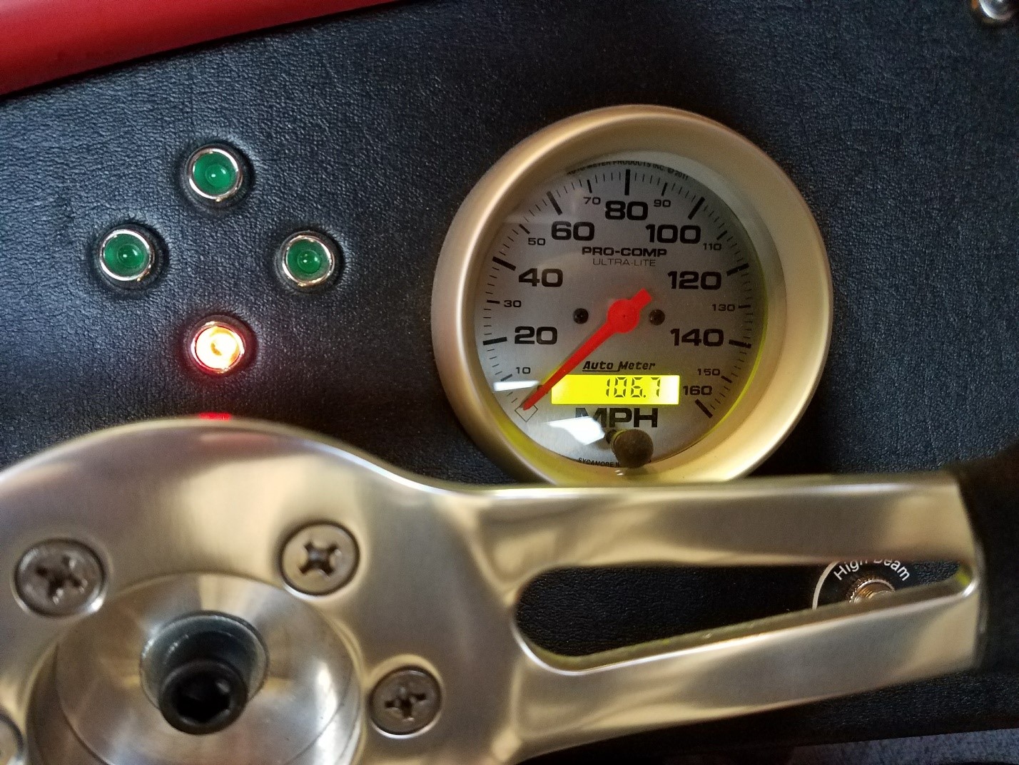

    I have been driving the car and really enjoying it. It is just in gel coat but still fun. I don't want to show it off too much in gel coat. I had rather everyone see it for the first time in all it's colorfully final glory. So my plan is the get the car registered and start disassembly for body work. For those in Texas, there is a great reference in the regional section of this forum that explains the Texas process. I am using that as my guide. I took the car to get a certified weight tonight. I took it to the closest truck stop I could find with a weigh scale. It was about 25 miles away. So I got to really drive the car a ways. This was my first long jaunt away from home base and I was a little nervous. I don't know why because the car ran great and I had no issues. The car weight 2500 lbs (including me and a half tank of gas). So now I am going to collect my necessary paper work, set up an inspection, and try to get this thing officially legal. I hope to get that completed before easter. If that happens then I will be able to start body work in May like I had planned. I plan on tackling the body work myself. There are so many great threads and inspirational stories on here that I am going to tackle this part myself. I found a painter that agreed to paint. Another member, bobL, did the same thing with the same painter and his car turned out beautiful. Hopefully I can duplicate his end results.
    So, I have officially broke the 100 mile mark on the odometer, I have a short list of things to fix after the body is off and at the painter, registration is in sight, and I will start body work soon. Hopefully the next time I post I will have a Texas License plate en route and asking questions about body work. In the meantime, evidence of the 100 miles.

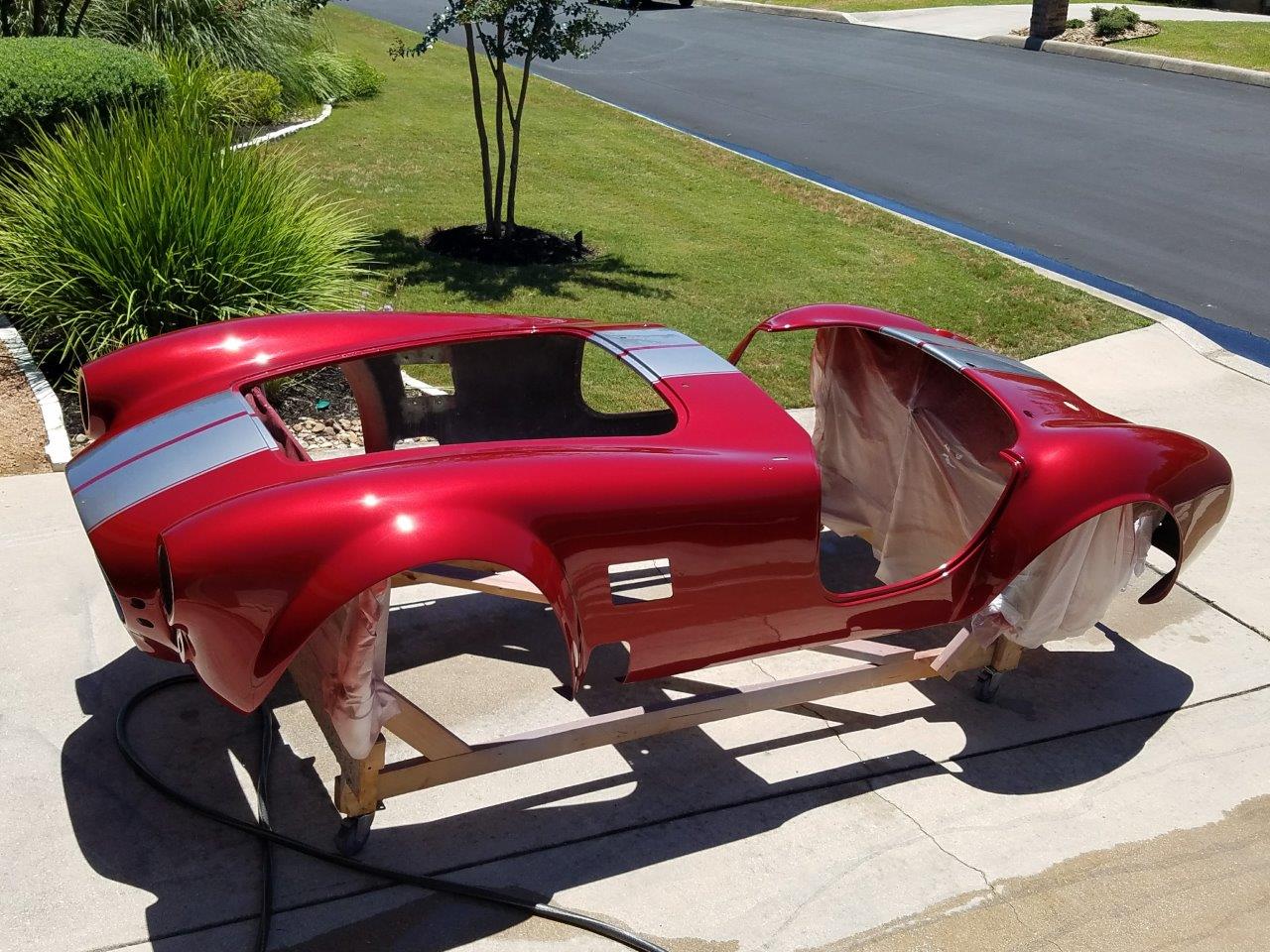

    Well, I got the body work done. Here is a link to the body work thread
    http://thefactoryfiveforum.com/showt...sonx2-Bodywork

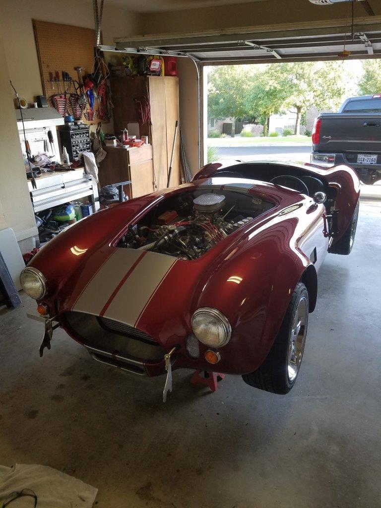

    Here is picture of the paint
    Now that I have the paint completed, I moved the chassis back over to the large stall of the garage and started on the carpet. For adhesive I am using the 3M 77 suggested in the manual. On the areas where there might be wear or I need them removable I am going to use a combo of carpet tape and velcro. I will document that as I go. I read a bunch of threads about different methods but this seemed the easiest and is working so far. I was a little concerned about how the carpet would adhere to the Lizard Skin insulation I applied. So far it is holding up. I will let everyone know how it works down the road. Just a couple hours of work this evening.
    So far I have logged 407 hours on the build and 226 on the body work and paint. That is a total of 633 hours. Hopefully I can get this thing wrapped up in the next week of two.

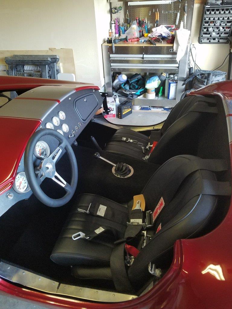

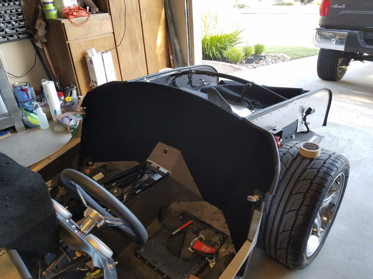

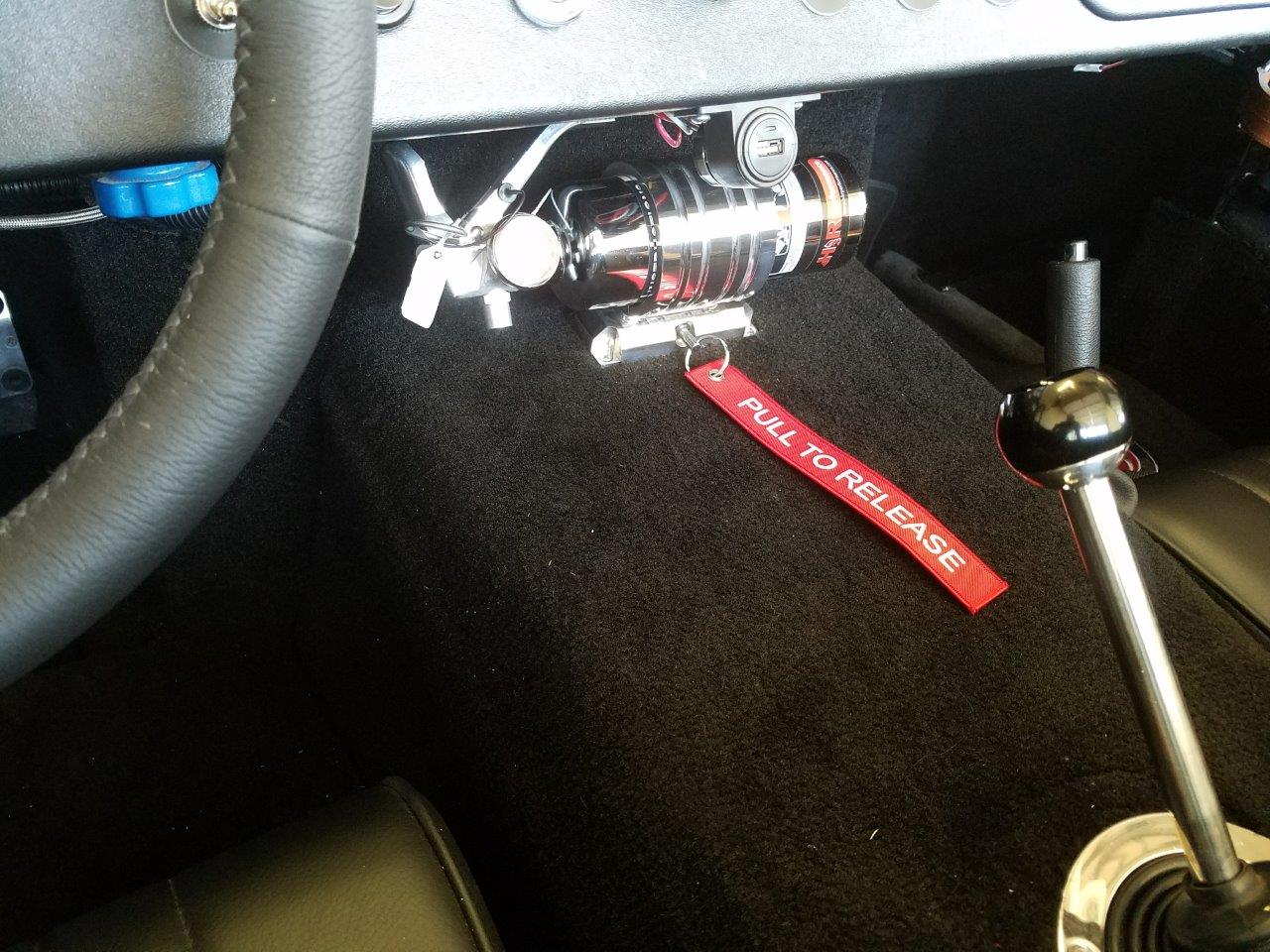

    So I got going on final assembly. Nothing really ground breaking just putting everything back together that I have assembled at least twice before.
    I wrapped up the carpet yesterday. I then prepped the chassis for body installation. I got some help from a friend and we got it on. Hopefully for the last time. Also installed the front quick jacks, Mike Everson's radiator aluminum panel, as well as Mike's front license plate bracket. Here is picture
    It went together well. Here is another picture of the cockpit.

    Well,
    I have been wrapping up the final details. This past week I have accomplished the following:
    - Hooked up and checked electrical. I had one issue. The drivers's side headlight high beam did not work. A bad connection in the weatherpack I installed. Easy fix.\
    - Installed my side pipe heat shield. I got them from Drummermike. They look great and pretty easy to install.
    - Fixed a couple of clear coat issues that I discovered. Just a couple of runs and nothing too exciting.
    During this past weeks work, I found that the driver's side side pipe was too close to the body. An order to Mark Reynolds at Breeze and that was solved. He quickly packaged and shipped a couple of exhaust wedges that arrived today. I painted and installed the right one and I am now all set. That was the last major piece I was needing. While I waited for the part, I decided to buy a floor lift. My floor jack and jackstands are less than ideal, especially with the body on. I don't have a lot of clearance and had to make a couple of "lifts" in order to get the jack stands in place. I wasn't real comfortable with that set up. And I was looking for a good excuse to buy a lift. I bought a Quick Jack BL5000SLX. Here is a picture during set up.
    Here is a picture half way up.

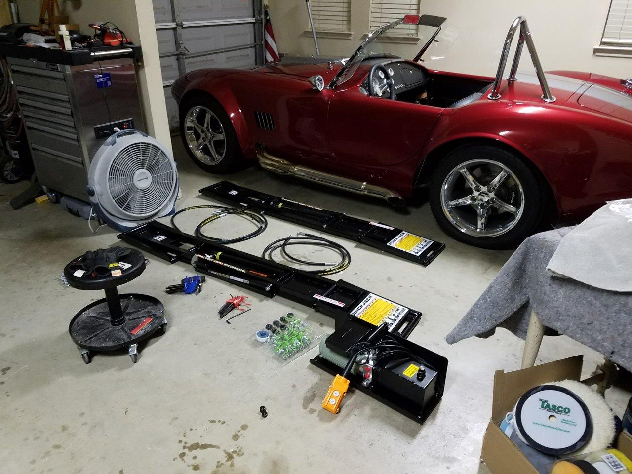

    I used it today and it is great. I wish I would have bought one of these at the beginning of the build. It gives great access to the entire car.

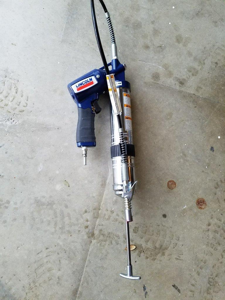

    I also bought another toy. My grease gun was a cheap one I picked up a while back. I decided to try a pnuematic grease gun. I works great and is much easier. It allows me to keep one hand on the grease gun hose while applying grease.
    With my new grease gun and lift, I accomplished three items today. I got everything greased and all the front end and rear end hardware checked. All was tight and I should be good to go. While I had the wheels off, I used some of the left over black bed liner I had from earlier in the build and put another coat on the wheel wells. I thought it would ensure a little more protection and give the wheel wells a finished look. I got the wheels back on and ready to go.
    The only really build item I have left is to finish off the quick jacks. They are installed but I just have nylon lock nuts on them now. I order some acorn nuts from McMaster-Carr. They should be here early this next week. That will be an easy item to knock out. Once I get this done, I will call it good. I am excited to start driving but the weather is not cooperating. Hurricane Harvey is keeping everything wet. I will just have to wait until this blows over. I am getting close. Graduation thread will be coming soon.

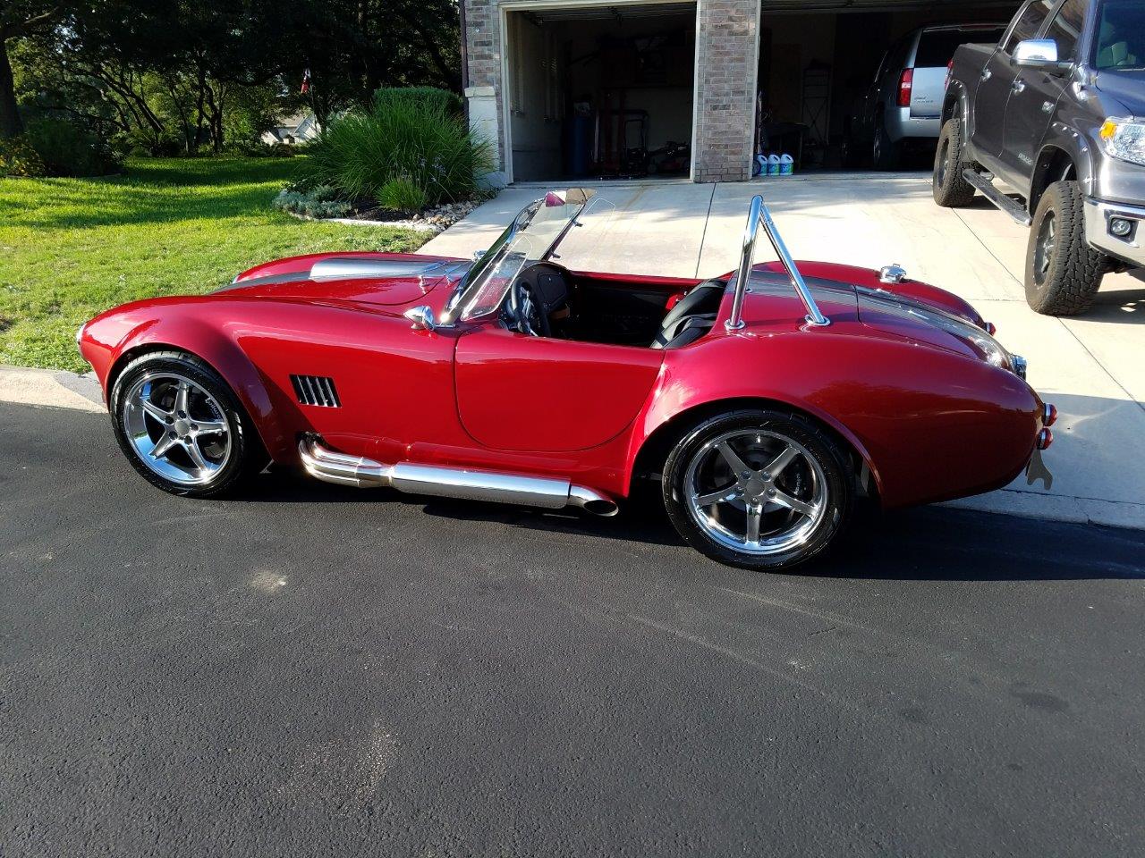

    Long but fun road. I have been at this for about a year now. I have learned a lot and made some new friends. Now it is time to DRIVE!!!!!.

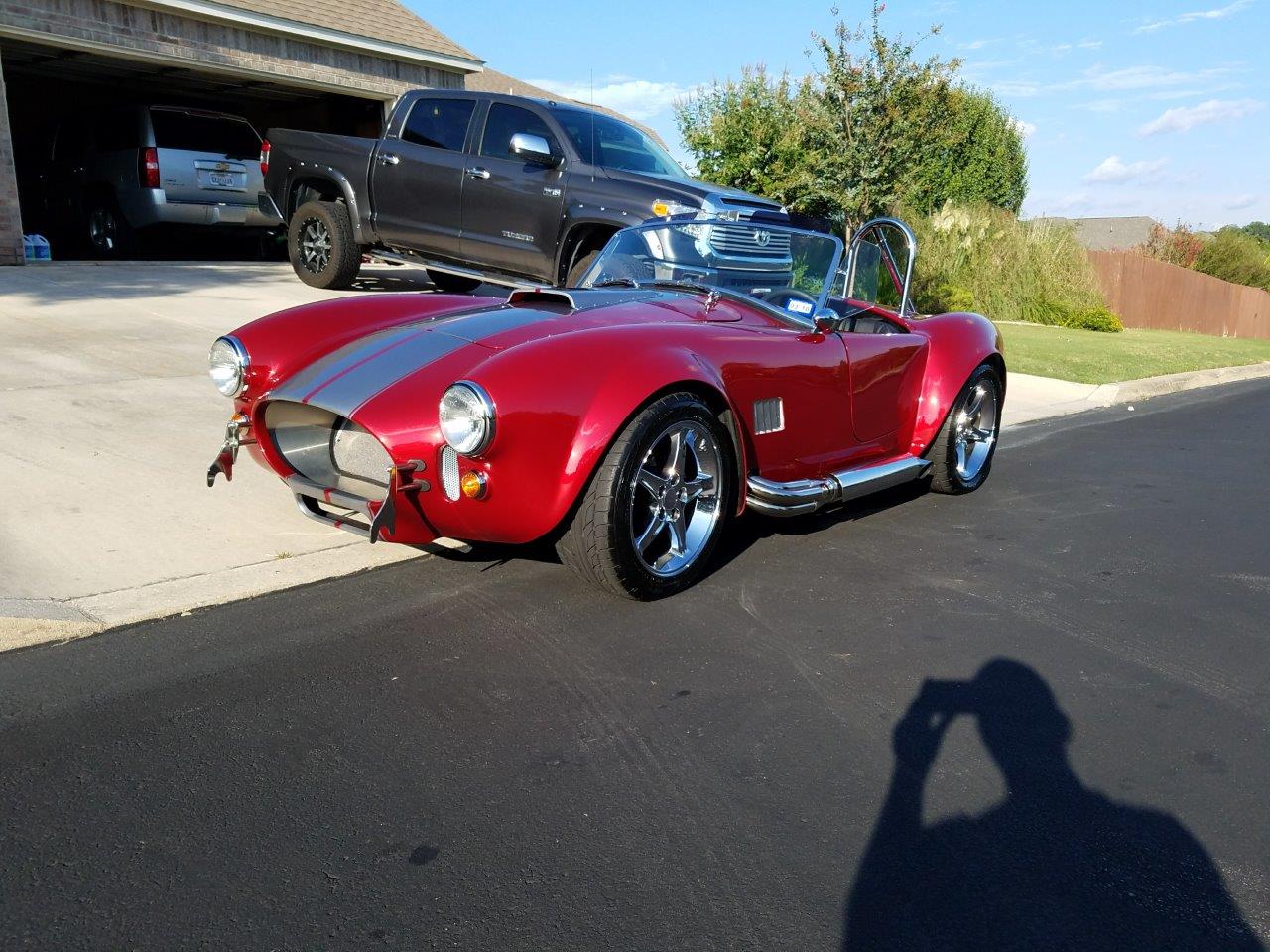

    Harvey has moved out of the San Antonio area. The sun came out and the cobra decided to come out of it's den and warm in the sun. It's old skin has been shed and the new scale color looks fantastic if I do say so myself. The snake has been hibernating for four long months. The metamorphosis is over and it was time to let the snake roam.
    After a long wet weekend, well it rained but I stayed dry and busy in the garage, I could take it no longer. I needed to get the car out and go for a drive. I made one final inspection, eased in the driver's seat, and slid the shiny silver key in the ignition. I lightly touch the gas pedal to reset the high idle on the carb then turned the key. The engine immediately roared to life. It normally takes my engine about a minute to warm up. Once the water temp is up to 150 F, I am good to go. I made a quick loop around the neighborhood, mostly to show the usual garage visitors I was done, but I told my wife it was to give it one final test before her maiden voyage. The short jaunt well great without issues so I then made a short run of about 10 miles. Came home to take the wife for her first ride. She has been nervous about this for a while. She says it is loud, low to the ground, and looks dangerous. She was waiting in the driveway when I returned from the test drive. I think she was excited, just didn't want to admit it. I helped her in, and get strapped up. She jokingly mocked the necessity of the 5 point harness. But, I saw her take a couple of selfies that was mostly harness. I think she secretly thought it was kind of neat. I made a short loop with her. I took it easy at first and she seemed to enjoy it. I only made one "spirited" acceleration and I saw a little smile. When all was said and done she said it wasn't as bad as she thought. We will see how the next drive goes. Regardless, I love it.
    A few small items to complete and I will call it good........for now. I am still waiting on the acorn nuts for the quick jacks. I also ordered a H3R extinguisher. Hopefully that comes in this week.

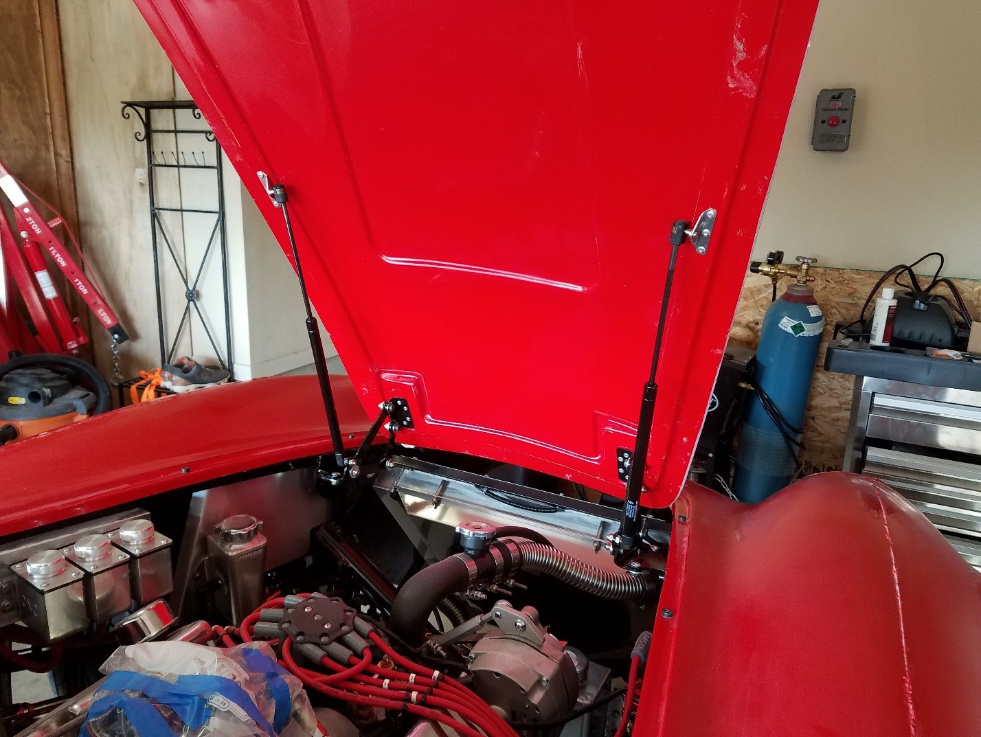

    Still working on a few items. It feels like I could continue to tinker forever. When I first started this journey, I wondered why everyone said these cars are never truly done. Well, I think I know what they mean. Anyway, I had a few items to finish up.
    Installed a 1/2" phenolic spacer below my carb. I hope this solves a warm start issue I am having. It seems like once my engine is warm, it starts fine if I kill it and then restart it quickly (2-3 minutes). If I let it sit for 10-15 minutes and then try to restart it, I have to turn the engine over quite a bit for it to start. I don't pump the gas pedal as that seems to exacerbate the issue. Cold engine is fine. I also notice that the carb bowls are empty after a drive and checking the engine after it has cooled down. So hopefully this will help. Installed easy.
    Secondly, I finished off the quick jacks. I bought some acorn nuts (cap nuts) from McMaster-Carr to fit my 7/16" bolts and all thread. I used split lock washer under each nut. I used these for two reasons. The split washer will keep the nuts for backing off (obvious) and they also have a smaller outside diameter. These gave a little cleaner appearance than a flat washer.
    I also installed a fire extinguisher. I bought the H3R Halon extinguisher with the flat surface mounting bracket and matching chrome ring. Kind of pricey but it looks nice and is good insurance. I know it won't solve any big issues, but small oil or electrical fires can potentially be addressed before they get out of hand. And it looks cool. I mounted mine under the dash because I have my battery cut off switch mounted on the angled aluminum piece where most mount an extinguisher. I might have done this different if I had to do it over but it will work and looks fine. I might spring for a larger halon extinguisher to put in the trunk but for now I feel a little better.
