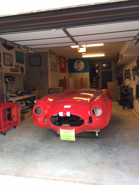

    Delivery day
    I was very excited the Stewart transportation truck showed up yesterday. I couldn't be more pleased with the delivery process. The driver Jim was great, the communication throughout the process from order to drop off was great. Would highly recommend Stewart if you are considering them. I ordered the last week of May and had delivery June 28. Quicker than expected.
    After unloading and getting everything in my workshop it was time to start inventory. My wife enjoyed helping check off parts as I told her what they were. We had numerous interruptions as neighbors had to stop by and see what I had been talking about for a few months. That was fun to tell them about it and show them the kit. Hope to finish inventory today and then get to the real fun!

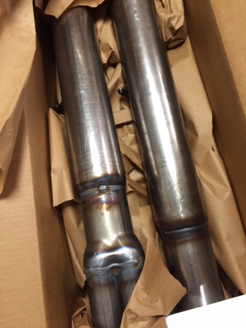

    I ordered 14932 polished stainless side pipes. The finish on them certainly is not the polished look I thought I was getting. Not sure if I got the wrong ones sent or if I just had an incorrect perception of what polished stainless was?? I was thinking they would match the roll bars.
    Here is a pic. Did I get the wrong ones?

    yup, wrong ones.

    Quote Originally Posted by Duke View Post
    yup, wrong ones.
    x2. Those are the plain steel pipes. I promise the SS ones look different than that.

    Thanks for verifying Duke and Paul!
    Figures two of the biggest boxes I have will need to be returned! haha

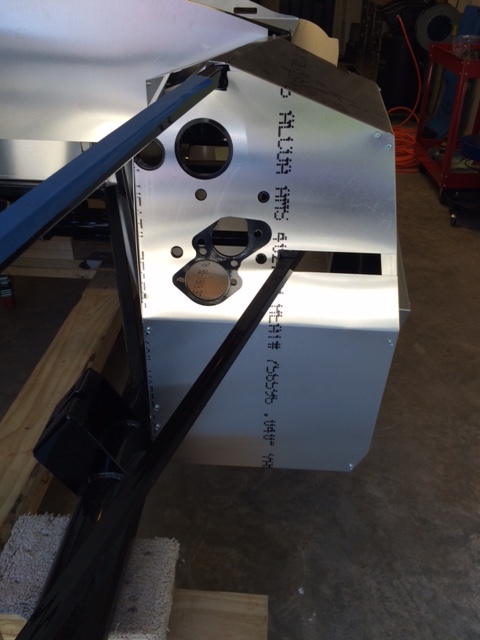

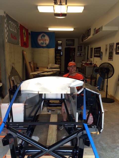

    panels and more panels
    Finally layed hands on the car today. It was great to do something other than inventory parts. FFR did verify they sent the wrong exhaust pipes so they are sending those and the Kirkey high back seats.
    Had a neighbor come help me get the body on the buck. Not sure if my design or execution was lacking on the construction of the buck but after putting the body on there the back seemed to sag just a bit. I made some stands out of 2x4 and propped one on each side. Seems all good now.
    Then I started removing the aluminum panels. I have to figure out which ones I would like to powder coat. I decided to drill them as I go so it is pretty slow going getting them off. Got about 6 done so far.

    Panel help please
    I found a couple hours to work today. Still working on drilling and removing panels. It is slow going for me but I think I will be glad to have a lot of the drilling work done ahead of time. The tips I asked for in a previous post are much appreciated. Worked great!
    I do have a question about the DS footbox front panel. The kit shipped with this panel.
    The build manual indicates part 15142 is left footbox front - wildwood pedals (which I have)
    The manual indicates a different part number for another left footbox front pedal.
    The resolution of the picture of all the panels is not good enough to notice any distinguishing characteristics.
    Could someone please tell me which one is in the above picture?

    The DS panel you have pictured is for a Mustang footbox. It has large holes near the center for the steering column and the master cylinder that mounts on front of the footbox. The DS panel you should be using with a Wilwood pedal box only has a single hole for the steering column. Typically FF ships both panels with the kit. If you didn't get the Wilwood panel, you can call and I'm sure they will send the correct one.

    Exactly what Paul (EdwardB) said! I am confident that you have the other -- correct -- footbox front. I think FFR ships them all with the one you have on the car. Then, the folks that have the Wilwood upgrade, they simply add it into one of the myriad boxes. I feel confident that you have the correct one.

    Yep learned something else today. I have all the parts organized in the boxes they came in and layed out on shelves by box number. My plan when I need a part was to find it on the pack list which indicates box number and then go get it. The panel I needed was part 15142. I looked over the pack list 3 times and that part was not listed. I went to box 6a that had all the aluminum panels and it was not in there either. Then I looked in the build manual and saw a note that the panel would be with the pedal box hardware. So I looked and sure enough it was in that box even though it was not listed in the pack list.
    Lesson of the day is you may have more parts than listed on the pack list! Look in the actual boxes.
    Follow up question:
    Now that I am looking more carefully I notice on the list of trunk mounted aluminum it says 14810 & 14811 LH & RH Shock tower block off plate (irs only). Those were not mounted on the frame and I can't find a picture of them in the manual. I do have some unlabeled panels I have not determined what part they are. (I do have the irs option so should have these). Does anyone have a picture of these to help me identify what I'm looking for?
    I checked my inventory list, and 14810 & 14811 LH & RH Shock tower block off plate (irs only) are listed on the mounted components list. But they are lined off indicating not included or delivered. Nothing like that came up in the instructions or during the build, and I'm not sure where they would go if they did. There's nothing about the rear shock towers to block off. I'll bet these may have been used on the older IRS design. But that's only a guess.
    Thanks Paul. Like yours mine are lined off. Good to know they don't seem to be needed during the build. I will cross that off my list and not worry about them.

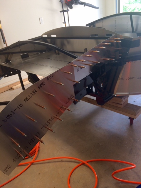

    more panels!
    Still working on panel drilling and removal. Looking through the instruction manual I see the logical order they need to be installed in and what tabs need to go behind what panels. Originally I was just taking the panels off that came installed on the frame. Today as I got to the rear cockpit wall I realized to drill some of those I need the other pieces that go around the back of the transmission tunnel and the pieces on the cockpit sides so I can get all the holes drilled correctly through each panel that attaches to each other. When I realized that I started getting the appropriate panels out of the box and adding them in the mix. My reasoning behind this is so I can decided every panel I want powder coated and just take them all in as one load and have them already drilled so they don't get dinged up drilling and installing later. Also, I plan to powder coat the panels black. Right now I am marking on them from the backside where I need to drill at times. Figured once they are black seeing the markings will be more difficult.
    Does anyone see any reason why it is a bad idea to pre drill all the panels? I like the idea of having it done and then clean up all the holes and shavings but I want to make sure I am not missing some reason why it would be beneficial to wait.

    Pre drilling is a great idea, and for the most part it works great. However, don't be too surprised if things occasionally don't match up quite like they did when you drilled them. Why? Who knows. Gremlins, moon phases, sea level, global warming, political correctness, I don't know. It will all work out. Keep doing the drilling. You are indeed wise to have everything powder coated at the same time.
    Drilling prior to coating is the preferred method.

    Lots of holes to drill!
    Update - in the last week I have probably drilled more holes that the previous 42 years of my life! HA
    Almost done drilling and removing panels. Very excited to actually start putting parts back on. I took a break to daydream about driving today!
    Fred Flintstone style feet on the ground. Having a great time with this build.
