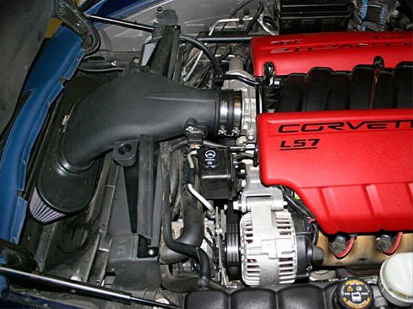

    A Corvette intake would be great!
    https://www.summitracing.com/int/par...model/corvette
    I calculated that the radiator would need to be lowered by 1 inch.
    Senior Member Hacksaw84's Avatar
    Jun 2017
    402
    Quote Originally Posted by totem View Post
    You calculated it based off a stock intake mani or the boss? I think it sits higher might be a good fit then...?
    I have talked with Lund racing about tuning my coyote (I am doing a cobra jet manifold) and they were very specific about knowing what intake you are using. As well as where the MAF is located.
    149
    Quote Originally Posted by Hacksaw84 View Post
    Stock manifold. It will need a pn additional tube between the TB and the pancake tube. I was worried with the space between the hood and the radiator.
    I think this one has the right slot type MAF:
    https://static.summitracing.com/glob....jpg?rep=False
    I'm NOT saying it fits. I'm just saying that would be nice to have the intake going over the rad with the filter in front of the rad.
