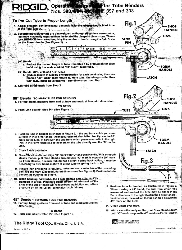

    Maybe this will help you with the Ridgid bender. Once you figure out thr reference marks on the link you'll be gold.

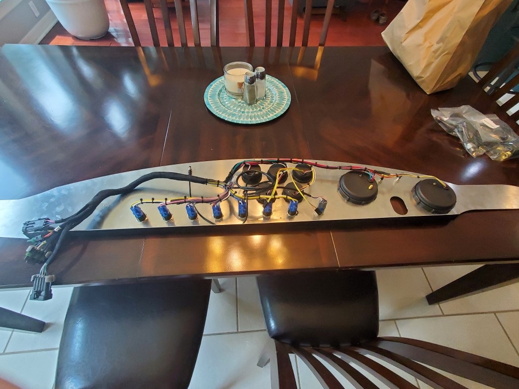

    I have a few days off this week and next week. I think that will allow me to get some real progress done since most of the time I have been working randomly after work.
    So I have been working on the dash and wiring. I purchased some good crimpers and am using 3:1 heat shrink on all connections, this is a part I really enjoy doing.

    Be sure and run all of your dash wires to Weather Pack connectors so it's easy to remove later.
