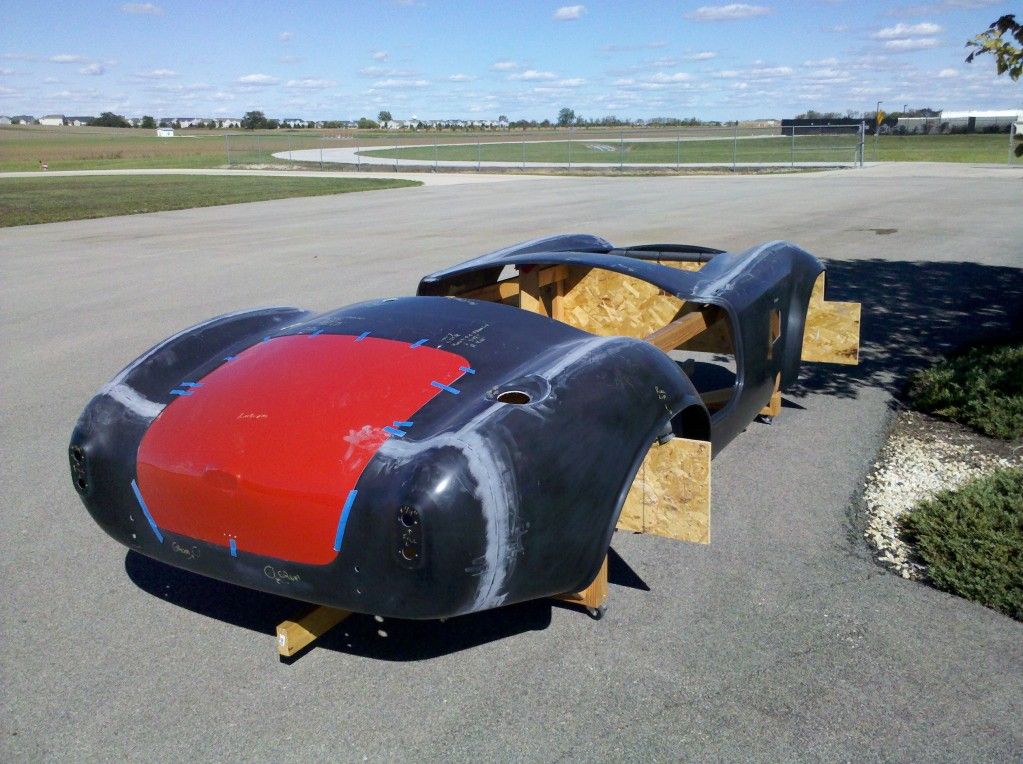

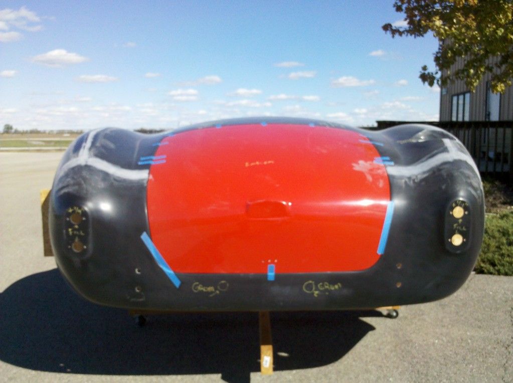

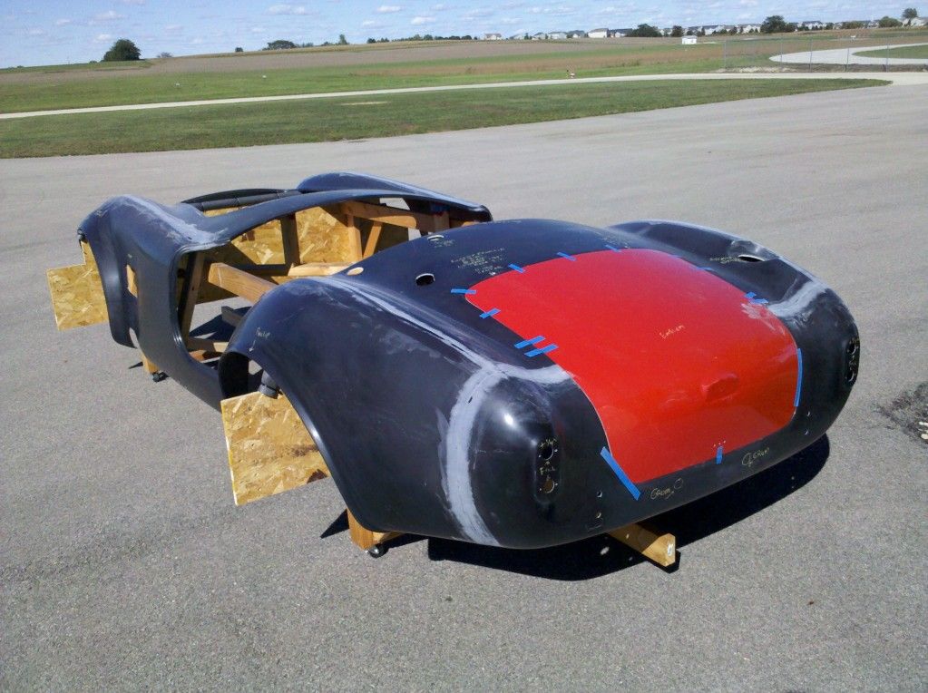

    Finished off the initial work on the rolled wheel lips with a second (skim) coat of Rage, followed by sanding with adhesive paper on a 1" DuraBlock round pad. I cut 2 3/4" off the long block, which is the width of the adhesive sandpaper, so it worked perfect and was small enough to follow the contour of the wheel opening shape while getting full contact with the paper. This filled in some pinholes and voids in the first coat, while giving a nice uniform roll to each lip. These areas will be coated with slick sand when doing the rest of the body, so they'll be finish sanded later. But, for just a few hours of work, I'm very pleased with the results and it was good experience working with Rage for the first time in a spot that's not visible!
    I also did the initial grinding around the tail lamp pads - I'm changing these from the two round lamps to the rectangular, so I wanted to make the contour match the lamps. I made the templates out of some steel plate and started by cutting down the obvious parts of the FFR lamp pads with an angle grinder (3" - 40 grit). This knocked down the sharp edge and I'll further contour this area using Rage. More to come on this one, for sure.
    Before:
    After:

    Finished adding fiberglass to build up the rolled cowls, including 'glassing in the faux dash tube at the top center of the front.
    It was pretty messy work and I went through a bunch of resin as I had to work in small batches. Each few ounces of resin would do a couple layers of cloth - basically making two passes across the cowl. I did eight or ten layers of 1" woven strips, then topped that off with another four or five layers of 1/2" woven strips. I used varying lengths, too, so that there is an uneven overlap of each layer, ensuring that there wouldn't be any seams that pass all the way through the full build-up.
    As was asked, I also took all the gelcoat off, too (well, almost all... there were some thin traces), so that I wouldn't have any adhesion issues down the road. My plan is to give this a rough rolled shape, drill some holes all the way through this build-up, then add a few skim coats of filler (Rage or HSRF - any suggestions?) to smooth everything off.
    It was pretty hot and a little humid today, so I had to experiment to get the resin to MEK ratio right, so that I'd have sufficient work time, but good kick once it started to harden. I'll make sure to post more pics as I get this further along.

    Yet another update in the ongoing saga of my bodywork experience. What an incredible adventure it's been so far and yesterday I reached a milestone - the seams are done!
    Grinding, filling, and sanding the seams was the most time consuming part so far for me. Like a lot of this build, I probably went a little overboard on this part, but I wanted to make sure I did a good job. Even if I have issues with printing or cracking down the road, at least I'll be able to say that I didn't cut corners and that I did the best I could with my limited (really non-existent) experience. I have to admit, though, that it felt really good to stand back and admire the curves on the car when I finished sanding last night... I couldn't find an angle of the body that I didn't like. I also noticed that my feel for bodywork - and I mean this literally - has really come far since I started this. I've heard from many experienced professionals that you do bodywork more with the feel of your hands than with your eyes and I finally understand. I'm now spending as much or more time when sanding just closing my eyes and running my entire hand along the area I'm sanding. It's amazing what you can "see" when you're not really looking! I'm sure it's not perfect, but I'm just hoping to get it close to that so that the painter - the real pro - can put the final touches on it just before shooting the color and clear.
    Here are a few pics of the rear seams - which I worked on yesterday. You can see in the first two that I followed the painter's advice and did one continuous pull on the applicator down the length of the panels (at least where the fuel filler hole didn't get in the way).
    This photo shows the top of the driver's side quarter looking back from the door opening - visually it looks good, but more important it feels good to the hand and the contour gauge doesn't show any flat spots, either.
    I'm getting really close to putting the body back on the chassis for gapping and leveling the moveable panels, but I want to get the door openings at the rolled cowl edges roughed-in first. I'm also working on finishing the hood scoop opening, the trunk lid mounting pads and edges, as well as the rolled edges on the doors. Once all of those things are done, everything will go back on the chassis.
    Speaking of the chassis, when I got to the hangar yesterday, it was still a little early and the ramp area outside my hangar where I like to work on sanding was in the blazing sun. So, after doing a few things inside, I decided to roll the go-kart out for a little fun. I ended up driving it around for nearly a half hour, doing 1 - 3 gear runs up and down the taxiway, and learning a few things about driving one of these cars. First, it's loud. I noticed that I'm blowing out some of the packing in the sidepipes and that has translated into a noticeable increase in sound level. I'm guessing that putting the body on will re-direct some of the sound, though. But, given my experience yesterday, I agree with others that ear protection will be recommended for long rides and for passengers - I'll make sure I keep a supply of yellow foam earplugs in the glove box, just so I can offer them anytime I give someone a ride. Second is that the carburetor is very well tuned and responsive - maybe a tad too responsive with the mechanical throttle linkage... I think I'm going to re-adjust that so that I have a little more travel on the pedal since my linkage gives me the flexibility to adjust the ratio between pedal movement and throttle butterfly opening. What I found was that when I hit an undulation in the pavement at low speed, my foot would push an imperceptable amount on the throttle, causing just a slight hop of acceleration, which would be followed by a few more of those... each worse than the last and in a span of just a second or two, but enough to realize that this thing needs to be treated with serious respect! Anyway, what a blast to drive it around... and what a motivator to keep working on the body so that I can get on the road!
    Here are a couple of shots of the roughed-in rolled cowl to door opening transition... more to come on this, for sure.

    Hood scoop cut-out modified to match the turkey pan. Check out earlier posts for the process of cutting off the scoop and patching the front 8" of the hole:
    Here's how I decided to handle the trunk lid stud plates. Since this is a Mk3, I had the trunk with the "beak" or "stinger" as it was often called - that pointy license plate mounting area. I'm using a custom lid that was made by Karl Gess here in Illinois back before FFR was making the Mk4. This lid looks quite a bit like the Mk4 trunk, but has a bit more room between the license plate mounting location and the latch handle. Unfortunately, what it doesn't have is a clear mounting point or reinforcement area for the Breeze hidden trunk hinges. I used HSRF (before I learned about SpeedGrip structural adhesive) to bond the stud plates to the lid, then as covered above, made forms to allow me to completely encase the plates in the HSRF. Now, I've shaped the HSFR and added some Rage Gold to form what look like raised mounting pads. The final step on the trunk lid is to fill the perimeter where the inner and outer skins come together as the inner skin was a bit smaller than the outer, making the outside 1/2" or so only one layer thick.
    The pads before shaping:
    Layering on the Rage:
    Not quite finished - needs some final sanding, Slick Sand, etc..., but looking good:
