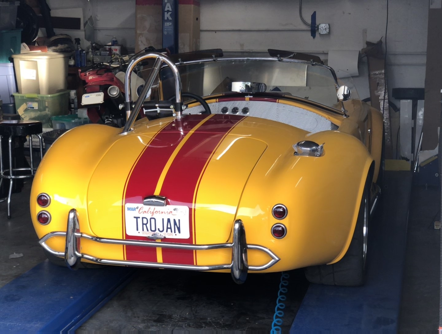

    FINALLY mounted the TROJAN License plate as the car is prepped to show in the FFR booth at Barrett-Jackson and possibly the Grand National Roadster Show in Pomona later this month:
    Senior Member AZPete's Avatar
    2,374
    Geez, Dave, I was drooling as I read through this thread, then I saw that it's coming here to the Barrett-Jackson Auction display next week! Can't wait to see it "live", especially all your beautiful engine turning.
