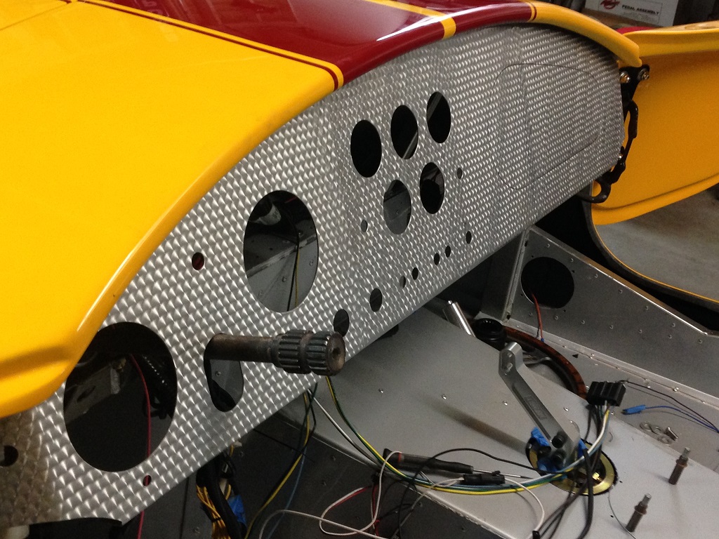

    I spent a few nights getting the dash brackets created and mocked up. I ended up using mostly 1/4-20 nut serts to hold the dash and lower supporting brackets in place. A power plug and phone charger went into the lower bracket under the dash. The dash is the FFR provided plastic/pre covered unit with glove box. with 4 upper mounts and 3 lower mounts I'm happy with how ridged it is, even though it's just light weight plastic. Cutting holes turned out to be easier than I thought. I started from the back with spades on a drill and cut nearly through the black plastic. I finished the cuts, including through the padded vinyl with an exact o knife. It worked perfectly and was quick. The spedo has a little spacing issue though with the retainer ring, but I have some room for adjustments so it should be an issue.

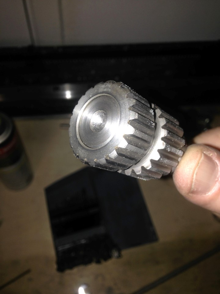

    And with this bone-head move I get to take the opportunity to spend more money. New upper steering column from FFR, another Breeze quick release hub kit, and while I'm at it a second track only steering wheel since I'll have an extra quick release hub. That was an expensive 'ah sh1t' moment.
    Edit: Welded the spline on backwards.

    Quote Originally Posted by Duke View Post
    I plan on using the Breeze quick release but haven't purchased it yet. No instructions posted on their site to know what the install steps are, so can't really tell what you did wrong. Are the splines simply welded in the wrong place on the end of the shaft? Do the need to be further towards the end?
    Are you feeling altruistic? Nobody wants to stew in their own unfortunate situation, but maybe you'll share for the benefit of the rest of us?
    -TJ
    Quote Originally Posted by jeepurz View Post
    -TJ
    Looks like he welded the collar upside down. I don't know what's going on at the top of that shaft but I cut off the last ~1" or so that is beveled before welding. Then I ground the top of the shaft flat after. Doesn't mean doing so is right or wrong, that's just what I did:
    -TJ
    Sorry, yes I welded the splined collar on backwards. There's great instructions with Breeze stuff by the way (on everything I've ordered from them). With the upper shaft I had to cut off the stock bevel before starting which shortened the shaft. I spent a lot of time mocking everything up but at some point I swapped the collar and never checked it with the quick release hub before welding it into place. The extra 3/8" extension I left on so when the quick release was mounted to the adapter hub it the center of the column would slide into the adapter hub. Not per the instructions but it would give the wheel/hub a little extra support. If it didn't work out I would have just cut off the extra 3/8" extension and have it flush like David's. I did bevel/chamfer the column and pre-heat it before welding to ensure proper penetration. The grinding on the end was my misguided attempts to get the retainer clip to clear when sliding the quick release hub on; not realizing it was backwards until I made enough clearance and found out it wouldn't lock into place. Doh.
    Courtnie was nice enough to sell me a new upper shaft on Monday so it should be in route in the next day or two and I ordered a second Breeze full kit. Since I now had a second quick release hub I also decided to reward my stupidity and order a second dedicated track steering wheel (driven wheel from Detroit Speed). I figured why not and it would give me a little more finger room between my gloves and the door when at the track, along with a better hand feel then then the wood. The wood wheel will be street use only from here on out. All in, the mistake ran an extra $450 or so. I also just crossed the 60K mark on the project too.

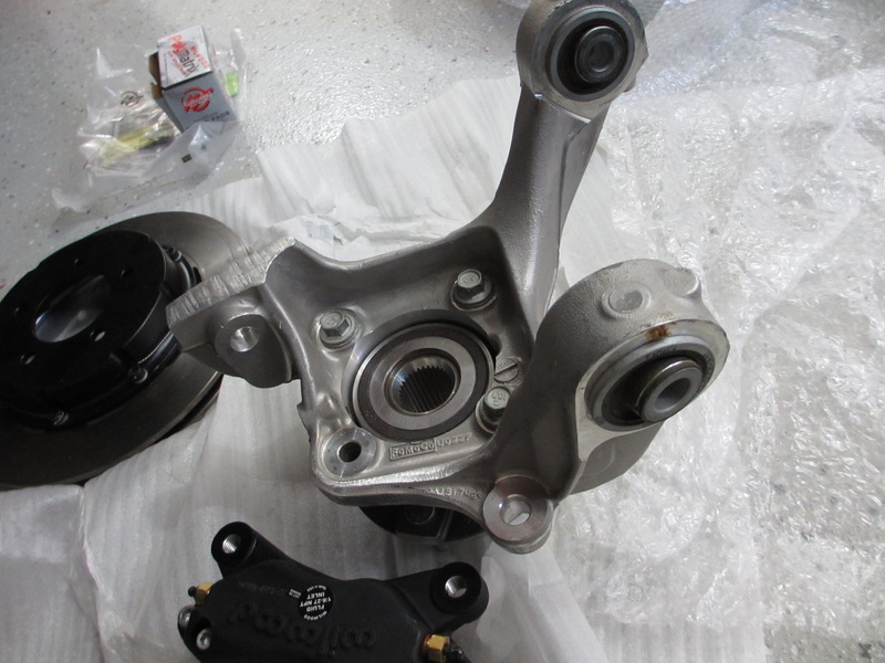

    Still waiting on Gordon for my rear brakes/spindles/wheel. Last I spoke with him they were shipped so hopefully sometime next week. We were aiming for Aug but the first batch of brackets weren't right and had to be redone by the water jet contractor.

    News on the rear brakes, Gordon has them completed and they are in transit. He's done an amazing job and spent countless hours this year on them. More on this when I get them in. For parking brake, we're planning on a pinion brake between the driveshaft and the pumpkin, using a Kart disk. More on this at another time.
    Duke,
    Definitely post pics of the brake setup from Gordon. I've talked with him several times and I'm ready to order once back in town from a work trip. We discussed parking brake options and I was originally planning the line-lock hydraulic option over the kart setup but in WI I haven't been able to track down requirements. To the best of my knowledge, there actually isn't a requirement at all. There definitely isn't a registration inspection with the "hobbyist/collector" registration I'm going with, since I've already registered a rock crawling Jeep that way. We'll see which way I go....
    -TJ

    First, a big thank you to Mr. Gordon Levy over at http://levyracing.com/ for making this happen. His countless hours and many designs he went through, all while managing his own customer builds and motors truly shows his dedication to this niche of the hodrod world. For those of you who haven't followed my build, about a year ago I choose to venture down my own path and ordered my roadster with the new 2015 IRS and planned running 15" wheels on the street. This along with the T56 Magnum transmission made for a uniquely challenging build.
    After countless designs trying to integrate a parking brake into an area that just wouldn't accept it we finally arrived on the design to incorporate a Kart disk as a pinion brake. This little disk and the spot caliper will sit between the driveshaft and the IRS pumpkin and should be more than sufficient to pass my state inspections. These brakes, along with my front cooling ducts should be a good match for the Hoosier R7's I have mounted to my track tires, while allowing me to run the classic 15" wheels and Billboards (Avon's & Trendware) on the street.
    Thank you Gordon for the spindle machine work, brackets, and figuring out how to make all this work:
    L]
