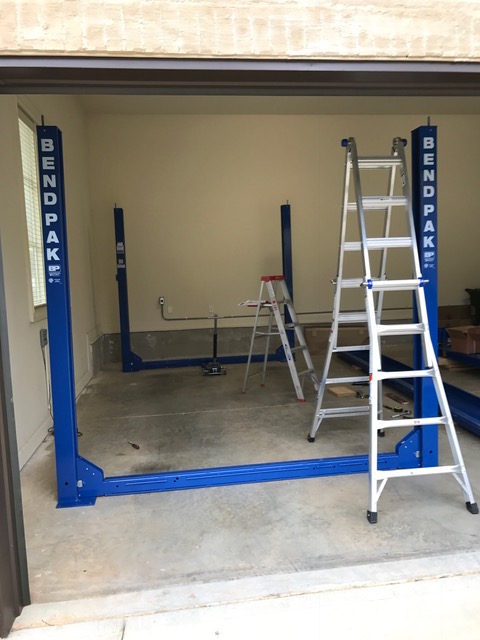

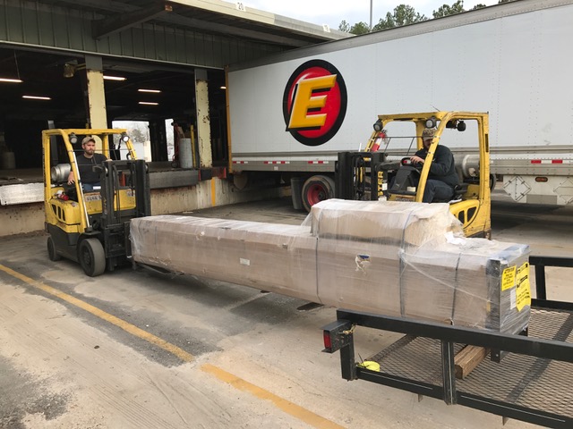

    4 post lift
    Not much to report on the pcm issues. Waiting to hear back from Ford. Anxious to get that resolved.

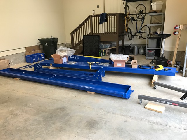

    I have been thinking about and looking at lifts for a while. Ordered a 4 post yesterday and it should be here about February 1. I am excited to get that up and running.
    I went with the Bend Pak HD-9XW. It is long enough,wide enough and with enough lift that I can park my F-150 with the 4 door crew cab underneath it. My primary purpose of the lift is for storage allowing me to park all my cars indoors (truck has been outside since I got the Cobra) but I am sure it will be very handy for working on the Cobra and anything else I would like to do with my other vehicles. This lift has a 9000 lb capacity. Interestingly there is a chart that shows with shorter wheelbases you are limited on how much you can lift. For the 90" wheelbase Cobra that reduces you to about 42% of the rated max so about 3800lbs. That is still plenty obviously. I guess the further away the wheels are sitting from the corner posts the less weight you can load on it.
    The lift has some available options. I got the drip trays that go between the ramps. They offer a very nice looking pneumatic scissor jack that goes between the ramps. I am considering that and may add that to my order before it ships next week. They also offer longer approach ramps that are made for low ride height vehicles. From the data I got I think the Cobra should work nicely with the standard ramps that are included. If not I will order the longer ramps later.
    I have a main garage with a high ceiling and a high lift garage door opener that will provide ample room for the lift. My basement garage is where I keep all my tools and have been building the Cobra but it is to small for this lift. I will have to see if the lift will end up causing me to migrate all my tools upstairs. If I send the wife down to park in the basement garage I am not sure how well that will go over! haha
    The lift has either a 110 or 220 motor. The lift time was about 45 seconds with the 220 and 90 with the 110. The 110 motor has a high amp draw and they recommend a 30 amp breaker. That exceeds my current garage outlets capability and since I am going to need to beef up the electrical anyways I decided to go with the 220 motor. Luckily the main power box for the house is right on the outside wall of the garage so running a 220 line and outlet should be pretty simple. I have an electrician friend coming over to help me with that.
    They quoted me about $800 to install the lift. Decided that was not worth it and it would be fun to do myself. The delivery options where either pick it up at the freight terminal or have it brought to the house. If they brought it to the house you are responsible for getting it off the delivery truck yourself. The package is 17' long and about 2100 lbs. I do not have a forklift so I decided it would be best to pick it up at the freight terminal. They will load it onto your trailer there. I plan to just back the trailer with the loaded package into my garage and then use my engine hoist to pick it up off the trailer and have a couple buddies stabilize the ends to keep it from swinging. Then drive the trailer out from under it and set it down. Once I do that we can start unpacking the individual pieces. Im thinking at 2100 lbs the heaviest piece are probably the ramps and those should be maybe 400lbs each. That should be manageable with the help of friends. Pretty much everyone on my street has helped me on this project at some point along the way. We are blessed with some amazing neighbors that are always willing to help.
    If anyone has experience unpacking one of these or moving the package around any tips or lessons learned are appreciated.

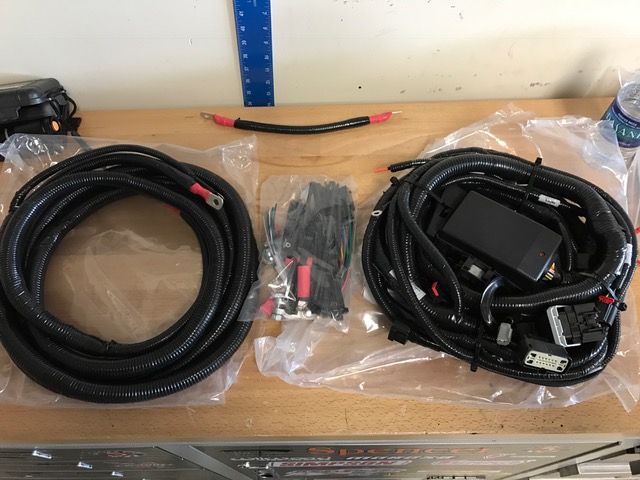

    Last I heard yesterday evening from Ford is they are going to send me a new coyote harness and want me to completely rewire the car. The were testing my original PCM that they still have on an actual motor to see if they could replicate the fault at the end of business yesterday and once that was done the next step was to send a new harness.
    I have mixed emotions on that. I told them it would take me 2 minutes to check a replacement PCM and 2 weeks to change out the harness so how about humoring me and letting me try a PCM first.
    However, I have had a couple oddities electrically since I started this. First when I received the harness my ODB plug was not working. Come to find out Ford sent a batch out with 2 wires going to the wrong position. I had to correct that and after that the OBD has worked fine. I have always wondered if the harness was incorrect there are there any other areas that are also messed up. Additionally my SCT X4 tuner has never worked properly when plugging into the OBD. I have verified the X4 works on my F150 and even went as far as to send the tuner to EdwardB for him to check on his. He had full functionality with it on his car. MY SCT X3 tuner works perfectly on the Cobra. There is some oddity causing that. Lastly, when I was initially connecting the battery I accidentally touched the wrench to the frame and the positive terminal and sent a surge through the system. Now no fuses were blown and the first 6 weeks of the car running were flawless. I have contemplated if there is possibly something going on related to that.
    I am not looking forward to changing the harness as that will require some pretty major deconstruction of the go cart but if that fixes whatever the issue is that will definitely be worth it. I guess my dissatisfaction with the delay waiting on paint is working out ok now because it looks like I will have a fair amount of work to accomplish and I would much rather get everything squared away before the body is in position. That would just complicate things working around the body.

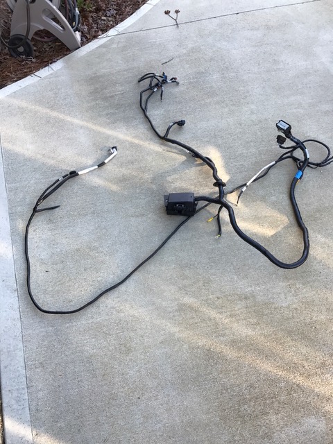

    I performed the harness swap last night and today. It wasn't as bad as I thought it would be. Took about 6 hours of work. I found it was much easier just to replicate what I had previously done vs having to think it all through the first time. As usual Paul (edwardb) was very helpful with my questions. I was very pleased to be able to get the old harness out and the new one in without having to remove the dash. Here is the carcass of the old one:
    I was pretty nervous when it came time to crank up. First thing I did was plug in my handheld tuner. I have an SCT X3 from a previous car that is a little older and a new X4. The X4 has never previously worked while the X3 has always worked great on the Cobra. The X4 has always worked fine on my F150 so I knew it was a Cobra issue. I decided prior to starting I would try out the X4. Well guess what it worked flawlessly! That was a first and a good sign. After that I cranked up and the car ran fine. Took about 30 seconds to stabilize but after that it returned to its previous smooth operation. Ford had told me no DTC codes would show up if there were any until the second start cycle. After it idled for about a minute I shut it down and went ahead with the second start cycle. Still ran great. I got it off the jack stands and went on about a 5 mile spin around the neighborhood. It is running great and no DTCs. I am optimistic it will be good to go now.
    I will be sending the original harness to Ford for them to look at and see if they can tell what the issue was. I will be very interested to hear. Either the harness was bad from the beginning or I screwed something up on the install.

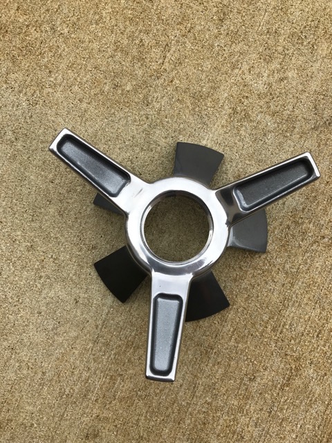

    knock offs / Air intake

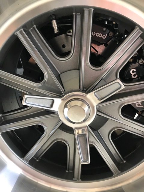

    I mentioned last week I had found a guy to polish the knock offs and paint the little indentions on the spinner arms to match the wheel color. I was really disappointed with the finish they came with. He brought them back to me today. The change is really subtle and the lighting was not great for a picture but I am happy with how they look. Has a little more of a finished look to them. Nobody but me will probably notice them but once I notice a fault I cant stop looking at it! This small upgrade will keep me from being bothered by them! haha

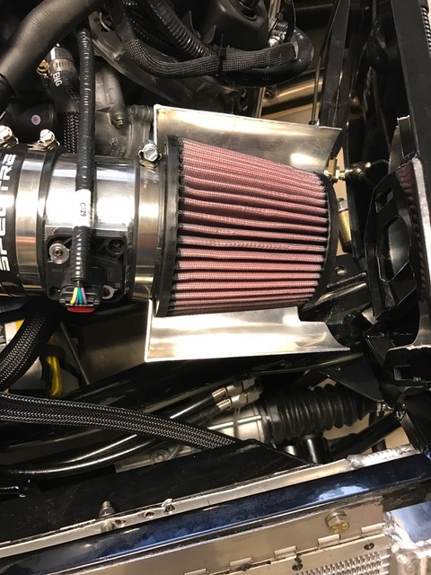

    When I was going through all my pcm/maf issues fellow forum member Duke was very helpful with some suggestions. Included in our discussions was some data logging he had done for his custom tune and the data indicated when his engine fan kicked on it was disturbing the airflow going into the intake. He installed a Spectre performance air filter heat shield to remedy that. I liked the idea and thought I would do the same. Now I have no idea if this will benefit me in any way running the stock tune but I figure worst case it can not hurt anything so I wanted to give it a try.
    I ordered the specter performance 8130.
    Here it is:

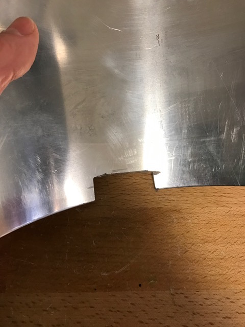

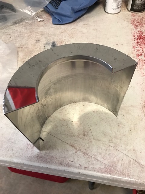

    As with anything on the Cobra it is a tight fit. I had to modify it a bit to fit around the X brace running up below the filter. I have never had the hood hinge in place yet. I believe I have the filter angled down enough not to cause a space conflict. It is possible it will need to go lower in which case I will have to further modify this part.
    Here it is installed. Did a quick test run up and down the street with no issues.

    spinners look nice, something I have to deal with soon. thanks.
    20th Anniversary MK4 Roadster, #8752, 18 of 20, Delivered 12/03/15, 1st Start 01/28/2017, off to paint 4/13/2017, Forte 351w/ Holley EFI, Forte throttle linkage, TKO 600/Forte Hyd. Clutch, UniSteer Electra Steering, RT's turn Signals, many Breeze parts, Paint by the Jeff Miller. Finished on 10/08/2017. 500 mile inspection on 10/21/2017, 3000 mile inspection on 1/14/19.
  36. #396
    Scott-
    Nice decision on the spinners; really completes the look.

    Lift install Day 1
    Well all I have to say is this lift has some HEAVY parts to it!
    Started off yesterday going to the freight terminal to pick it up. Took them maneuvering 2 forklifts to get it on the trailer. That was quite a process in itself.
    I guess the freight terminal did not have one of those giant forklift with the long arms that this crate was designed for. After we got it home just breaking down the package was a chore. Ended up picking up the heaviest piece with the engine crane and getting it to the ground. After that 4 of us manhandled the rest of the pieces.
    Here is the pile of parts waiting for construction.
    Got the four corner posts erected and the cross tubes. The cross tubes were really heavy and getting them up to the top of the posts that are about 10' tall and lowering them down was a three man job.(I got the extra wide, extra high lift so I can park my truck under it. The short ladder in the pic is 6')
    Here is where is sits now. Had to do a couple steps over. The directions are pretty crappy.
    Now I am up to installing the ramps. They are extremely heavy. Gonna need to recruit some more neighbors tomorrow. Hopefully with some help I can get this thing completed this weekend. Lucky that I have some great neighbors always willing to lend a hand!

    You are buying the lift when you car is 98% done? You must be making room for your next project. Gen III Coupe? 33? Can't wait to watch the next wareagle episode?
  39. #399
    Quote Originally Posted by Straversi View Post
    I am primarily buying the lift for storage. Currently I have 1 more car than I have garage spaces and my truck has been living outside since the cobra showed up. I got the extra long and high lift so my truck will fit under it. That is what I am currently telling my wife. (She is very supportive though).
    ...however the truck being outside isn't so bad and now my workshop garage could be empty with room for a project
