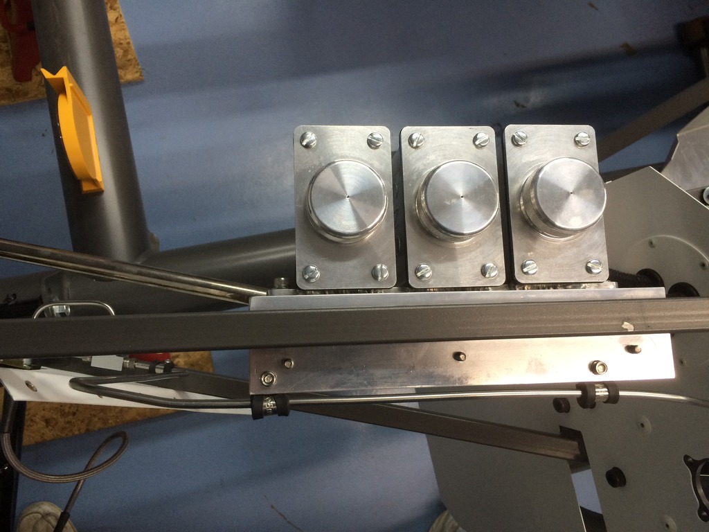

    Other activities include creating a bracket for the CNC triple brake reservoir, cutting and mounting the rear differential vent, drilling and clecoing panels, practicing bending/flaring stainless steel brake lines...
    I'll get a proper update with pics soon but right now I have many things started but few things finished...

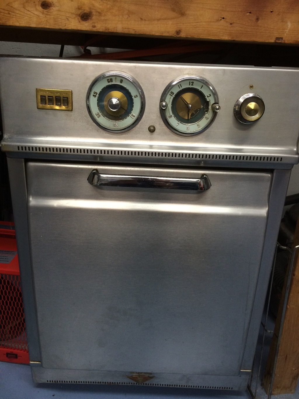

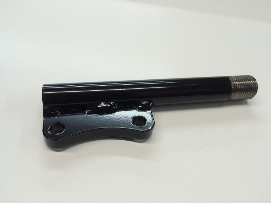

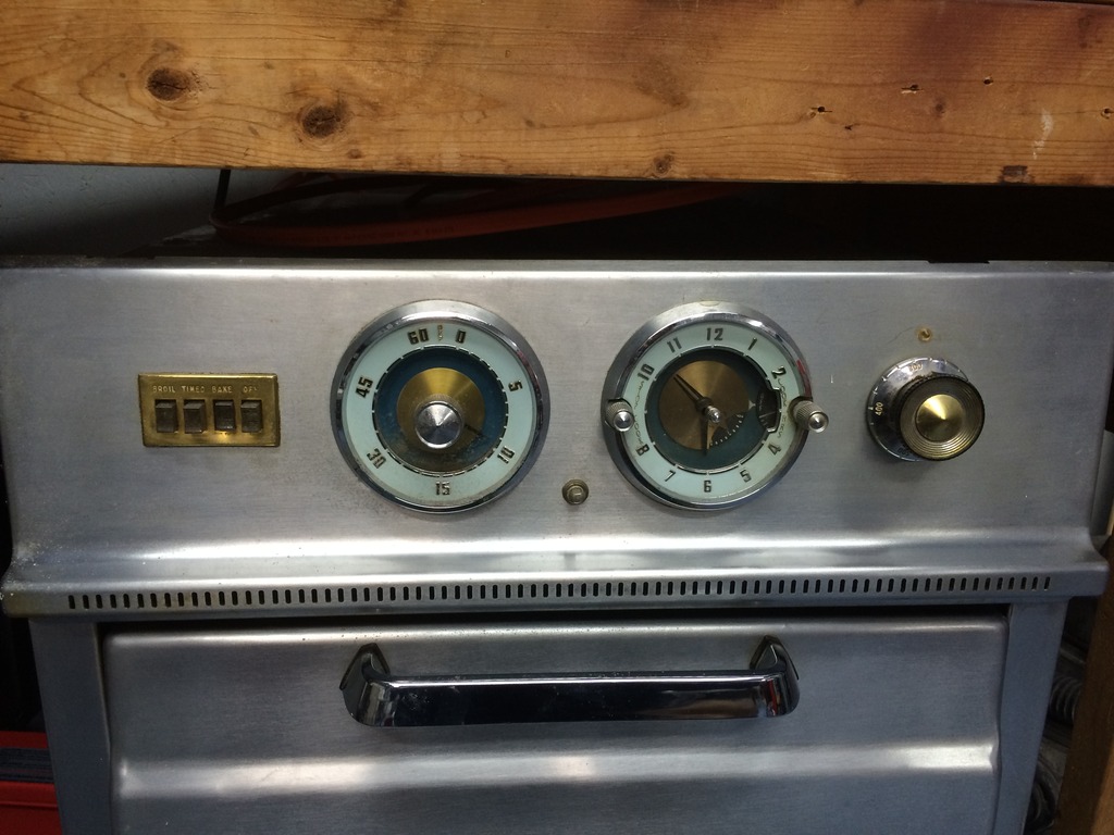

    Powder Coating Setup:
    I want to thank everyone that posted about how simple it is to get started with your own Powder Coating setup. It really is VERY cheap and easy to get setup. I went with the Eastwood Dual Voltage HotCoat Powder Coating Gun
    Item #11676 and a pound of the #10107 Powder High Gloss Black. That set me back about $120 - all I needed then was an Oven to bake it in. I considered the little Eastwood Oven but I was afraid it would be too small so I took to Craigslist and found a 1950's Vintage Oven for $35 bucks. It was in great shape but it still had the 1950's wiring... I took it apart enough to get a modern extension cord hooked up and I placed the oven on a little dolly so I can roll it under my shop workbench. So now, for a little over $150, I'm all set for powder coating small parts.
    Here are some pics of my new toy:
    And here is a pic of one of the parts I have powder coated so far:
    The oven has a Dual Rotisserie and an Automatic Shutoff timer - pretty fancy for a Powder Coating Rig...
    i am going to try the Clear Powder next to see how it seals Aluminum.

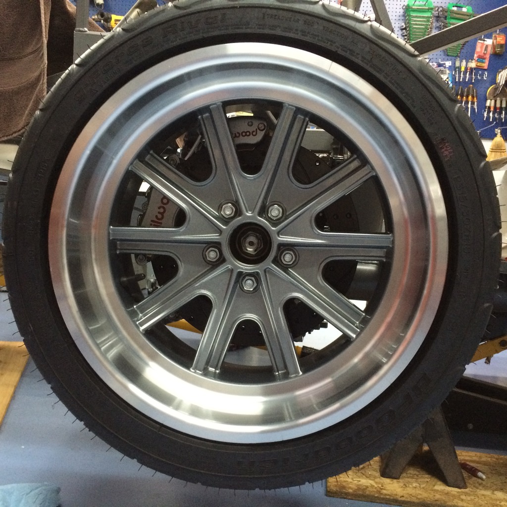

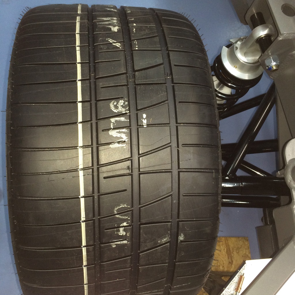

    Tires:
    I also went ahead and picked up my tires last month. I went with the BFGOODRICH G-FORCE RIVAL S tires. I have had several sets of these in the past and I like the performance/price/treadwear combination that they provide. I picked up the P315/30ZR-18 for the rear and P245/40ZR-18s for the front. They are fat and sticky!

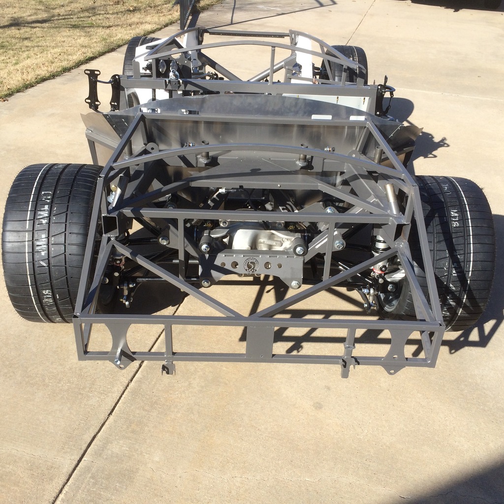

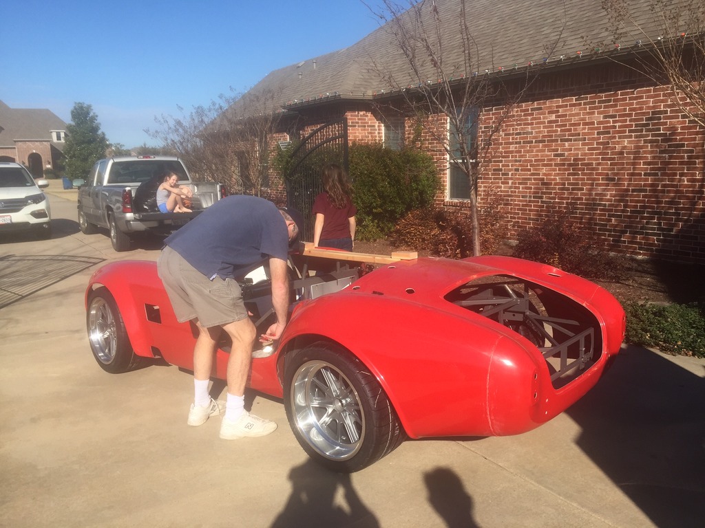

    Rolling Chassis - to see if I fit...
    As I mentioned a couple of posts back - King stopped by over the holidays and I had a hard time getting in and out of his car (AKA - it was never going to happen). I climbed in like I would my DD and my left leg was NOT going to get over door sill. Anyway, since I had my tires mounted and most of my suspension done, I thought I would roll it out and see if i could get into mine. I did figure out an easy way to get in and out but I do need to support myself on the center console and the body behind the door. Anyway, here is a pic of me pulling out some cleco's so I can get the seat in:
    And another shot without the body:
    You can almost see the Diff Vent Tube in that shot but here is a better look. I just trimmed the 2015 Mustang Vent and heated it up a bit to get the bend a little straighter. I did not have to move the clip although the test fit left a little bite mark on the right...

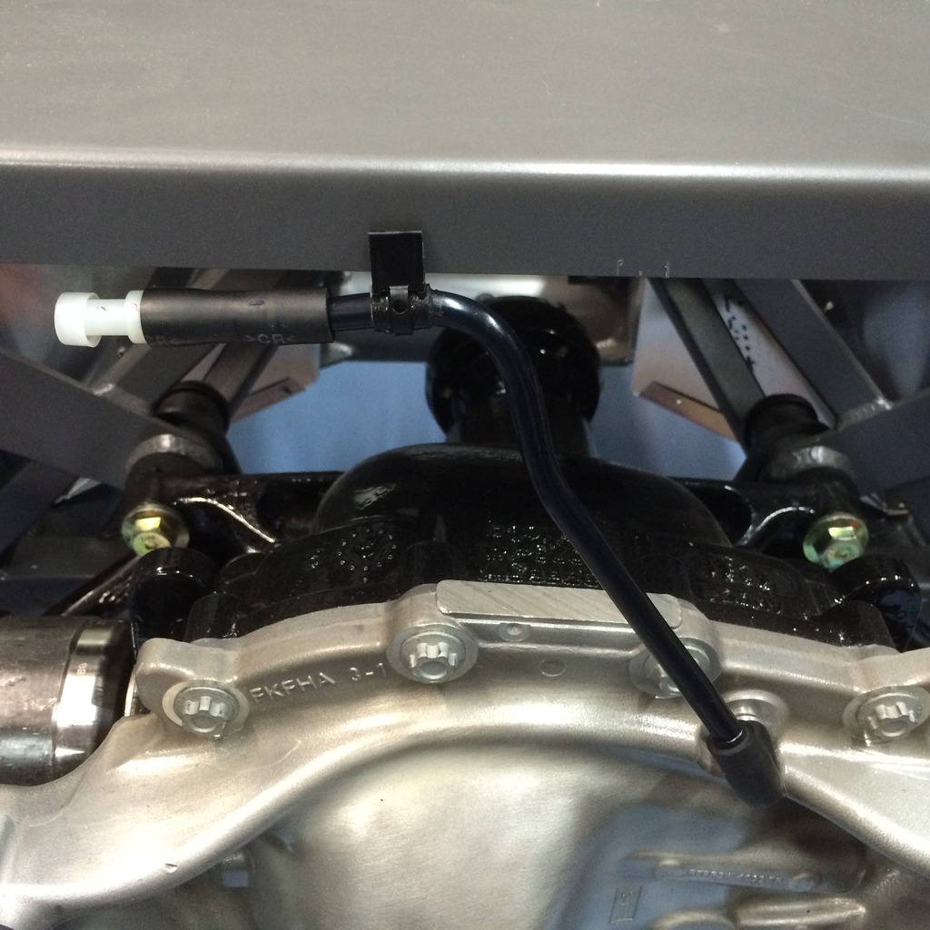

    Albuquerque, NM
    Quote Originally Posted by RRussellTx View Post
    I'm clearly not an expert on the topic(especially with this particular diff) but one comment about the vent tube routing/layout. With the checkball/one-way vent on the end, the only way it works as designed is if it's mounted vertical. Most have a small plastic/poly ball in them the seats properly based the situation: car upright/no pressure escaping, car upright/vent out under pressure, car sideways or upside down, etc....
    The line coming out of the diff is at about 11o'clock position with the vent at 9o'clock. It looks like if you move the line to 2o'clock, the vent will be upright at 12o'clock and can still be mount on the same surface. All of this being said, it may not really matter that much based on the baffle on the inside of the diff for the vent. Oh, and by keeping the car shiny side up....
    Beautiful build, I'll be continuing to follow as you make progress.

    Most check valves have a spring on the ball that forces it to seat unless there is pressure pushing the ball up, allowing the pressure to escape. It could very well work in any orientation.
    11,123
    Quote Originally Posted by jeepurz View Post
    -TJ
    Quote Originally Posted by Jazzman View Post
    Thanks for the photo of your differential vent tube installation. I am working on that right now. It is nice to see on possible option. Do you plan to make any change to the routing based upon TJ's comment about the need to install the vent vertically?
    Quote Originally Posted by networkcrasher View Post
    I just looked at the Ford differential vent tube (FR3Z-4A058-A) and this is a non-issue. There's no check valve in the end of the line. It's just a little plastic cap that's loosely mounted, I'm assuming to keep water, debris, whatever from getting into the tube. Blowing through the tube it works exactly the same except when in a complete upside down position. It should be fine mounted as pictured. I'm actually not surprised about this. The 8.8 solid axle also has a vent on the top of the axle tube about halfway between the diff and the end of the axle. It's metal, but it also has a loosely fitted cap I assume for the same reason.

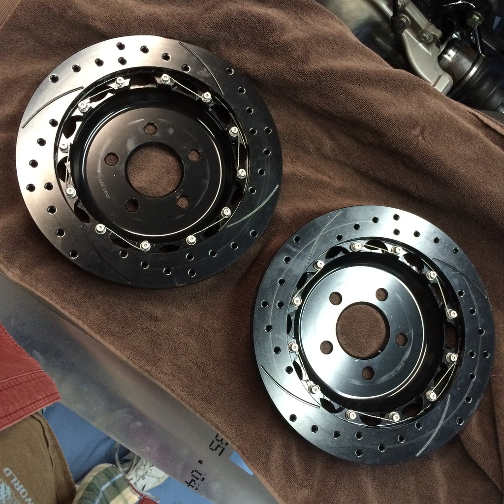

    Well, after almost 5 months since my kit was 'ready', I have received my very last back-ordered part today (door latches)!
    I received the front brakes last week and got them installed over the weekend without any issues and received the e-brake cables yesterday.

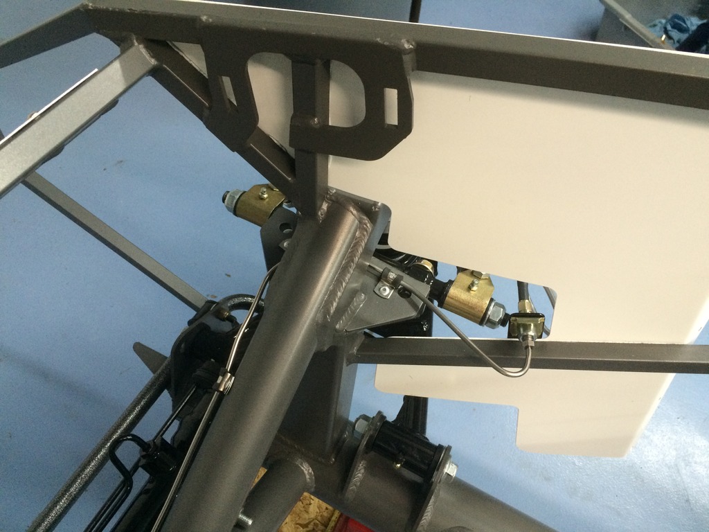

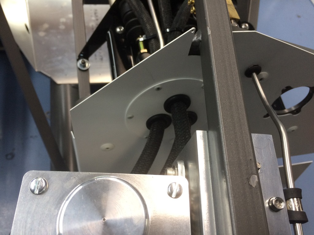

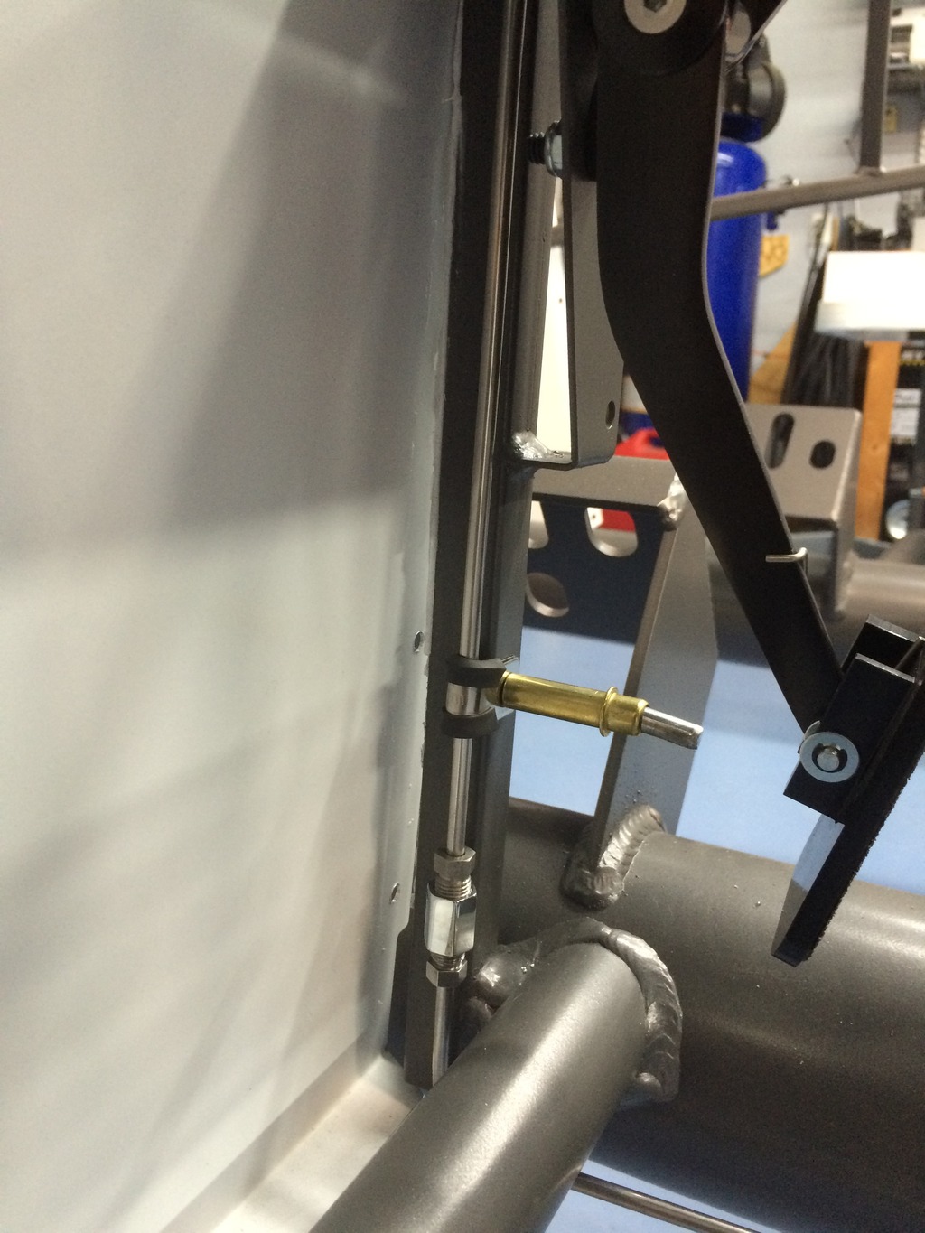

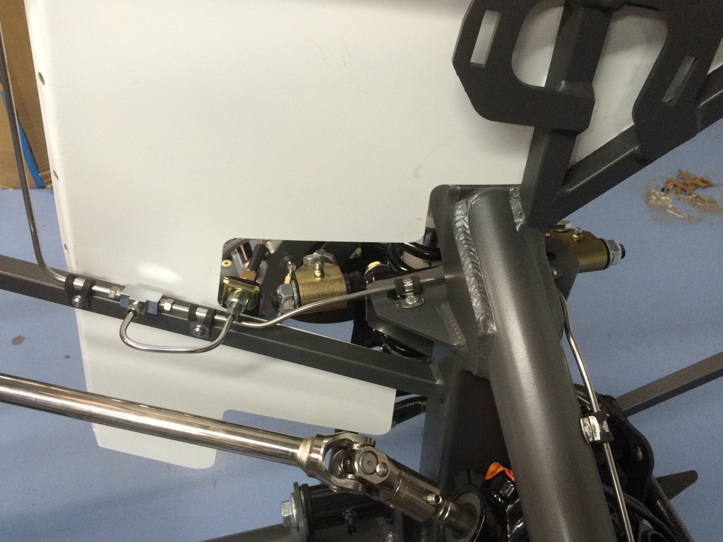

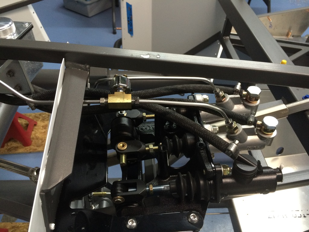

    Brakes are complete!
    Also, the brakes are just about complete. Here are a few pics of the finished product:
    DS Front:
    PS Front:
    At Reservoir:
    Footbox Panel:
    Pedal Box:
    Inside Footbox:
    Looking down on the DS Rear:
    I used the Gardner-Westcott Chrome Fittings and Stainless Steel Lines flared with the Eastwood Flare Tool. I also use the Ron Francis Brake Light Pressure Switch (SW32). This was my first attempt at brake lines and I'm pretty happy with the results. There is a pretty good pile of rejected attempts but I finally got a few runs that I was happy with. I still have some work to do getting the rear brake lines through the footbox floor but that should be pretty easy compared to the rest of it.
    Really looking forward to getting the engine so I can be sure of the fuel line routing and the general fit for the engine compartment panels.
    11,123
    Great job on your brake lines. First time and stainless too! Excellent work. I'm going to steal a couple of your routing ideas since my Anniversary build is the first time I've had the MC's inside the footbox. One hint/observation: Nice and neat how you brought the fluid reservoir lines through that access panel in the footbox front. But that location is normally used for the front wiring harness leg to exit the footbox and go up to the front of the chassis. Could get a little congested in there, or maybe will take some other creative routing. Your engine numbers look great too.
    Jun 2015
    Parker, TX
    288
    Thanks for the tip. I'm finding that 'Creative routing' is a large part of my build! I don't need the clutch opening since I'm going hydraulic so I was looking at that for the wiring harness exit. It also won't be the first thing I've had to redo if I don't like it later.
    GREAT JOB running those brake lines!
    re: fitting into the car. On both of my build I cut off ~.45" of the threads between the MC and the pedal, and then cranked them all the way down to the bolt at the top of the threads to gain about 2" of legroom. What are you doing for seats? I used the Kirkey Vintage 48's instead of the big and tall traditional style seats. This gives you additional legroom as well. Last note regarding entry/exit. I instruct all newbies to stand on the seat and put their butt on the edge of the body (watch out for Levy jeans buttons and keys!) and then "walk" their feet down into the footwell and drop down into the seat. Exiting is a tricep press, working your butt up to the top of the seat before swinging your left leg out over the door sill and pipe. Trying to get your leg out before getting your butt up above the seat is a SURE FIRE way to get burned by the side pipes!

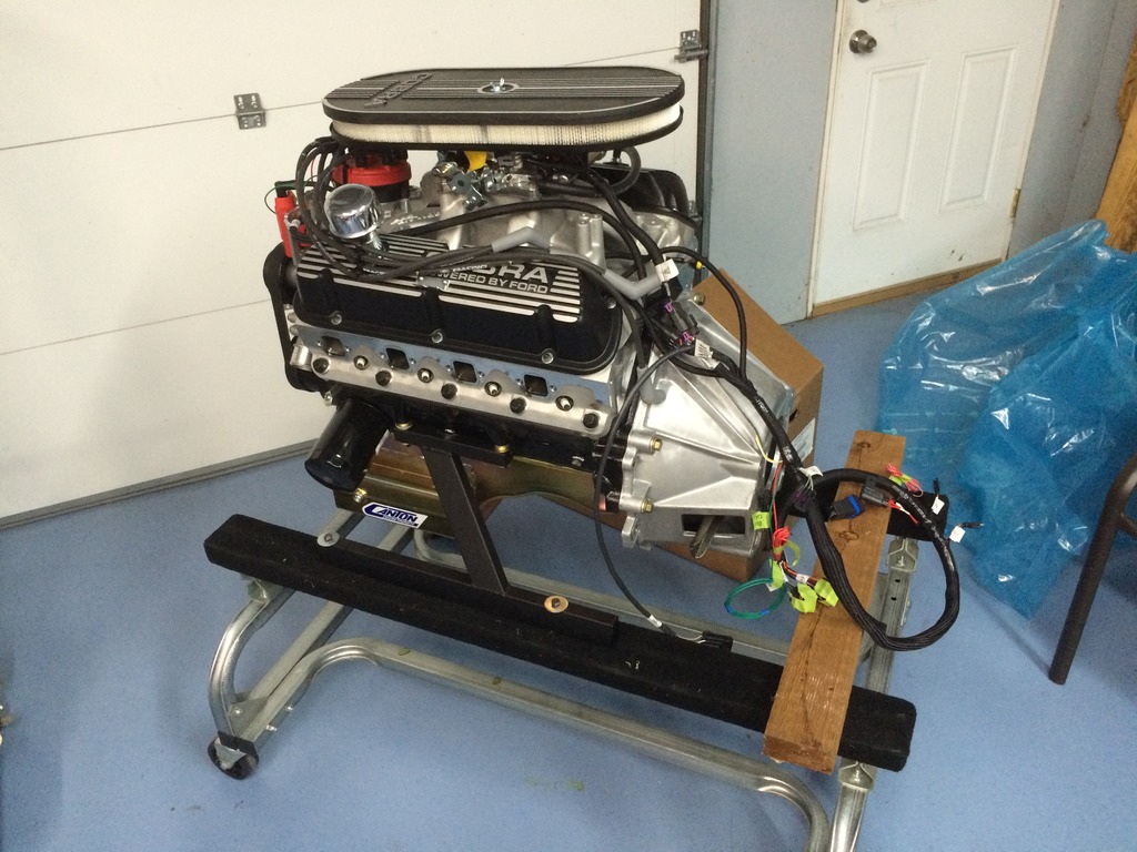

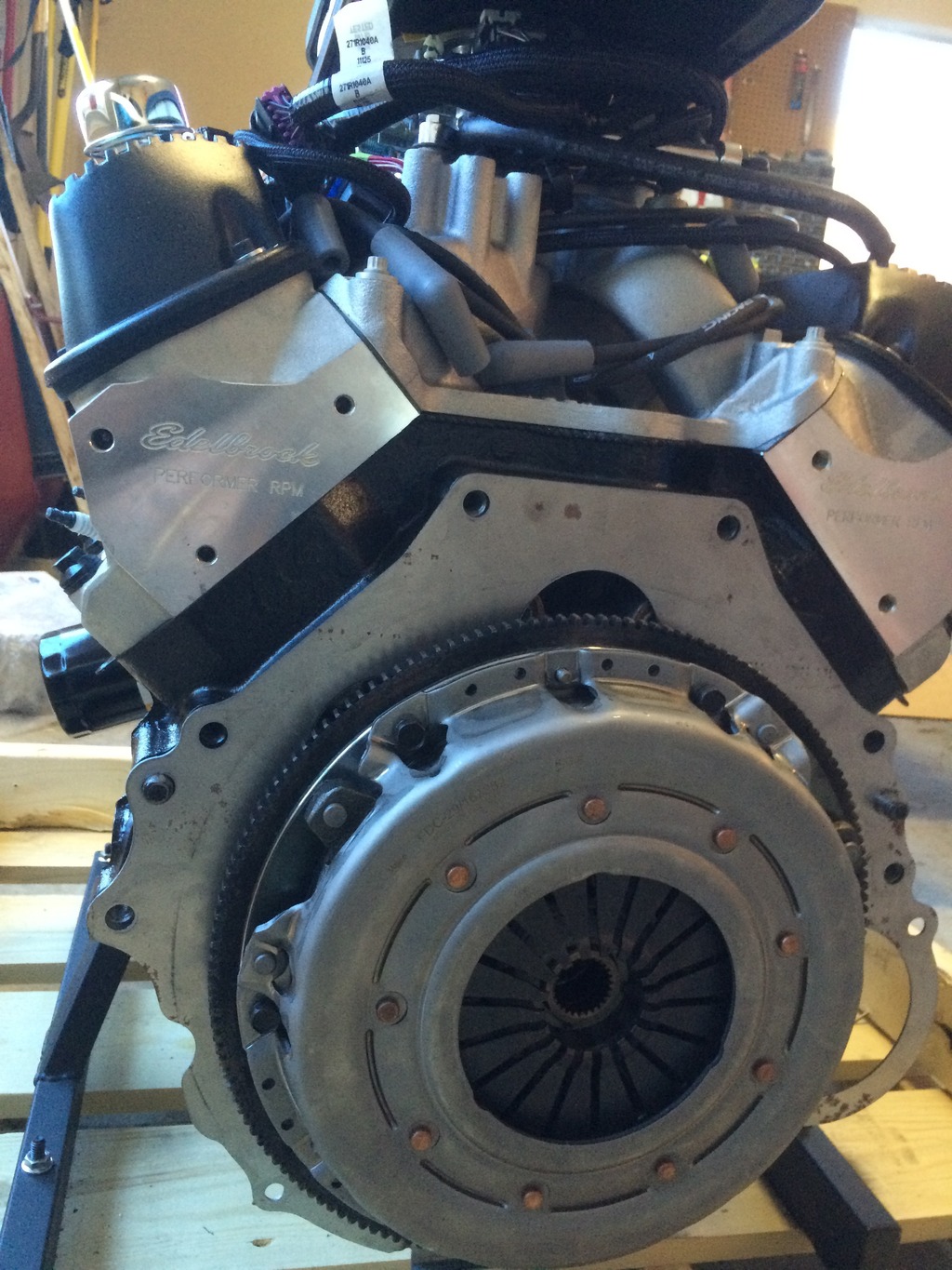

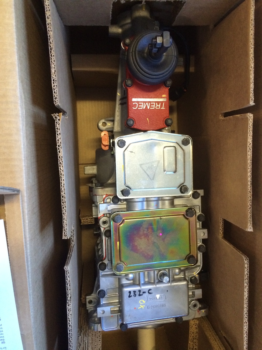

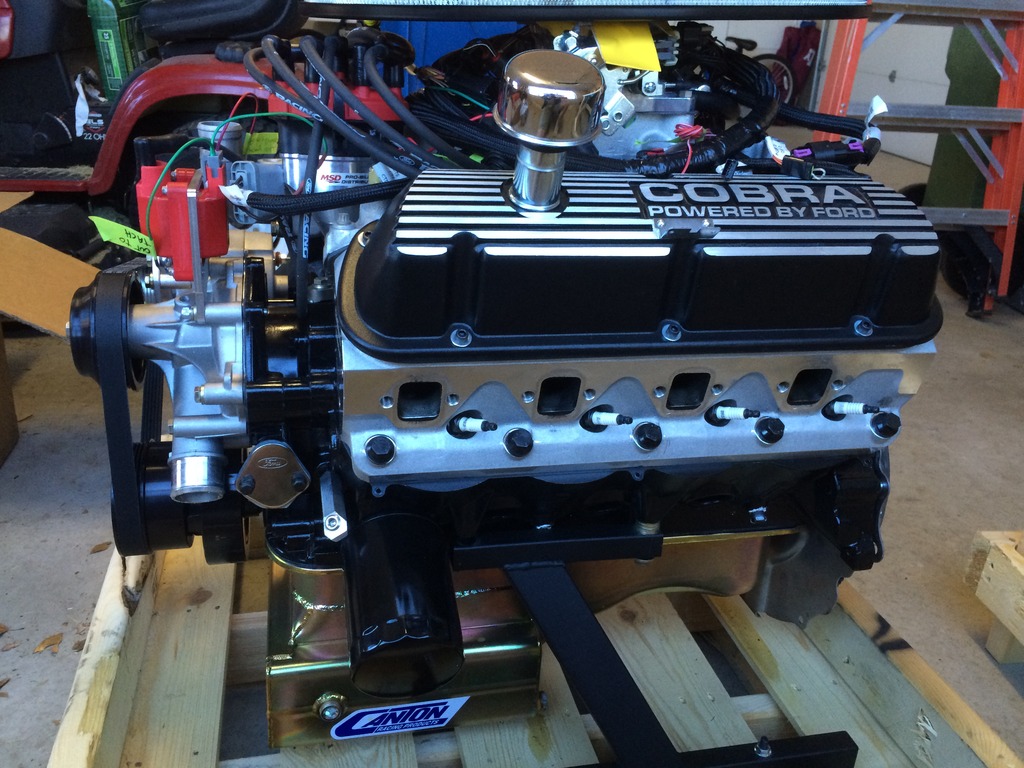

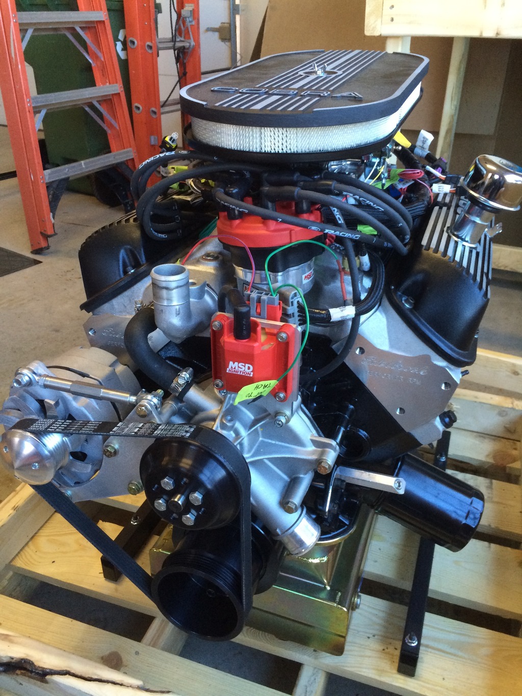

    The wait is over!
    I ordered the 427w Dart with the Holley Terminator EFI on September 17th from Mike Forte and it finally arrived today. It was supposed to be 6-8 weeks but turned out to be 24. I think Mike is like that friend of the family that wants to help everyone out but just does not have the time to get to everything. He will take care of you eventually but just can't say when - Kinda reminds me of my Dad and all of his projects without the pass that I get to the front of the line.
    Anyway, I hope to get everything stabbed in this weekend (Hopefully Dad can make it up) so I can start to figure out the fuel line routing, electrical placement, power steering pump, other bling on the front of the engine, headers and all the other items that need to go around the engine.
    Here are some pics and I hope to get some more this weekend with it in the car.

    Great looking motor. Seems worth the wait to me but hopefully did not hold you up too much. Did Mike run a dyno?
    Doug

    Quote Originally Posted by dougski View Post
    I agree - I'm not in a hurry so the wait was not a problem at all - the lack of knowing when to expect delivery was frustrating but not a problem. I posted the dyno results on February 7th below - well worth the wait!

    Thanks for comments on the build and the brakes! As for the info on the engine, I went with Mike Forte based on his reputation in this community and his pragmatic views on what these cars need. Given that, I went on the assumption that no other data is needed but I probably I expected a little more data than I actually received.
    I have actually not had much luck with communication from Mike - latest example, I was supposed to get a video about the build but I have not received one yet and he has not responded to my emails. I also received an extra hydraulic clutch kit from him with 2 extra master cylinders and he has not answered the email about how to return them yet either...
    That said, it's a great looking engine and I'm quite sure it's going to run like a scalded dog.
    I would probably build the next engine myself so I know exactly what I have but it's nice to have that out of the way so that I can focus on the rest of the car. I'm not sure what other people have experienced but that is mine.

    Great job on the powder coating, too. My wife bought me the DIY Eastwood kit, too and I found one of the discontinued Harbor Freight ovens at a local garage sale. It'd been used only a couple of times for the seller's chopper project and he decided not to build any more bikes - so I was able to pick it up for $100.
    Very cool - DIY Powder Coating is the ONLY way to go for the small stuff! I'm contemplating building a larger homemade oven to do the larger panels but I'll probably end up just taking them in to a local powder coater. I just received 12lbs of the 20th anniversary white powder that Edwardb found a source for so I'll probably go one way or the other next week.

    Has anyone had issues with the Prismatic Powders white? As you know, the anniversary roadster comes with several panels coated with Prismatic Powders white. My local powder coater is doing a great job applying the Extreme Powder Coating's Glimmer but is not fond of the powders from Prismatic. He has found them to be difficult to order from and they are very slow to deliver. Also, he finds the product terrible to work with and often has to apply several coats, with light sanding in between.
    11,123
    Quote Originally Posted by ThickCobra View Post
    Strange, isn't it? I needed three pounds to do a few custom panels that I made, to replace the ones supplied already coated from FF. I ordered directly from Prismatic Powders on a Thursday, and had the powder on Friday. Less than 24 hours after I ordered. They had a promotion going for next day delivery, so that was part of it. But their website claims they ship same business day when ordered before a certain time. The parts came out very nice. No problems were noted, to me anyway. My powder coater said he liked the coating and color very much. Said he was going to consider making it one of his standard offerings. I don't know anything about powder coating (other than the general concept) so I can't begin to explain why two companies would have such different experiences.

    That is strange. I wonder whether it may be a relationship issue between my powder coater and Prismatic. I am waiting for a call from my powder coater to pick the white pieces. I can only hope their as nice as the glimmer color. I'll keep you posted.

    I got the engine out of the crate latest weekend and mounted it on an old Jet Ski stand so I can roll it around. I noticed some oil in the crate so I let it set for the week to see how bad the leak was. Here is a pic of the engine on my stand and the puddle underneath it after one week.
    Looks like I have some work to do on my 'crate' engine before I can install it...
