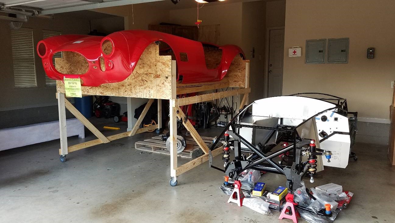

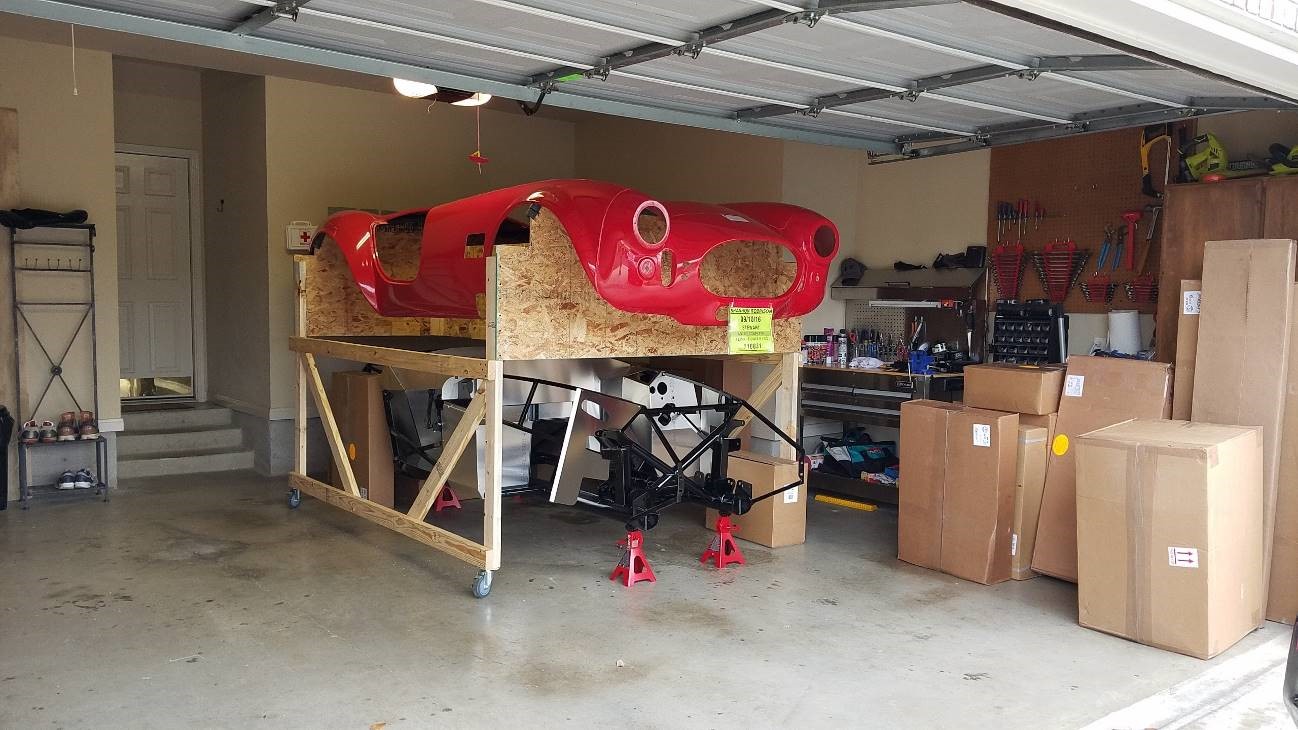

    First day was........interesting. I am going with interesting. Delivery was scheduled for Sunday 9/25. Stewart Transport couldn't get in my neighborhood due to some low haning limbs. So we regrouped and set up a meeting place (Walmart parking lot) for the next morning. I scrambled around trying to find a trailer on Sunday night. Luckily a friend came through so I showed up early Monday morning for pick up. Of course it was raining. What else would you expect? We got her loaded though.
    Got my kit home safe and sounded but a little wet. I didn't have a dolly so I removed the body and muscled the chasis off the trailer and onto jack stands. Thanks to my wife, I had an extra pair of hands for setting the jack stands and removing the body. I even got about half the inventory done.
    I was a little nervous during the unload but all ended well. Hopefully the build goes a little smoother.

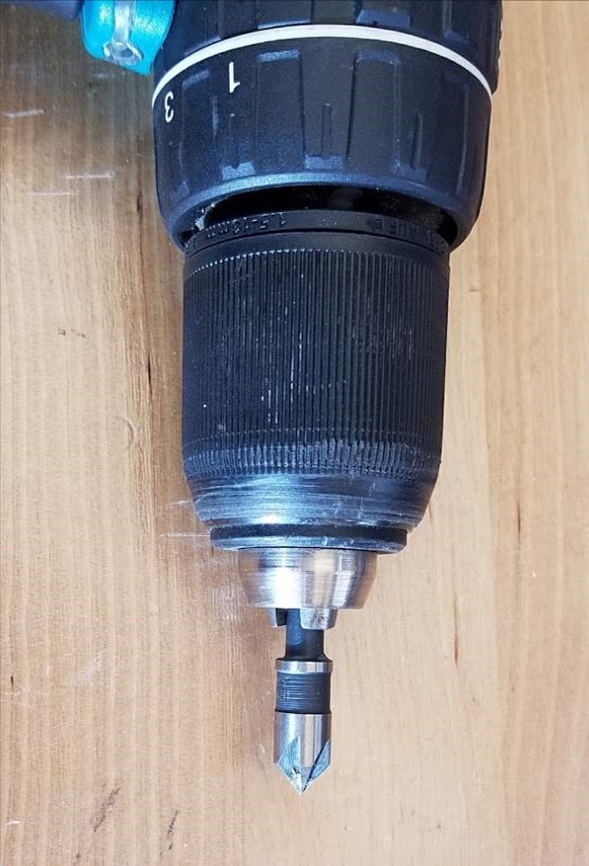

    The second item I discovered was a new tool. I could not find a deburring tool locally and I wanted to get started. During my search I ran across a 3/8" countersink drill bit. It resembled a hand tool I used while reloading bullets to debur brass casings. I bought it, gave it try, and it worked really great. I could quickly debur the aluminum holes. I would simply run my drill at about half speed, apply light pressure, and make 3-4 revolutions. Here is a picture of the bit. Hope this will help others. It was new to me so I thought I would share.

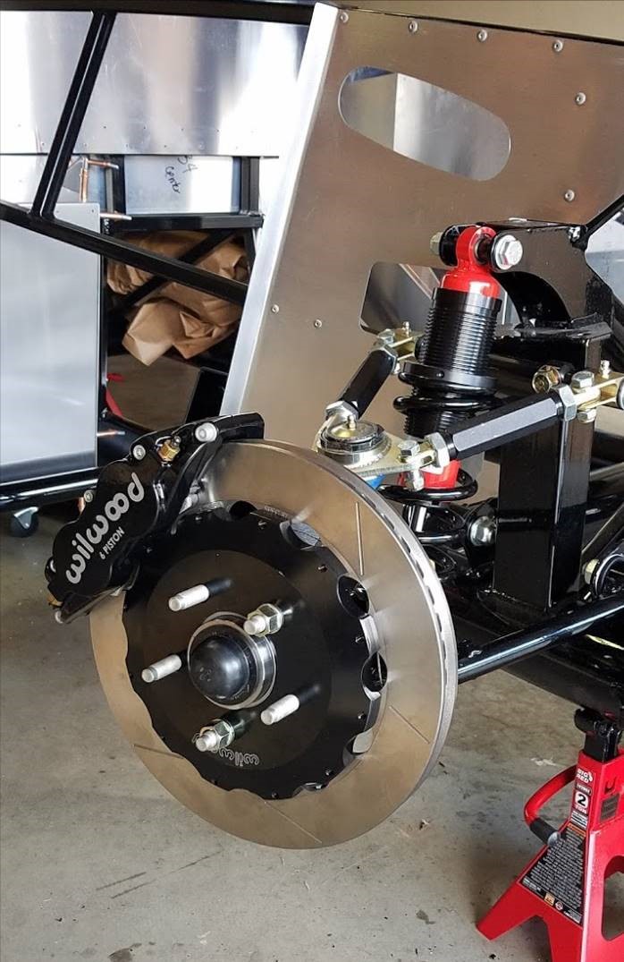

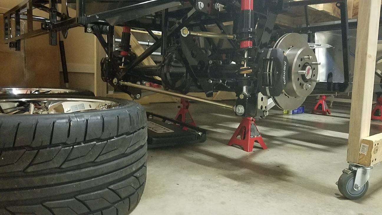

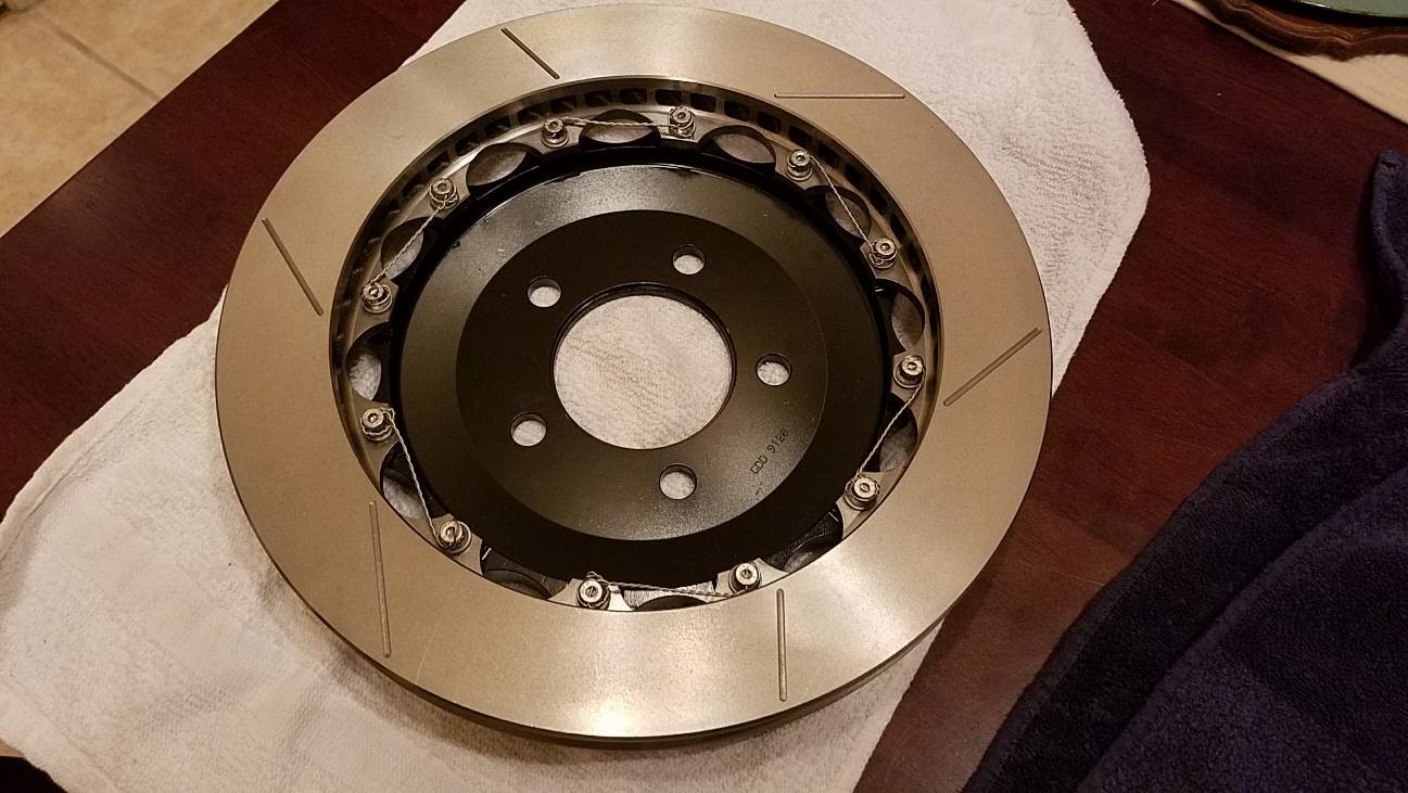

    I also finished the front suspension and brakes. The front suspension went on smoothly. The only problem I encountered was finding the correct socket for the axle nut. I searched the forum and as usual found the answer......36mm. The local auto parts store had this on hand so no big delays. The only small delay was getting that thing torqued down. I might have pulled something but it is in place. Let's hope I don't have to remove them.

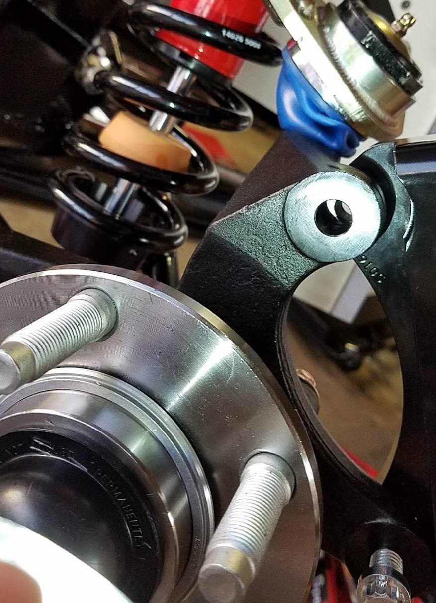

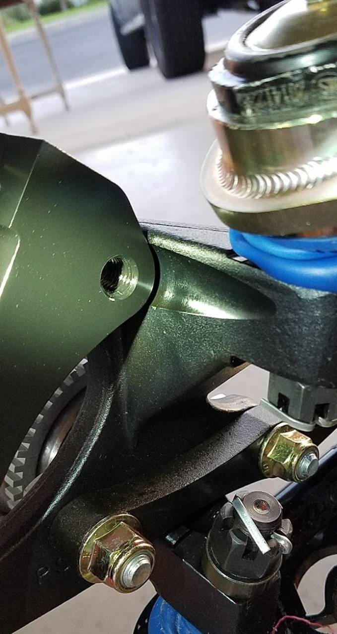

    I did encounter one small fitment issue while assembling the brakes. The wilwood caliper bracket would not line up with the holes on the F5 spindle. See the picture below.
    This might be common knowledge for the more experienced but was new to me. Gordon confirmed I needed to do a bit of grinding on the spindle and the bracket. I tried to concentrate as much grinding as possible on the spindle. I removed small amounts from the spindle on the pre formed "valley" that interfered with the bracket. You can see this "valley" in this pic.
    I used a pneumatic 1/4" grinder with a aluminum oxide bit I found at Home depot. It didn't take long. I painted the exposed metal where I ground the spindle for protection. I got everything completed and here is the final product.

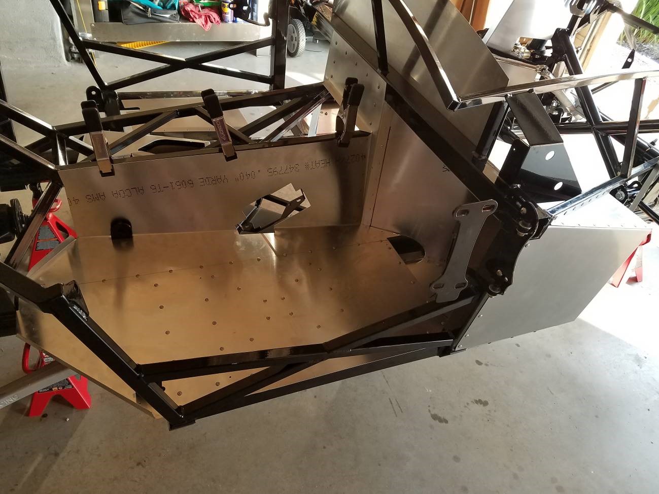

    I did some aluminum panel fitment on the driver side foot box. After fitment and sharkhide on those panels I was ready to call it a week. Hopefully I can keep up the pace. My target is 10-15 hours a week.

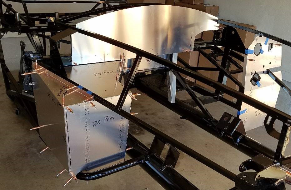

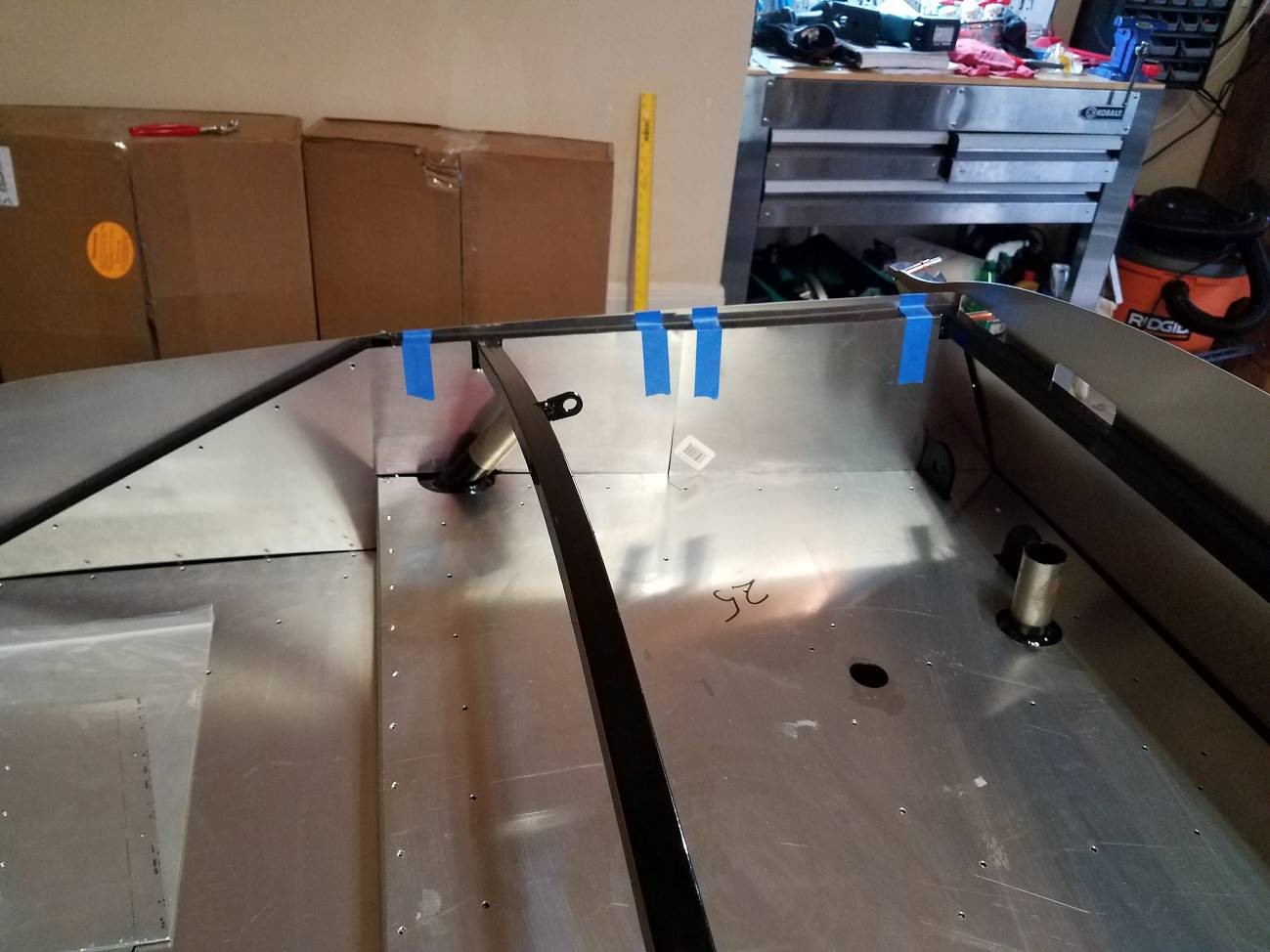

    I also got the aluminum panels permanently installed on the passenger side footbox. As you can tell, I put in plenty of rivets on the passenger side floor. Might be over kill but better safe than sorry.
    The aluminum panel work went smoothly, it just took some time. I discovered quickly I was not going to install hundreds (probably close to a thousand) of rivets by hand. I like to think of myself as efficient not lazy. Yeah that sounds better As my Dad use to say, "Work smart not hard boy." I initially bought a cheap pneumatic rivet gun (Amazon prime and late nights got me again). It lasted 3 hole rivets. It got returned and I purchased one locally from Northern Tool. Their house brand is called Klutch and so far it has worked well. Time will tell.

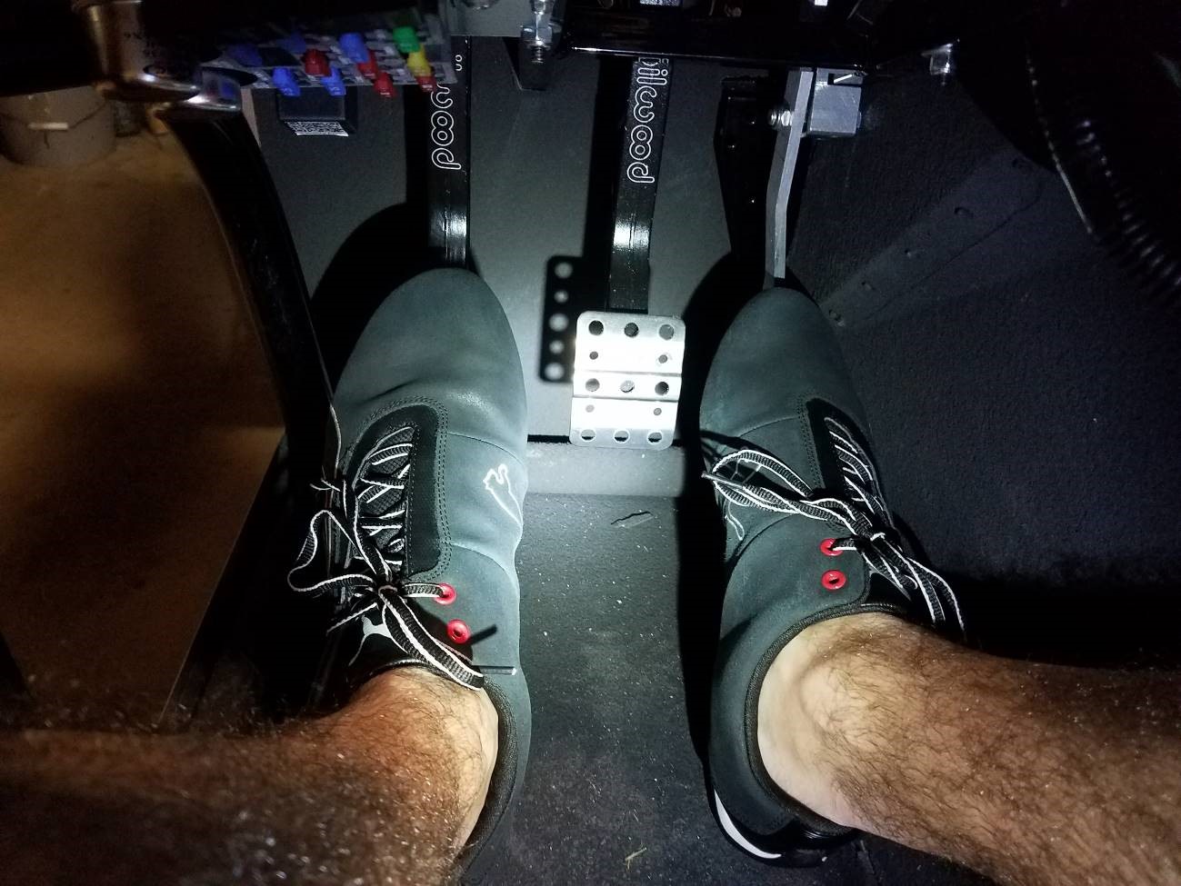

    My main "opportunities" arose with the pedal box. I have the complete kit and of course the Wilwood pedal box. It comes supplied with a 3/4" and 5/8" master cylinder for the brakes. I have Levy Racing upgraded brakes and he recommends a 3/4" master for both front and rear brakes. I purchased an additonal 3/4" master from Summit. It arrived and I quickly noticed the fittings for the outlet (I am sure there is an official name but I mean the pressure side) was not the same size as the 3/4" supplied by F5. The F5 3/4" MC has a 1/8-27 fitting on the end. There are easily accessible fittings for this size thread to get to 3/16" flared fitting for tubing. The additional MC I bought from Summit had 3/8-24 threads. I have had a hard time finding a 3/8-24 male to 3/16" flared fitting 90. A fitting of this type would match the one supplied by F5 (purely for aesthetics). Well, long story short, I decided to run braided hose from the MC to footbox wall. Fittings for this connection were readily available. I will then use a bulkhead fitting. to transition back to 3/16" tubing. If anyone see issues with this please let me know. I am waiting for the fittings to arrive and will post pictures when I am complete.
    My second issue was the accelerator pedal. The problem was I could not find it. Turns out it was never packaged up with my kit. I spent 3-4 hours looking diligently through each box (AGAIN!!) with no luck. I called Factory Five and they confirmed it was not sent. They were very apologetic and hopefully it is on it's way. Great customer service.
    Last issue of the week that sucked up a lot of time was the clutch cable. I was originally planning on using the supplied clutch cable from F5. I got all this mocked up on the pedal box and just didn't like the route the cable would take. It will be really close to the headers. I know this has been done alot and I know some experts will say a hydraulic clutch is not necessary. I just think I would feel better and why not help stimulate the economy. Plus it's my car so.... I talked to Gordon Levy and he recommended the hydraulic clutch kit from Mike Forte. I called Mike and he has them in the mail. Again great service from both. Hopefully I will have some pictures for everyone to review and provide comments on later.

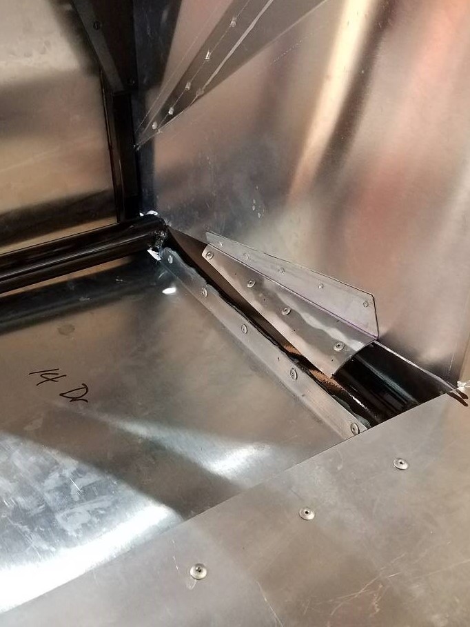

    I made a patch to stiffen the inside of the driver footbox
    Also patches for the upper trunk sides. Apparently this aluminum was included in earlier MK4 models (per other threads). They aren't the prettiest I have seen but I plan to lizard skin and carpet. The tape is just for a quick test fit. I will rivet them in place eventually.

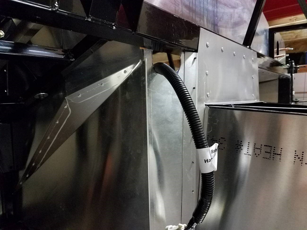

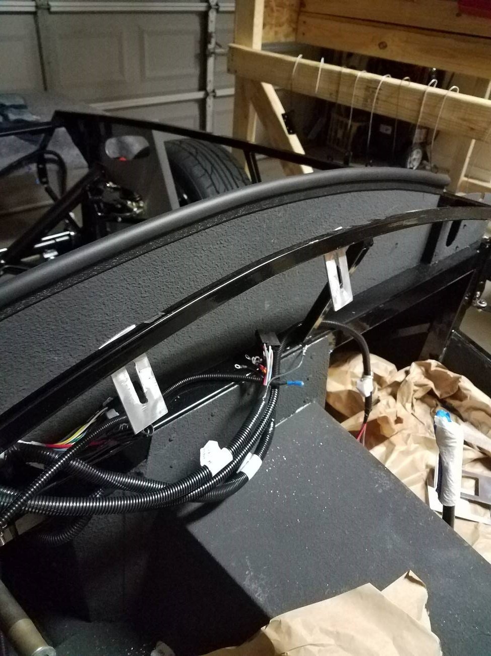

    Finally I cut a "notch" for the wiring on the inside of the driver's footbox. I think I made it a little too big so will have to work on something to fill this when all the wiring is complete.

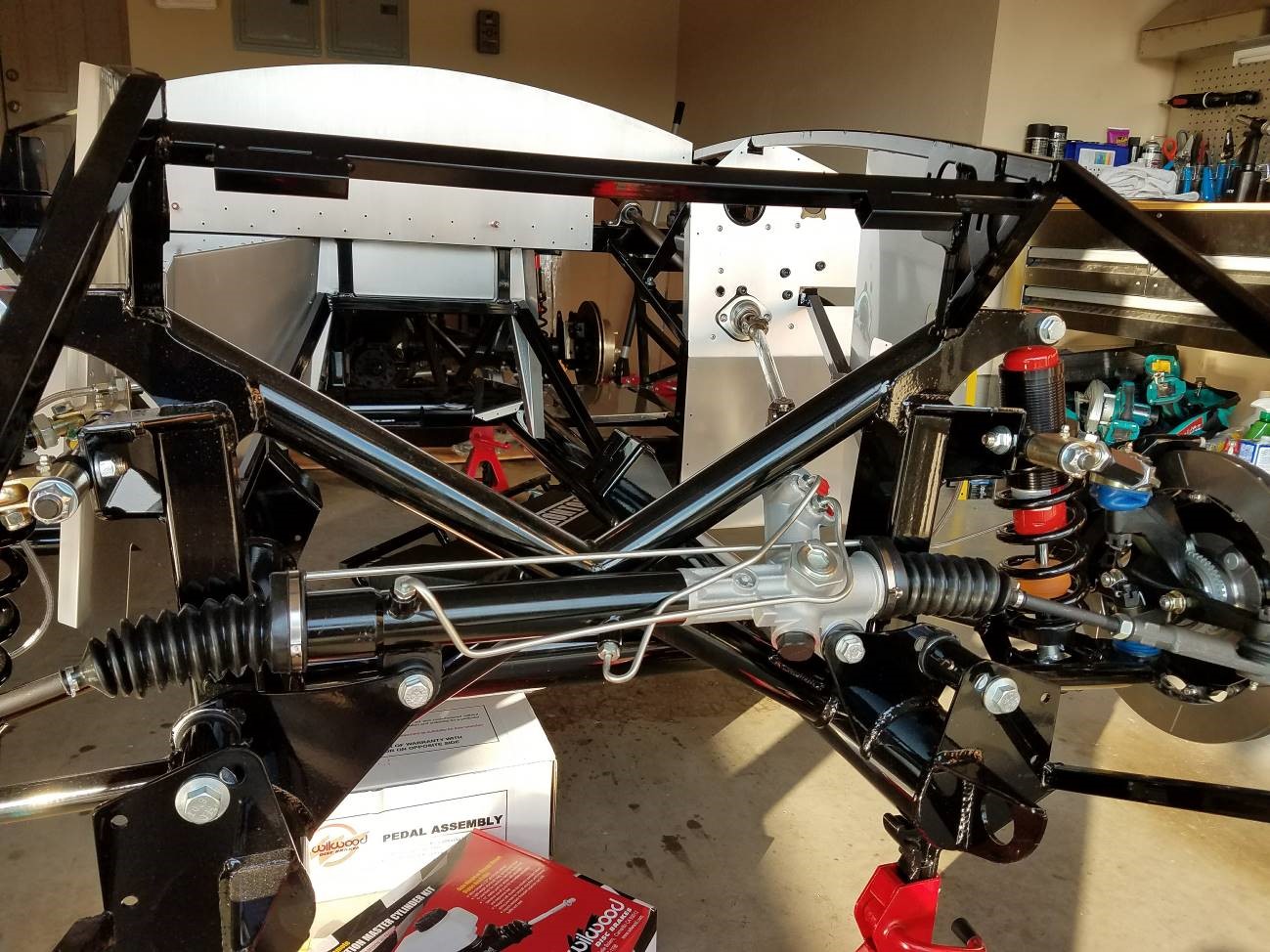

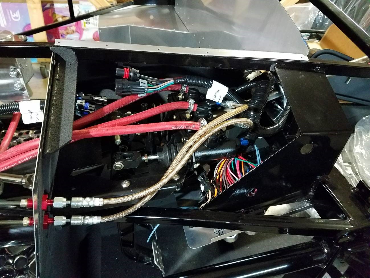

    I finished up the hard brake lines. This is my final mock up for the connection to the drivers side footbox. I decided to use bulkhead fittings (3/16 inverted flare to -3 an) to get through the footbox. I had them lower and they interfered with the clutch pedal. I had to redo them and ended up putting them here. Hopefully this works.

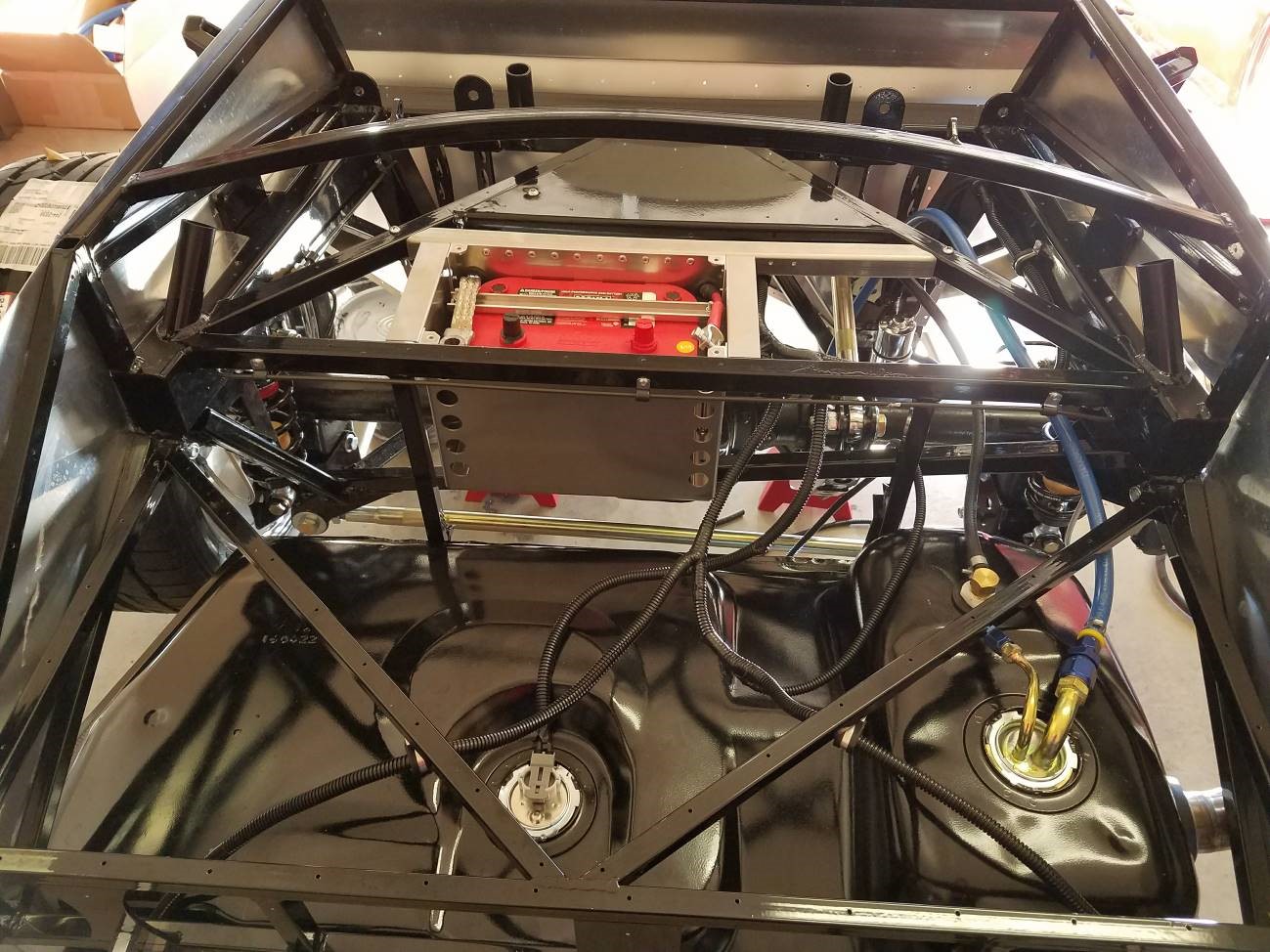

    It has been a couple of weeks since my last post. I am trying to keep things moving along. I have logged 118.5 hours so far.
    First a few small things. May not seem like much they represent new skills sets gained. I got the CNC remote reservoir mocked up. I built an aluminum bracket like others have done. I also tried to mimic the location as others have recommended so hopefully it works out. Let me know if ya'll (I am from Texas) think the location is incorrect and will interfere with the hood.

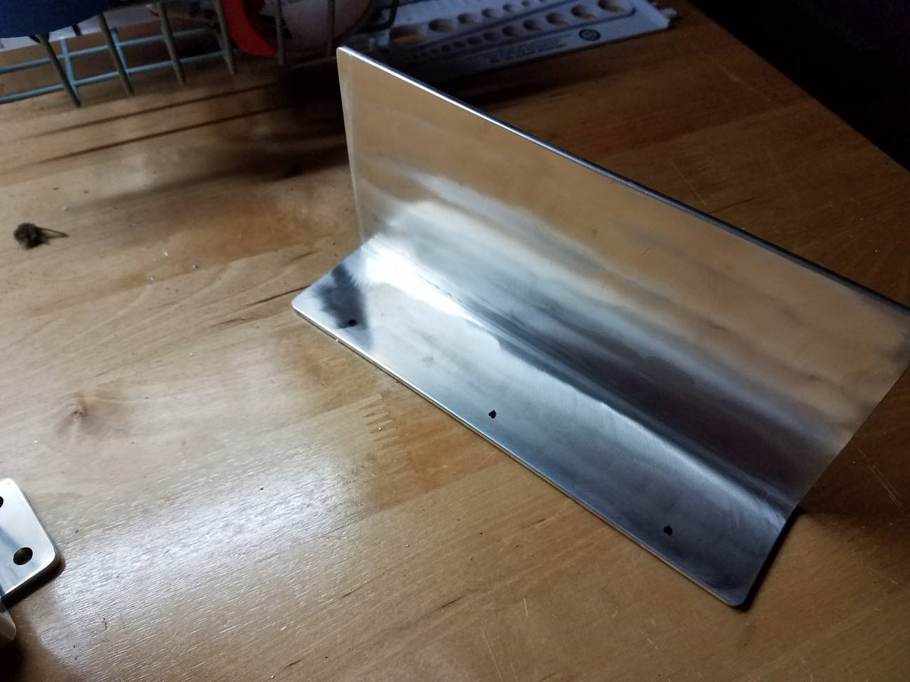

    The bracket was pretty simple to make. I used 2"x4" unequal length L. Was able to easily cut it with a jigsaw and then smoothed the edges with a sanding disc on my die grinder. I then "buffed" it with a scotch brite type conditioning pad with the same die grinder.

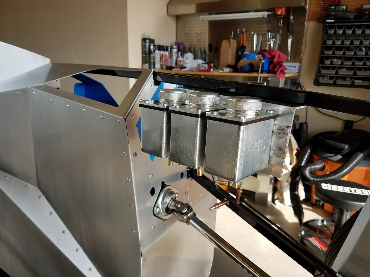

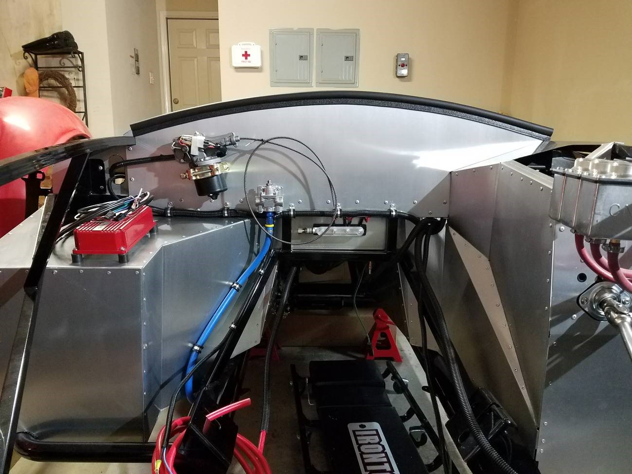

    I also mounted a FFMetal battery box. It went in very easily per the instructions. In the same picture you can see where I ran the rear harness and fuel lines before permanently mounting the trunk aluminum.

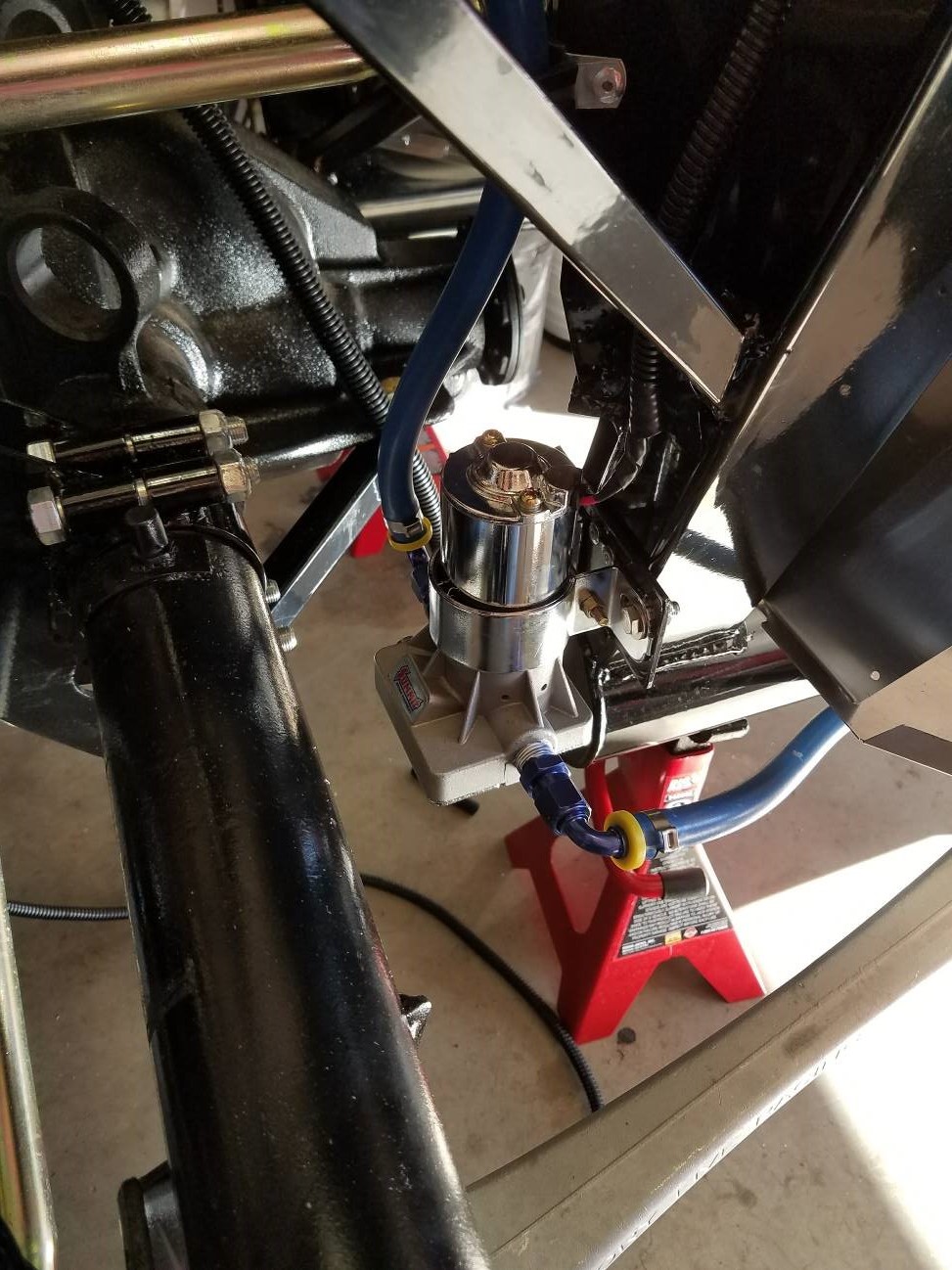

    Below is a picture of the fuel pump mounted at the back and just above the large round lower frame member on the passenger side. I had to make another small bracket for this as well. This time I used plain steel bar. I cut, smoothed and painted it as well. It is mounted with rivets to the frame. Five 3/16" rivets. I am not completely comfortable with that attachment and I think I might weld this bracket in place. I have been looking for an excuse to get a MIG welder and this might be the time to do so. Let me know if you think the rivets are enough or should I go ahead and weld this in place. Either way. I then simply bolted the fuel pump the bracket and ran the fuel lines. The pump and lines came for Levy Racing. Gordon was nice enough to go ahead and send the fuel system components so I could keep things moving.

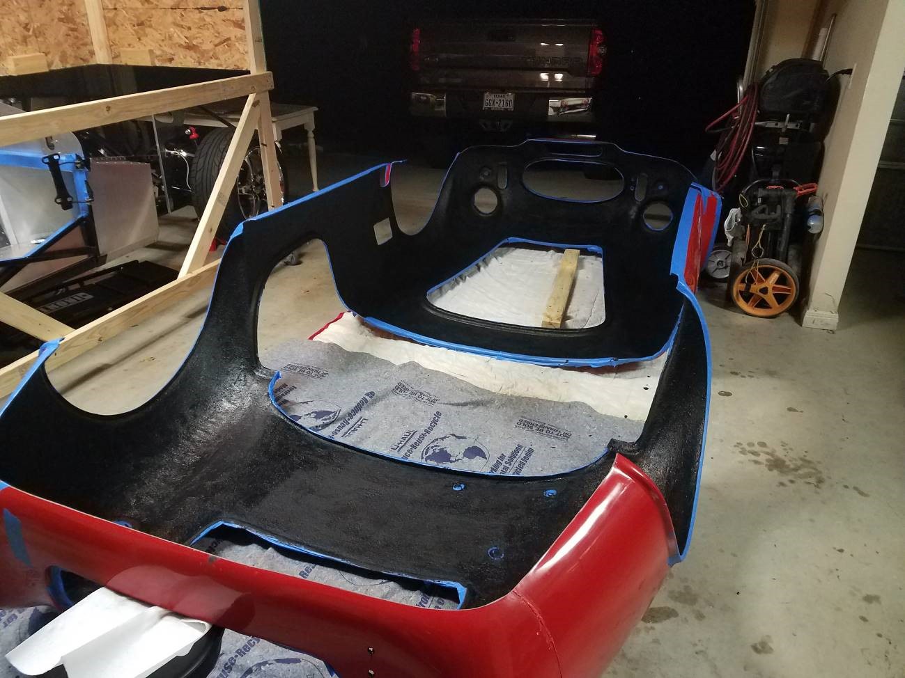

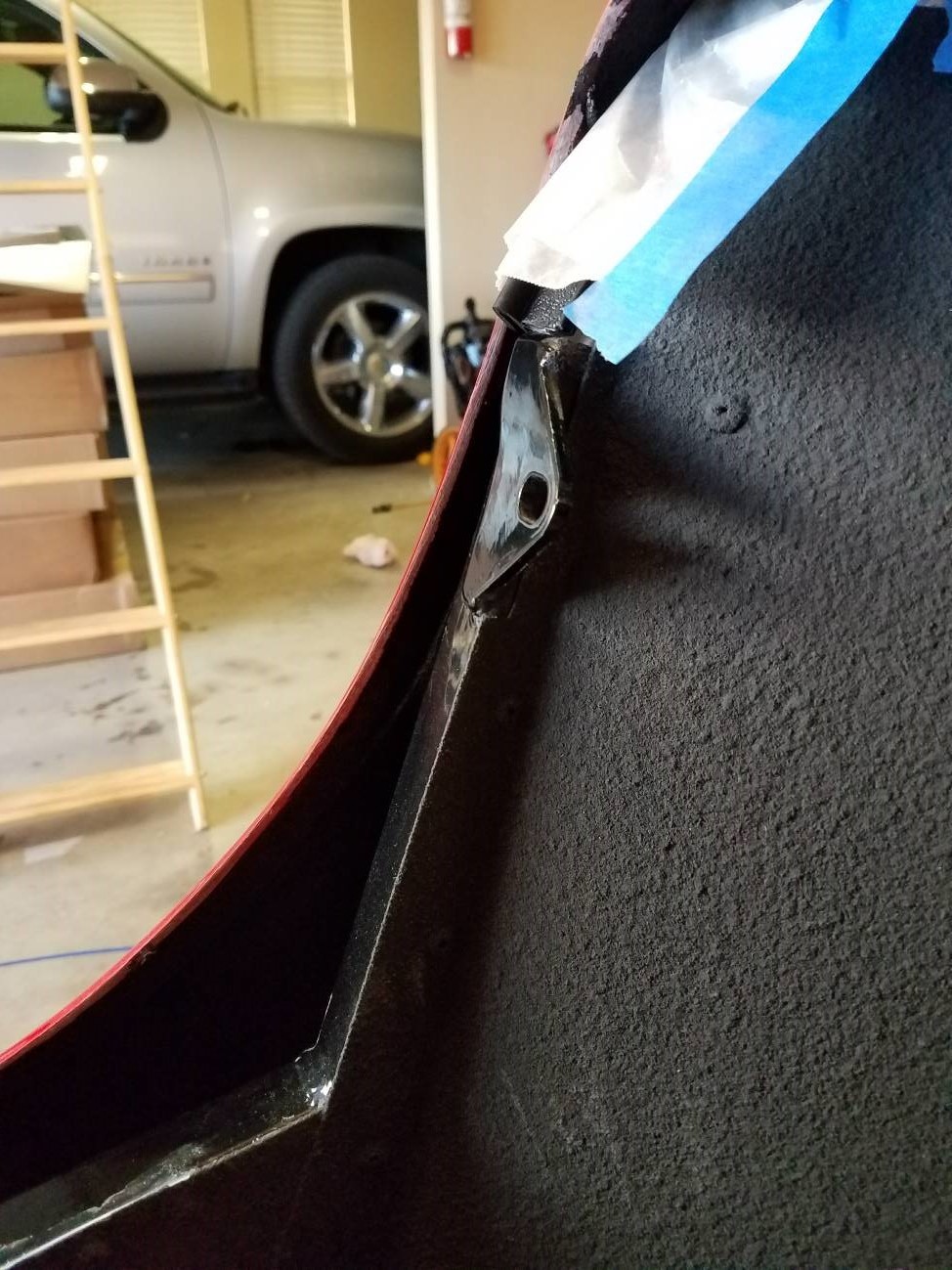

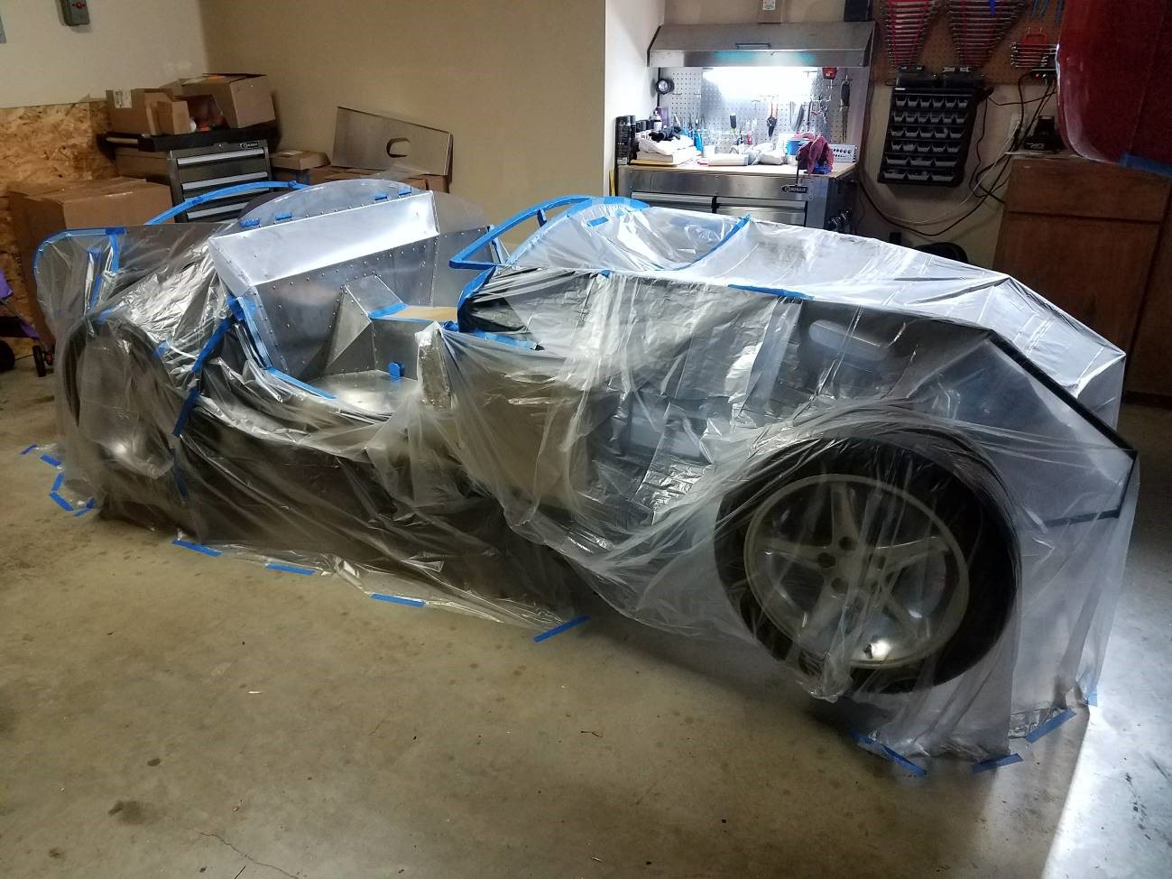

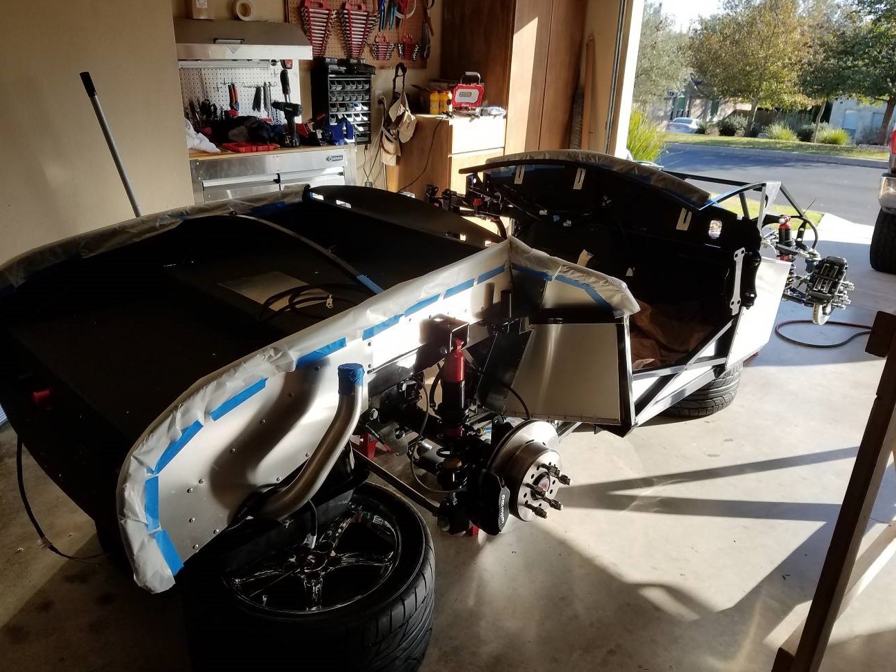

    Now to some bigger items. I got the undercoat applied to the body. I used the Duplicolor Bed Armour. It is water based, went on easy and really no big issues. I followed the steps used by others and thoroughly washed the underside, taped, and applied. One thing i found was it seemed easier to apply the Bed Armour with a brush instead of the applied roller. The roller was just to big and wouldn't fit the curves. I just used a brush and went to town. I slopped it on pretty quickly. I put two coats everywhere and a third on the wheel wells. I ended up with about a 1/4 of a gallon left. I am keeping that and might apply it to the splash gaurds.

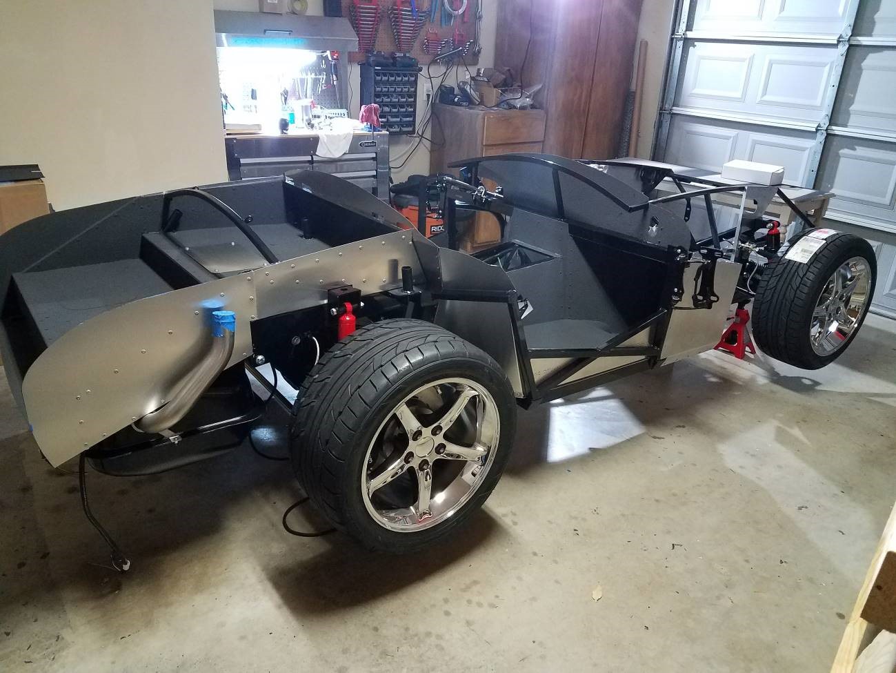

    Finally I have all the aluminum permanently mounted and have the car taped/prep'ed for Lizardskin. I am trying to follow the work of EdwardB. I am sure mine won't look as great but I will do my best. Here is a picture of the final tape job. One deviation from those that went before me. I decided to remove the pedal box before spraying. I made sure I could get it back and I think I am good to spray and then install the pedal box. That just seemed much easier than trying to tape the pedal box. After 8 hours,. I have seen enough blue tape for a while. Let me know if you think I have messed up. I probably won't get to spray the Lizardskin until the weekend of Dec 3rd so I have time to reinstall the pedal box if ya'll know something I don't.
    Well I have probably bored everyone enough for one post. Let me know if you see somewhere I have gone wrong. Thanks in advance and I hope everyone has a great Thanksgiving. I have alot to be thankful for: my family, my faith and my country. I am also thankful for the help this group generously gives to a newcomer with a lot of dumb questions. Thank You. God bless.

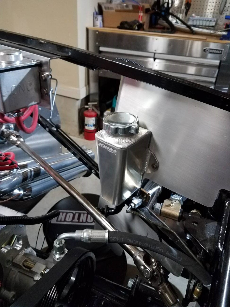

    Looking good!
    Your triple reservoir looks well below the top of the frame rail. That should not be a problem.

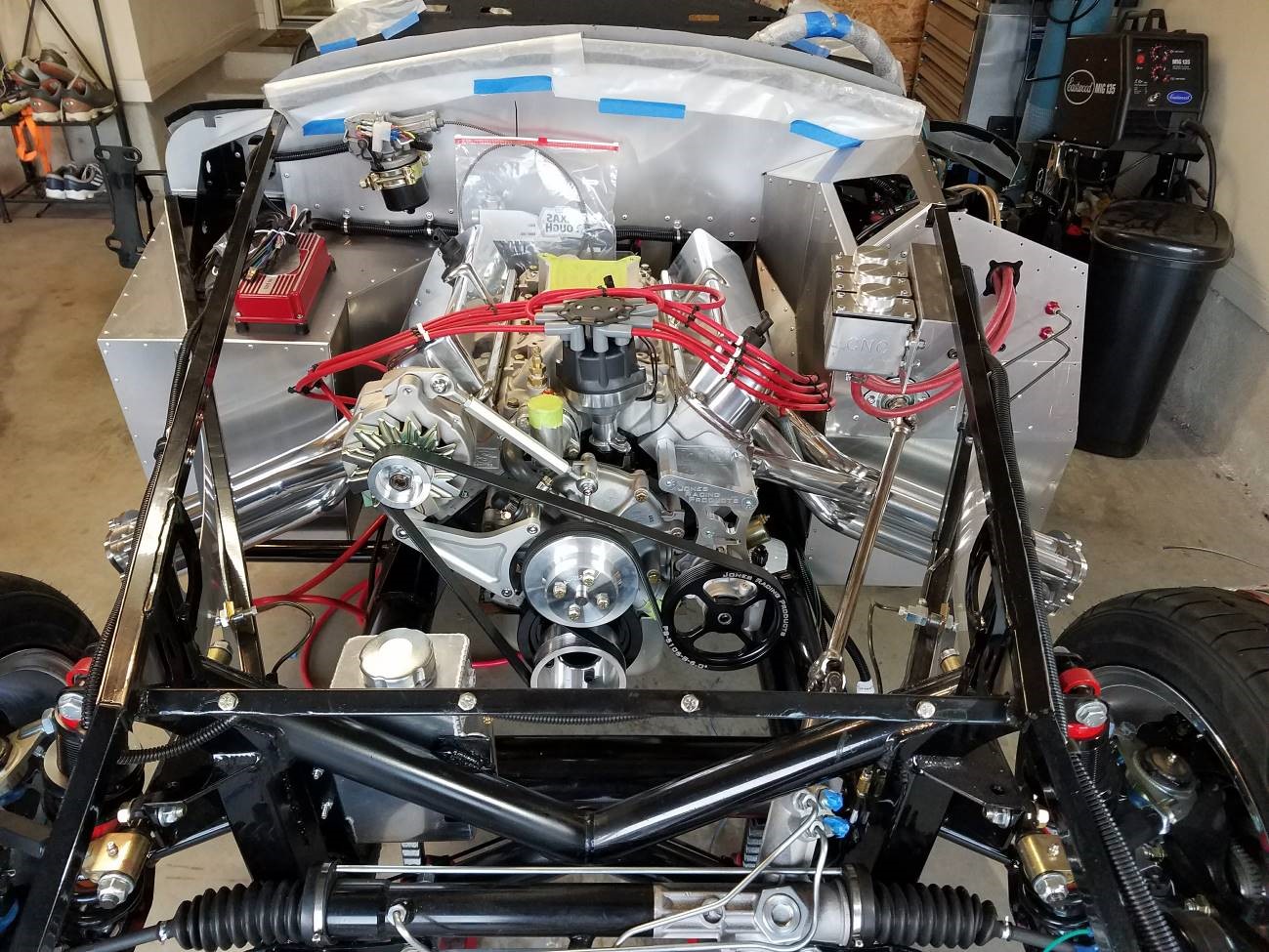

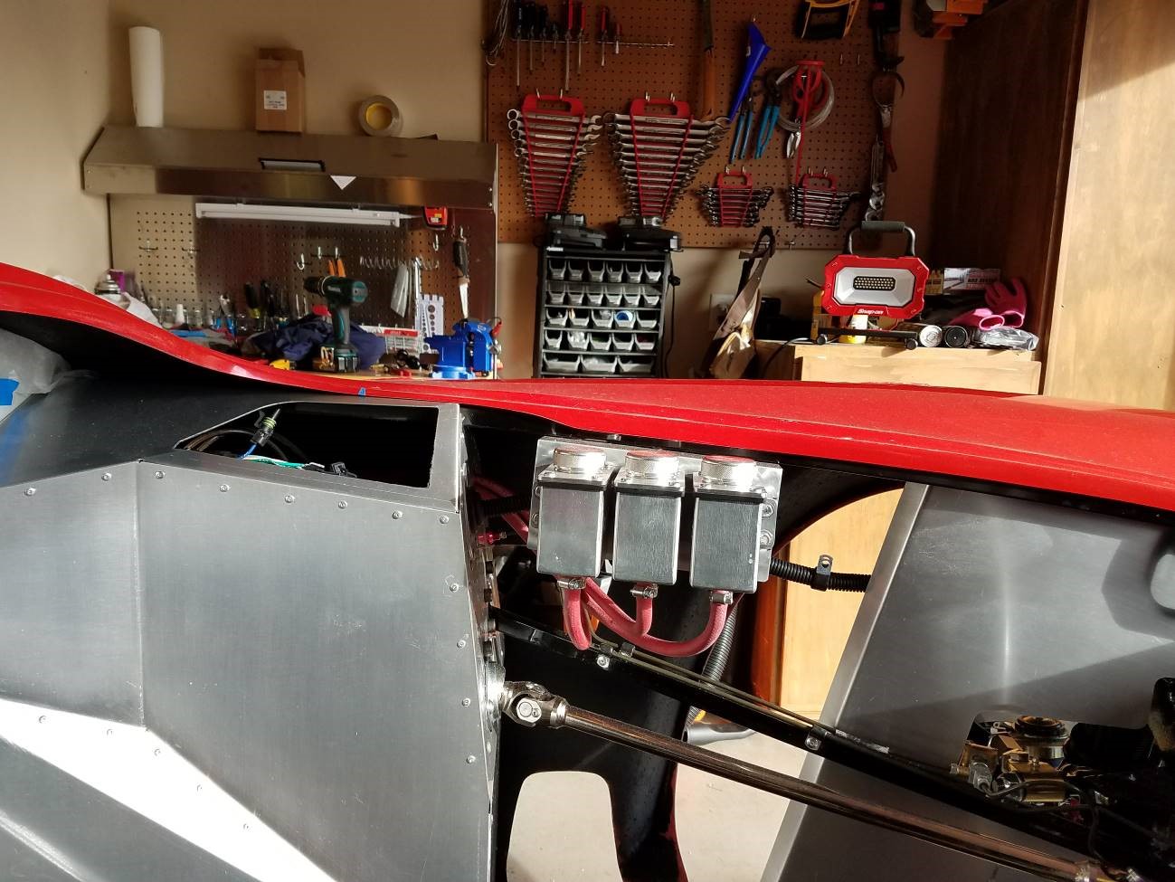

    Holidays were good and got some time to make steady progress on the build. I am eleven weeks in and I have logged 144 hours so far. I completed some major milestones and learned a lot. So here we go:
    1. Aluminum paneling is complete (except a few small pieces that must wait like splash guards). This allowed me to complete the insulation. I decided to use Lizard Skin. I essentially followed the instructions and the great write up Edwadb provided. It went pretty smooth and I turned out nice. That only advice and I can offer is to follow EdwardB's advice about applying two layers of tape around the edges. I did not (like a bone head) and it required extra work to remove the edge tape. Would have easier to remove while wet. Just a heads up.
    2. I got the steering rack centered. I won't try to explain what that means here. Others have done so very well and I would probably mess it up anyway. So, after doing some research, I decided to by the Breeze Offset Bushings. They worked great and I was able to get things centered perfectly. I have exactly the same dimensions on both sides from the inside of the frame rail to the outside of the rod ed/ball joint on the rack at lock on both sides. While I was doing this work I decided to tackle the steering wheel alignment. It appears that most end up with the steering wheel not even close to aligned with the steering centered. I was off a little less than 90 degrees. I was expecting to have the file a spot for the set screw on the spline coming out of the rack. To my surprise, the spline sticking out of the power steering rack was completely round (no flat spot) and had a "channel" all the way around the circumference for the set screw (between two sets of splines). At least the set screw matched up there perfectly. This allowed me to simply orient the steering wheel any way I wanted. Seemed different than what I had read on these forums. I bought the upgraded power steering rack from Factory Five. It was an option when I placed my order. Sorry I didn't get a picture of the spline section while it was off.
    3. Got the brakes bled. I followed the directions of others. Bench bled, pressure bled (using CNC pressure cap), and then peddle bled with a helper. I had to do the peddle bleeding process with a helper because I had a little air somewhere following the first two. I think I didn't do a good bench bleed and had some air left in the master cylinder. Anyway, no big deal and I got that knocked out the help of my beautiful assistant (my wife). She did great. Didn't let the peddle up unexpectedly, complain, etc. I might let her drive it when we are done......under supervision of course.

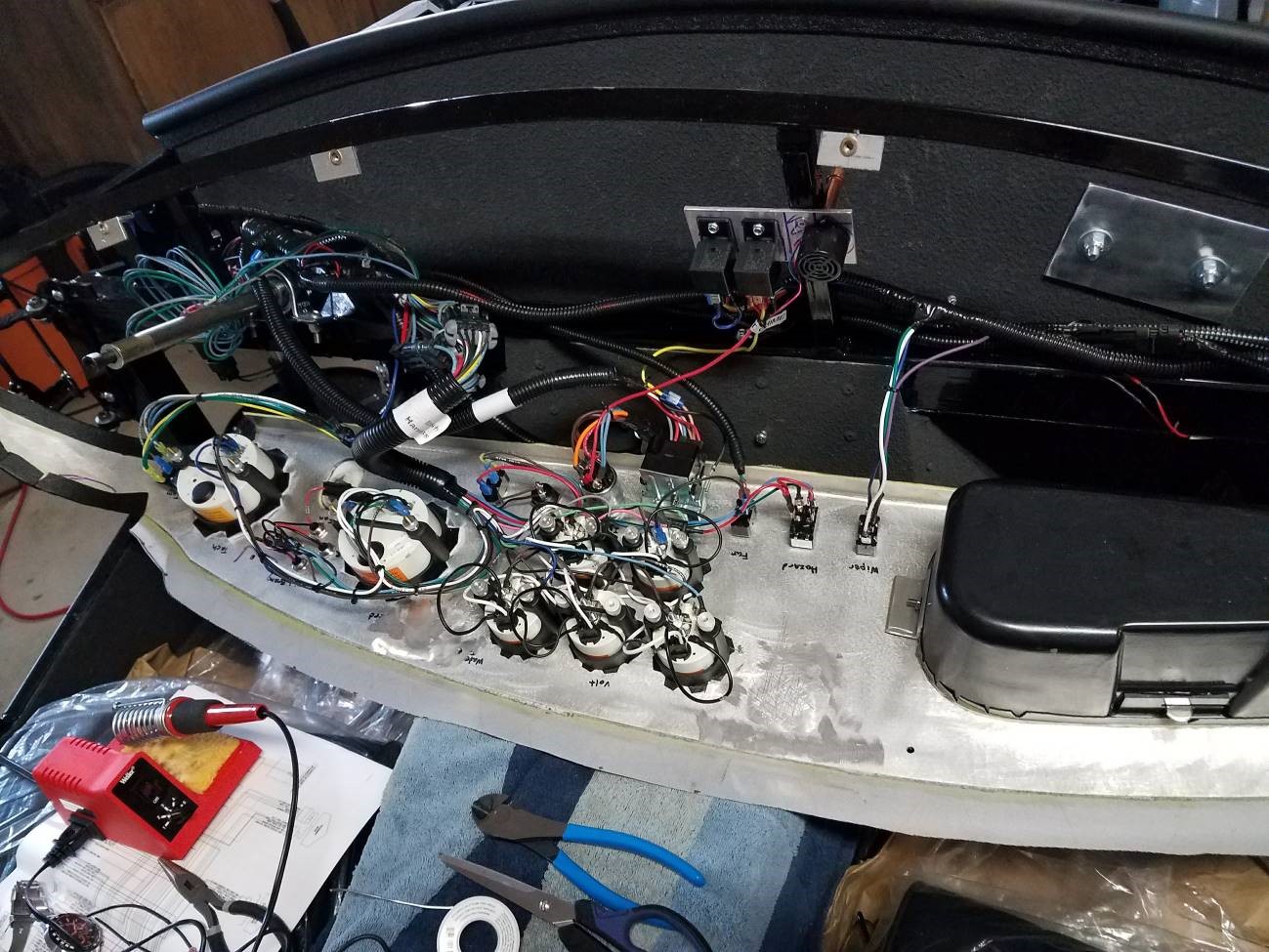

    4. Started electrical. I got the fuse panel installed, which filled the peddle box up pretty quick. Wow, that's a lot wiring.
    A couple of things occurred to me. One, I need to go ahead and hook up the clutch safety switch. I went ahead and ordered the Painless switch this week. I ordered the one recommend in a number of places on this site and looks alot like the brake light switch already in place. Two, you should mark the holes for the inertia switch, start the self tapping screws with the switch out of the way, and then mount the switch. If you try to do this all at once, you can break a tab off the inertia switch. Ask me how I know. I am such a knuckle head. Anyway, I had to find a replacement. I first called Ron Francis. They recommended a part number SW 4177. This appears to be an ACDelco part and din't look exactly the same. I ended up getting a Carquest part number S9300. I found it at Advanced Auto Parts locally for about $35. It looks exactly like the original and even fit the plug in on the harness.

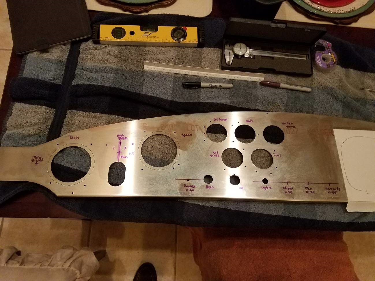

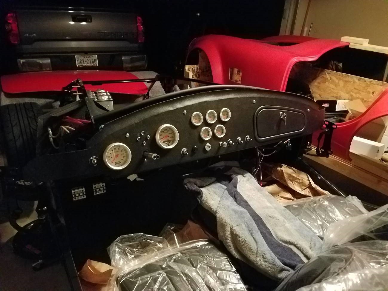

    5. I started mocking up the dash. Below is pic of the set up. I followed the advice of the site experts and then made final tweaks with it on the car before drilling. I have since put on the vinyl and some of the guages/switches. I will show the final product later. I have labels coming from Carolina Laser to give it a more finished looked.
    Well that is probably enough for now. I am moving along and looking forward to engine install. I hope that can happen around Christmas. I am getting a 347 from Gordon Levy. I will give him a call in the next few weeks to check in. I haven't harassed him in a few weeks anyway, so he is due. Just kidding Gordon. He has been super helpful.

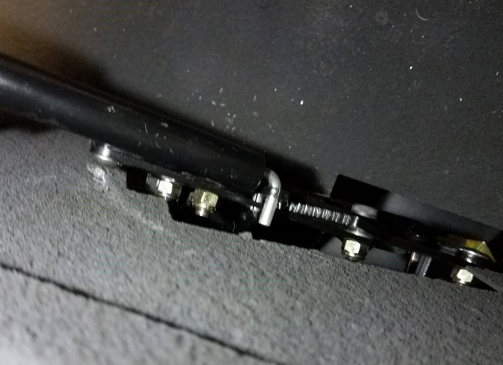

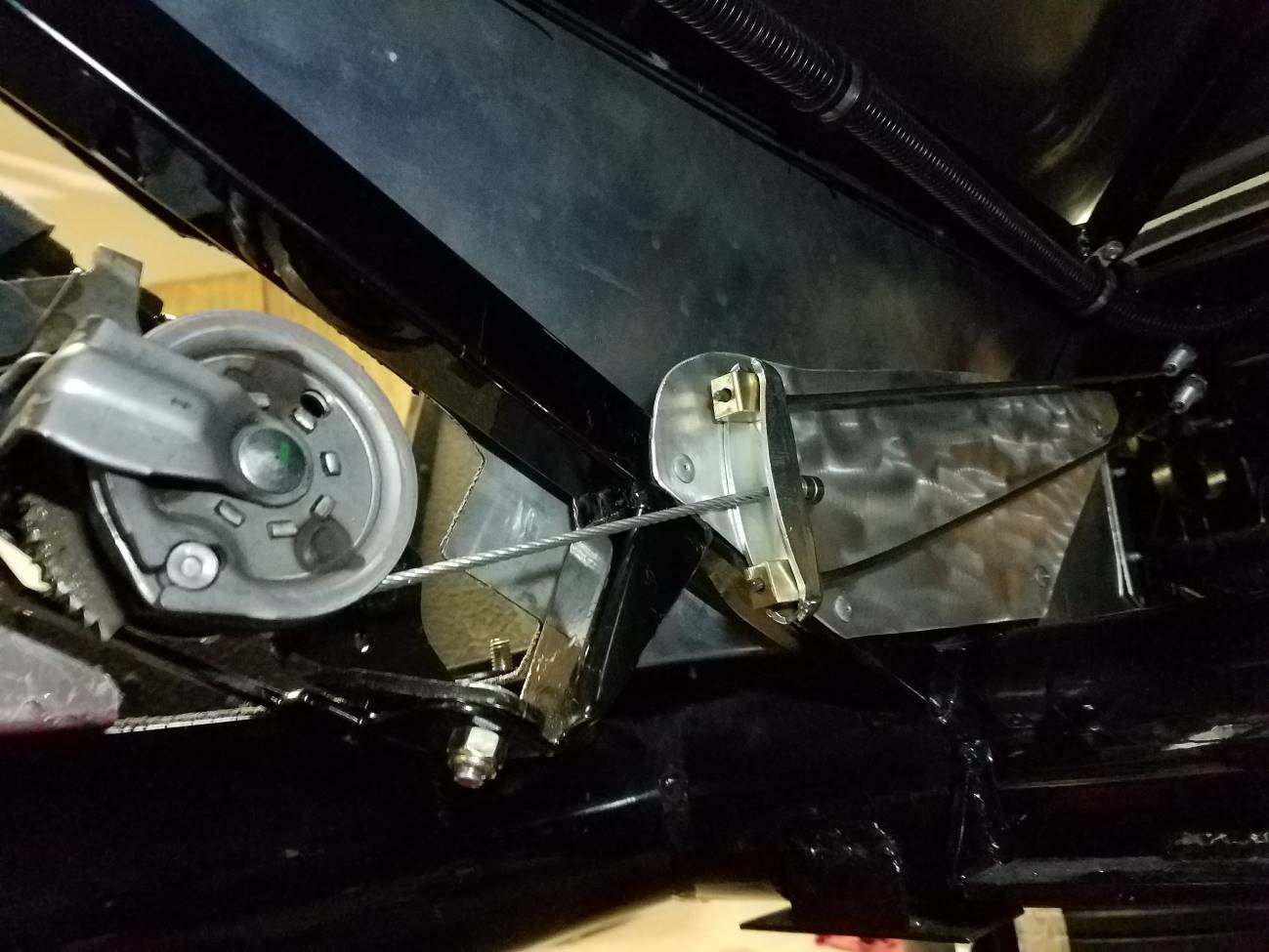

    Following that fine bit of craftsmanship, cutting the Lokar cables to fit my application was simple. I just followed the instructions and used a dremel tool with a cut off wheel. I routed the cables up the rear frame, secured everything with insulated brake line clamps, and adjusted the rear drum brake pads. I have not worked on rear drum brakes much. Actually never. It took me a bit of searching and quick note from Gordon Levy and I got it figured out. Pretty simple really. Inside the drum (on inside bottom) is a gear type apparatus on an adjusting link. I had to remove a small rubber plugs to get access. This allowed me to tighten the brake pads as needed against the drum. I set them to have just a little contact. My parking brake cable could then be set. This allowed everything to get tight after about three to four clicks on the parking brake handle and have plenty of adjustment.

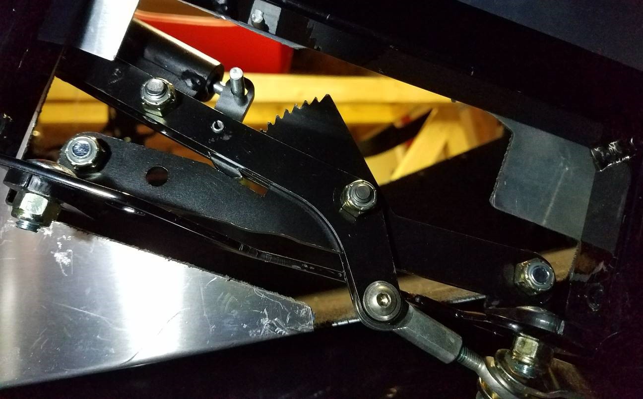

    I first installed the FFR parking brake handle per the instructions. The front mounting tab on the handle goes under the mounting bracket on the frame. This caused the bolts on the handle to contact the transmission tunnel. You can see where the bolt was rubbing in the picture below.
    As you can see, I flipped the bolt on the handle around and that helped a little but didn't solve the problem completely. I then did a search on the forums and found where a couple of folks had actually installed the handle a little differently than the instructions from FFR. I decided to try this and sure enough it made a big difference. It is hard to describe but essentially I flipped the front mounting tab over and remounted. Here is a picture. It is not the best but if you compare it to the build manual you will see the difference.
    Hopefully all of this makes sense and can help others. I will post Part 2 separately.

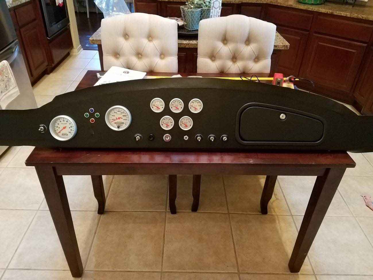

    Part 2 is the dash.

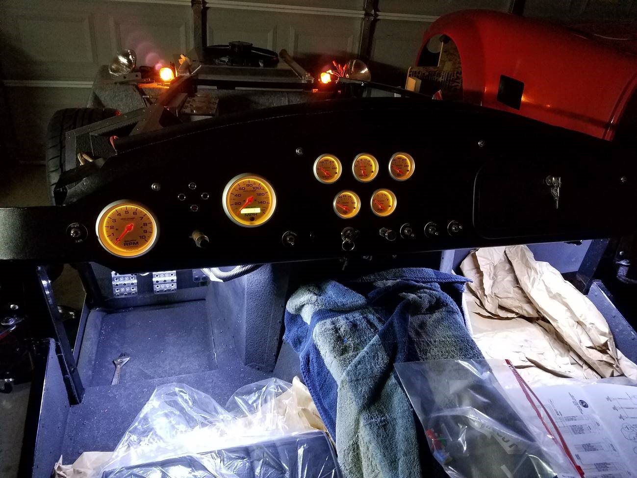

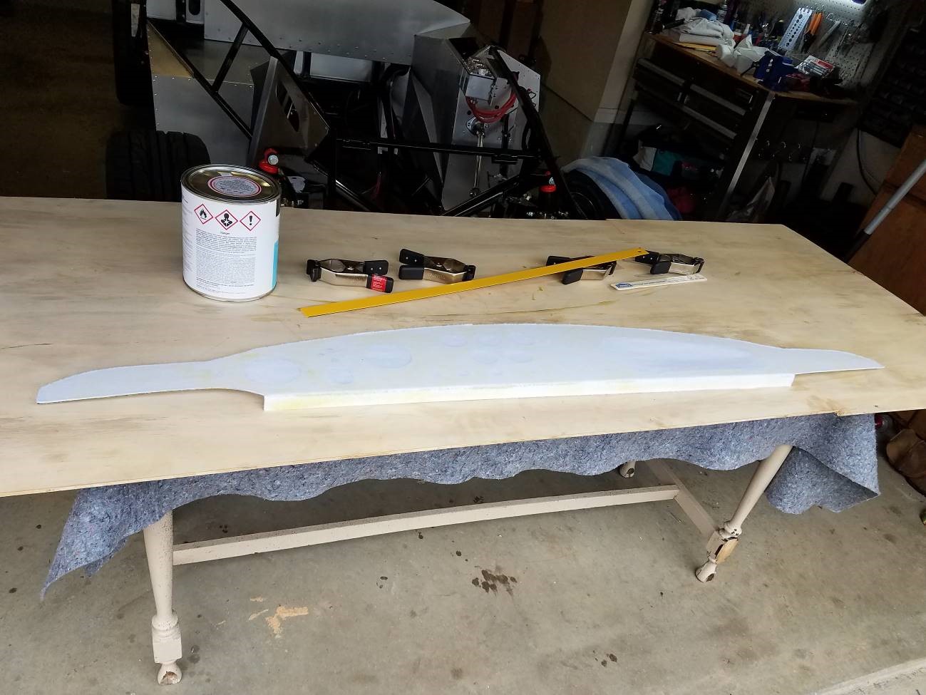

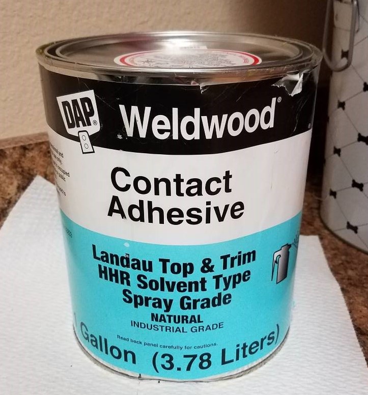

    Well this was a bit of an adventure. I first glued on the FFR "puffy" vinyl with the recommended 3M 77 per the instructions. I did not do a lot of aluminum prep before this step. I simply cleaned the aluminum with acetone and glued the vinyl down. It held ok and I started mounting the gauges and switches. I discovered three things that most probably know but might help others:

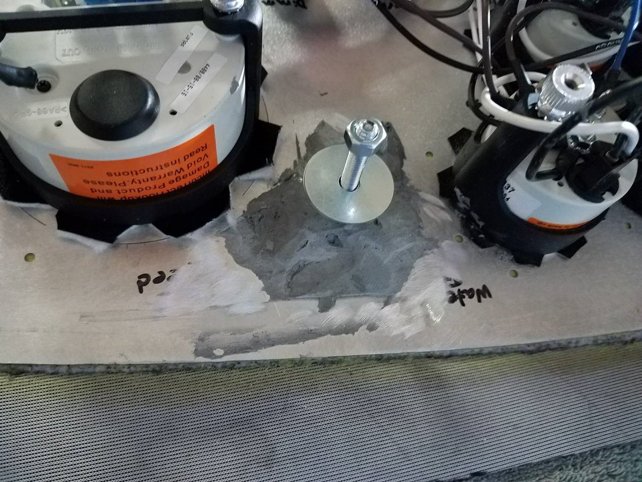

    1. The puffy dash makes it difficult to attach the FFR supplied switches. The threads on the toggle switch, headlights, ignition, and wipers are all really to short to accomodate the puffy vinyl. I could get all of them attached but not much thread was available and I just wasn't comfortable with that set up
    2. Some of the Autometer gauges fit into the precut dash holes well without any dash material sticking through the back. Others did not and needed a little dash material sticking through. I discovered this after cutting all vinyl at the gauges holes even with the dash. This caused a few of the gauges to have some wiggle room that I didn't like. I was also concerned with the very little bit of vinyl held under the gauges.

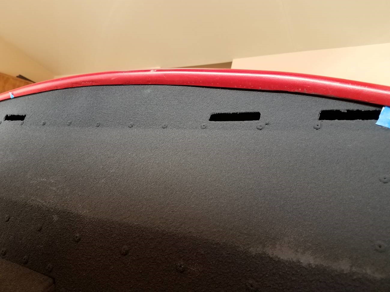

    3. The 3M 77 glue stuck ok but had a hard time keeping the edges wrapped around the back and bottom. A few of the pie cuts on the back let go after my first mock up.
    With these learning's and the fact that I didn't like the puffy look, I decided I needed to redo this portion. After a few hours of forum research I decided on the following setup. I am using marine grade vinyl and premium felt from Joann Fabric. I think the vinyl was $19.99 per yard and the felt was $3.99 per yard. The vinyl was based on recommendations here. The premium felt is what would be used on pool tables and is polyester (per the helpful ladies at Joann). With 80" of both and coupons I found online, I got the material for a little over $40. I also ordered some Welwood Landau Top and Trim HHR Contact Cement. Here is a picture of the 1 gallon container.
    Removing the glue and FFR vinyl was not fun but certainly doable. I used lacquer thinner, GooGone, and elbow grease. I also decided to do a little more prep this time to the aluminum. I sanded the entire front of the dash and the edges on the back with 120 grit on a DA sander. I then cleaning Sharkhide and it worked so well I thought I would give it a try here as well. After drying, I applied the Welwood HHR contact cement with a cheap paint brush. I applied two coats on the felt and one good thick coat on the aluminum dash. I let it dry for 10-15 min per the instructions and then stuck the two together. The bound was instant and very firm. I placed the dash felt down and set a bunch of heavy items on the dash. I let is set up for 24 hours. I tested the bond on the passenger side edge and it was very strong. Of course the felt started to tear and I stopped. I then trimmed the felt flush with the aluninum edge and left the felt over the holes and glove box in place. I thought I would wait and see how everything would fit and trim the felt out of the holes as needed.
    Just a word of advice. This HHR contact cement puts off some pretty strong fumes. I did not wear a respirator (wich I would recommend) and had to stop once of twice for some fresh air. I had the garage door open and a fan going which wasn't really enough. Certainly don't apply this stuff in doors or without ventilation.
    The next day I used the Welwood HHR contact cement again to bound the marine grade vinyl. This time I applied two coats on both the felt and the back of the vinyl with a paint brush. Man that adhesive has a strong odor. I spent a little too long in the garage because I was a little loopy by the time I was done. After the 10-15 minute wait I got the two bonded and let it sit overnight. Again the bond was very strong. I tested the strength again and I was not able to pull the vinyl from the felt. Only time and the Texas heat will tell but so far this install is much stronger than the 3M spray adhesive I used before.
    This install also has a little higher quality look. Well, not as high quality as leather but better than the puffy look. The vinyl looks about the same as the FFR material but the thinner felt certainly improves the look. For reference the felt I bought is a little over a 1/16th of an inch while the FFR backing is about 3/16th.
    When installing the glove box and gauges, I made sure I tucked the pie shaped cuts through the hole like most others have done. I think this will ensure the vinyl is retained behind these devices and resolve my concern. I cut the vinyl and felt flush with the holes on the switches and lights. The thinner backing allowed for the better fitment of the indicator lights and switches.

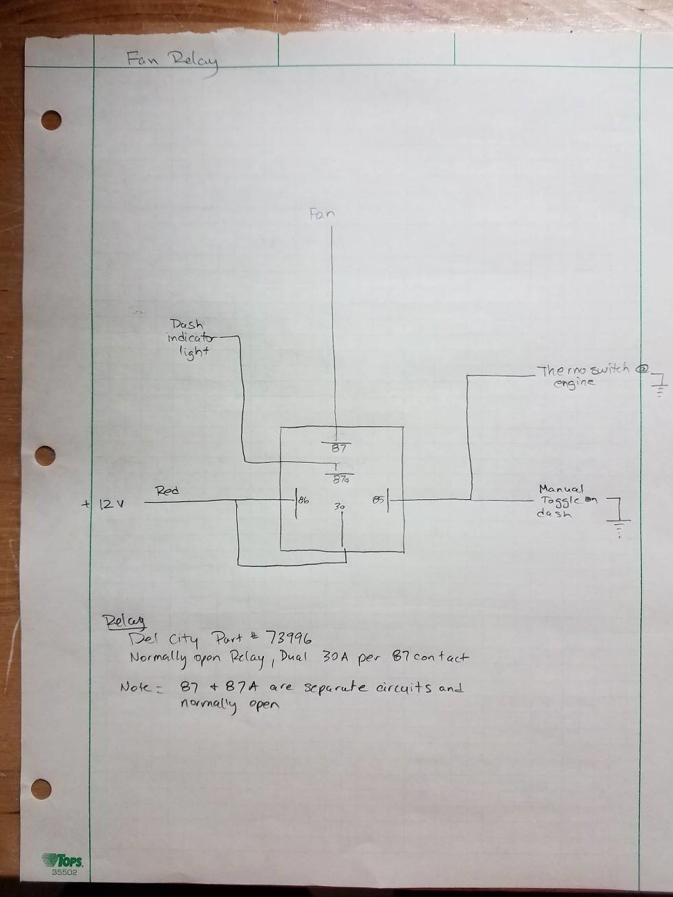

    Wiper - SPDT on-off-on (part # 7200044) - I am using a relay per the directions from others on this site

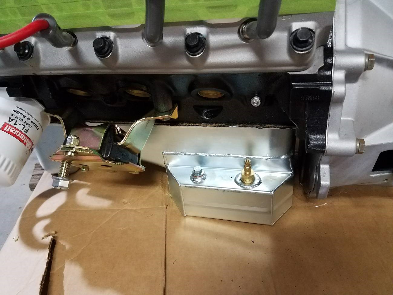

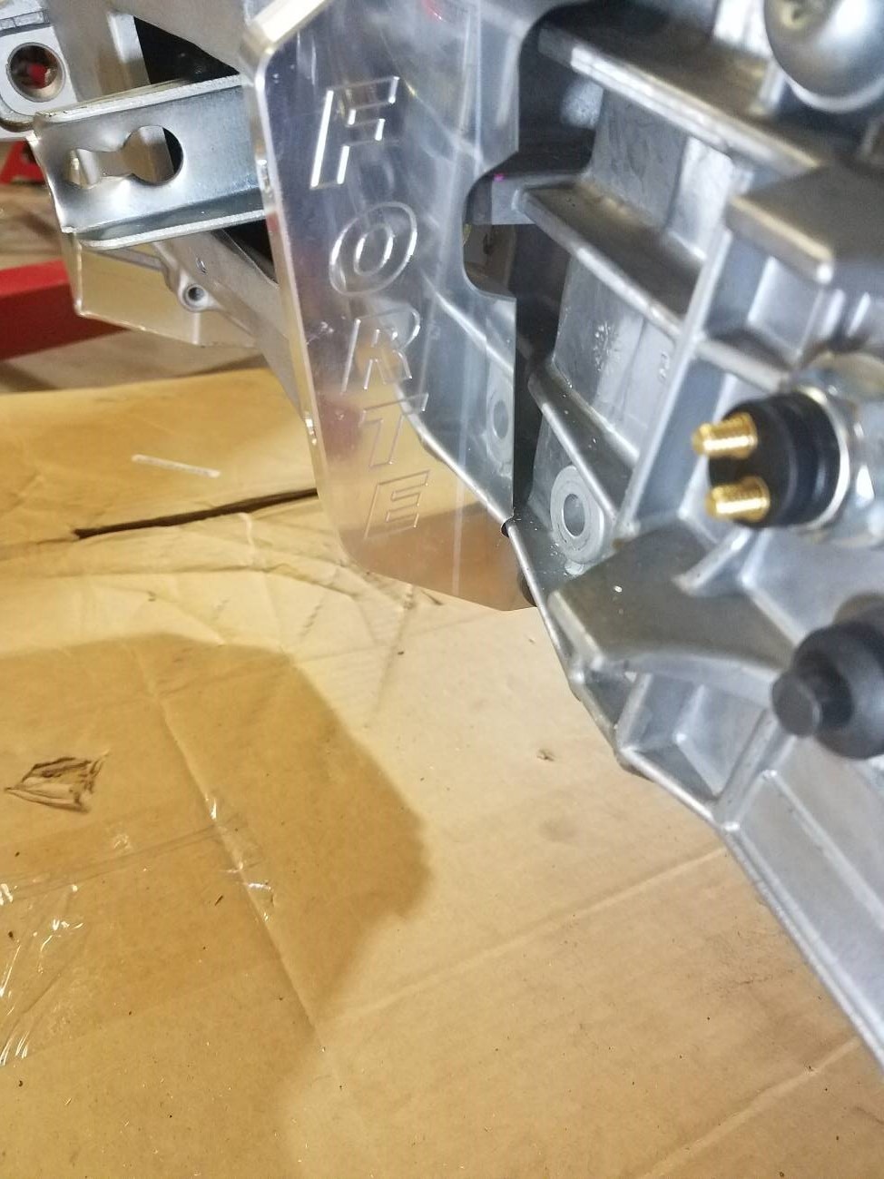

    I plan to continue with the electrical. My motor and transmission should be here in early January. I plan to wrap up a few more items by then and be ready to install the power train when it arrives.

    196 hours so far. I didn't get much done with the holidays and travel but did wrap up one issue that has been nagging me. I like the adjustable/removable dash discussed by many on these forums. Of course I decided this after the vinyl application. So the installs like by Jeff K and Edwardb wouldn't really work. I had to find a way to attach bolts to the dash from behind. I tried a number of different products before finding something that worked really well. My idea for the adjustable dash was really stolen from Jeff K. I made brackets similar to his out of aluminum, more detail to follow. I then used a two part epoxy to attach bolts to the back of the dash aluminum. So here was the process.
    I first wanted to test and find the best product. I first started with JB Weld and Loctite products from Home Depot. The JB Weld was called Steelstix. The loctite product was metal/concrete epoxy. I applied both to a bolt and try attaching them to a scrap piece of aluminum. After a 24 hour cure, the JB Weld held the best but I could pull the bolt off relatively easy. The weak point wasn't the JB Weld of the Loctite, it was the bond to the aluminum. I then repeated this test but with better surface prep. I sanded the scrap aluminum with 36 grit sandpaper, cleaned with acetone, roughed up even further with a rasp, and then cleaned again with acetone. This time the JB Weld bond to the aluminum was much improved. It took a 50 pound weight to break the bolt off and this time the actual epoxy failed. The loctite was another failure so it was eliminated. If i used three brackets to support the dash, then 50 pounds would probably work but I wanted something I knew would hold up to vibrations over the long haul. I found a source for a product called Belzona. It is an industrial two part epoxy made for metal repair. I have used this in my work to repair a number of metal tanks, pipes, etc in a chemical plant. This stuff is amazing. Anyway, I got a few small packages and decided to use it.
    I did the same prep on the back of the aluminum dash. I had about 3 minutes before the product started firming up and became unworkable. Not a real issue but I had to work fast. Once this product dried it can be "tooled". I had to grind it quite a bit with 36 grit to smooth it down. I didn't do a great job of smoothing because it was taking to long and no one will ever see it (except you guys and me ). This stuff is hard.
    Note on the hardware. To increase the surface area for the bond, I used 1/4 x 2" elevator bolts from McMaster Carr item #92670A750. I then used two nuts and two fender washers to sandwich the bracket.
    I made the brackets from a piece of aluminum stock I had left over. I cut them 4" long by 2 1/2" wide and made a slot for the dash attachment. I used rivets to attach them to the back of the 3/4" hoop. Here is a pic without the dash.
    I think this will work well. I will let everyone know if I have issues once I start driving.
    The remainder of the week was mainly electrical: battery cable, cut off switch, remote battery terminals, bus terminal ,etc. I will post some picture and details for those later.
    That should all for now. As always, let me know if you see any major errors or issues.

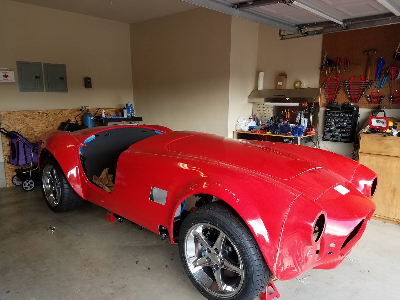

    Big day
    Well as 2016 comes to an end I got a big step completed today. I put the body back on for the first time since delivery. I took a brake for wiring and decided to do a test fit. I plan to use this test fitting to get the information I needed to do some minor aluminum panel trimming, body trimming, and verifying locations for items in the engine bay. It went on pretty easy and seems to be pretty close all around. Before I go crazy and start trimming items, I wanted to get some expert eyes on the current location. Here is what I did with the test fit:
    1. Put bulb seal on the front firewall, trunk sides, and rear cockpit panels outside of each door frame. I left the bulb seal off the lower trunk panel that runs horizontal along the bottom. I thought it would be easier to get the body off and on without it.
    2. I did not have the dash installed.
    3. Got it set pretty close to what I think is correct. I did not install the quick jacks. I did verify the holes line up pretty well left to right. The front of course will have to be raised to get the holes to line of vertically
    4. Really no contact with the body other than the bulb seal and bottom edge of the body as it wraps under the frame.
    5. I went a head and dewaxed/degreased the body with a Duplicolor product I got from Oreilly's.
    So here are some pics
    Bulb seal on and covered with wax paper for protection.
    Body is on
    Checking the placement of the remote reservior
    Picture of the gap for the dash. This is about a 1/4" except on the passenger side. I will smooth this out and make it all the same distance for the hoop.
    The rear cockpit is really tight. The rolled edge is almost touching. I think I need some room for the carpet.
    Jeff K and other experts seem to reference the body in relationship to the door latch. Here is what I have. Seems pretty close to what I have seen.
    A few questions:
    1. Does the body look like it is close to the right position front to back?
    2. I would like a little more room to fine tune the location. Currently the body is tight against the bulb seal on the back of the trunk sides. I think cutting 1/4 to 3/8" off those two panels would give me that. I see others have done this. Does it make sense in my case?
    3. If I do move the body forward a little, I will need to trim the front lip for the dash a little more than planned. If I leave it where it is I will of course need to trim a little off the rear rolled edge. I was considering cutting a little off of both. Does that sound ok?
    4. I was going to smooth and straighten out the rolled edges on the cockpit front and back. Is there any reason to wait until just before final body install?
    5. I was going to knock down the seams and cut back the wheel well edges. Any reason not to do this while I and doing this other work?

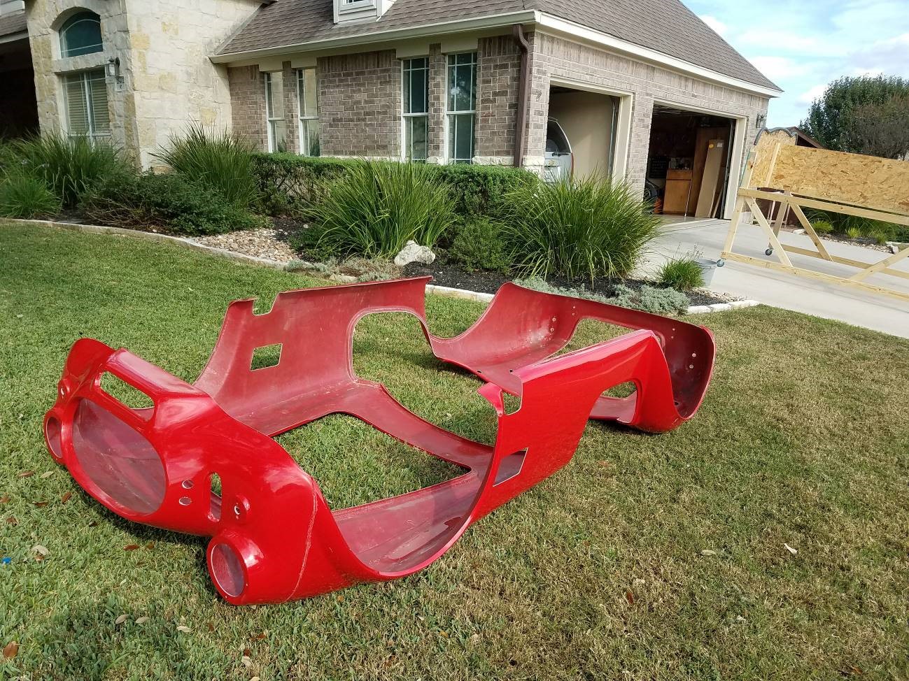

    Body work

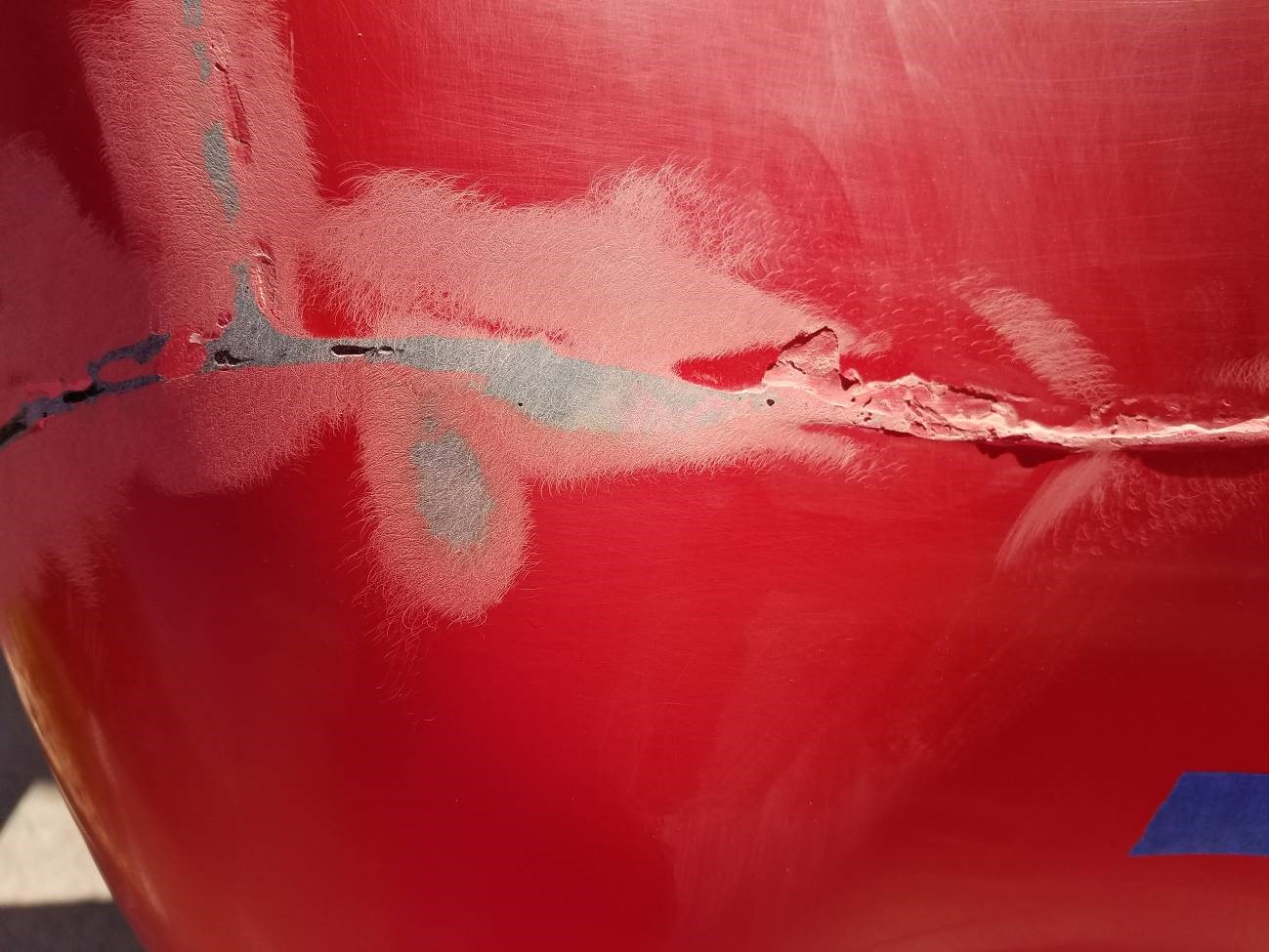

    I posted this question and build progress on the other forum. I wanted to log it here to capture my build progress and maybe catch some that don't frequent both forums.
    So I decided to take a stab at cleaning up the body on my MK4. I am considering tackling the bodywork myself but haven't fully committed. I have read through most of the threads about body work (STL-Scott, JeffK, Jeff Miller) and they give me hope that I could do this. With my new found optimism, I cleaned the body per instructions of the experts. I then attempted to gingerly remove a little of the parting line on the back driver side fender as well as cut away some of the wheel well opening on the back passenger side. I thought this would give me a little more confidence and find out if this is something i can handle.
    I used a DA sander with 80 grit on the parting line and stopped because of what I was seeing. I want to make sure what I am seeing is normal and I am not overdoing anything.
    I have attached two pictures. One of of the parting line I attempted to smooth down. I saw quite a few voids. I know some had mentioned this but my body appeared to have quite a few. A number of areas also had "soft" gel coat. I assume it was just uncured.
    The second picture is of the wheel well. This really got me concerned. I used a die grinder with 80 grit disc to cut back some of the lip. When I did I found quite a large number of voids. I only sanded back about 12-16" of the radius and they were pretty consistent. The gel coat easily flaked away above the voids.
    What do you guys think?
    1. m I removing the right about of material on the parting lines?
    2. Are the voids and soft material in the parting line ok?
    3. Are the wheel well voids an issue?
    Thanks in advance. I know this body work topic is discussed alot so sorry for the rehash. This is the area of the build I have the least confidence but am the most interested in. I was actually excited to do this part. This is one of the reason I decided to go an head and see what it was like today. Just a little nerve racking.

    Week #16
    Still plugging along. A little over 230 hours into the build since I started. Wiring really takes longer than you think. I have been trying to solder all connections (other than terminations on switches. That adds quite a bit of time but I think it should provide a more reliable system in the end.
    Well, after mounting the body a was able to fit the dash and get it close to where I wanted on the hoop. To make a long story short, the Belzona application I mentioned in my earlier post did not hold up. One of the posts I installed came off the aluminum dash. The Belzona was hard and remained firmly connected to the elevator bolt. It just simply did not hold on the aluminum. I roughed up the aluminum pretty good before application but my surface prep technique must be lacking. Anyway, I decided to go with a slightly different fastening technique and will still provide a removable dash. I saw a few threads on the forums where button head bolts were used along with finish washers. I did something similar. I made four brackets out of 3/4" angle and attached them to the hoop (two 3/16" rivets). I then placed a #10-32 rivnut into the brackets facing the dash. I then used 10-32 bolts the finish washers for attachment.
    In the picture you can also see my dash wiring. I am doing my best to clean that up and have a little more work to do.
    I also wrapped up the wiring in the engine bay. At least what I could get done without the engine. I used a terminal bus bar for consolidating power. and eliminated the starter solenoid. I will be using a starter with a solenoid and this set up made the look a little neater. I also got the wiper motor installed.
    With the wiper motor installed I went ahead and wired up the relay and switch. Since I replaced the supplied FFR wiper switch with one to match my others, the relay was necessary. I will have to test my wiring but simply followed the directions supplied by others on this forum. I also used the wiring diagram supplied by EdwardB for a chime to indicate I left the lights on. I figured that was a matter of when not if. So over all the wiring is done (courtesy lights, all switches, etc.). I will try and test each circuit this next week. I plan to remove all fuses and test each circuit individually.

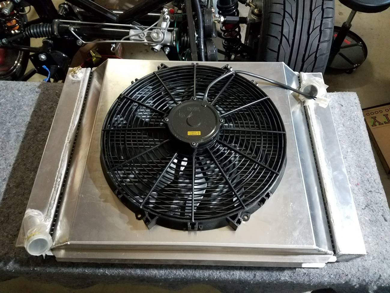

    Also got the upgrade from Breeze Automotive for the radiator. It comes as three parts, as shroud, an upper bracket, and a lower bracket. I might try and test fit that this weekend in preparation for the engine.
    Finally, I got way way way ahead of myself and tested my new "driving" shoes. I found my tennis shoes a little tight for the pedal layout. These new shoes look a little funny but I think they will work nicely. They are made by Puma and got them off Amazon. They have a relatively hard heel that makes them really pretty neat. Might be something to check out if you are having issues. Ignore all the hair. I keep telling my wife that real men are suppose to be hairy. She just rolls her eyes and asks me why I don't have more on my head.
    Hopefully I get my engine this next week.

    So after finishing up what electrical I could, I decided to do some system tests. I did the following:
    1. Installed the battery and verified I had power to the main cut off switch.
    2. Pulled all fuses
    3. Switched on the main cut off switch and verified I had 12V at the terminal bus bar (I am using this instead of a solenoid)
    4. Installed one fuse at a time and tested each circuit
    5. Horn worked
    6. Brake lights worked (well only one at first) after some switch manipulation
    7. Parking lights, headlights (high and low), turn signal, hazards, dash turn and high beam indicators all worked.
    8. Verified the "light left on" chime worked. Thanks to EdwardB for the instructions.
    9. Shut everything off after snapping this pic
    The testing process and set up did not take very long. I simply twisted the appropriate wires together at the for corners and laid them in the trunk and on a table in the front. I only had two real problems. Problem one was the brake lights. They came on and stayed on. I verified that the brake switch attached to the wildwood pedal box was closed meaning it was not depressed all the way. I did a little adjustment and that took care of the issue. Problem two was the passenger rear running and brake light. It did not come on. I checked voltage and all was good. I thought maybe my ground was weak and was about to rig up a quick chasis ground when I decided to check the bulb for grins. Well, no bulb. Easy to solve but a little surprising. FFR got all but one right.
    All in all I was pretty happy to only have those two problems. I will try to get the wipers checked out. That is the circuit I am most nervous about. I am using a replacement toggle switch and a relay. Hope it works. Once I check the wiper then I should be basically done wiring with the exception of the high beam indicator. I bought a blue led light from Del City. It is part number 73380. Man that thing is bright. Way too bright. I am going to replace it with a green one (part # 73388DL). I happened to order an extra of each color and should knock that out tomorrow. Anyway, I am getting closer little by little.
    I talked to Gordon at Levy Racing and he said my engine is almost done. YEAH!!! He said it should ship mid next week. I asked him to send me a picture to drool over in the mean time. Keeping my fingers crossed I have an engine shortly.
    Just had to show off my working electrical.

    1. I installed and tested the wiper motor. I had some issues initially but finally got them solved. That solution is captured in the following thread in case anyone is interested. http://thefactoryfiveforum.com/showt...r-wiring-issue
    2. I also corrected an issue with the fan indicator light. I wanted the indicator light to confirm that the relay was supplying power to the fan (triggered from eitherthe thermo switch or the manual toggle). I initially tied the indicator light to the power wire (blue wire in the Ron Francis Harness front loom). This did indicate when the fan was on but remained lit even after the manual toggle was turned off. This was due to the DC motor continuing to free wheel and essentially functioning as a generator. This fed power to the LED until the fan stopped. This would of course cause the light to come on any time the car was in motion. Not what I was wanting. I contemplated and research solutions such as diode, alternate wiring methods, etc. I finally decided to replace the standard change over relay for the fan with a dual post relay. Essentially the 87 and 87a post are supplied power when the relay is pulled in. The 87 and 87a post are also not connected internally. I made the mistake of order a dual 87 post relay which had the two posts connected internally and that will not work. I ended up finding a relay at Del City. The part number is 73996. I should get this part next week and will confirm if it works or not. I am confident this will fix my issue and wrap up this task
    3. I also added lights to the engine bay and trunk. I used the same LED strip lights I used for the courtesy light in the foot boxes. I put the trunk light on the hoop where the trunk hinge is located and the engine bay light on the top cross frame member in the front of the engine bay just above the radiator. They are hooked to the courtesy lights. I thought about using another toggle but thought the courtesy light would make things cleaner. I got the engine and trunk light ideas from BobL. He is on these forums. More on him a little later.
    4. I got the breeze seat brackets fitted and all ready to install. With the classic seats supplied with the MK4 complete kit, I was able to use the alternate installation instructions. It took me a little bit of testing to get the exact location and angle I wanted but once I did the system works great. Not much to photograph.
    5. I got the Breeze fan shroud and hinge system mocked up and installed. It is back off in prep for the soon to arrive motor. Fan works and the Breeze system is very nice and easy to install.
    6. Test fit the body one more time. This allowed me to do a little trimming on the "wings" of the dash. Per a thread on this forum I am going to let the wings kind of float against the lip on the body just in front of the hinge. I tried tucking them behind the hinge but the way I have them now looks a little better to me. So I will see how it goes when I get to drive it. The body is now back on the body buck and probably wont go back on until I get ready to assemble and drive it in gel coat.
    7. Cleaned up some wiring behind the dash and tried to organize that mess as much as possible. Did some labeling and wire loom work so that should all be ready to go.

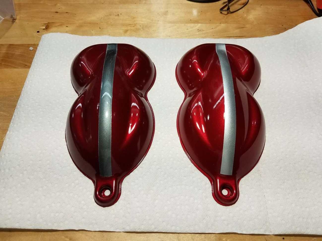

    So I have been piddle around doing some odds and ends. I decided to get serious about finding a color combo for my car. I have known I wanted red for some time. But what shade and what color stripe? I decided to make some samples to compare. I found the color choices I liked by riding around and looking at cars on the road. I then found the paint code and bought some touch up paint in aerosol cans from a place called Automotivetouchup.com. They really had everything and prices weren't terrible. They even supplied a base, mid, and clear coat for one of the reds I ordered that was a 3 stage paint. I also ordered some "speed shapes" from amazon. At least that is what the item was called. They are these small plastic shapes that are made for paint samples. They were less than $20 and came in a pack of ten. So below are the two options I tested. The one on the left is the way I am leaning. It is darker red with a dark silver (grey actually) stripe.
    I would love to here some opinions as I have not decided quite yet.

    Senior Member Gordon Levy's Avatar
    Maricopa AZ
    1,288
    The one on the left

    I vote for the darker colors.

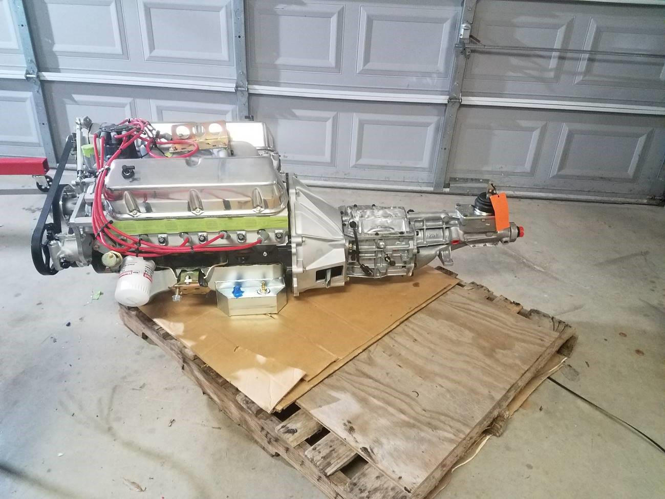

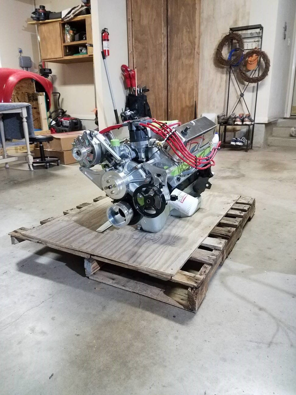

    My engine arrived.
    It is a Levy Racing 347. I should get the transmission any day now and hopefully in the car soon.
    I have worked on engines before but it has been a long time. I helped my dad rebuild a straight 6 300 for a Ford F150. But I have slept since then so I feel like this is all new to me. Any advice, checklists, instructions, tips, etc. for engine assembly and install would be much appreciated.
    I am excited about the engine and chance to learn.
    Overall a good day.

    I was just wondering if you got your engine. Looks nice.

    Emergency brake change
    After staring at my new engine and dreaming of thundering down the open road, I decided to get some work done. Since I need to wait on my transmission to arrive, I decided to make a change to my emergency brake. I had originally installed the FFR handle and a set of Lokar universal cables (EC-81FU). I know many say it is not a problem but I just didn't like having the cables run under the 4" frame. Probably would never be an issue but ever time I went over a speed bump I would worry and wish I had changed it. So, I ordered a Ford parking brake handle from Breeze along with the "T" bracket.
    The handle mounted up perfectly. I wanted to reuse the set of Lokar universal cables installed with the FF handle. The Lokar cables terminate on the handle end with a brass block that holds both cables with a couple of allen set screws. Since the T bracket needs an end of some sort to hold the cable, I decided to cut the brass holder in half and use it as a cable termination. It worked out well. My issue was the Lokar cable length. I had cut them off for the first install and knew that they might be a tad short. Well sure enough the self adjusting mechanism just wouldn't go around quite far enough to grab the first tooth on the that wheel. I thought about defeating the self adjusting mechanism and fashioning up some sort of adjustable linkage but really like the idea of the self adjusting feature. So, another $130 bucks out the door and I have a new set of Lokar cables coming. I might could have found a cheaper set of cables but the Lokars are really nice and easy to cut to the desired link. Plus I now know how to modify them.
    One other note. I made a panel to go behind the T bracket. I used a piece of aluminum I had lying around (the cut out from dash for the glove box). I removed the front FFR parking brake bracket and riveted the aluminum panel. Hopefully this will prevent the T bracket from catching.
    My transmission should arrive early this next week. Hopefully I can get the E brake wrapped up and be ready to drop the engine in later next week. It is coming together slowly but surely.

    Fan Wiring
    So I finally tested my new fan wiring set up from post 28 above. The set up worked great and I no longer get the generator feedback from the spinning DC fan motor. Here is the wiring diagram. Hopefully this helps someone down the road.

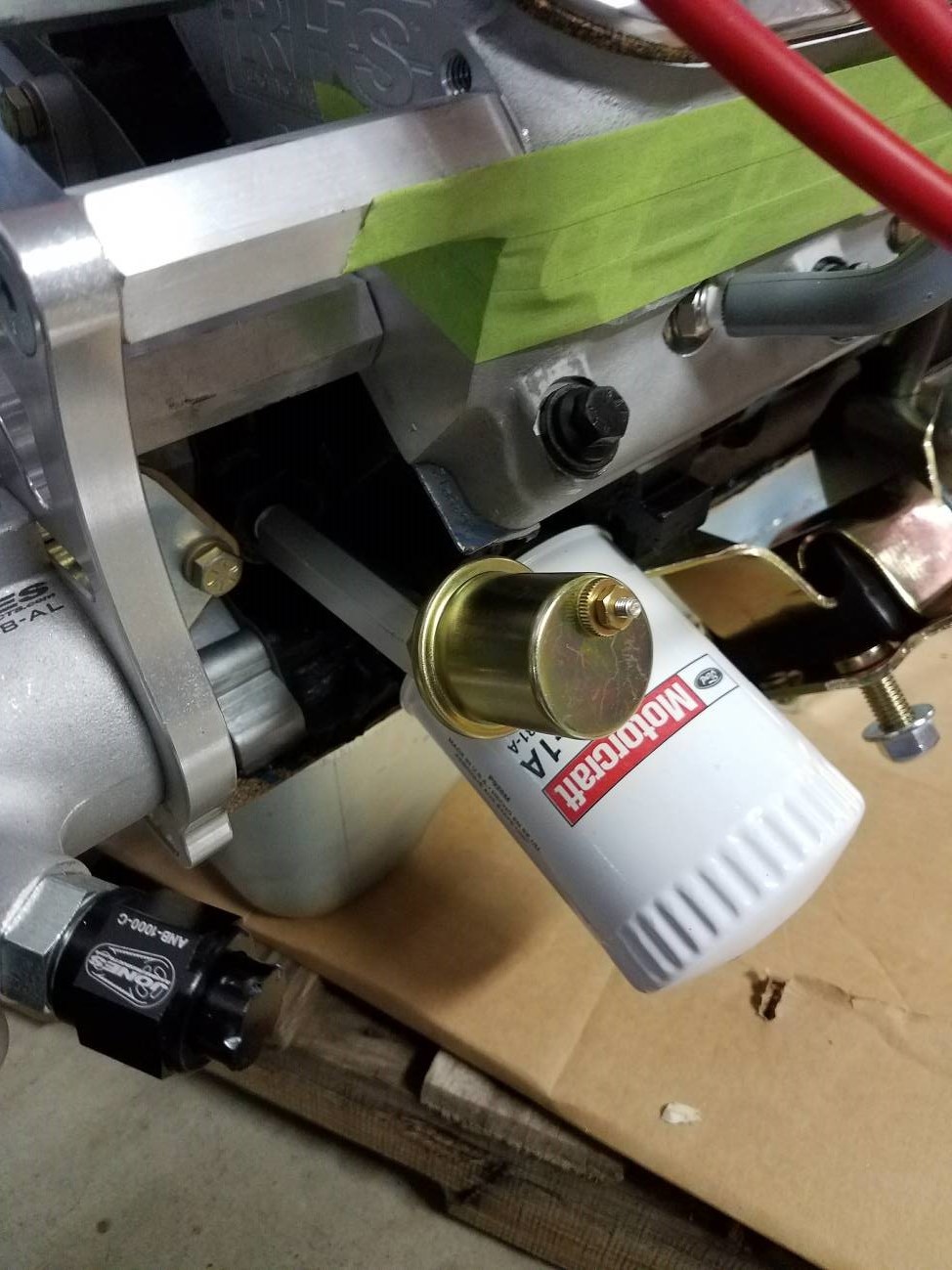

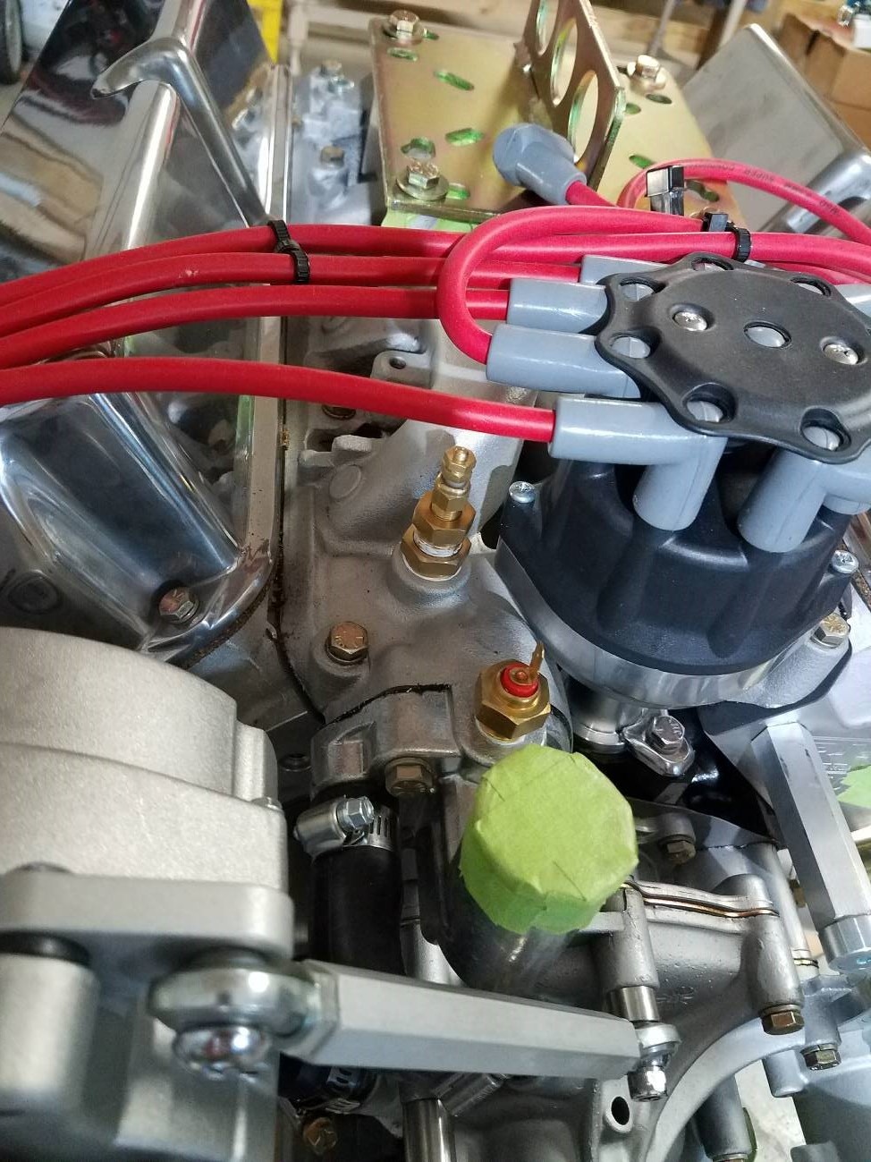

    19 weeks in. So far I have 287 hours on the build. I received my engine last Friday. I have been tinkering with the motor and finishing up some small items. On the motor I have all the gauge sending units and themostat switch installed. Here are some pictures. The first picture is of the rear sump oil pan with the oil temp sensor installed in the bung on the right (rear of the pan). The bunge on the left will be used for my dipstick.
    The next picture is the oil pressure sending unit. Based on other posts, I found this to be the typical location near the oil filter. I had to get an extension for the sending unit to fit. I got the part for Lat Model Restoration. Here is a link to the part and it work out perfectly.
    https://lmr.com/item/LRS-9278A/1979-...-Extension-50L
    I also installed the themorstatic switch for the cooling fan and the water temp sending unit. They are both right next to the upper connection point for the radiator.
    I put the motor mounts on but left them loose per the build manual. I also slid the throwout bearing and clutch fork into the bell housing. That is about I can do on the engine until I get my transmission. Hopefully any day now. I run to the front porch each day hoping to see a heavy box. Maybe tomorrow.

    My transmission came in this last week and got it mounted on the bellhousing. I purchased Mike Forte's hydraulic clutch kit. I went ahead and mounted that part since it uses the transmission to bellhousing bolt locations. I had some interference with part of the "ribbing" on my T5. The picture below shows the small cut out needed to get the proper clearance. I used a die grinder with a small bur bit and was very easy.
    I also removed the neutral safety switch. It took a little research to even determine what it was. I also found out it could be plugged with a 3/8 flare plug. I found it at Home Depot and was a Watts A-159 plug in the brass fitting section. I used a little teflon thread sealant (the dope not the tape) on the threads to seal it up.
    The next day I was able to drop the engine in. I could not round up any of my buddies so I decided to drop the engine in myself. Sorry for no pictures but I was focused on not messing up anything in the engine bay and on the engine. My hands were full and I was in the zone. It went in pretty smooth. I used a lift plat on the intake to pic up the engine. I used the middle hole which allowed the engine to hang lower in the back due to the transmission. I also used a ratchet strap connected to the tail of the transmission and connected to the bottom of the engine lift. Took about 45 minutes and it fell right into place. No big drama thank goodness.

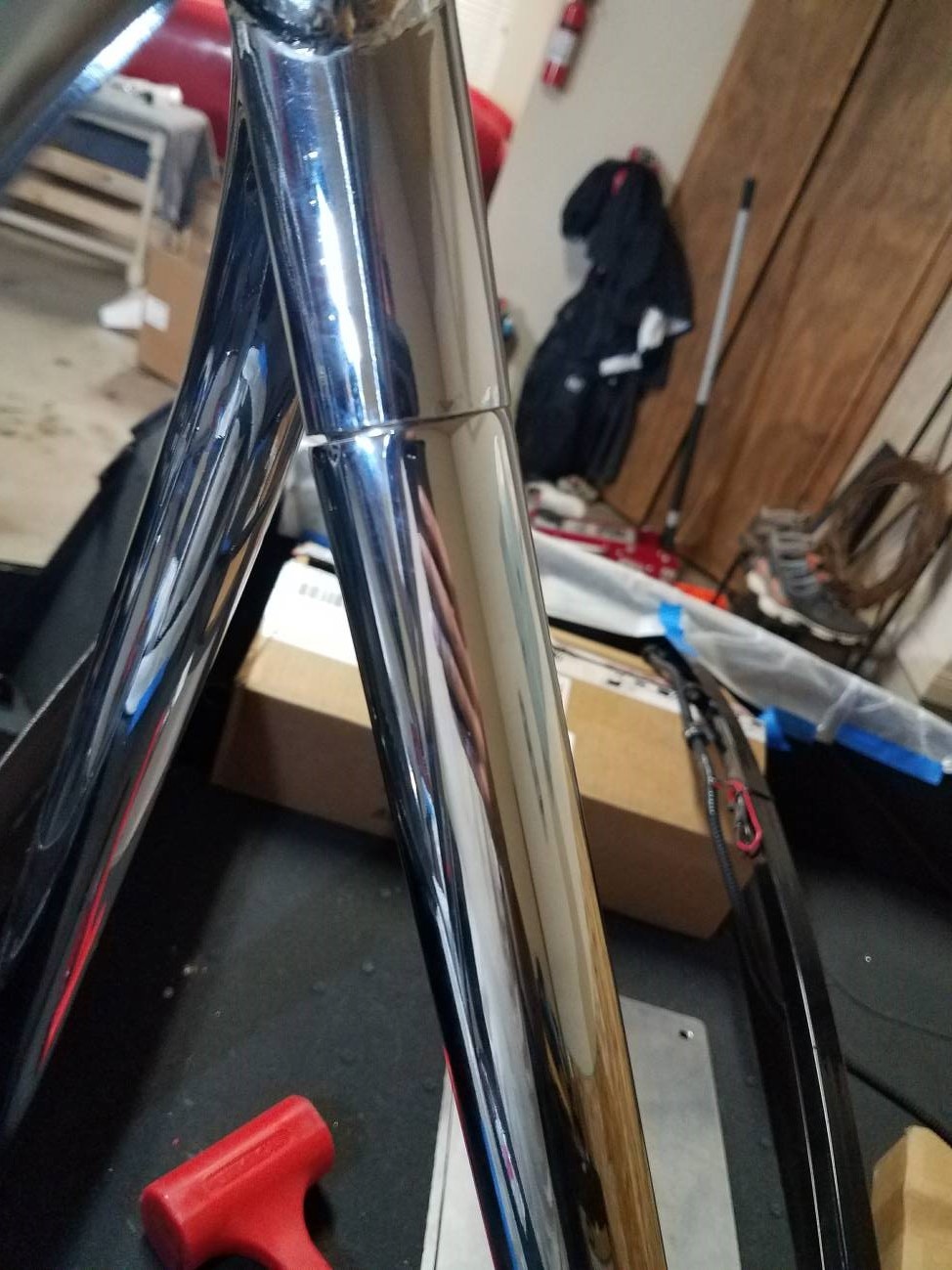

    Next I installed the transmission A frame and headers. I think it looks pretty cool. I finally feel like I actually have a car instead of an interesting Fred Flinstone go cart.
    This weekend I went ahead and starting working on the engine components that I couldn't hook up without the engine installed.
    1. Clutch - this went in pretty easy. I already had the master cylinder installed. It was the one supplied my Mike Forte. I don't remember the size but something just bigger than 1" is what I remember. I then cut off the small shaft of working cylinder on the clutch fork. I measured this a couple of times, called Mike to confirm, measured again and then made my first cut. I say first cut because I made about three cuts to get it right. I thought it would be easier to take off a little at a time than to make one big cut that was too long. It took a little bit but worked out well. I then bench bled the master (did this on the car) by hooking the braided hose Mike supplied to the master cylinder and then let it sit in the remote reservoir. Took a few pumps of the pedal and it was done. I then wrapped a shop rag around the end of the hose and routed it down to the working cylinder. I lost a little fluid but not too much. Mostly got on me. Once connected, I opened the bleeder on the working cylinder and gravity actually did the work and I had clear fluid with no air bubbled very quickly. First pump of the pedal and the clutch released. I am not an expert on setting up this system so it might need to be tweaked. If you guys have any words of wisdom then please let me know. Sorry but no pics. Not much excitement and other pics of Mike's set up are on this forum. Mine looks exactly the same.
    2. Speedometer - I installed the FFR speedometer sending unit. It had a red gear supplied and from what I read the color/size does not matter since the speedometer and odometer will be calibrated when I drive the perscribed 2 miles during the dash unit calibration. So the install was easy and I used a 1/4-20 x 3/4" bolt with a lock washer to hold the unit in place. Again, no pics and not very exciting
    3. Power steering - started on this but didn't finish. I mounted the remote fluid reservoir on the driver side F panel. Pretty simple and think it will work well. I started running the hoses. The system was provided by Gordon Levy along with my engine. Really nice system and very complete. The hoses, except for the high pressure hose were braided hoses (fiber not SS) and Fragola lock fittings. I had a hard time getting them to slide on. I tried heat with a little oil for lubrication and no luck. I actually messed up some of the hose and was a little short. The hose I did get completed, I could never get the fittings all the way on anyway. I decided to order some braided SS hose in the same sizes from Summit. I will try my hand at those. I will take some pics of the SS hoses made and installed. Most of the hosing is -6AN with the reservoir to pump inlet being -10AN. Those parts should arrive this week. More to follow.

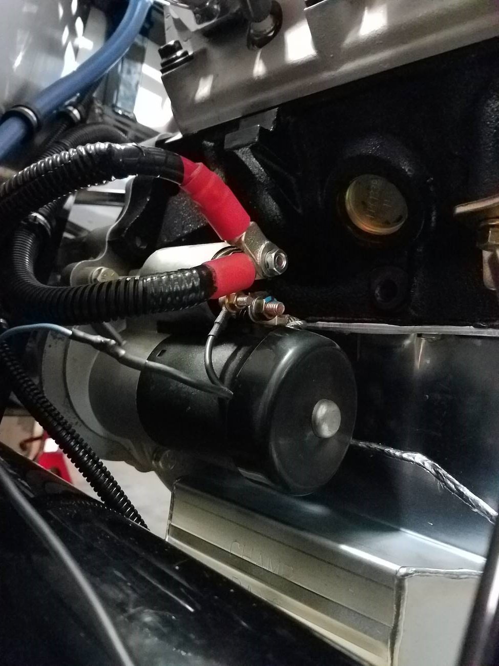

    4. Starter wiring - I got the starter wired. I am not using the FFR remote solenoid. I am just using the solenoid on the starter. I ran the battery cable directly to the starter and then another battery cable the same size to a terminal bus. I did this per other recommendations and made sense to me. The terminal bus is a Blue Sea Marine unit I bought on Amazon. It was rated for 300 Amps so should be plenty big. The battery wiring to starter and terminal bus was 1 AWG. Should be plenty big. I also connected the blue starter switch wire. I soldered this to the wire on the stater and put on some heat shrink. Still need to put this back in the wire loom. I am not sure how to test this set up and may not be necessary. I think I will just test it when I try my first start.

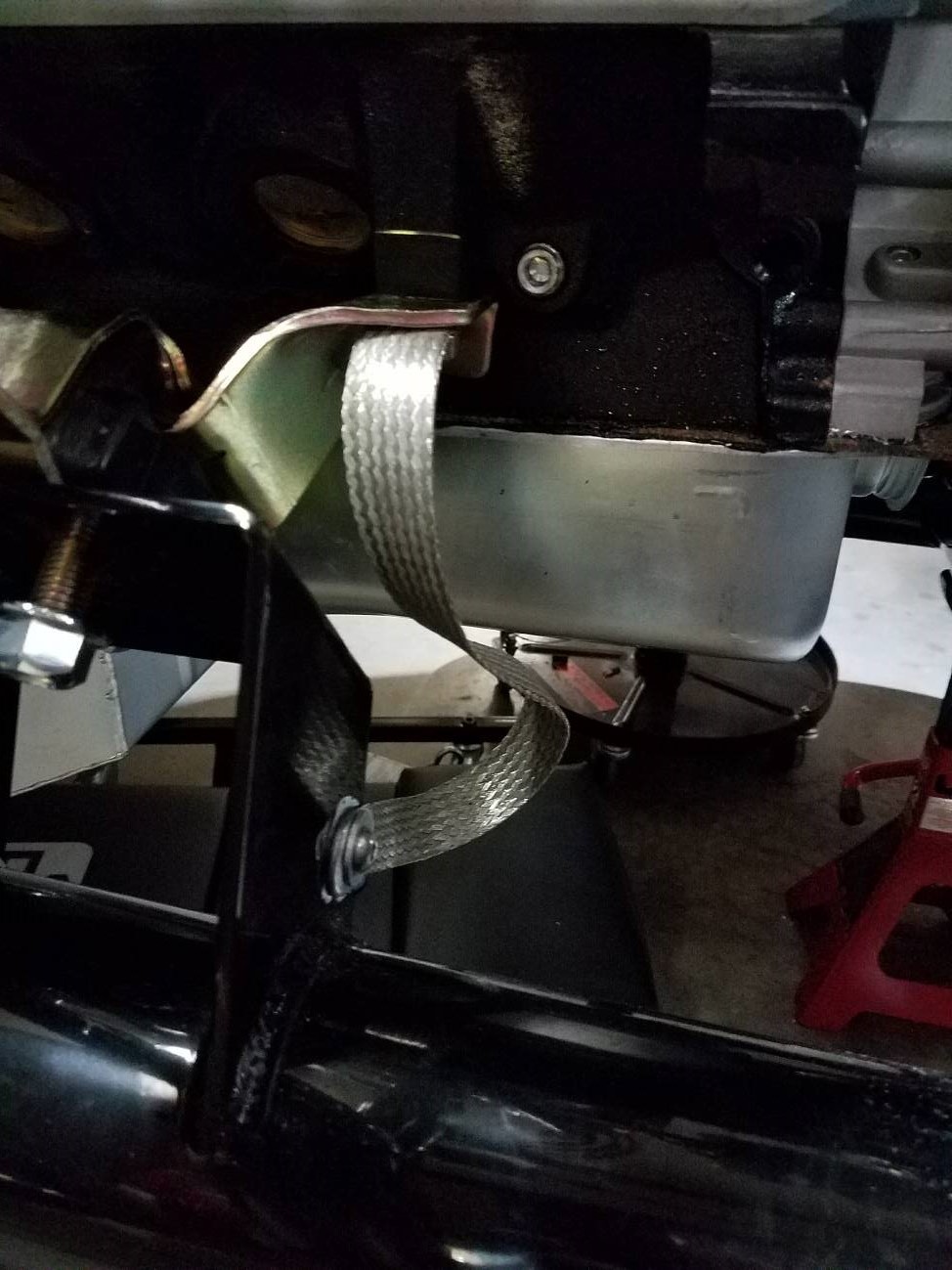

    5. Engine ground - I connected the engine ground just like the MK4 manual specified. I connected to the motor mount.
