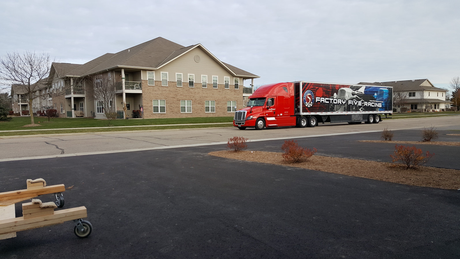

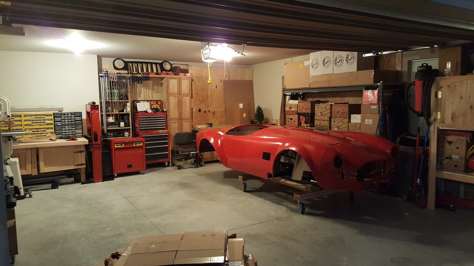

    Delivery went flawlessly except that it was 70 degrees and sunny two days before delivery but snowed before my car showed up. Gotta love Wisconsin weather! Gerry from Stewart was great, we loaded the car onto my chassis dolly, and the whole process was done in very short order. It felt good to send Gerry on his way with a nice tip since he was going to be on the road for Thanksgiving and unable to get home to Arizona.
    A detailed inventory was completed right away and I was able to repack things more logically and in easier to access boxes. My back-order list is quite short with no show-stoppers. Major missing items are headlight assemblies, throttle cable(I'll be throttle by wire anyways...), parking brake cables(I'm going line-lock), and a couple other knick-knacks. This biggest issue is I ordered the stainless side pipes but got uncoated. I haven't called FFR yet to talk to Courtney about options. Either get the $300 credit back and keep them or we'll have to give UPS more business. Still not sure which I'd rather do.

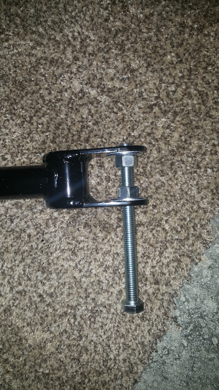

    ​After the car was fully photographed and marked I stripped of all the interior panels. I quickly dug right into the front suspension. My plan with both front and rear is to do a mockup to make sure I everything works, see what changes I want to make, etc... Once satisfied I'll be pulling everything back apart to prep and grease bushings, powder coat spacers, and prepare for final assembly.
    Like others have seen and expected as a part of the frame welding process, many/most of my suspension tabs were pinched to close together. The first lower control arm tab I hit with a rubber mallet quickly chipped the powder coating. Idiot... powder coat is durable, but not indestructable. I built a quick tab spreader with 1/2" all-thread, 2 washers, and two nuts.
    Works like a dream and although tedious it really is the best way to spread tabs in a controlled manner. After my first newbie mistake chipping the powder coat, I told myself to take my time and think things through better.
    My Mevotech upper ball joints were also similar to others. One screwed in extremely tight but seated, the other wasn't going on even after cleaning threads, etc... Since the car will see a decent amount of track time I decided to upgrade to the Howe Racing joints. Overkill and will require slightly more maintenance, but it is a very high quality part. The joints move effortlessly but the tolerances on the inside are so tight that greasing them doesn't let grease spurt out and around the ball joint. This requires you to be more diligent about using the right grease(not just all-purpose) and keeping them lubed. But they are also rebuildable so easy to keep in good shape. Did I mention that they are overkill? The rest of the front went together without issue.
    To move too far forward in the rear, I need to POR15 the iron Ford factory diff but it's awfully cold in my WI garage. The diff reads about 49-50 degrees, which should be warm enough but will take extra long to dry. I also noticed that the sleeves for the front diff mounts aren't sized right. They are way too small and sized for a 3/8" bolt, so they don't fit in the poly bushing and are too small for the carrier bolt. Not a big deal but also not something I can easily pickup in the correct size locally. I'll call FFR tomorrow, it's unfortunate since I just received a box with my back-ordered front pedal box panel.
    I took my rear spindles to my friend's Tool and Die shop. Instead of hacking the extra tab off with a sawzall then cleaning up the cuts, we mounted them in a fixture and put them on the CNC. No real advantage to doing it this way, just a little cleaner of a process. I then mocked up most of the rear except for the diff and CV axles. Like the front it will get pulled back apart for final prep and install, then brake work and alignment.

    My injury left me with lots of time, but no ability to work on things. I received my engine mounts, I decided to buy BRP mounts instead of fab'ing my own since I'm already a little behind on my plans. They look good, the anal person in me wishes some welding flash was cleaned up before powder coating, but not a huge deal. Not something I'm go cleanup and re-powder coat for a non-show car.
    I've been putting together my Levi-sourced Wilwoods while my ribs are getting better, pretty routine stuff. Doing loctite and safety-wire for the rotor to hat bolts since the car will get track time. Decided the best way to save on garage space was to install the engine in the chassis instead of sitting on a pallet. It would also give me the ability to see how far forward I can move my firewall, where to bring the fuel line to, how much room I have to expand the passenger footbox, etc... I got the motor hoisted off the crate, removed the stock exhaust manifolds, and covered the open ports. I installed the motor mounts and went to slide the cherry picked under the chassis when I hit an issue. I didn't build enough space under the chassis dolly for the picker legs so it's a no-go. I'm going to have to finish all the suspension and make it a roller or get creative jacking up the front of the dolly.
    At least I got back quite a bit of space, the motor is just going to have to wait to get installed later. I may look at mounting the bellhousing and tranny as well to get an initial fitment, measure for driveshaft, etc...
    I'll post more pics once I get the engine in to show the spacing, alignment, etc... for any potential or curious LS roadster builders.
