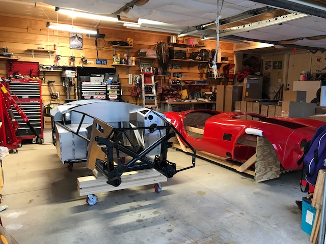

    First, I got my garage space in order. Long ago, it looked like this:
    After a good bit of organization and work, it looked like this - ready to receive this awesome project:

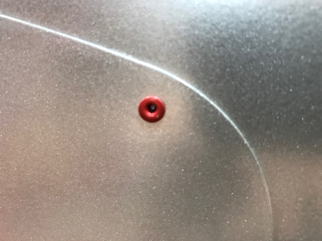

    So, I have decided that I really like the appearance of a scheme where the rivet heads contrast with the panel. So, I'm going with silver panels in some places and want red rivets. I had read Paul's tale of painting rivets, so thought I'd give it a shot.
    I made a panel with appropriately sized holes for 1/8" and 3/16" rivets:
    Then used self etching primer, a red color coat, and a clear coat:
    I didn't really like the way they turned out, as the clear coat resulted in a wrinkle finish. So, I read the rattle cans. Sure enough, the clear said not to use on the type of paint I used for the color coat. Therefore, I repeated the whole process with different paint, that would supposedly play well together.
    Also, at that point, I ordered a box of McMaster-Carr colored rivets.
    After giving my home job adequate time to dry, I pulled a few. Here is what I found:
    My home painted rivets (one on the left) didn't fare too well when pulled, either with a hand riveter or a pneumatic riveter. The commercially available did better (one on the right. Not perfect, but better).
    Based on these findings, I went ahead and ordered a bunch of red rivets from McMaster-Carr. They weren't too expensive, and I'm hoping that they continue to fare as well during the build. I'm hoping I can get the look I'm going after, but will default to just bare rivets if it doesn't go well.
    If you're going for painted rivets, give it a trial beforehand. I don't know that it's any cheaper to not just buy them, if you can get the color you want. Based on Paul's results, home painting rivets can certainly be done - but I sure didn't have much luck.

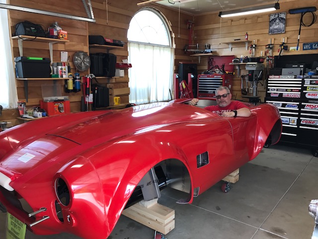

    Yup. It was cool. Obligatory picture, with me holding imaginary steering wheel.

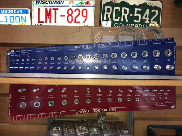

    I did get these, which were used to verify each and every bolt/washer/nut provided as we completed inventory.
    I had one bolt that was longer than the length specified on the BOM, and a grand total of four other missing parts after completing the inventory. Given how many parts there are in all these boxes, I thought that was really, really good. That summary does not include my "Box 24 Issue", which I'll get to in a minute.
    In the end, I don't know if the bolt/nut gauges shown in the above picture were really necessary to do inventory, but they have been helpful for other reasons (so I'm glad I got them).

    Deconstruction - Take it apart before you put it together (and a couple questions)...

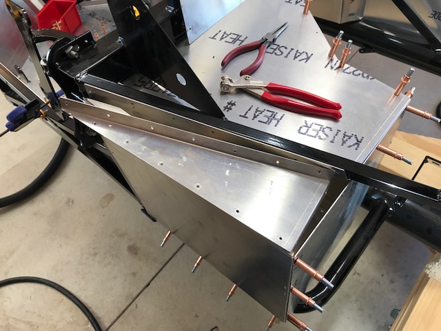

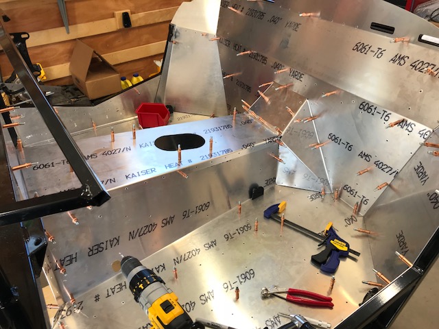

    After reading all the great build threads on here, and given that I'm having my aluminum panels powder coated, I decided it best to do as much panel drilling as possible as I did disassembly.
    I started with the trunk panels, then went to the front and worked my way back to the bulkhead behind the seats.
    I've heard stories about broken drill bits, so I ordered 30 of these (3 10-packs) which really is 60 drill bits - since they are double ended:
    I also ordered some #10 bits of a different type, but haven't used any of those yet.
    After drilling all the panel's rivet holes, I still have 2 unopened 10-packs. So, either I'm doing something right, doing something wrong, or these were pretty good drill bits.
    I made couple mistakes initially, where I'd mark a panel, remove the panel, drill just the panel, and then mount the panel on the frame - only to find that one of the holes I'd drilled in the panel was in a location that I'd not be able to get the drill to finish the job once the panel was in place. Or, I'd drill a spot on the panel where a weld was right behind the hole. Thankfully, I didn't make the same mistake twice. However, I did find that there were several unique situations where a given mistake could be made once. Drill head clearance, weld placement, panel assembly order, etc.
    I didn't get many pictures through this process, but here are a couple:
    Holy crap, that was a lot of drilling. I tried to vacuum and sweep often. And I was very careful with eye protection during drilling.
    And for the questions regarding what tools are required, this is pretty much the extent of what I used for this part of the process:

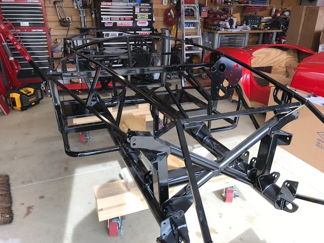

    After completing all the drilling for rivets, my frame was completely bare:
    On my build, the firewall and those panels forward of the firewall, and the trunk panels are going to be powder coated a metallic silver color. The remaining passenger compartment panels will be getting a different powder coat color.

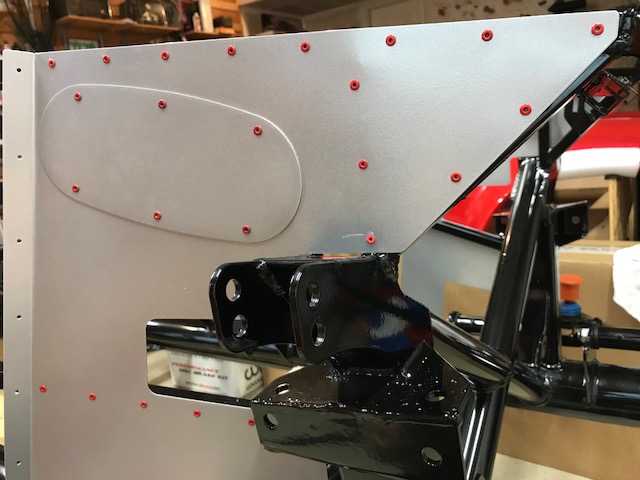

    First Panels Back from Powder Coater

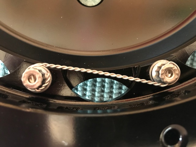

    So, while I was killing time, waiting for the powder coater to finish my first batch of panels, I took care of several things: Painting my differential, assembling and safety wiring my brake rotors, and I had the tires mounted/balanced on the wheels.

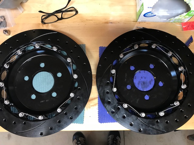

    It was the first time I've done anything with safety wire, and with the right tool - it seemed really easy.

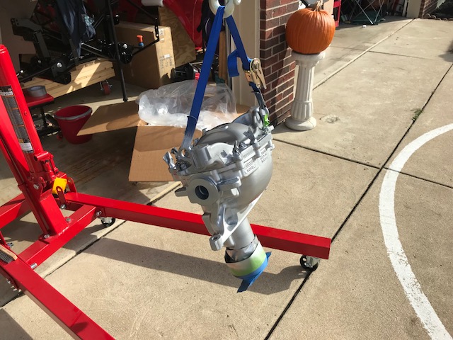

    And my differential. I put the first coat of paint on and wasn't happy with the color, so subsequent coats were with a different color - followed by a clear coat. There is a slightly different color between the housing and the rear cover.
    While I was doing the coats on the diff, I got the text from my powder coater that the first batch of panels was ready for pick-up. So, I picked them up (and dropped off the remaining panels).
    The metallic doesn't show up too well in photos, but here's an attempt:
    And finally, I did officially put on the two F-Panels. As discussed earlier, I'm going with red rivets (commercial ones from McMaster-Carr). I think it looks awesome, and is just the look I'm going after. I know that is purely subjective, but I like it.

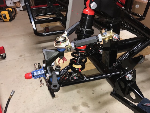

    I've already put on the lower control arms, but I hope to finish the front suspension today. My upper ball joints are in, and my shocks are assembled.
    Should I use the wicking thread locker (green Loctite) between the coil sleeve and the shock housing? I read a recommendation to do that somewhere, but it doesn't seem to be mentioned in very many build threads.
    I would not recommend doing that. Everything is under tension when the car is on the ground. They're not going anywhere.

    As Edward has already mentioned you don't need lock tite on there. I have a spanner wrench and adjust the shocks as I need for different occasions. You want to have them adjustable. Not sure why anyone would put locker on there?
  35. #35
    Senior Member mach'er's Avatar
    Mar 2012
    Monroe, MI
    152
    Not on the threads the sleeve and the coil stop, but between the sleeve and the shock body. The reason read that it kept the sleeve from just spinning around the shock when using the spanner wrench.
    I read it, and wondered if people actually did that.
    Roadster #9146. Complete Kit, 363 w/Jim Inglese Weber Carbs, Forte TKO600 w/Hydraulic Clutch, IRS, Wilwood Brakes, F & R Sway Bars, 17" Halibrands, Power Steering, Breeze Front Battery Kit, Herb's Door Panels, and who knows what else left to be added.
    Ordered 5/19/17. Delivered 8/18/17. Slowly Building.
  36. #36
    Brandon #9196 TexasAviator's Avatar
    May 2016
    679
    mine has set screws built in that location. why not just use the set screws.

    Through to Spindles
    Well, I didn't get as far as I would have liked over the weekend. I got to this point:
    RH
    LH
    I ran into a couple minor questions:
    1. Parts list calls out a LH and RH steering arm, but I can't tell any difference between the two parts. Therefore, I just mounted them without regard to LH and RH.
    Question: Should there be two unique parts with some discernible difference?
    2. Upper control arm initial adjustment... I put this question in Yama-Bro's thread on his UCA assembly, and will look to see if an answer gets posted there.
    Other issues I dealt with (not really questions, unless someone wants to give input):
    3. Castle nuts too far engaged on upper ball joints (similar to this discussion from a '33 build thread). The spindle seats on the upper ball joint, it's just too far engaged for the height of the castle nuts relative to where the cotter pin hole is located. I've decided to get some spacers to put in place, similar to the lower ball joints. I think a spacer should take care of the problem.
    4. Tightening the rear bolt for the upper control arm mount. I had difficulty getting a wrench on the nut behind the mounting flange for the rear nut. I was able to get it torqued to spec, but clearance back there is pretty bad. Just did the best I could, and got creative using a tool wedged between the nut and bracket to prevent the nut from spinning while torqueing the bolt.
    I'm using the paint mark method on each fastener as I torque it to spec, both as an indicator that I've torqued a given fastener, but also to provide a visual clue of any movement once the vehicle is in use.
    After I get the spacers for the upper control arm ball joints, I hope to get the front hubs and brakes installed this week. I'd like to be working on the rear end this weekend (I hope).
    Thanks, guys. Let me know if you think anything looks wonky in the pics of my assemblies so far.
    --Curt
