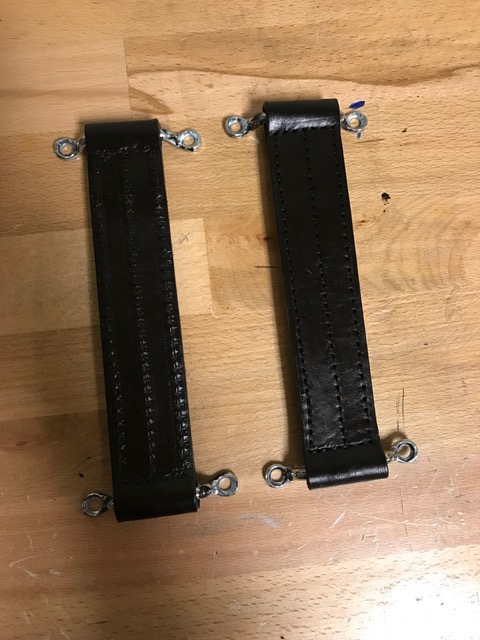

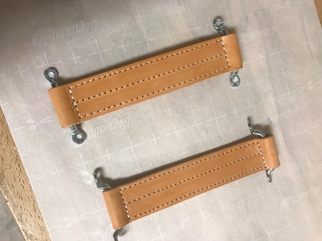

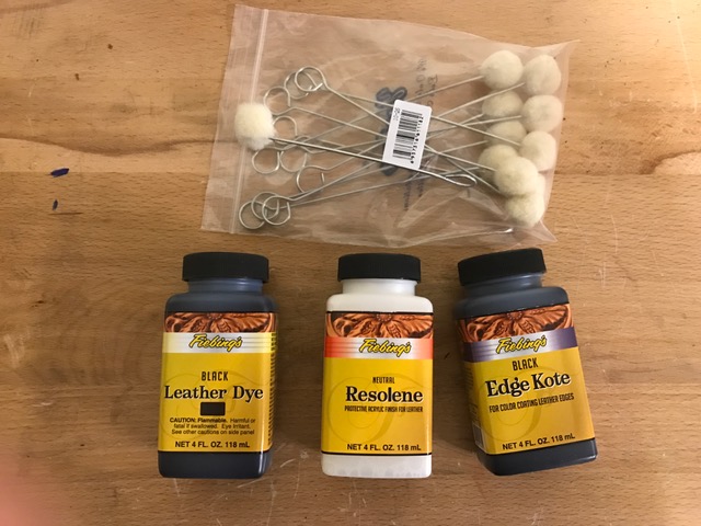

    Today I once again followed Edwardb's good idea and dyed my leather door straps. I noticed he also did the leather on the seat belts. I changed out my belts to some aftermarket ones and did not need to do anything with those..
    Here is the before:
    These are the supplies I used. Ordered them on Amazon. Pretty cheap. I used about 1% of the bottles. I think I now have a lifetime supply of leather dye. The three products are the dye, edge finishing and the finish coat that supplies the shine. Prior to putting the finish coat on they were black but pretty dull. If you are looking for a dull finish just bypass the resolene.
    Here they are finished. Pretty simple to do. I like how the black will blend in better with the rest of the interior.

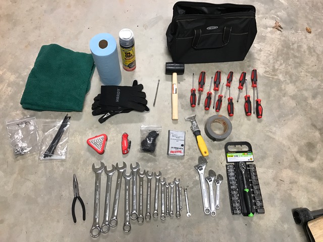

    Well this is about where I am at on my build. Waiting for the body to be ready. Have a few very minor things I can do but honestly I am dragging my feet to make those small items last me for a while so I don't run out of things to do. Luckily the weather continues to be nice so I will just go cart around the neighborhood every couple of days. I am up to 55 miles now. Getting pretty routine driving around the neighborhood again and again. Anxious to get out on some real roads! On the positive side the neighbors don't really look at me to strangely anymore because they are all used to it.
    I am getting way ahead of myself but I figured I would throw together a trunk tool kit. Went to harbour freight and got everything for about $115. Some of this may be overkill but I like to be prepared in case I have any roadside issues.
    I have included:
    paper towels
    towel
    can of fix a flat
    work gloves/ rubber gloves
    zip ties
    hose clamps
    utility knife
    flashlight
    allen wrench set
    rubber mallet
    screw drivers
    pliers
    adjustable wrenches
    socket set
    duct tape
    Any other essentials anyone would recommend? Any input is appreciated

    I would change those needle nose pliers out for a set of Vise Grip needle nose. They give you more leverage, can do the same grip and turn function, and can be attached to hold something in place, if needed. Good luck,
    I have read where they were used to pinch off a leaking brake line, hold a trailer ball on the tongue, pinch off various leaking hoses, etc.
    20th Anniversary Mk IV, A50XS Coyote, TKO 600, Trunk Drop Box, Trunk Battery Box, Cubby Hole, Seat Heaters, Radiator hanger and shroud.

    ---Wire stripers, crimpers, a variety of spade, butt and ring connectors along with a few feet of 12 or 14 ga. wire.
    ---Small digital volt/ohm meter.
    ---Channel locks.
    ---Socket to fit your lug nuts on a 1/2" breaker bar.
    Hopefully you'll never need any of it!

    Good tips on the tools. I'll make a few additions. Thanks.

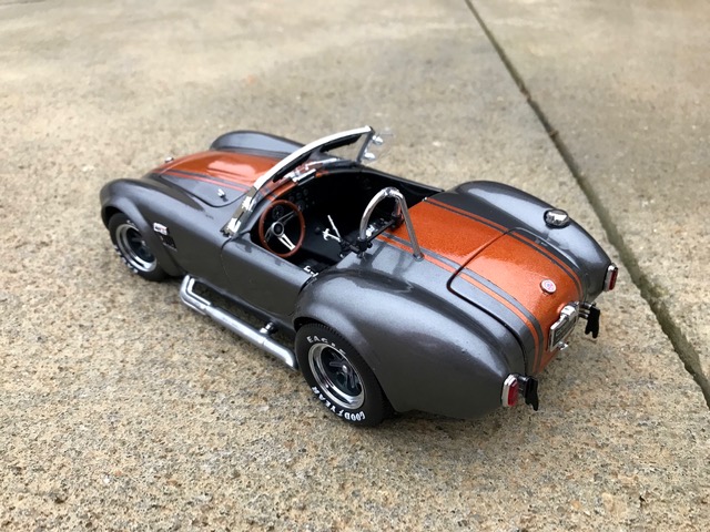

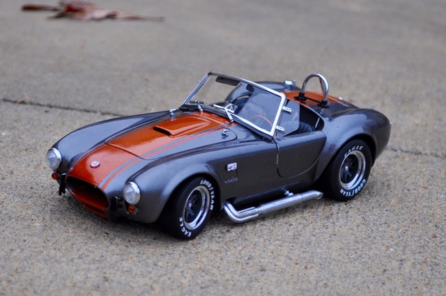

    Paint is done!!!....sort of

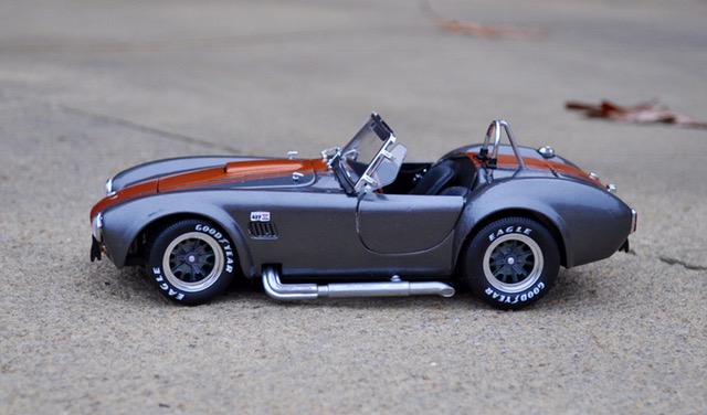

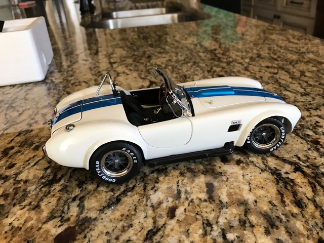

    Well I am getting pretty antsy waiting for the paint to be done. I decided to take matters into my own hands ... on a 1/18th scale! Haha
    I bought a die cast model and painted it up to match how my car will look when done. I actually really like the paint job now that I am sort of seeing it in person. It will look nice sitting on my desk while I browse the forum and day dream about the day when I have the completed real thing in my garage! Here are a couple pics. Fun project!
  16. #336
    9,128
    The little one looks great! Do you have a date for paint completion on the 1:1 scale version?
  17. #337
    Thanks!
    No date yet but I hope to have a pretty solid estimate soon.

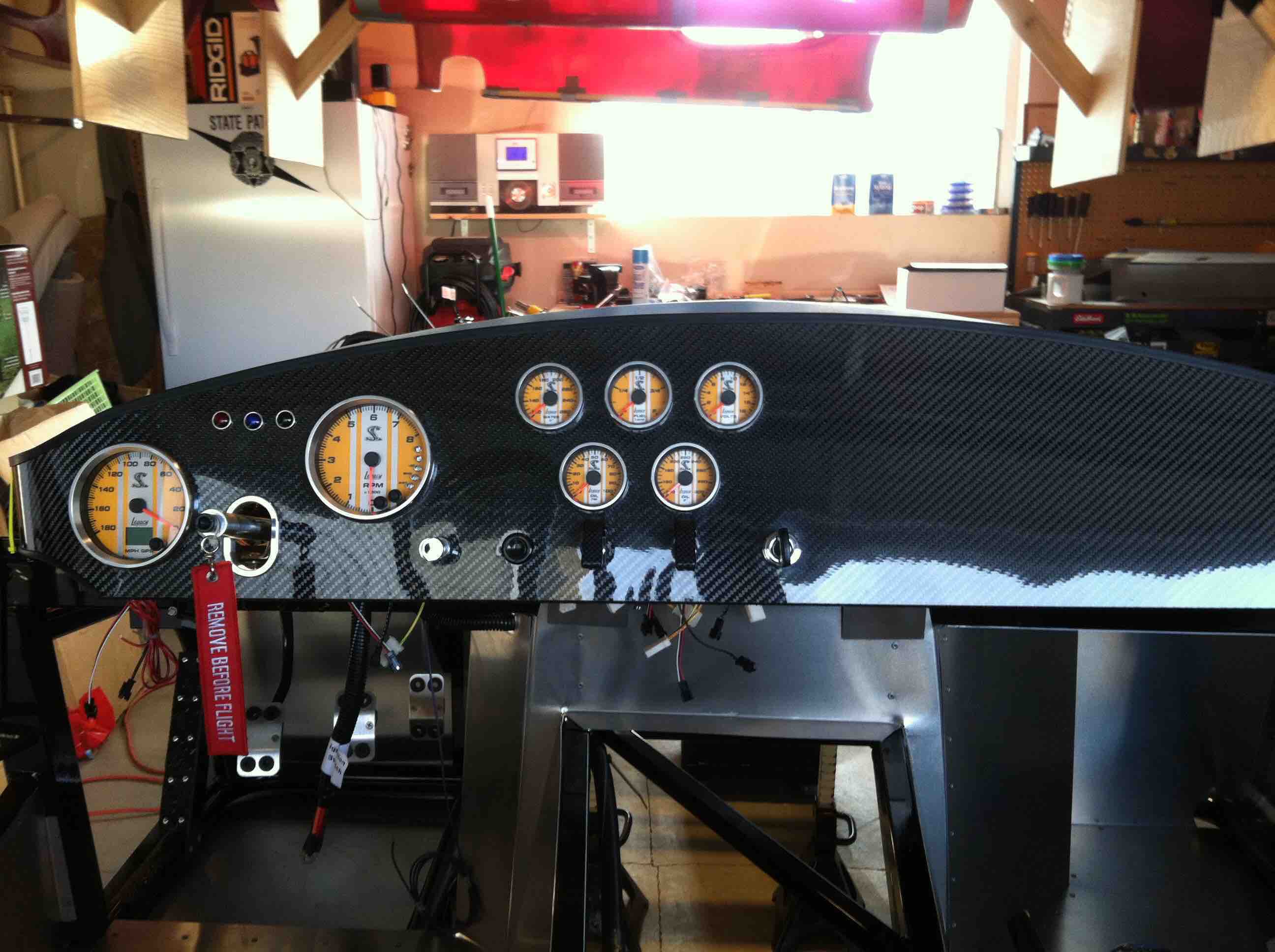

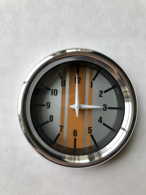

    Smile gauge decision

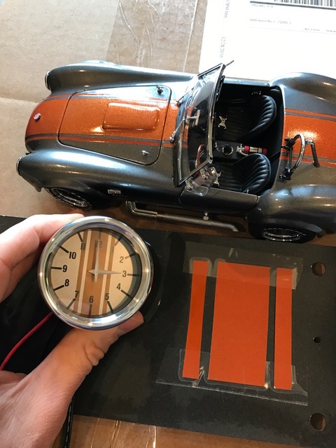

    I came to find out speed hut could do custom faces for the gauges. I am considering sending mine in and having them refaced. The cost is pretty reasonable. About $300 for the set. I really like having a unique look to my projects. All these cars we build are one of a kind and I think the personalization is one of my favorite aspects. With my high back seats, fighter stick shifter, dual roll bars and the triple stripe I will be doing my car will certainly not be a traditional Cobra look.
    As far as the gauge faces you are somewhat limited on colors you can choose from. Speed hut offers a tangerine color. I was concerned about just selecting it by an online picture. I called and asked if they could send a color sample which they said they could not. I was disappointed in that and determined my best course of action would be to have a sample gauge made so I could see one in person. The clock was the cheapest thing they offered so I ordered one of those. That had me in for $76. At this point what is another $76! haha I ordered it on 11/28 and it arrived today. A little slower than their normal service with the holidays I think.
    Here is the clock. Silver with a tangerine triple stripe. I would also be interested in adding a small cobra logo they offer on each gauge face but figured for just the sample I did not need to pay extra for that.
    Now for my dilemma. The silver is not close to my gray and the orange is close but certainly not the same color as my stripes will be. Here are a couple pictures comparing my paint samples, the gauge, and the diecast I painted up. Also one of the gauge vs the originals. That is all I have for now. The lighting in the picture with the die cast isn't the best. The orange in the other picture is pretty true.
    I am fine with the look of the silver on the gauge face. I think it would actually compliment the look nicely. I am going to have to think about the orange. IF they would do a custom orange color that matched perfectly it would be a slam dunk. I may try asking again and see if I can work something out but am doubtful. Another consideration is my red rocker switch covers in the picture. If I change gauges I will swap those out to black. My fighter stick has a couple very small red buttons which is why those are red in the first place.
    So what are your opinions on the custom gauge face?
    (My buddy asked me when I was asking about colors if his opinion mattered? I said absolutely, it is 95% me, 4% my wife and 1% everyone else's input! haha) I do like to hear the opinions though
  25. #345
    Senior Member Misterfubar's Avatar
    Olathe, KS
    131
    When it comes to the gauges I think form should follow function and the colors you've got on your sample don't give enough contrast and might take a split second longer to read the gauge, and the white dials are hard to see against the white background. If it's not an exact match I would skip it.
  26. #346
    Senior Member Jdav's Avatar
    Sep 2016
    ATL GA
    443
    Your seat belts are a third color orange, correct?
    On one hand, that would make me think that a different orange variation would be ok, but it might be too much.
    My bigger question would be if a dash full of striped gauges would look too busy (regardless of the color match) - looking at 1 by itelf is fine, but 7 of them might get crazy.
  27. #347
    Quote Originally Posted by Jdav View Post
    Here is a picture from Chris Gundermann that shows a full panel. I think it looks pretty awesome.

    I am more comfortable knowing that you have your opinion priorities in correct focus! It should be all about you unless you plan to sell the car immediately, which clearly you do not. My 1% is this: I like the silver face, but the "tangerine" doesn't look like any ripe tangerine I would ever eat!! I like the custom gauges, like the concept of the stripes, but don't think the color works with the other colors you have. I like the red switch covers, and you are correct that they would have to go. I would like it better if a) they had a decent orange color, and b) they had your triple stripe pattern. As is, I say skip it, save your money. If they can give you a good color match on the stripes, perhaps.
    Just remember, opinions are like navels: everybody's got one!

    My 1%...the stripes, even if they were an exact match, are a bit much and would be even more so with the Cobra logo. If you want to make a change from the current gauges to add some color I suggest gray/silver faces with orange pointers. But your vote carries 95 times the weight of mine

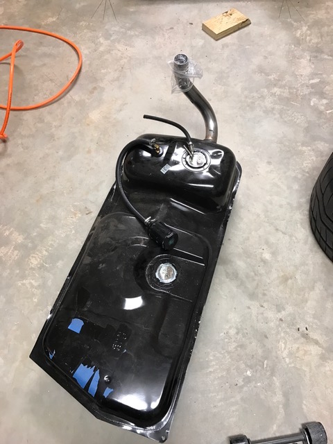

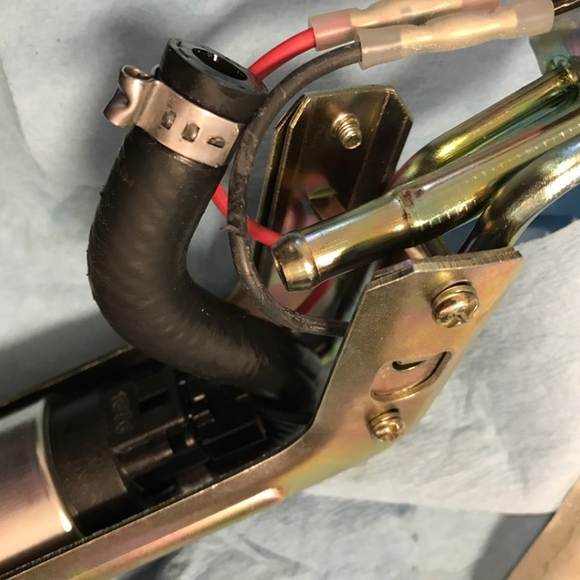

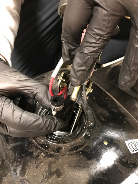

    fuel pump failure
    I got my pcm back from Ford racing. They said it checked out ok. Prior to sending it I was having a couple issues. One being no fuel pressure showing on my regulator although the pump was running. Since everything had run perfectly right up to messing with the pcm upload to fix the P0116 code I and the Ford racing tech I was on the phone with deduced it was likely the PCM so I sent it to them. Well after it came back and it checked ok I hooked it up again and still no fuel pressure.
    I figured it was time to look at the fuel system.
    Started with the output of the fuel filter. Unhooked the fuel hose and then activated the pump. NO fuel came out.
    Next I tried the inlet hose to the fuel filter to determine if the filter was blocked. Well nothing was going into the filter either so it was clear that while the pump was running no fuel was leaving the tank for whatever reason.
    At that point on the advice of my build mentor Paul I dropped the fuel tank so I could get the pump out.
    Once I did that I took the pump out and found that the hose on the pump had come loose.
    I have no idea how that happened but it sure explained why the fuel was not leaving the tank. I purchased this pump from Breeze. I called Mark and asked if he had seen this before. As usual his customer service was outstanding. He told me to send it to him and he would fix or replace it. I think it simply needs another clamp but I don't have the tool for the crimp type clamp so I elected to let him do it.
    I am quite amazed that the car ran perfectly the last time I drove it prior to the pcm update and that the pump simultaneously failed right when I was doing the pcm. I cant see how they could be related so I will just write it off as an amazing coincidence. Hopefully I will have the pump back soon and be back on the road for some more go carting. I wonder if it is possible some back pressure due to a pcm fault of some sort could have caused the line to blow off??
    Mark at Breeze indicated he has seen this happen before but it is very rare. I guess the only thing to be learned would be to just check those clamps over and make sure they all seem very secure prior to installing the pump in the tank. I know when I put it in I did not give it a second thought or look to closely at it.

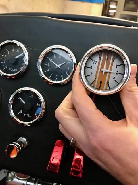

    Custom gauge color
    I previously updated about my hopes of refacing my gauges to match my orange stripe. The sample gauge I ordered just did not look good enough to me. The orange color they offer is not close enough. That is the only orange color speed hut produces. I called to ask for a custom color at an additional charge but they will not do it.
    Since I now have the sample clock that is pretty much useless to me I am wondering about taking it apart and seeing if I can get the printed face out. I am wondering if I could get a local print shop to make some for me and I could switch them all out.
    Anyone ever try disassembling a gauge? Is this feasible?
    My thought is from what speed hut told me is they print the face out and then assemble the gauge. Wondering why I could not have the same done locally?
  32. #352
    2bking's Avatar
    Garland, Texas
    799
    I'm sure you can disassemble the gauges and make your own faces. The front bezel screws off and the hands can probably be pulled off the shafts. The problem is what you don't know about what is done to maintain accuracy and the assembly techniques. I would assume the gauges are cleaned and assembled in a clean room, an environment not available in the home. Instruments, like a watch, require a clean case and parts along with the right lubricants for longevity.
    Perhaps Speed Hut would swap the faces if you supplied them. A simple CAD package and a color printer could produce the custom faces. A lacquer finish would keep debris from coming from the paper and ink over time.
    King

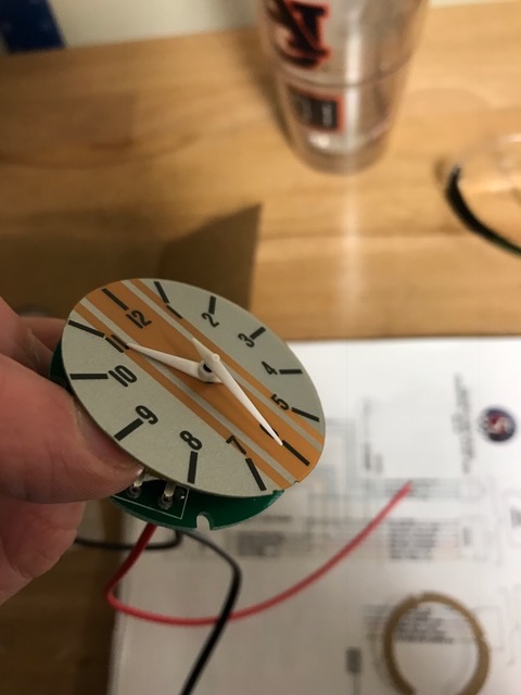

    gauge face 2
    Good points King. Thanks.
    I did get them apart quite easily.
    Couple problems in addition to the clean reassembly King mentioned.
    The printed face seems to be a special disk that has the wiring attached to it that provides for the backlighting. I see no way to reproduce that locally. I would not want gauges that were incapable of being properly lit. Based on Speedhuts unwillingness to provide a custom color I seriously doubt they would supply me with blank disks to get printed myself. Not to mention they probably have special machines that cut the disks after they are printed.
    I think that is just to much to overcome so I will put that bright idea to bed. Would have loved the look but the stock gauges look very nice as well so it is just fine.
    Another $76 sitting on the parts shelf! haha Anyone have a failed clock and need replacement parts?
    The nice part is the clock came with another one of the plug in cables with the setting button. Previously I had the one that came in the box set up so I could swap it for use with the speedo, tach and clock. The tach should be good to go now that it is set. Now I have a dedicated set button for setting the clock and one for changing the modes on the speedo.

    Thanks for posting. Looks interesting. The appeal to refacing the speed hut gauges was reasonable cost and the ability to use the existing wiring I have already installed. Had I thought of custom gauges from the beginning I could have proceeded differently. I think I will just leave it as is but keep this in mind for a future build.

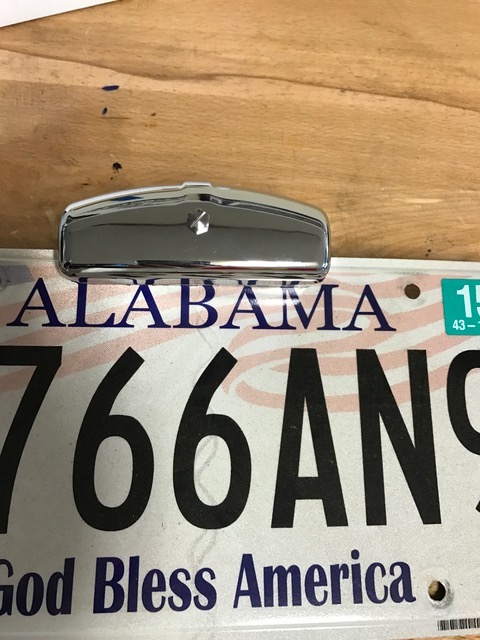

    kleiner license plate mod
    Just looking for small task to complete while I wait on the body and paint.
    I did the famous Jeff Kleiner license plate mod. Moved the plate up about an inch by rotating the internals and drilling/riveting some new holes. I won't go into a ton of detail but if you google "kleiner ffr license plate" the step by step instructions will be there. Very easy mod and should work great when it comes time to mount the plate.

    Are the gauges actually back lit? or lit from around the edges. Seems like any local sign shop could make some vinyl decals faces. There used to be a sign shop in the back of the car stereo place across the street from Waffle House on opelika road close to the mall. They used to cut custom vinyl for me 20 years ago.
  38. #358
    11,117
    Quote Originally Posted by mikepward View Post
    Speedhut gauges dial lighting is an electroluminescence panel. Not something easily duplicated. http://www.speedhut.com/faq.i#how-do...ng-system-work

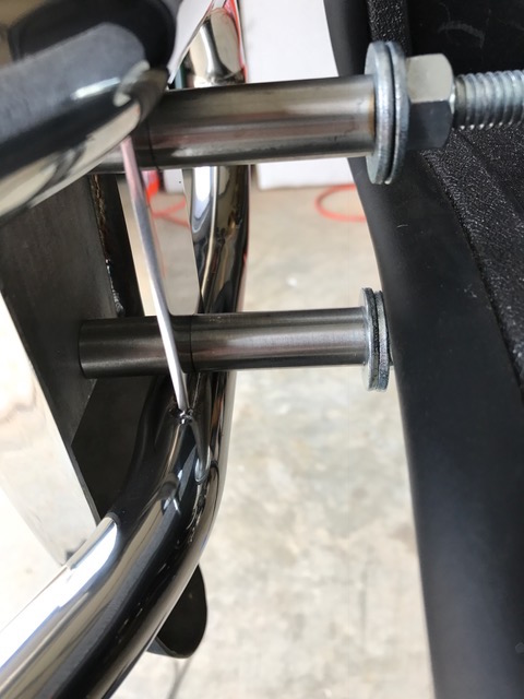

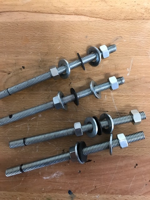

    Rear bumper couplers

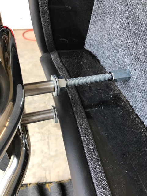

    Previously I had planned on just using the supplied bolts to attach the rear bumper. Since my fuel pump issue necessitated me dropping the tank I decided to go ahead and use the couplers so I won't have to drop the tank again to get the bolts in. I bought 3' of 7/16" threaded rod which I cut into the needed lengths. Also got the couplers and other hardware needed. I happen to have a specialty bolt store in my small town. They have everything I need. Interestingly I told them I wanted lock washers for the backside of the coupler and they advised me there is new research that shows lock washers don't work. I found that surprising but have no reason to doubt what they are telling me. I skipped the lock washers and used a regular washer on the back as well as some blue thread lock.
    Here are the couplers installed:

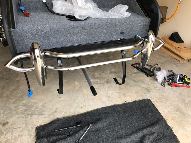

    I decided to go ahead and mock up the bumper to make sure everything went together as expected. The bumper kit comes with some shorter spacers that go between the bumper piece and the overriders. The longer spacers came with the bolts intended to hold the quick jacks on. I decided not to use the longest provided spacer that normally goes between the inside of the body and the trunk aluminum panel. Instead I will use a bolt and washer on the inside. That way it can be adjusted to the appropriate position for best body fit. I did add a neoprene washer to this setup that will go on the outside of the body against the painted surface.
    Since the threaded rod threads into the coupler you need to drill out the threads in the overriders. I did not realize this at first and was somewhat puzzled how I was going to get this together! ha Once I learned the overriders get drilled it made a lot more sense. Then the threaded rod can slip through the holes in the overriders and you put a nut on the backside to hold it all in place. No way to get a good picture of that. Here is the bumper mocked up and how the hardware is arranged. Just keep in mind the body will be sandwiched between the nut and first spacer.
    After I was happy how that went together I packed up the bumper. I will be sending the go cart to Whitby to install the body and then when it comes back I will install the bumper. I will just send this to whitby so they can attach the body in the proper position and then when it comes back remove the nuts temporarily holding the body in place and replace them with the spacers, bumper, and overriders.
    Fuel pump should be back tomorrow and I look forward to some more go carting this weekend. It is supposed to be almost 70 here.
  40. #360
    9,128
    You're welcome
    And your overriders are installed upside down.
