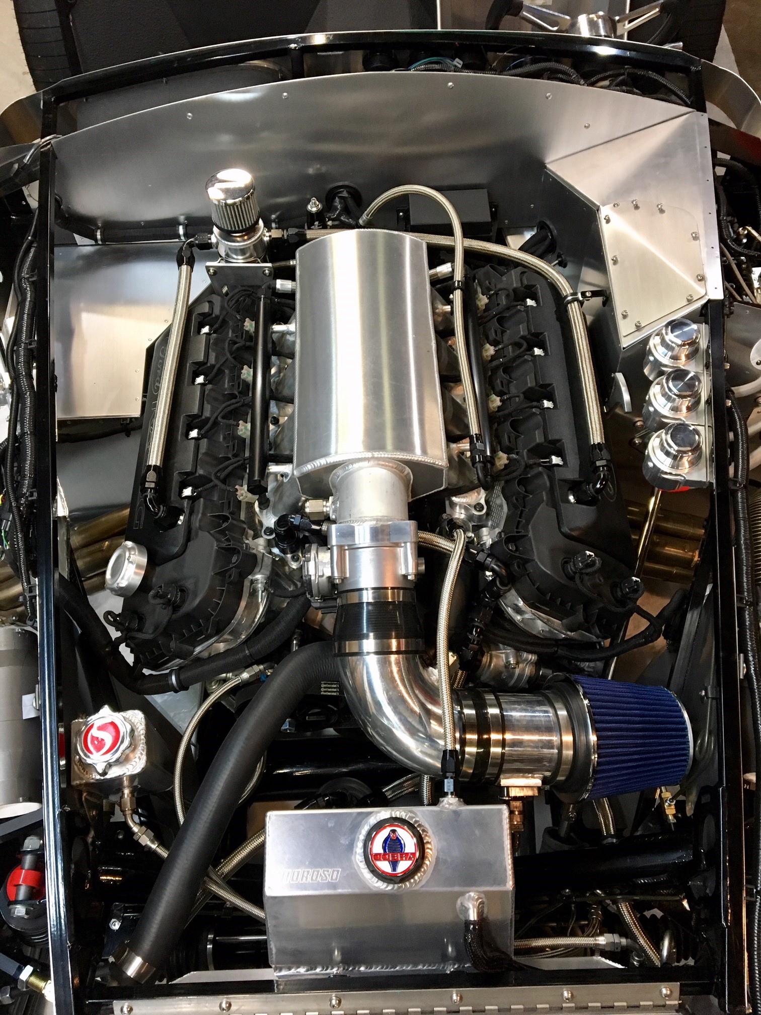

    Love those Wilwood reservoirs as well. I literally sucked wind when I Googled one and saw the price though. Not sure I have room for the triple CNC on my Coupe build, so looking at alternatives. I'll keep this one in mind.
    Your build is looking great BTW!
  3. #123
    1,282
    Thanks Jdav, Thanks Paul.
    Yea, I had the same reaction. Wilwood is awfully proud of those little cylinders. I employed a little of my wife's shopping logic though, "since I have a bunch of credits with Summit, they really weren't that expensive" ... I know, dangerous way to rationalize spending but I do like them and now I should be done, ha ha.
    Presumably completed engine bay
    Happy to be moving on to body and interior. I'll need to re-read a bunch of your posts now.

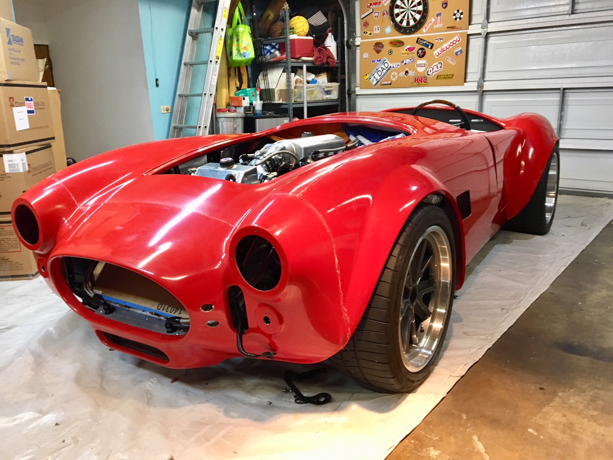

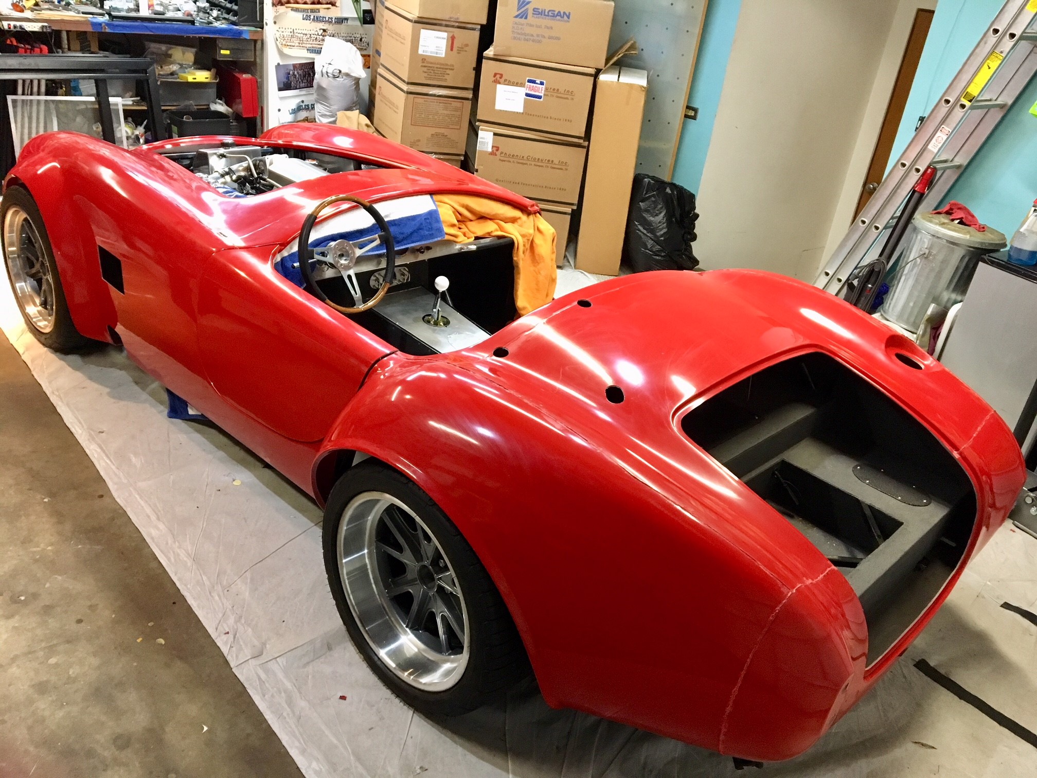

    Body On
    Just a quickie update. Got the body on for the first test fit. No bulb seal at this point, just a quick check for fit.
    Little nerve racking to pull that body on and spread the sides, but like everything else, once done it was not as difficult as I had imagined.
    It is an amazing transformation from chassis to car. Wow! More room and light in the garage and now this cool little red sports car to stare at. I can see why so many choose red; it is quickly becoming my favorite color. It looks perfect, even in gel coat. It takes me 10 minutes to get out of my garage because I just stop and stare at the lines from different angles.
    I forgot to remove my front turn signals and had to pull those off quickly in the middle of the process. Ooops.
    Initially, the nose got hung up on the oil cooler and I thought I might have to at least loosen the brackets but just had to get the body at a steeper downward angle and it slipped around the cooler and everything was fine.
    All for now.

    I like your setup on the wilwoods reservoirs and i was thinking about the same kind of bracket. I am still hoping that my 2 FF's will work. I really like the look of them and am hoping for the best. Great progress! What the height limit on those lids? I didn't look close enough back when the body was on so I'm just assuming I keep them no higher than the bar correct?
    Thanks Rob,
    Mine are about 1/4" below the top of the bar but flush should be fine. The lip of the engine bay opening on the body overhangs the square tube (inboard) and takes up 1/4" to 3/16". Make sure the reservoirs lids are spaced more than a 1/2" away from the tube. I never thought about the body but got lucky. If that doesn't make sense I'll try to get a photo for you.

    Louvers
    Next on the list was shaping the openings for the louvers and mounting the assemblies. I used the Finish Line louvers and the EdwardB method of bonding the McMaster studs to the body with HSRF. I stuck to the EdwardB plan other than I did it with the body on (not ideal). Lots more bending and stooping which is not my favorite thing.
    I trimmed the opening with a drywall plunge router, very slowly up to about 1/32" of my line. I brought the opening up to my line with an air sander and finally a hand file. One tip for fine work: Paint pens and sharpie lines tend to get worn away as you work. I lightly scribed my line into the gel coat with an x-acto knife. As you are filing and sanding that fine scribed line fills with white dust and is very easy to see against the red gel coat or your black sharpie line.
    First pass with the HSRF.
    I sanded off some of the HSRF with the Dremel tool and added a second layer around the studs. Here's my only advice: Tape over the threads of the studs when adding HSRF to keep them clean. Keep a nut on the threads to chase out any HSRF that might sneak past your tape and gum up a thread. I did that on 7 of 8 studs. Must have got interrupted or something but one stud was left bare and yes it takes a long time to pick HSRF out of threads with an x-acto knife.
    Finished product.
    And that, ladies and gentlemen will conclude the body work section of this thread.
    I was able to visit Jeff Miller at his shop and discuss what he like owners to do, and more importantly, what he'd prefer them not to do. He answered all of my questions and showed me how he like to do things, and in what order. As you can imagine, there are different ways to do all of these body fitting jobs, even amongst the pros. I have read so many threads and made tons of notes and while all of the ideas I've picked up are valid, not all are conducive to the way Jeff likes to work. I think if you are planning to take your project to a pro, it is time well spent to visit them in advance and discuss a game plan.
    My hat's off to all of you who do your own body work and paint. I'd love to but just don't have the proper facilities. I drilled a few holes, made a little fiberglass dust and got just enough of a taste of it to be able to hand it off to Da Bat with no regrets.
    On to the next project.
